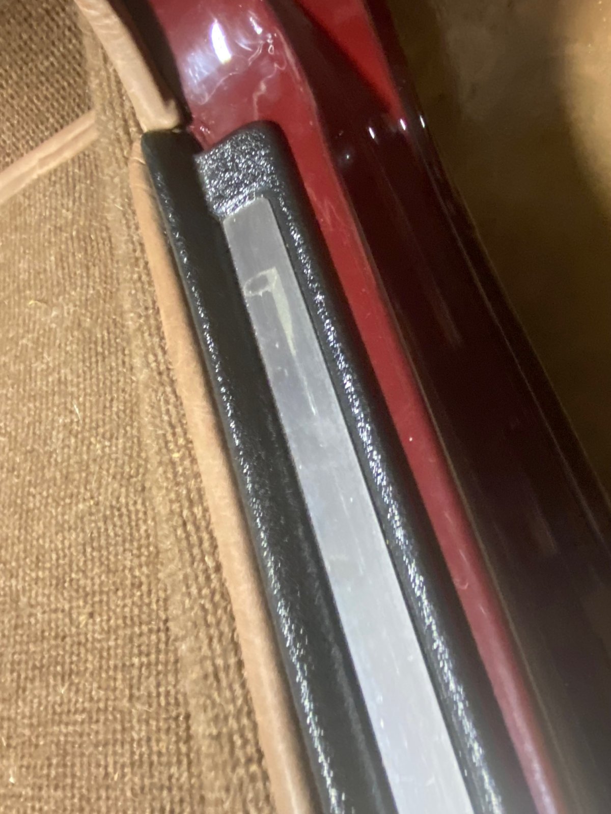

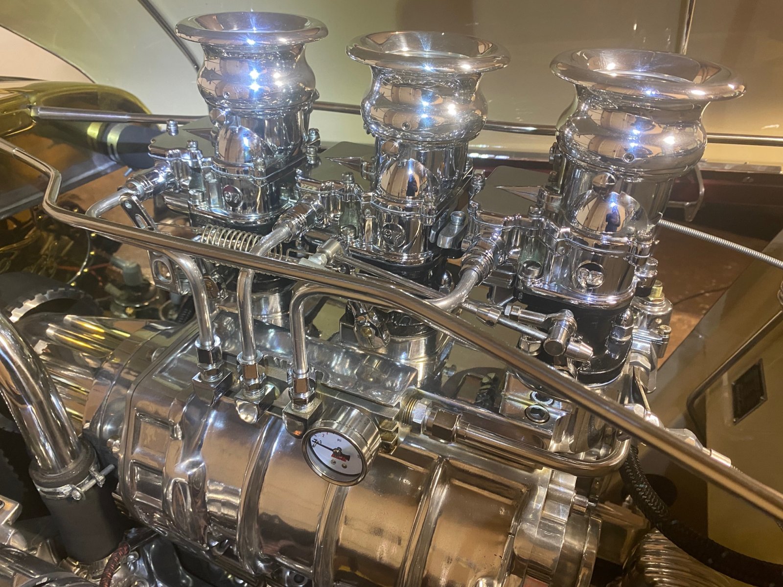

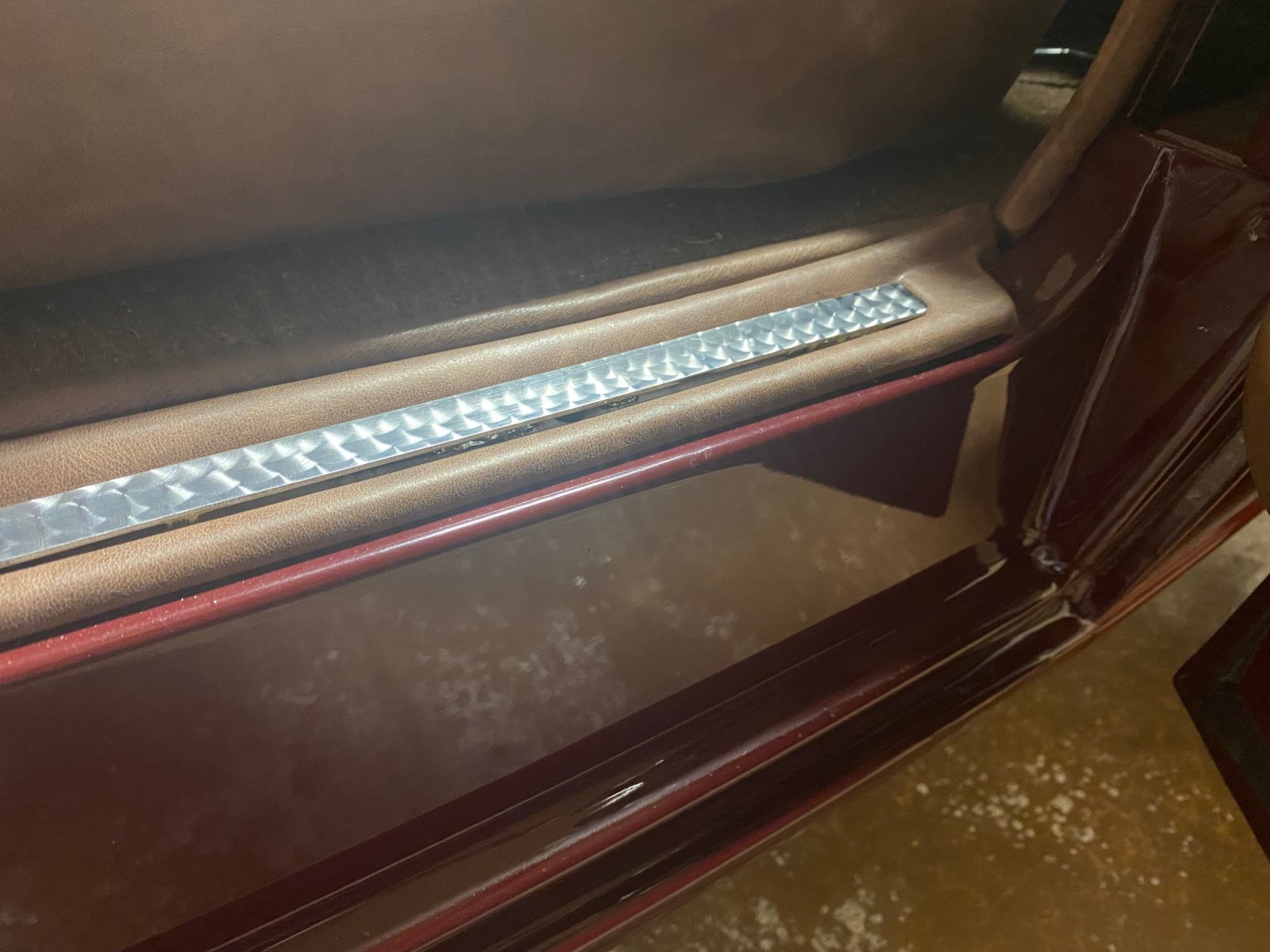

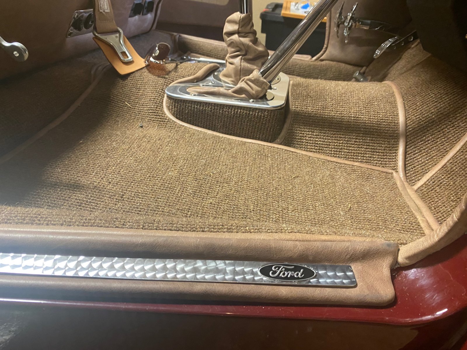

    While the buffer dude cleans the truck up, I changed vehicles this week. I had a short knock out list to do on the roadster. I swapped out the chrome steering box for a new Borgeson unit, pulled off the carbs to swap the bodies for the chrome plated ones I had done and then it was on to the door jams. I used these plastic ones years ago and I have always disliked them. They look cheap.
    I was going to make new ones but these fit the car very well, especially considering the carpet t*******.

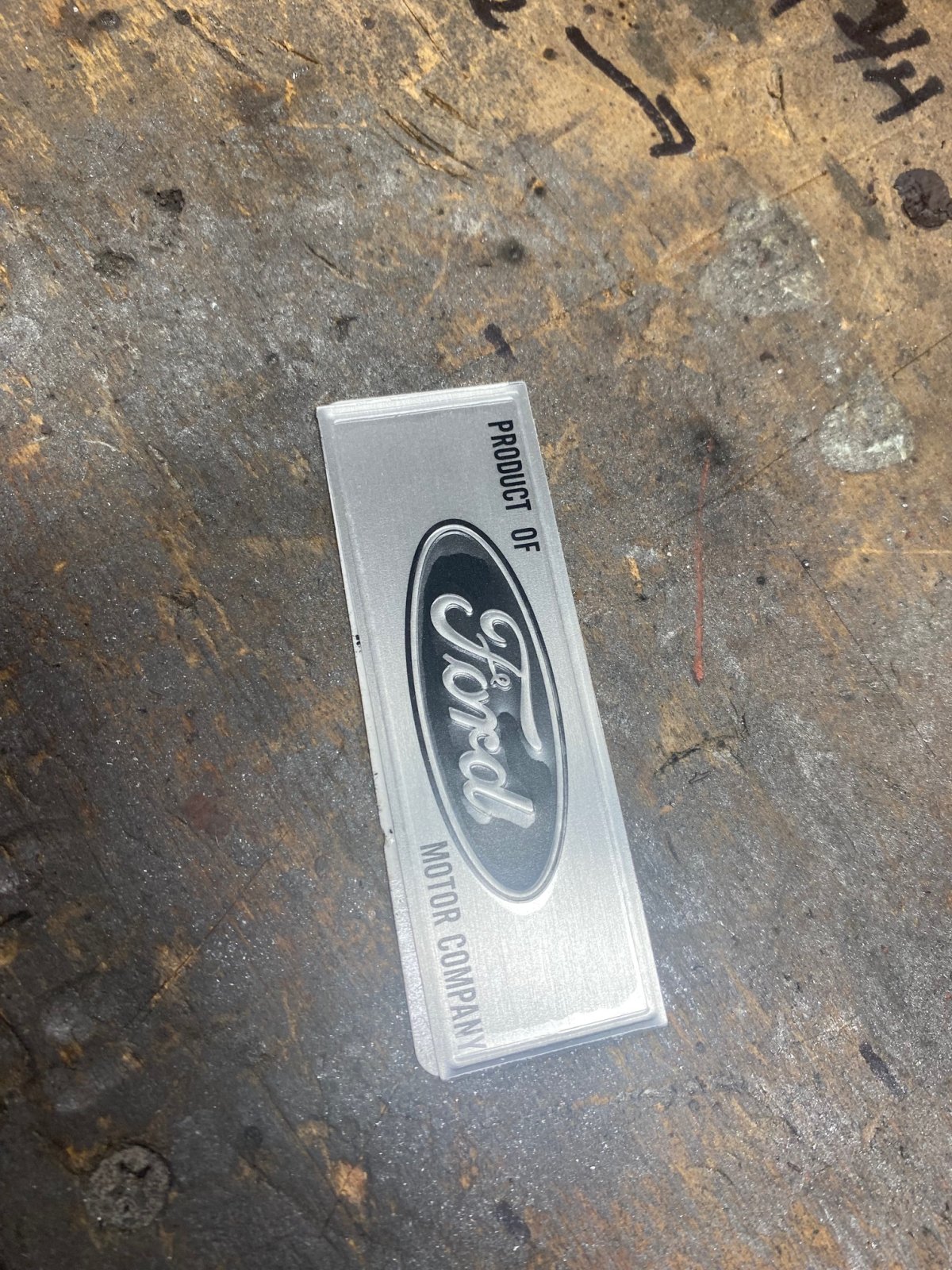

    So I pulled them off and dug up my box of left over leather t*******s. Grabbed some 3M 90 spray adhesive and covered them in leather. As you may have already guessed, I took that brushed aluminum strip, buffed it and turned it.
    I had these "pinto" door sill stickers that I chopped up until only the oval remained.
    And stuck them on the only spot wide enough to hold them.
    Cl***y! Next up I am going to cover up the gas tank in the trunk. That is going to be fun!

    The paint was starting to wrinkle on the Strombergs, so I fixed that. Or rather Chrome Troy, Clive and @uncle max fixed that. I just did the R&R. Another winter project done.
    So, I finished the trunk, door jambs, replaced the steering box, chromed the carbs, all it needs is oil change and it's ready for summer...after a few more months of rain.

    Billy I did the same thing with an engine turned strip for a door sill. I like the Ford emblem though. Nice touch!

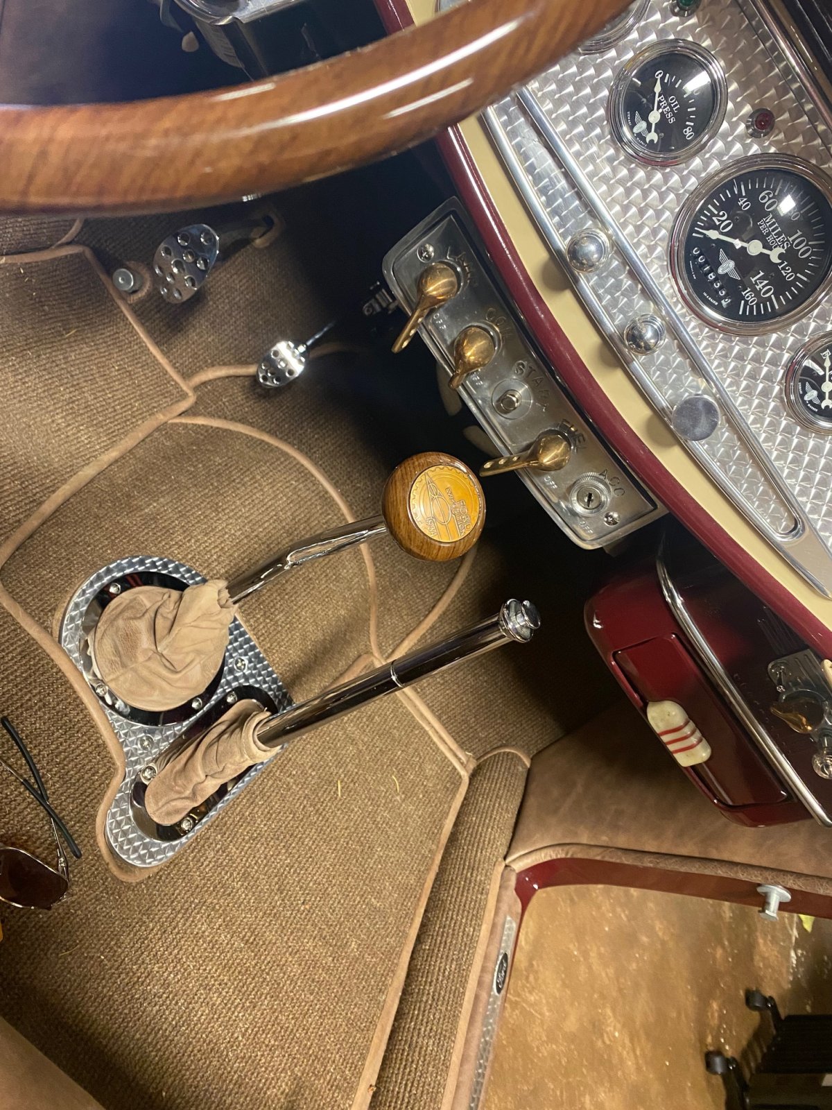

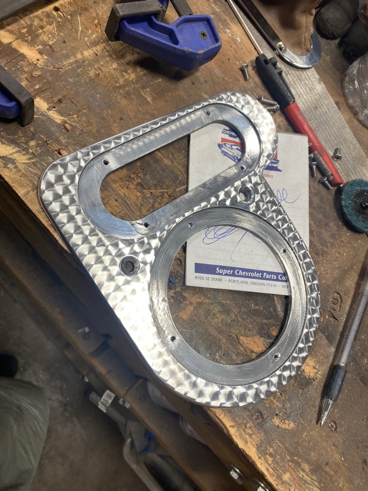

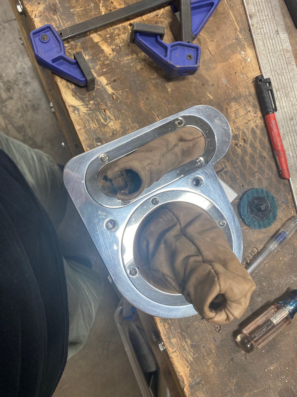

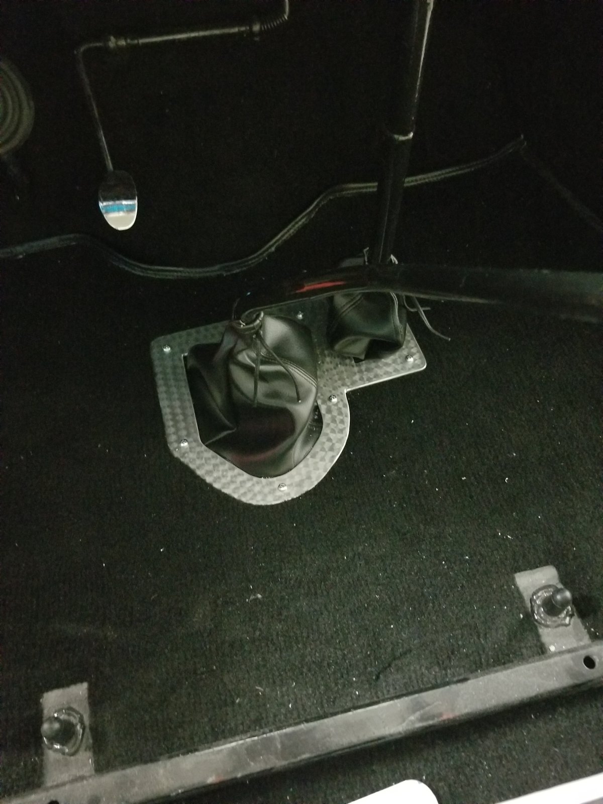

    I got all verklempt detailing the truck so I needed a break and went got mine off the roadster just now.
    Polished it up a bit and over to the drill press for some uniform scratching.
    Much better. And Back in.
    I always meant to that, so it matched the gauge insert but frankly, I didn't know how until I read a thread on the HAMB about it. Now shift panel, door jambs and dash look cohesive in design.
    Word to the rookies, start on straight stuff, round stuff has a lot of free hand involved.

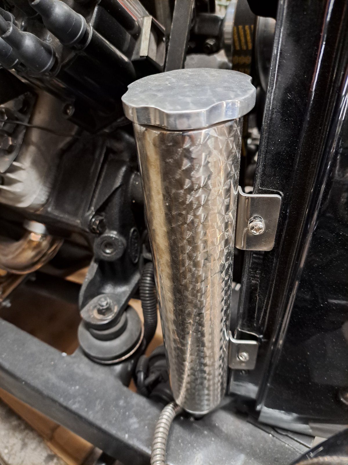

    It looks great Billy! I free handed my overflow bottle. I am feeling ya!

    Unless someone had actually tried a round surface, they would not understand the issue! Not bad! I tried a rounded fill cap and ended up sanding and polishing my mistakes out.

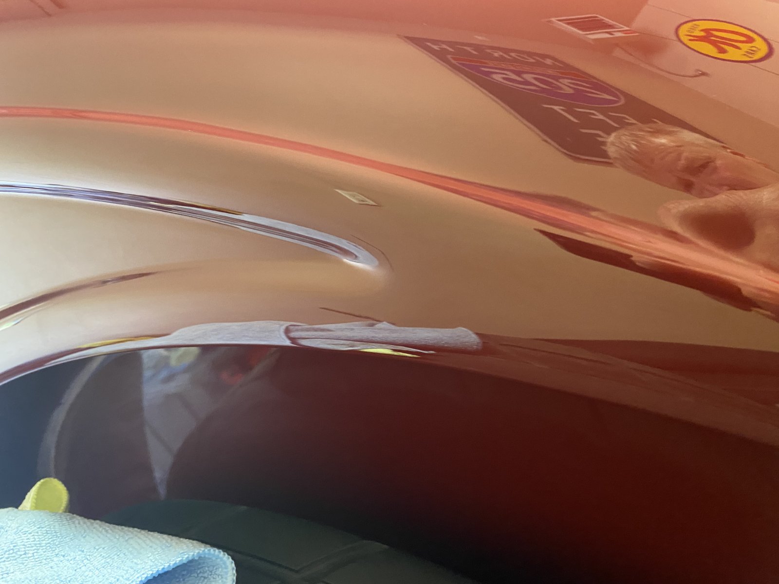

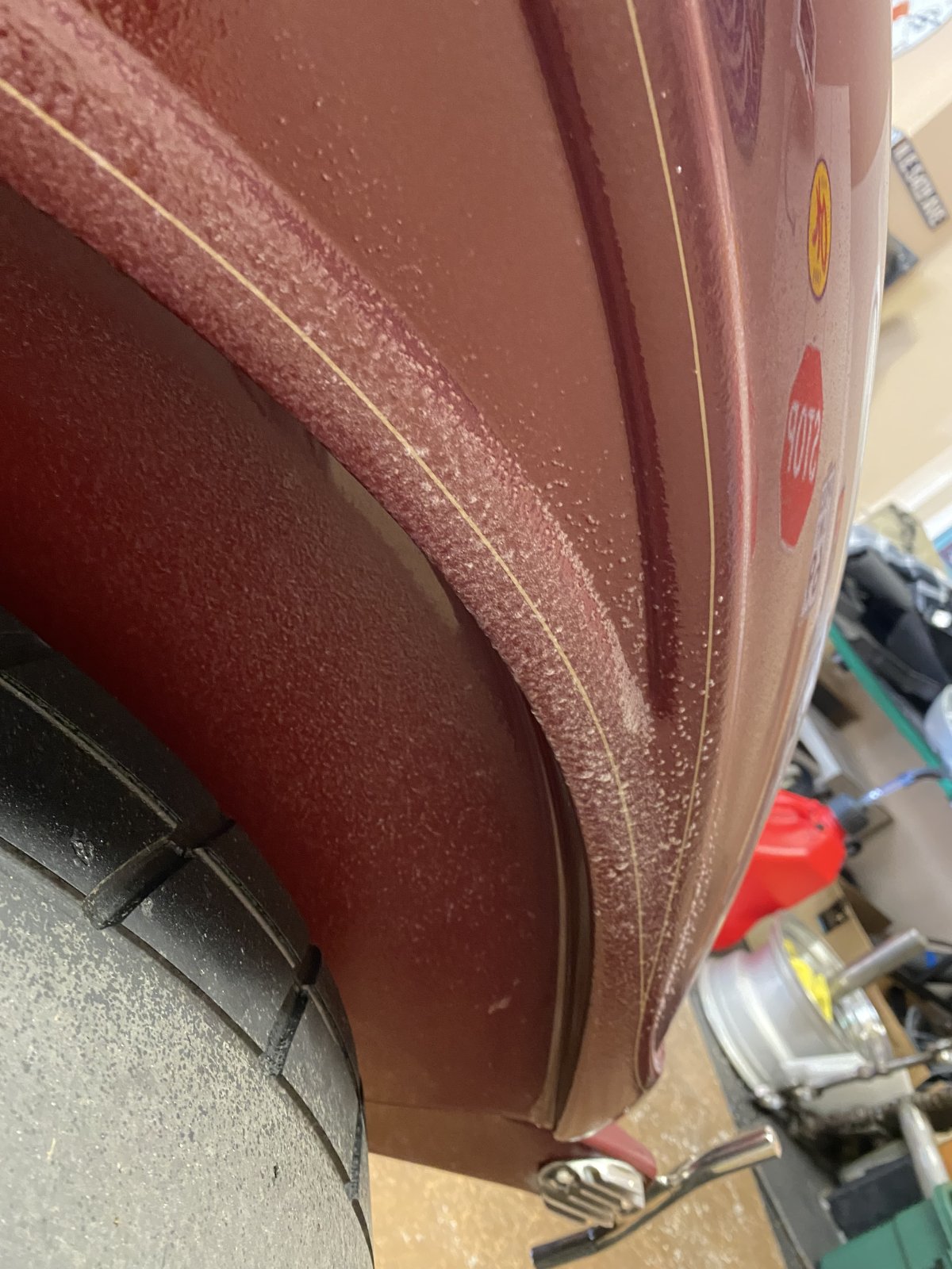

    From the “they’re never done” file, I was never overly impressed with the pinstripes in my roadster. After seeing what Mitch Kim did to the 41 pickup I booked an appt with him and that is now just a few weeks out.

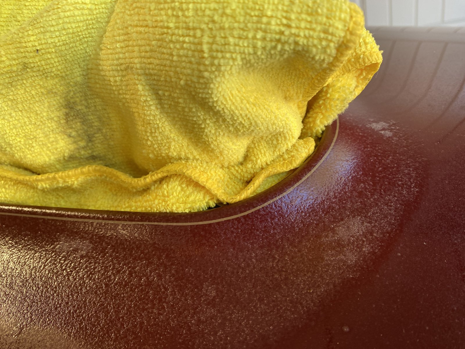

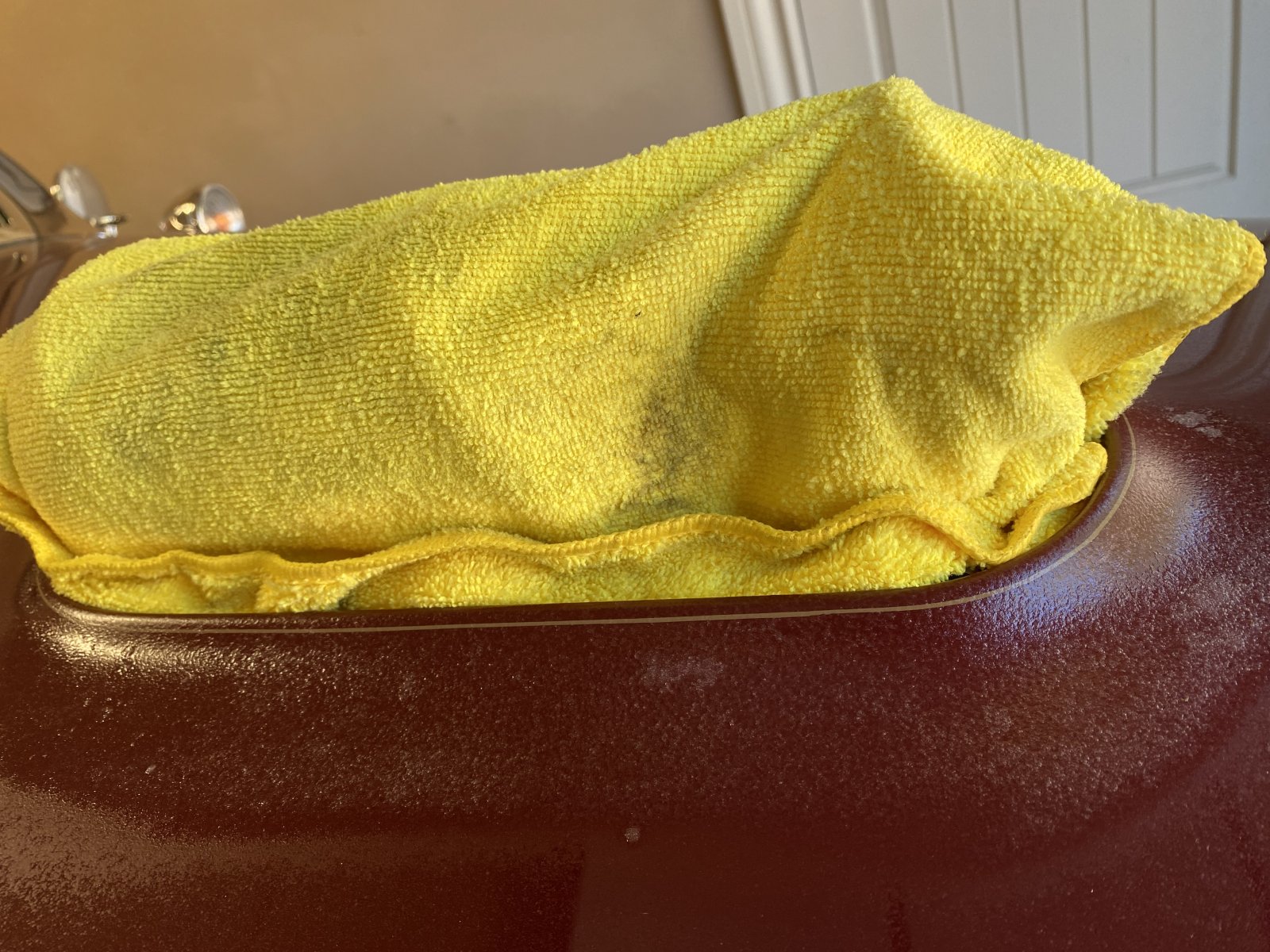

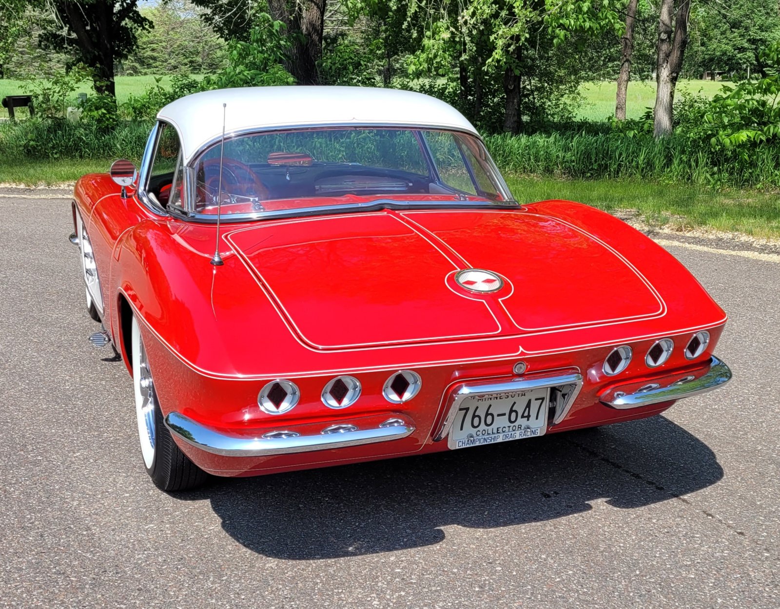

    First step is removal of the old stuff. I had purchased acetone but @Moriarity and I discussed it on the phone and I decided to try the EZ Off. I ordered the heavy duty stuff on Amazon and it worked beautifully.
    2to 3 minutes is all it takes. Spray one quarter, then a door, back up and clean the quarter with detail spray and by the time it is wiped down it’s time to spray the front and clean the door. Took 2 hours to strip it clean.
    Even though I threw a rag over my frog mouth scoops the aluminum scoops still needed polishing, that stuff is abrasive on soft metal. But they polished out with minimal effort.
