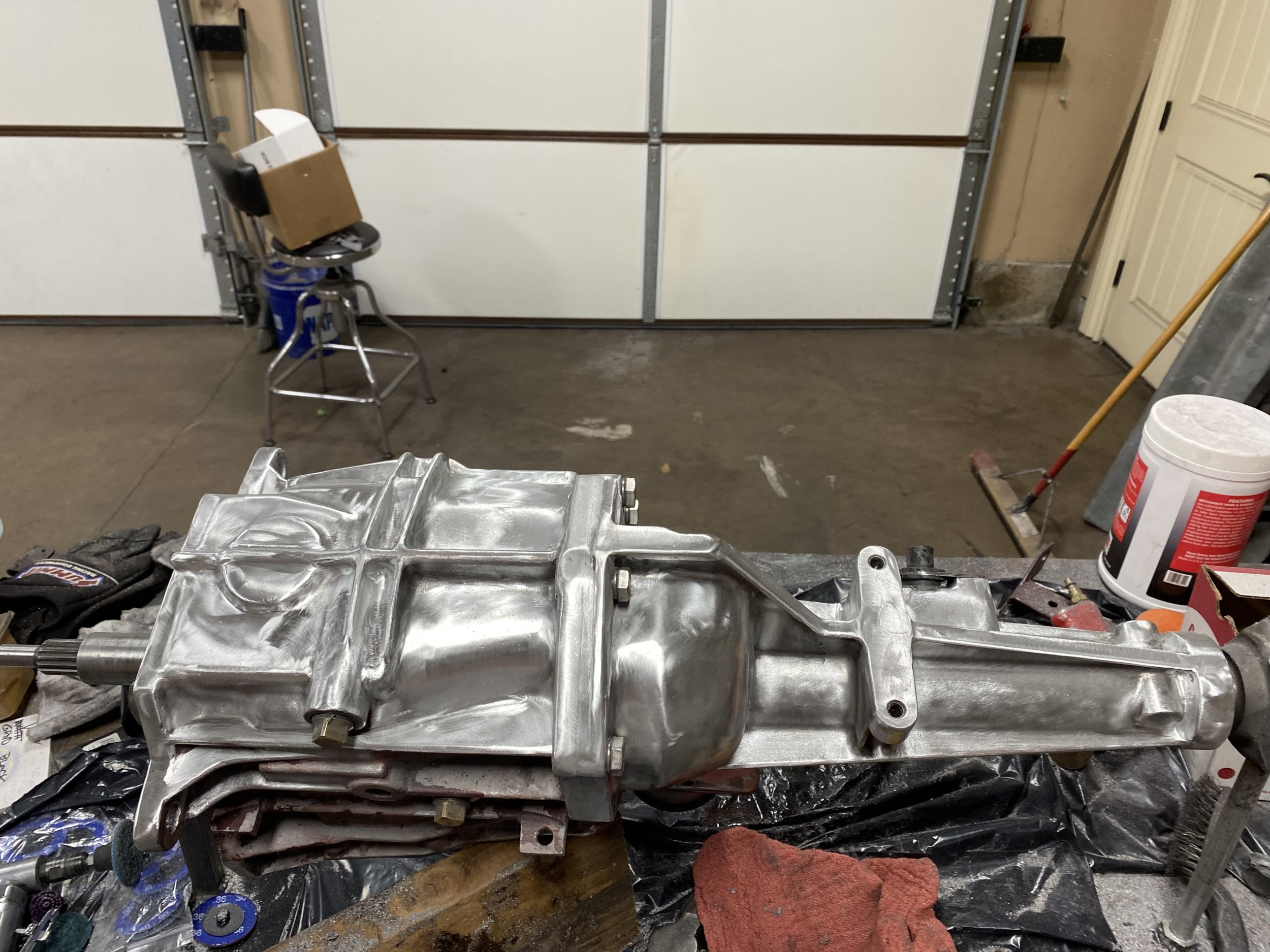

    Step one in polishing the tranny is to build a rotisserie.
    Up front is angle iron with an old distributor hold down tracked on welded to a base plate
    out back, a bolt welded to a scrap piece that is bolted to my bench, I welded a washer to it to hold the yoke. There is a spacer inside the yoke to keep things tight
    that should do the trick. Removing casting imperfections and paint. The garbage bag is to keep the air craft stripper from making a mess.
    I don’t have to get too crazy with the polish job, not much is visible after install but I also don’t like doing crappy work. I’ll find a happy medium.

    Well this is time consuming, but what else was I going to do today?
    This side is nearly done. Then I get to roll it over and clean the other side. I ground off the tabs in the top cover. When I got a sizable bump at speed you could feel the trans hitting the tunnel. When I removed it there were evident witness marks. This should quite that problem.
    I also removed the VIN numbers from the stamp pad on the side of the trans. Never a hood idea to leave them in there. One less thing to explain to an inspector.

    I started on this side because it is the most complex. I'm getting some polishing done while cleaning and most of the casting has been ground down already. Hopefully by the end of the weekend I have it down to fine tuning. I have been putting off surgery on my index finger (ganglion cyst) until I have the car re-assembled. Doc always barks at me when I show up to have the stitches out and his gauze is covered in grease and polishing compound.

    “Polish a transmission “ I said
    “It’ll be easy” I said
    I need to stop taking advice from myself.
    Paint nearly off. Hopefully start finish sanding it tomorrow.
