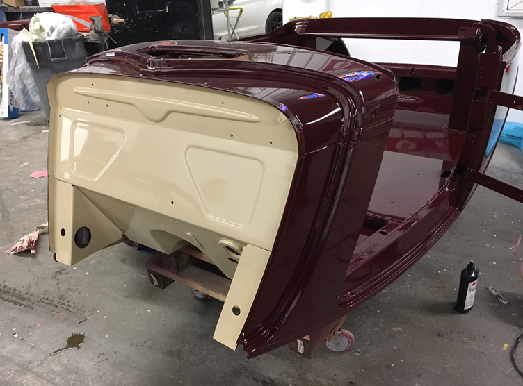

    I stopped by the booth to collect another truck bed of parts today and got a picture of the firewall un masked.
    I actually got down on the floor to see the entire tan undercar, it is very cool.

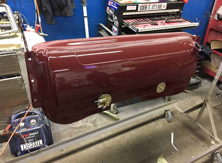

    And a picture of the 32 tank that I modified to fit my roadster.
    I dread thinking about how many hours I have into that tank. I had to make the brackets to adapt the tank...then I formed the bottom reveal so it was seamless all the way across...then I cut the tank for the quick change... then I had to move the sending unit over and weld the old hole up...then I had to move the filler neck...and no one will probably ever notice.

    Posts: 22,554
    A deuce fuel tank on a 34 is like getting chocolate in your peanut ****er.
    I like it!

    Exactly what the body guy said at the paint shop so he stuck a camera in the tank to take a look around then sealed the interior with POR-15 gas tank sealant as a precaution so it doesn't leak and ruin his paint job. I already had the tank pressurized and tested for leaks but this is good insurance.
  10. That's how you know you did a good job,
    It fits and functions flawlessly in someplace it doesn't belong and nobody notices it's been modified. Perfection

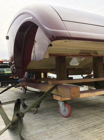

    This pic from the paint shop just now, car is loaded and on her way to me. I'm glad I am not watching this in person. Time for a ****tail to ease my troubled mind. Be here in 15 minutes.
    You can see her tan undies in this picture though. If it falls off the roll back you are gonna see mine.

    In my life I have had a few nervous waits, the birth of my two lovely children for example but this delivery had me sweating bullets. Feels like I just gave birth. Time for a cigar and a bourbon.
    ...Adorned by the master's lovely toys, she rests at last beneath florescent stars.
    Seriously, someone buy that Nova!
    And the frame is making a return trip to the shop for it's share of the maroon juice.
    Happy thanksgiving indeed. May yours be as joyful.

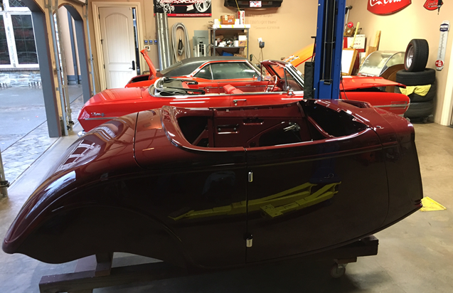

    Joined: Oct 16, 2002
