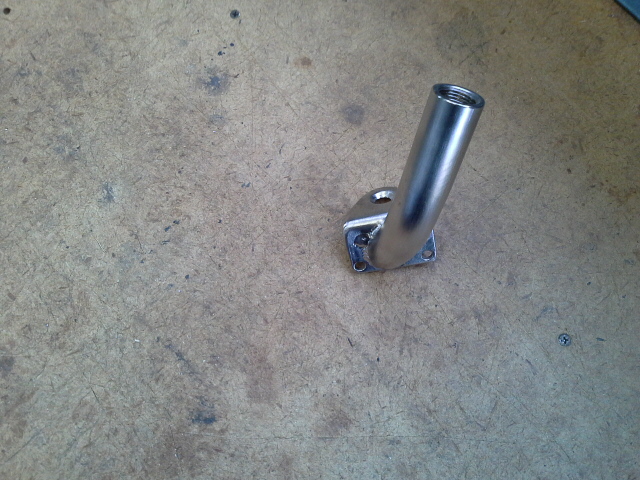

    This is the bugger I forgot to weld on, forged steel from So-Cal.
    Pete and Jakes offers this kit with a bolt on bracket that is like what I was describing above.
    I would make the bracket and weld my forged panhard bracket to it and chrome it up. Doesn't look like they were thinking it would be a lot of torque...those are small bolt holes.
    I am thinking I would use this as a guide and step on it a bit (over engineer it) and make sure it is sturdy. I could even run another wing up the inside of the frame to match this design and bolt all the way through the frame and bracket.

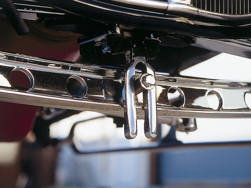

    What's with the tuning fork? The axle cant do the electric slide but it allows travel up and down? Is that a product or a creation?

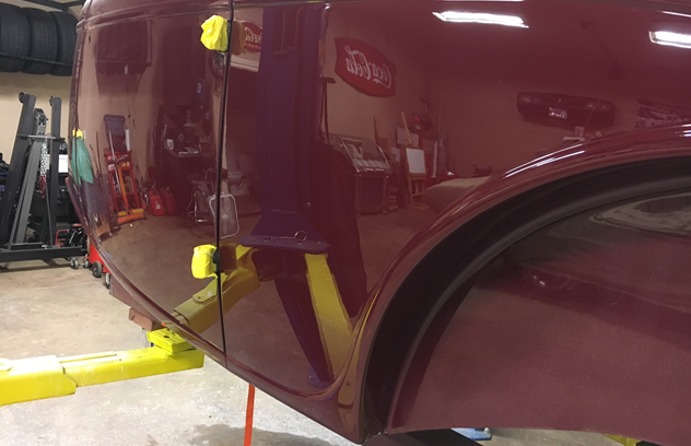

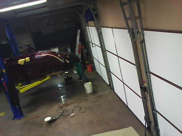

    So here is your evening update on the wet sand progress. The body is starting to take shape and that shape is flat!
    The polisher likes to shine up a panel to see how it is going to look. That panel of choice today was the deck lid (das boot?)
    Unlike Brian, I remembered to drill the trunk handle before painting :cool: snikker
    And that there is the Bandit himself, through rose colored glasses. This is going to look good.

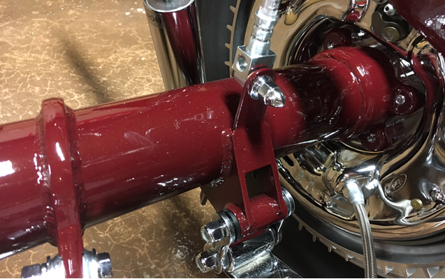

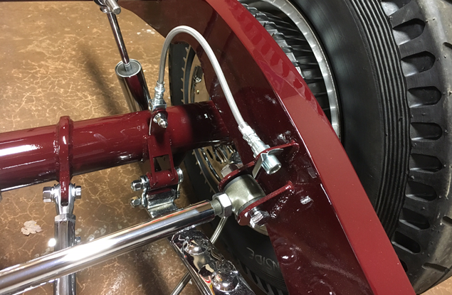

    Prior to painting the rear axle tubes I needed to weld brackets to hold the rear line distribution block and a spot on the opposite axle to attach my brake lines. I didn't want to weld directly to the axle (warping possibilities) and there was a perfect spot where the springs are attached on each side. So I cut a couple strips of steel to fit and stitched them in. Tonight I installed the distribution block and braided line to the frame as I prepare to run my hard lines.
    And up to the frame mount I remembered to weld in...o_O At least I remembered some stuff.
    The drop from the frame to the axle is dead on. More stuff no one will notice.
    Tidy! Now I can route the axle lines to the wheel cylinders and get ready to run the lines up to the M/C.
