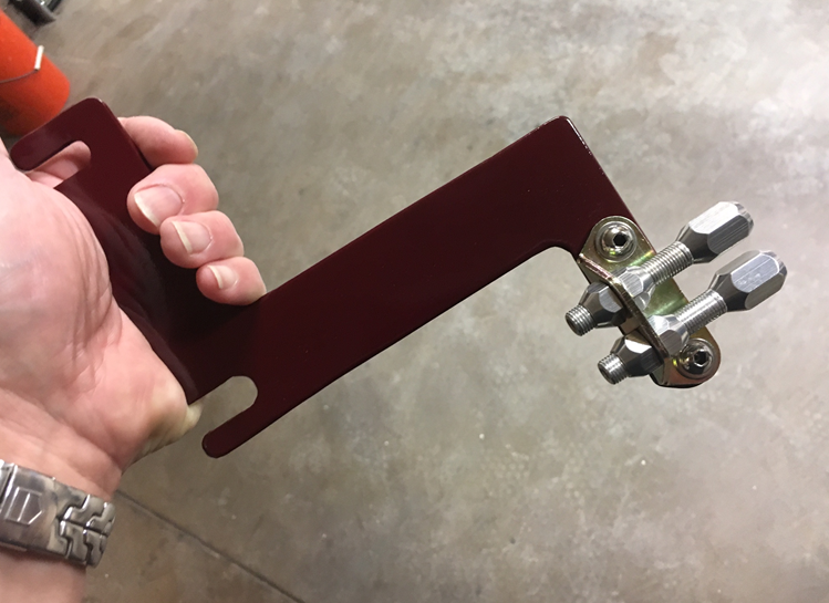

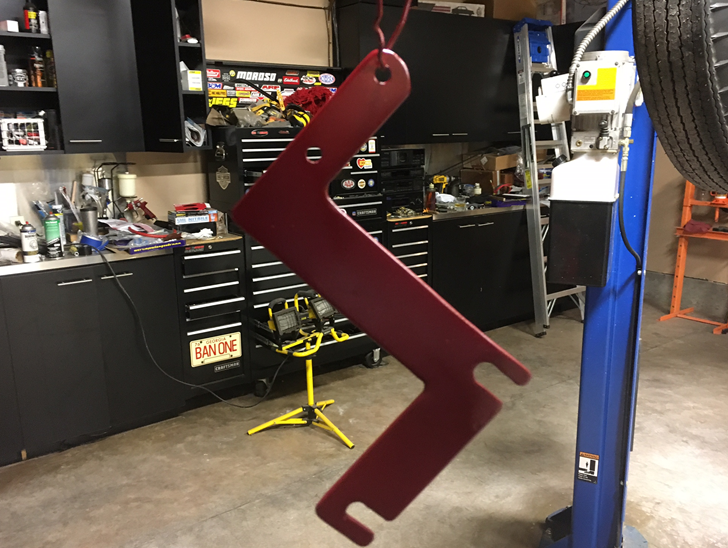

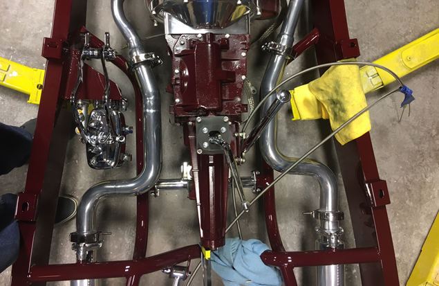

    Before I could get to that one I realized I also forgot the emergency brake bracket that I was going to add tot he frame before I painted it. I came up with a fix last night and a few s**** pieces of steel, welding, grinding, paint and clear I came up with this little jewel.
    It is slotted to slide between the trans mission and the mount/spacer. I offset the e brake cable bracket so it aligns with the handle that I added to the side of my T-5 in a previous thread somewhere.
    To make this next picture a little easier to follow along I have diagrammed it thusly
    T-5 trannny......new bracket.......spacer..........lever cable bracket.....new e-brake adjusters
    I had made the spacer to correctly align the transmission to match the QC's pinion angle. I had it nailed but after taking the ch***is apart for paint/chrome and re-***embly the transmission was needing to be raised by about the width of a washer as I stated in one of my posts above. This killed 2 birds with one bracket.
    Here is shot form underneath, tonight I will slide the cables out, trim the sleeves, adjust and finish the installation.
    I hope the front pan hard bracket does not provide more of a challenge. Now...what else did I forget?

    My thinking is this is the prototype, you can chrome plate the next one as this looks a little spindly.
    31Vicky with a hemi likes this.
  18. To me it looks flimsy as hell with too much leverage on slotted holes.
    But What the hell do I know? Test it before you chrome it.
    You'll need full weight on the ch***is before you get "washer" **** about the driveline angle. You could mill the spacer and make that bracket out of 1/4"
  19. Bandit Billy
    Joined: Sep 16, 2014
    Posts: 16,123
    Bandit Billy
    I set the angles with running gear installed, you think the weight of the body will impact since it is spread over the entire frame?
    I have quarter inch stuff and I could use it but I thought it was a bit over kill. In fact I have some quarter inch stainless, I could polish it and please you and Bob! :cool:.
    Ill cut the lines and see what happens tonight, post tomorrow.

  21. My experience is yes,
    there's a bunch of weighty stuff that nobody thinks about and then there's a boat load of stuff that doesn't weight much at all by itself - collectively it's no more than a "boat load" anyway though. :p:D
    Is the difference a lot ? Sometime not, but if it's down to a washer's thickness now there's no way to get it any closer until the ch***is is supporting all of its full dressed wet curb weight.
  22. Bandit Billy
    Posts: 16,123
    Bandit Billy
    Well, it wasn't the slotted holes but the arm the e-bracket bolted to deflected pretty good when I pulled the handle all the way back. The brakes worked, the set up is correct, but the material was not sufficient. I am going to use this as a template and knock it out of 1/4" stainless, that ought to do it and it will polish up real nice. I may add a gusset, we will see how the new material works out.
    The adjuster also needs to move inboard 3/8ths of an inch to align a bit better wit the ratchet handle. I did recheck the driveline angles with the bracket installed, it took the trans to dead zero. The rear is still .500 negative so I'll install the new bracket and see what I have before I adjust the rear ladders. Like you said maybe I'll wait until he body is loaded to do the final adjustment.

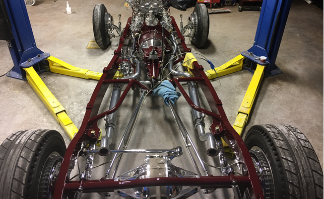

    Maybe after this weekend. Last night (after I dropped my bracket off with a buddy who owns a water jet machine to knock it out of 1/4" stainless, thank you very much) I added the fuel lines. They make a move from frame rail to over the inside frame supports that is a lot easier to do while the body is off.
    You can see where they have to move over that last bar. And I added a bracket there as well to secure them that would be impossible with the body mounted. And yes, I polished the stainless steel lines to nice high luster just for the entertainment of BlueOne and Bob. I am also planning on adding a bracket between those two and one more at the back where the tank connections are.
    Still to do is to add the 1 gauge power cable from the rear battery to the starter. That is getting tucked under the risers welded to the frame that hold my channeled body at stock position (visible in the picture above). I will add a clamp or two on top of the frame rail to secure it but it will in essence be quite invisible. I am going to add the alternator cable (#4) to the battery down the left rail. The remainder of the wiring runs down an internal channel in the body. I would have liked to have had the tail pipes back by now but they are not hard to add later.
    I started polishing the driveline last night. It has to be sanded with 180/400/1200 and then ran on the buffer so it will take me an evening or two. It doesn't have be added now, it is just something to keep me from getting bored.
    On the body, I am adding my wipers now so I don't have to reach across the cowl, easier to stand in front of the body and work. I am also messing still with the cowl vent trying to adapt a screen to fit. Really, the body is nearly ready once I finish the above on the frame.

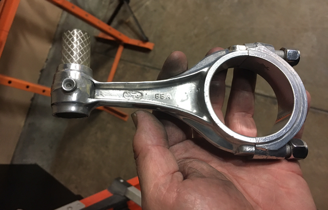

    Tonight I spent a little time in the shop after work. I made a couple of brackets out of stainless steel bar stock to hold the duel fuel lines fore and aft.
    Here are all 3 lines, fuel, return and vent all waiting patiently for the fuel tank to be installed.
    Oh, and I finished polishing the aluminum driveline I had built for the car over at Driveline Specialty in Portland.
    One step closer to body mounting. :cool:

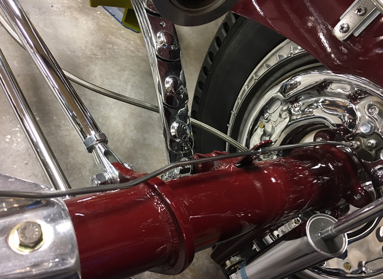

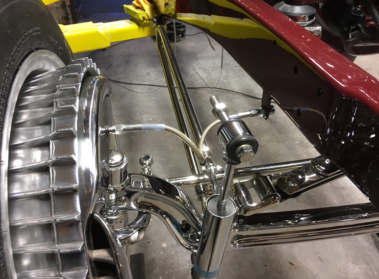

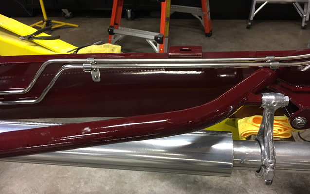

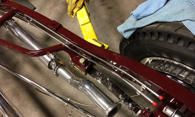

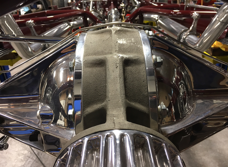

    Here is some more brake line progress. To keep the job from becoming monumental and overwhelming I brake (pun) it down into little parts so I can accomplish something every night. I started by routing the flex line from the frame to the rear axle and then I made the axle line. The empty connecting rods are awaiting the tailpipes that I dropped off at Russ Meeks for a little ceramic coating.
    The line closely follows the QC, mounted on the left and right on brackets I welded to the axle prior to paint. You can see the frame drop line in this pic and the tab it is bolted to..
    A little hop across the top, probably going to make a little bracket up there and attach it to one of those bolts on the QC housing.
    And over to the right cylinder and the tab securing it.
    All polished stainless steel lines and stainless line nuts.

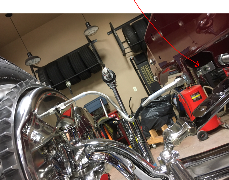

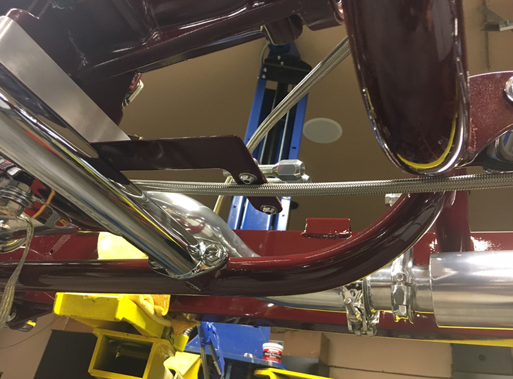

    I also bought a pair of line adapters for the front brakes so I could use a 3AN flex line to the tabs I welded under the frame.
    You notice I welded the tabs on the outside edge of the frame where most guys add them on the inside. I did this because the line has to run under the left rail until it p***es the steering box due to my bolt in motor mounts. I bought a clever little tee that attaches (3/8 inverted flair) directly to the adapter that clips into the frame. It shoots the line straight down the underside of the rail and tees it directly over to the right wheel.
    I am thinking about adding some gravel guard on the line that runs below the rail. If you didn't know where the tee was you may never find it.
    You see that Teflon pad on the spring that looks like it about to fall out? I am thinking about putting a little dab of black RTV on there and sticking it where it belongs. It only does that when the suspension is hanging but it is annoying me.
