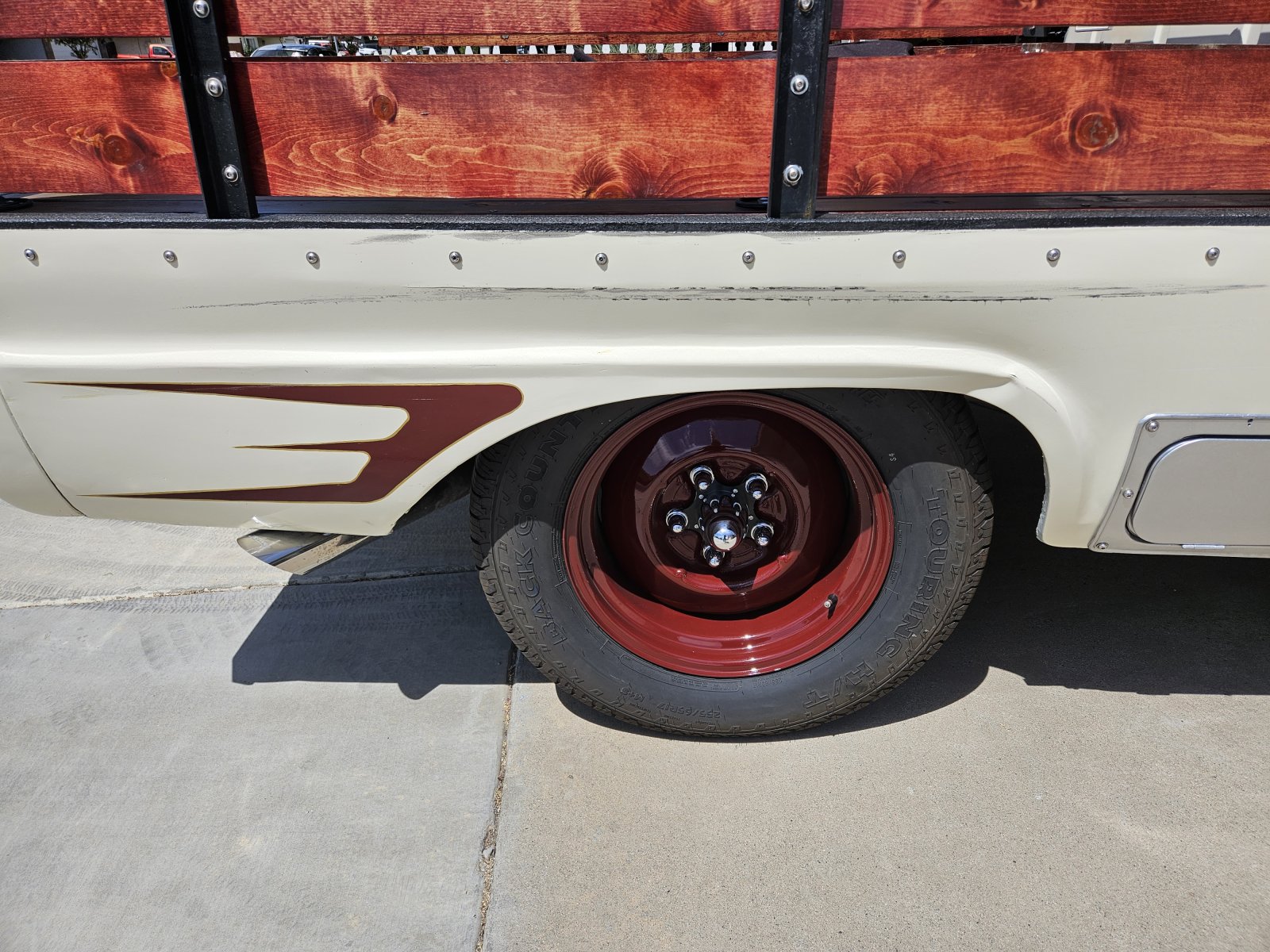

    Here's why I didn't want a skillion dollar paint job...
    Driving down the street minding my business, and a kid pulls put in front of me from his being parked on the roadside. Took evasive action but it wasn't enough, I reckon. Ol' Furd got tagged on the right rear quarter.
    Coulda been worse. Hopefully the kid driving the other vehicle and his parents do the right thing.
    Otherwise, it's a few hours work, and thankfully, I have some paint left over.

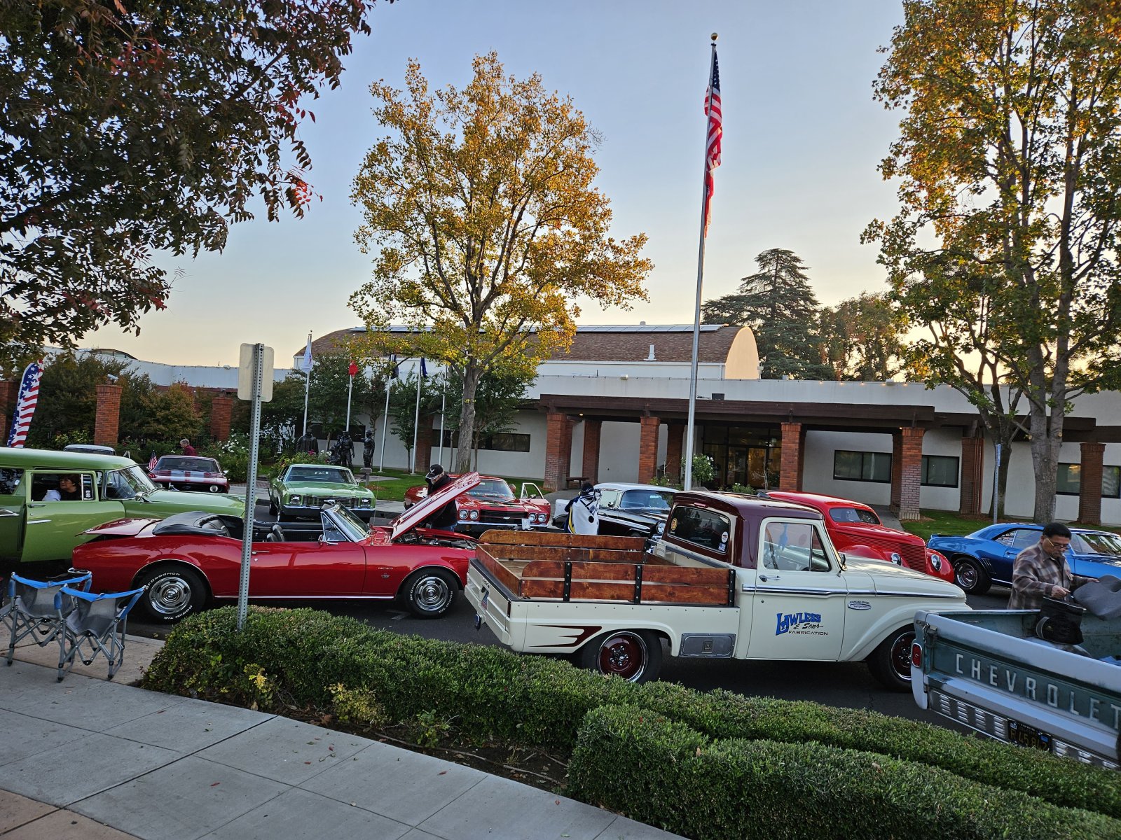

    Been about a month since the last update.
    Power steering has worked itself out for the most part. But when I cinch down the lower column mount, i still get some notchiness. I'm certain the rag joint I have has some run-out and causing some binding. Gotta figure out something for that. Maybe a u-joint, and swap out the stock column bearings for a good set of ball bearings. The bottom one is easy. The top one is gonna require some figurin'.
    But, she's running really nice. I added a set of blingy trim rings. That dark maroon along with black tires needed a bit of contrast between 'em. I like 'em. Anyone that don't doesn't need to look at 'em!
    Photo from the Friday Night Hot Rod gathering at a local church. Even the '37 Chevy and the elco has 'em.
    I'm liking these informal gatherings more than full blown car shows. A couple hours, fabricating stories with friends, and for a small donation, hamburgers and hot dogs are served. No awards, no judging. Just like minded people hanging out.

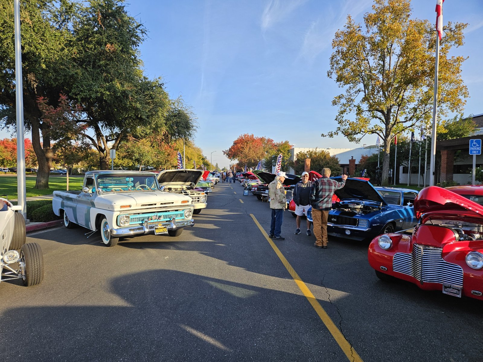

    Ol' Furd at the Veterans Car Show at the Clovis Veterans Memorial.
    Pretty cool being with fellow vets on this day!
