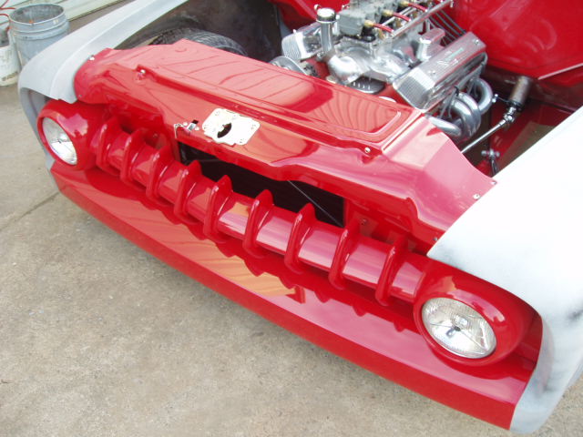

    $350.00 delivered with the ***le. 1989. There was paint under the rust. A solid body. Today still not done. Isn't going to get done. img095.jpg F100 003.JPG F100 005.JPG F100 007.JPG F100 009.JPG F100 010.JPG F100 011.JPG F100 012.JPG

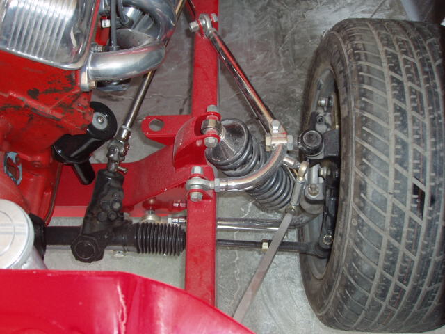

    Today's project was some travel limiters for the front beams. The dropped beams did not have any provision for limiting the down travel, which under some severe cir***stances could allow the front coil springs to fall out. Now, that would not be good at all!
    Even though my "Dukes of Hazzard" days are behind me, I have a trip coming up that entails some dirt roads that have the potential for that scenario.
    So, a couple forged eye bolts, some stout steel cable, some steel flat bar, I rigged some up.
    The test will come this weekend when I go out to an archery shoot with a couple miles of bumpy dirt road.
    brEad, SS327, Thor1 and 4 others like this.

    I thought the shocks were what limits travel. Are they too long?

    I reckon so. The factory beams had limiters. The dropped beams did not

    Shocks will limit travel but leads to quick death of the shock

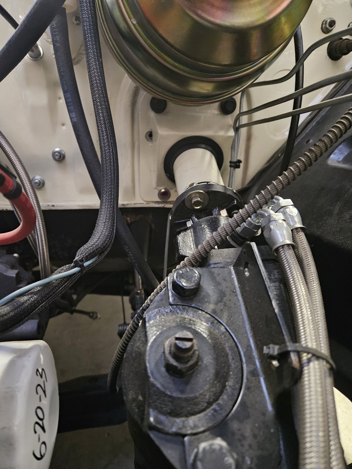

    Since it is purty dang cold these days, I decided to swap out my steering column for an Ididit column with tilt. Not a fan of the factory firewall seal, since to call it a seal would be innaccurate to say the least. It only covers 2/3 of the hole. I don't get it. Maybe the engineers had a reason. Just seems like there was some miscommunication between sheet metal and rubber parts divisions, and they just said t'hell with it. It's just a truck. So, I did what any self respecting hot rod guy would do. I made my own lower column support/firewall seal using a gas filler neck grommet.

  18. There's a reason we keep stuff like the filler gasket. I don't think I will live long enough to use some of mine. :) I like the fact that you dated your filter. I keep my records on a spreadsheet. Having all of the records in one place helps my senility. :)

    That filler gasket was perfect for this! Exact ID needed for the column, and just made the panel to fi the OD!

    A couple months ago, I bought a hinged gas filler door ***embly designed for a later model jeep. It came with the recessed body bezel and filler neck grommet. All I needed was the door for the floor of my bed. The grommet had an ID of 2.25" which is what the steering column is. So it was just a fortunate set of cir***stances.
    Just as an FYI, the factory Ford body grommet has this ID too and is quite a bit heavier.
