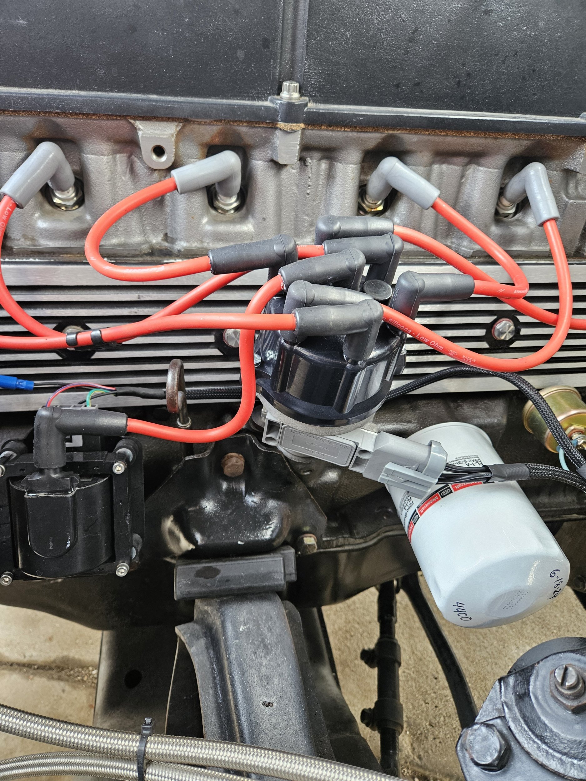

    Thanks @wfo guy
    There is some very knowledgeable people on the Holley EFI FB groups, and I have been getting flooded with idears....mostly about how it make it more complicated, as well as help me spend more money.
    But, because of that, I have some things to try. It's funny you mentioned the aftermarket units vs the Motorcraft units. I bought a Cardone distributor for a 1990. As you can see, it has the module attached to the body of the distributor. The supplied module had cross fire, erratic timing....just wasn't working. My son, who set up the wiring harness and got 'er up and running said it was probably the module, and he picked up a genuine Motorcraft module. Fired right up and ran smooth. At first it showed no timing advance at all. A couple changes to the settings, and it was working normally. Or so it seemed. It was pinging in the low vacuum/high load zones, so we turned the timing down a bit. Later after turning the timing down in the ECU to the point it should have had no more than 25° did I discover that it was still seeing 40° actual timing. I filled the entire table to 12° and then checked actual timing. It should not have seen any advance at all. But yet it did! Idling at the 12° setting but getting to 30° or thereabouts total.
    So now, I have that same 12° table with just a little additional timing in the table in high vacuum/ low load areas. And it works. Now it sees about 35° in the "cruise" area. It runs nice. It seems the is either built advance in the TFI unit, or it's getting a timing input somewhere, somehow through the ECU. I have a another round of things to try before I either learn to live with the ECU just adding X amount of advance to that which is already there, or as you suggested, ditch the TFI module in favor of an external CD box. Whew!
    I think life was easier when I could either just twist the distributor this way or that, and change springs, weights, or advance slots to tailor the timing the old fashioned way!

    A little update on the whole Holley Terminator vs. Ford TFI issue....
    It seems that the Holley ECU does not recognize the Ford TFI in 6 cylinder form. Apparently some sort of "handshake" is required, but one side, or maybe both, won't do that. So, no timing control.
    It runs pretty nice as is. But, (big hairy but) there's just too much advance in the high load/low vacuum areas one would encounter, such as hill climbing. The obvious solution would be to back the timing up. But then idle advance and around town, plus flat highway driving take the hit on efficiency.
    The solution, at least I hope, is a coil driver for a single coil, which would by-p*** the TFI module. A place called DIY AutoTune has this coil driver, actually made in the US.
    I can pretend I know what this is all about. But that would be just that. Pretending. My son, who does this stuff for a living has researched this, and will do the wiring an initial set-up. He says we WILL get timing control. Hopefully that is the case.
    Once we have control, I can tailor the timing events to drop timing out in the "Ping Zone" while keeping it where it likes to be in the other areas. That part is something I can do my own dang self.
    But, just in case, I was able to find a rebuilt single point distributor. I will put that in my "Road Trip Box" so in the unlikely event of a failure somewhere deep in BFE, I can get going again.

    Finally a solution on the whole Holley EFI/Ford TFI episode! My son came up with, and found the single channel coil driver module. He came by last weekend and wired it into the system. The kid (42yo) really knows his stuff! Very little intrusion into the existing wiring harness, and it looks as neat and tidy as it did before. The existing TFI module on the side of the distributor is still there and acts only as a convenience connector to the pick-up module inside the distributor.
    After getting it wired up, the Ol' Furd fired right up, and we went through a few steps to get the actual timing sync'd with the ECU. I now have timing control!
    Took 'er out for a ride in the Sierra foothills the other day, and put 'er through different scenarios, with wifey writing down info the old fashion way. I coulda done a datalog, but this way was easier for this old coot.
    The most heinous test was lugging 'er up a 12% grade at 45mph in 4th gear. She didn't like that much and there was just barely audible pinging, 1500 rpm, 27° timing and 95Kpa manifold pressure. That is akin to about 2 or 3 inches of vacuum. I certainly won't intentionally do that again, but it is comforting to know the limits anyway!
    That wraps that project up, except for fine tuning. So, bring on some road trips! AMPmodule.jpg
