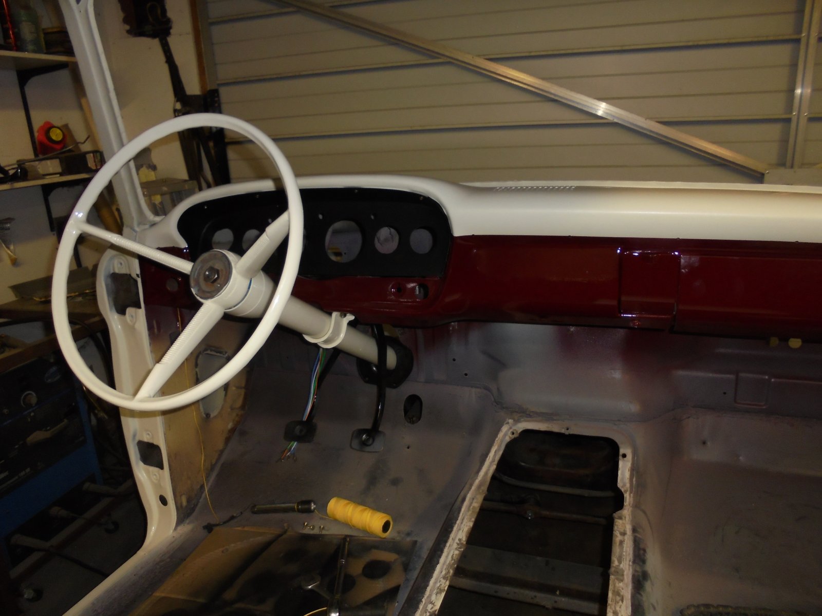

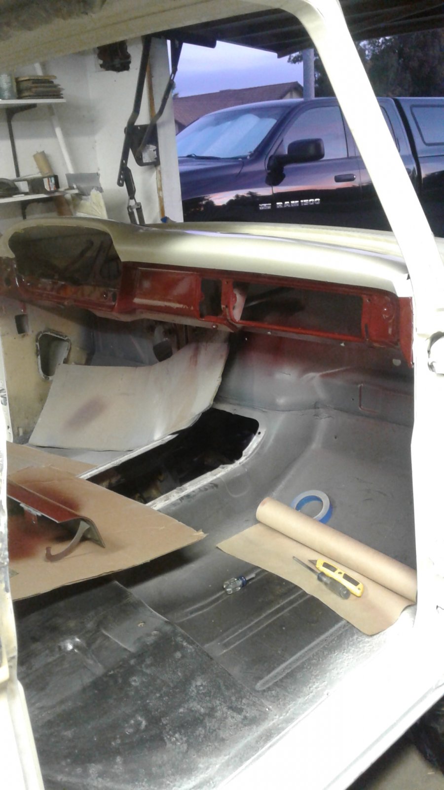

    I continued on with interior paint this morning way before the sun came up. I painted the bottom of the dash below the trim line with a nice deep maroon that goes well with the wimbledon white.
    But, I screwed the pooch when my paint gun started giving me fits. I shoulda walked away and fixed it, but instead tried to compensate and got a big-*** run for my trouble.
    Serves me right for trying to rush it.
    So, wait, sand flat, begin again. It's just a bit of work. Nobody died.
    But, I LOVE the color combo!
    I'll put photos up when I'm worthy. Right now, I'm not worthy

    I managed to get quite a bit done this past weekend. The interior paint is done! I decided to "Two-Tone" the dash, just so it wouldn't be all white inside. The second color is maroon, and my steel smoothie wheels will be that color too.
    And with that, I needed to turn my attention to stuff that needs to go into the cab so that wiring can commence.

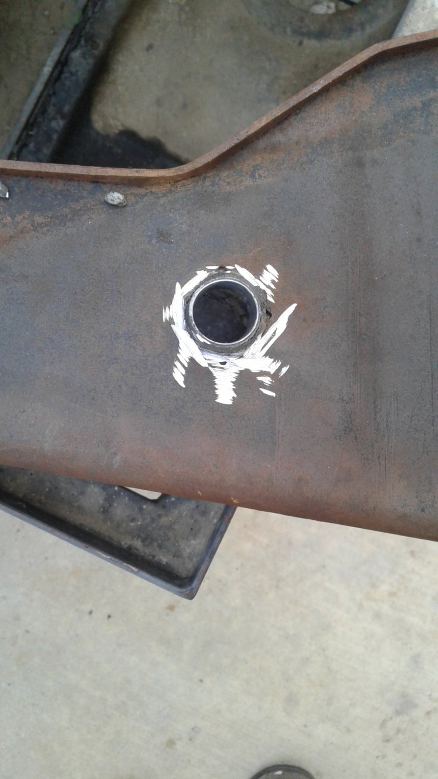

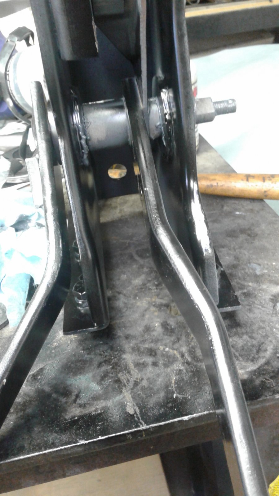

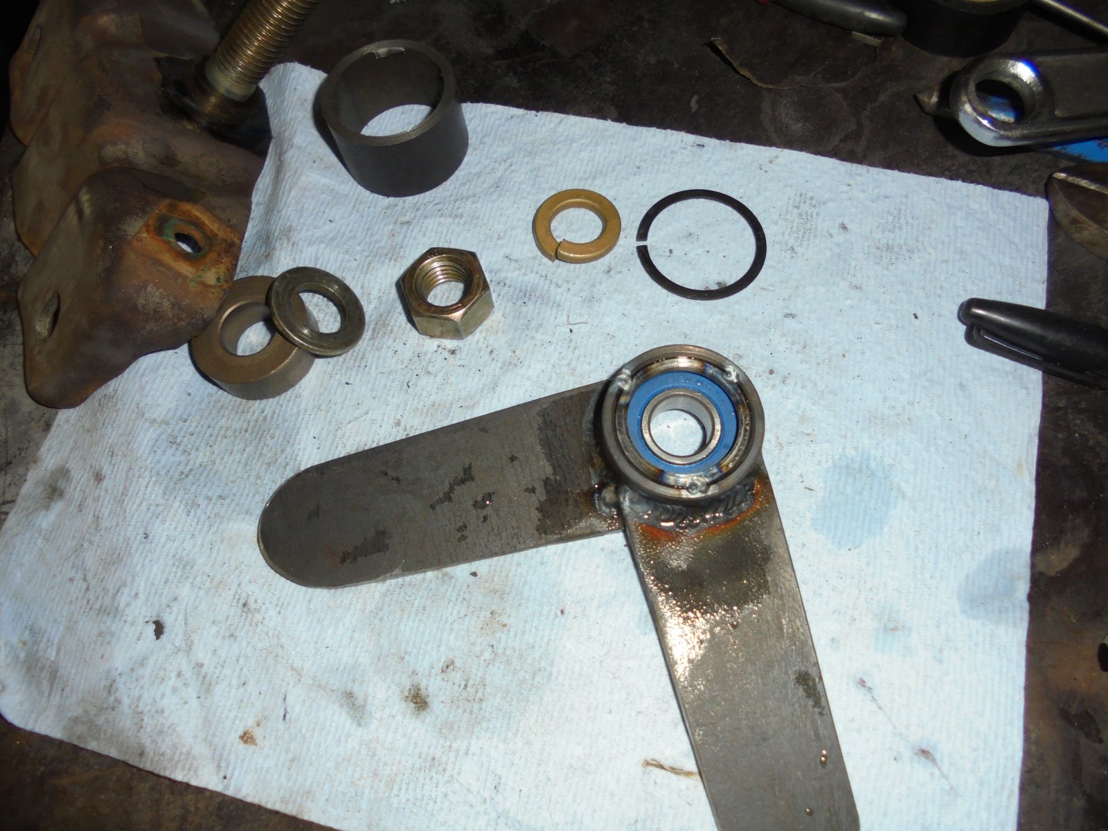

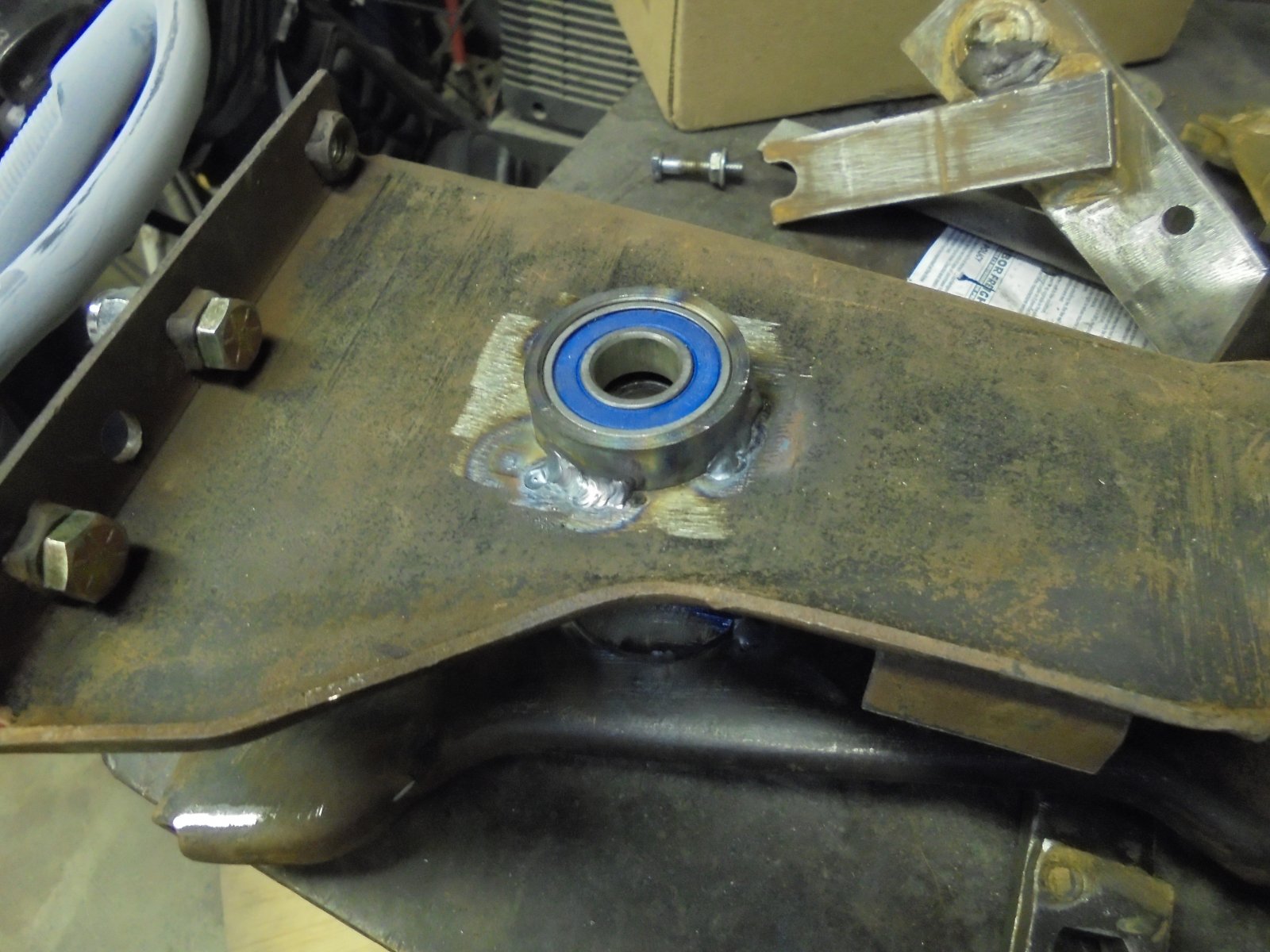

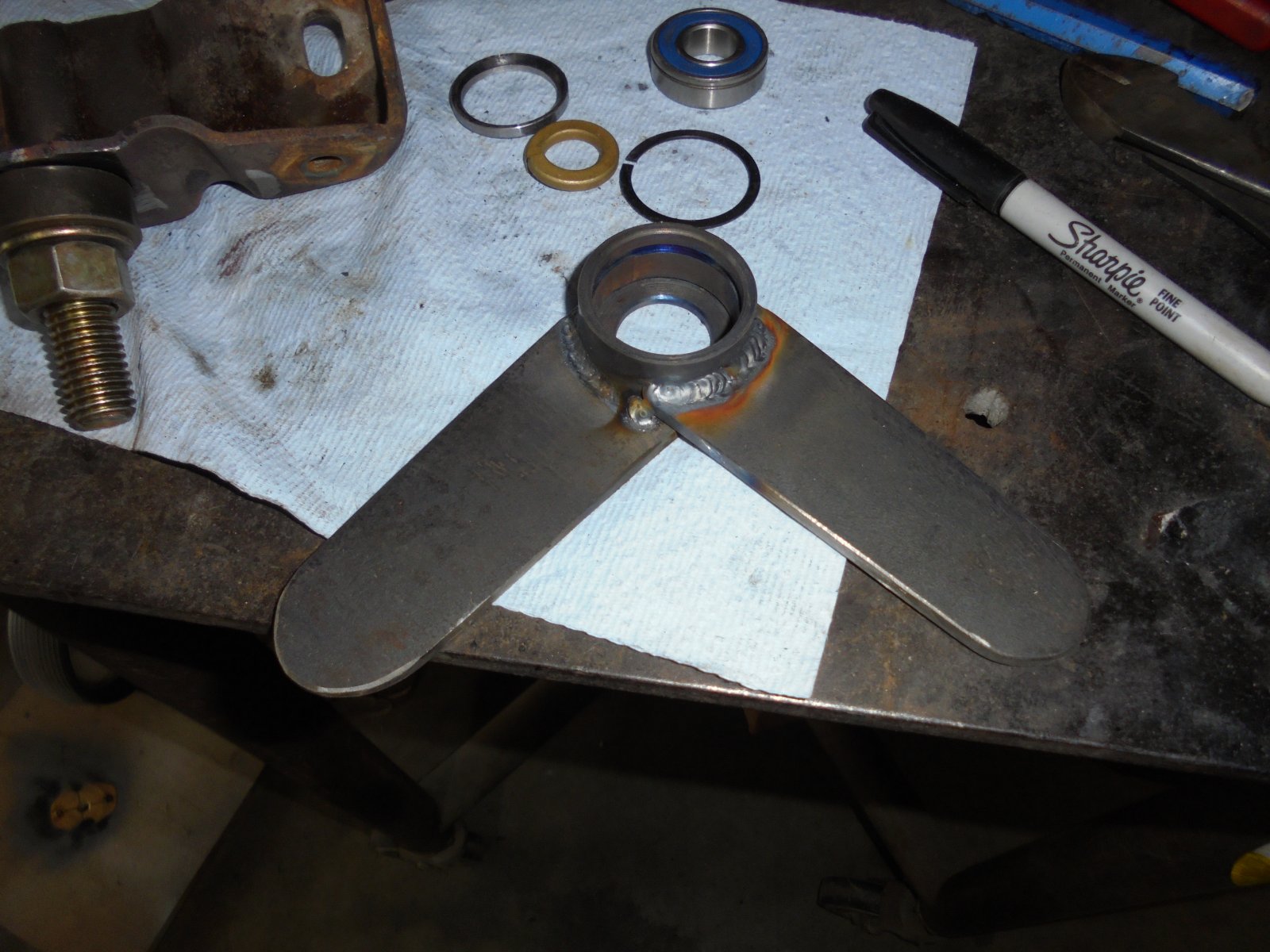

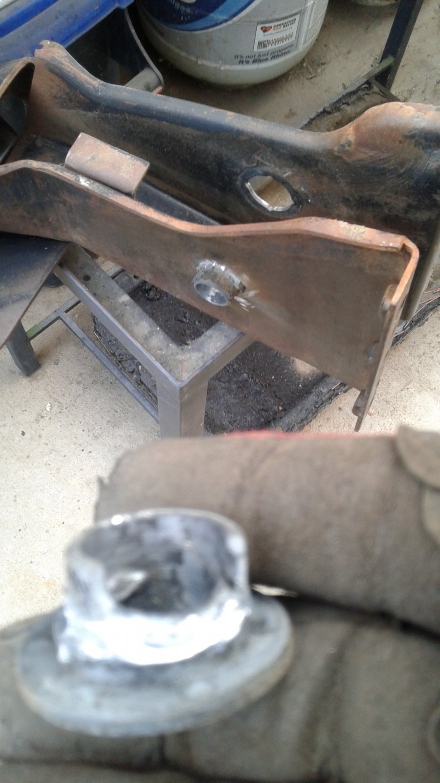

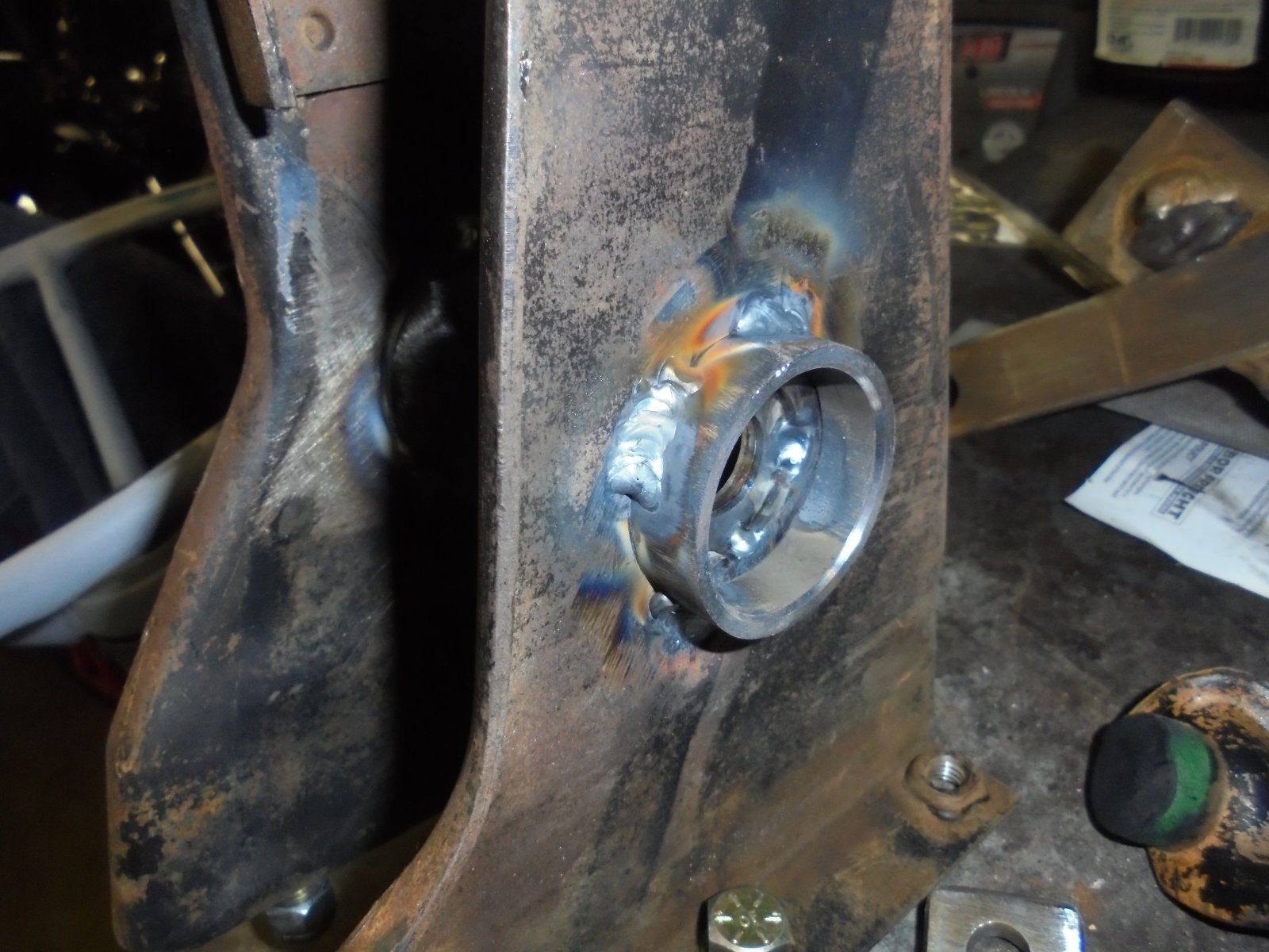

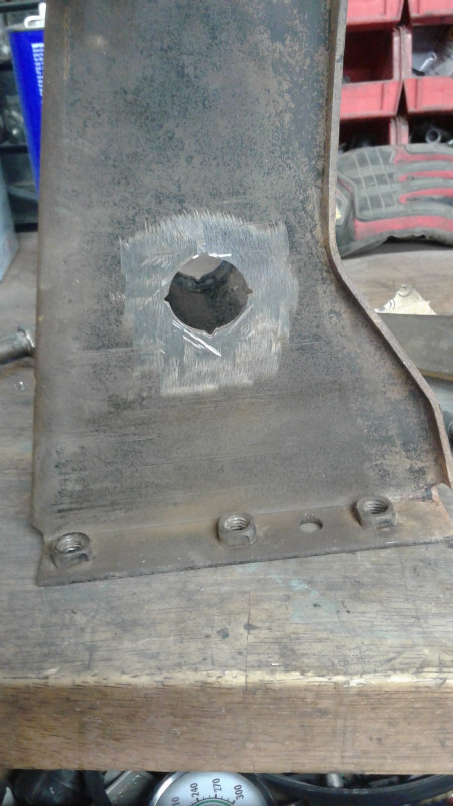

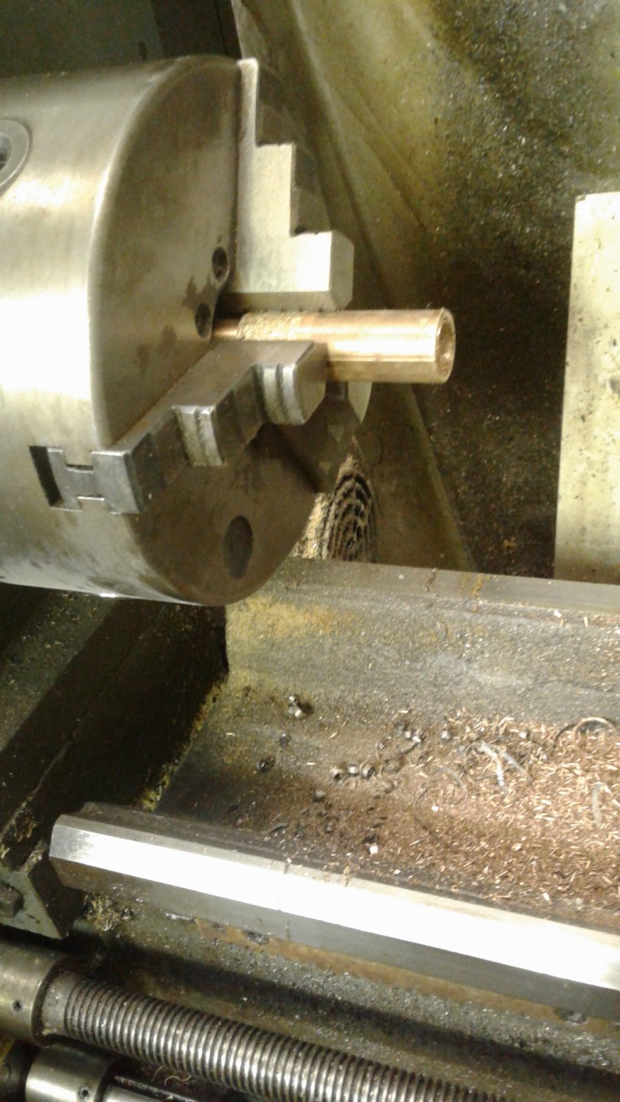

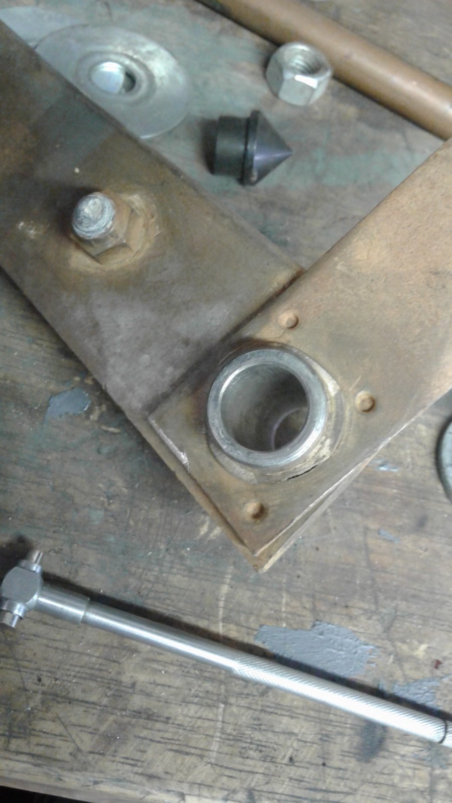

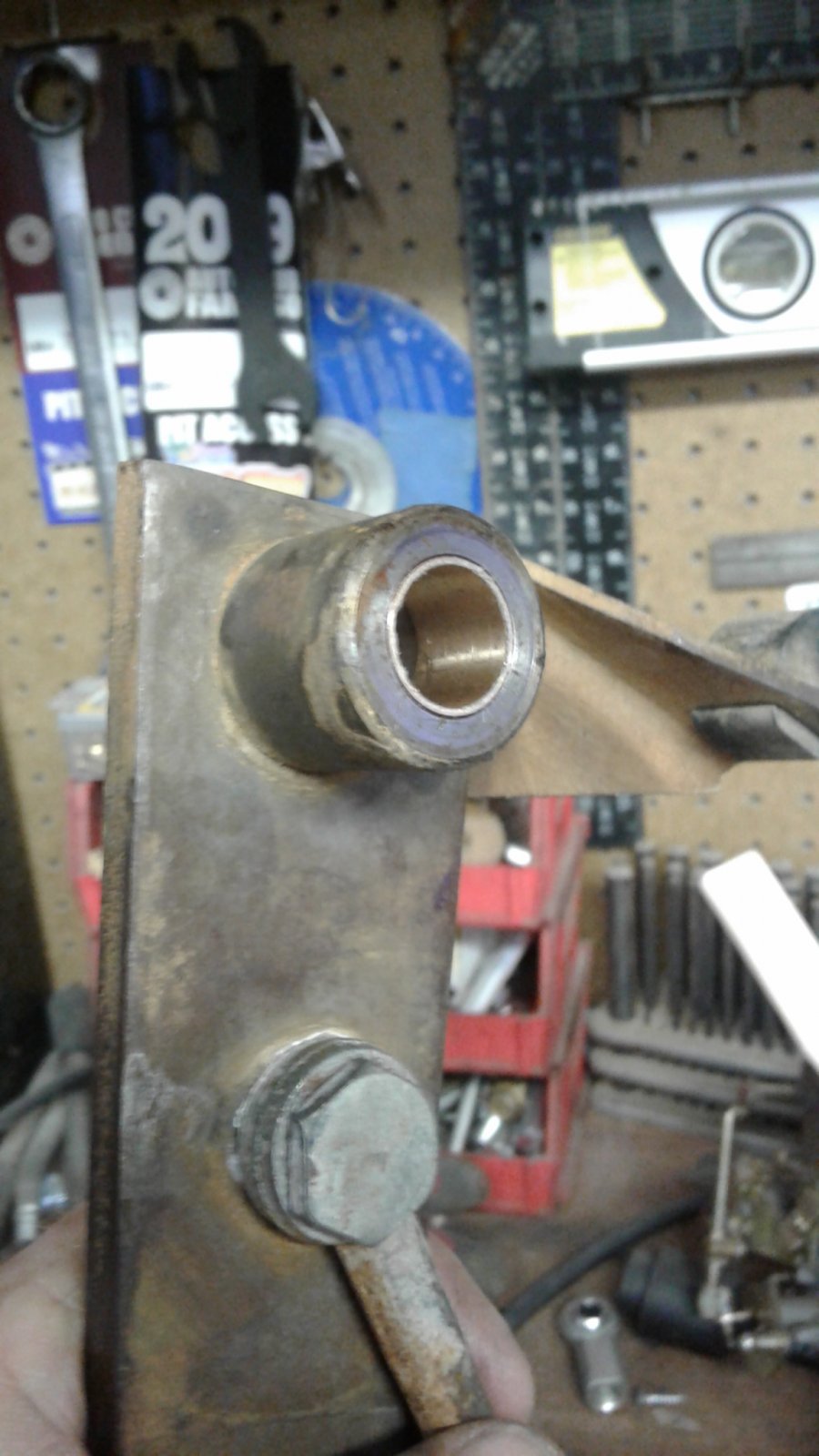

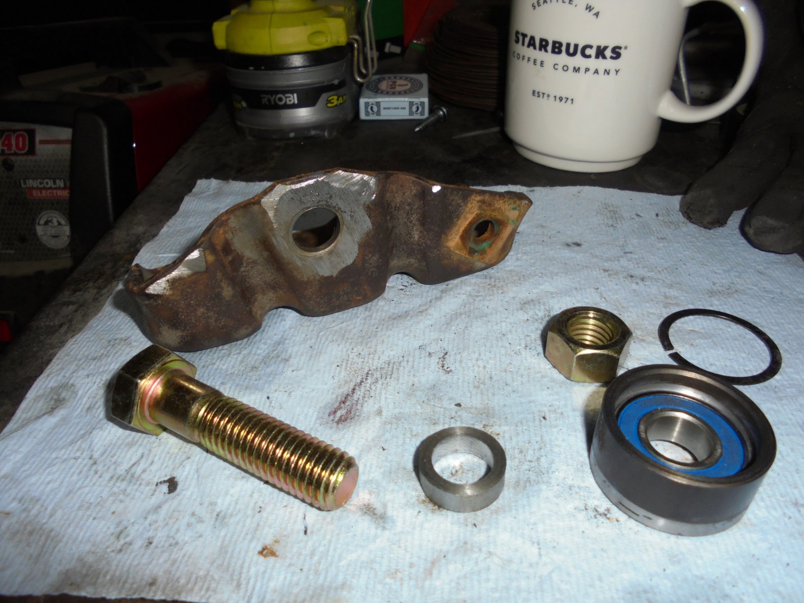

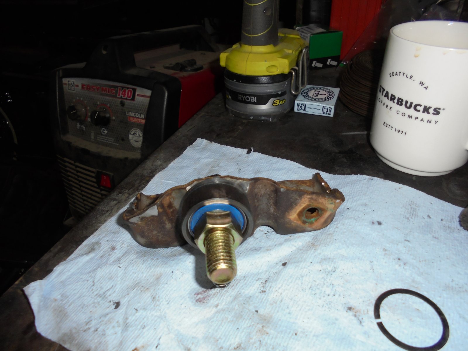

    First up is the pedal cluster. The pot metal bushings were all wallowed out. I had read a post on the ford trucks forum about someone who had done a ball bearing conversion based on a kit from "Mustang Steve". The kit replaces the pot metal bushings with sealed ball bearings. Sounded like a solid idear! And I'm not above stealing good idears fair and square.
    So, being a cheap ******* with a b!tchin' set of tools, rather than buy the kit, I am making it myself to fit this particular pedal cluster.
    First, hack out the old bushings. Grind off the peened over tabs and they pop right out. Next, brake pedal bushings. I know I coulda bought stock style plastic bushing for next to nuthin'. But then I'd have to wait.
    I won't wait as long as I have bronze oil-lite bushing material in stock! So, I turned a set of bushings on the lathe, and pressed 'em in. And what d'ya know! The clutch pedal shaft slides right in!
    I have the ball bearing retainers cut already from material I had in stock as well, but I had to buy the bearings to fit them up and get 'em welded to the pedal bracket. The bearings should be here soon. Since they came in a pack of four bearings, I will also use one of 'em for the clutch linkage bellcrank I'm making (stay tuned for that) that uses the stock pull rod in the stock location, using most of the stock frame bracket to mount the bellcrank, and putting the hydraulic master cylinder on the frame rail under the cab. It'll be a remote reservoir, and the reservoir will mount up on the firewall. This will operate a hydraulic throwout bearing inside the bellhousing, which does away with the stock throwout bearing arm. Hopefully, this will make the clutch pedal effort easy and smooth. I built the hydraulic linkage system in my drag race VW, and it is incredibly smooth. It's really all about getting the linkage geometry right.
    More on that later.

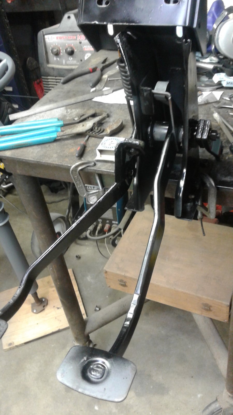

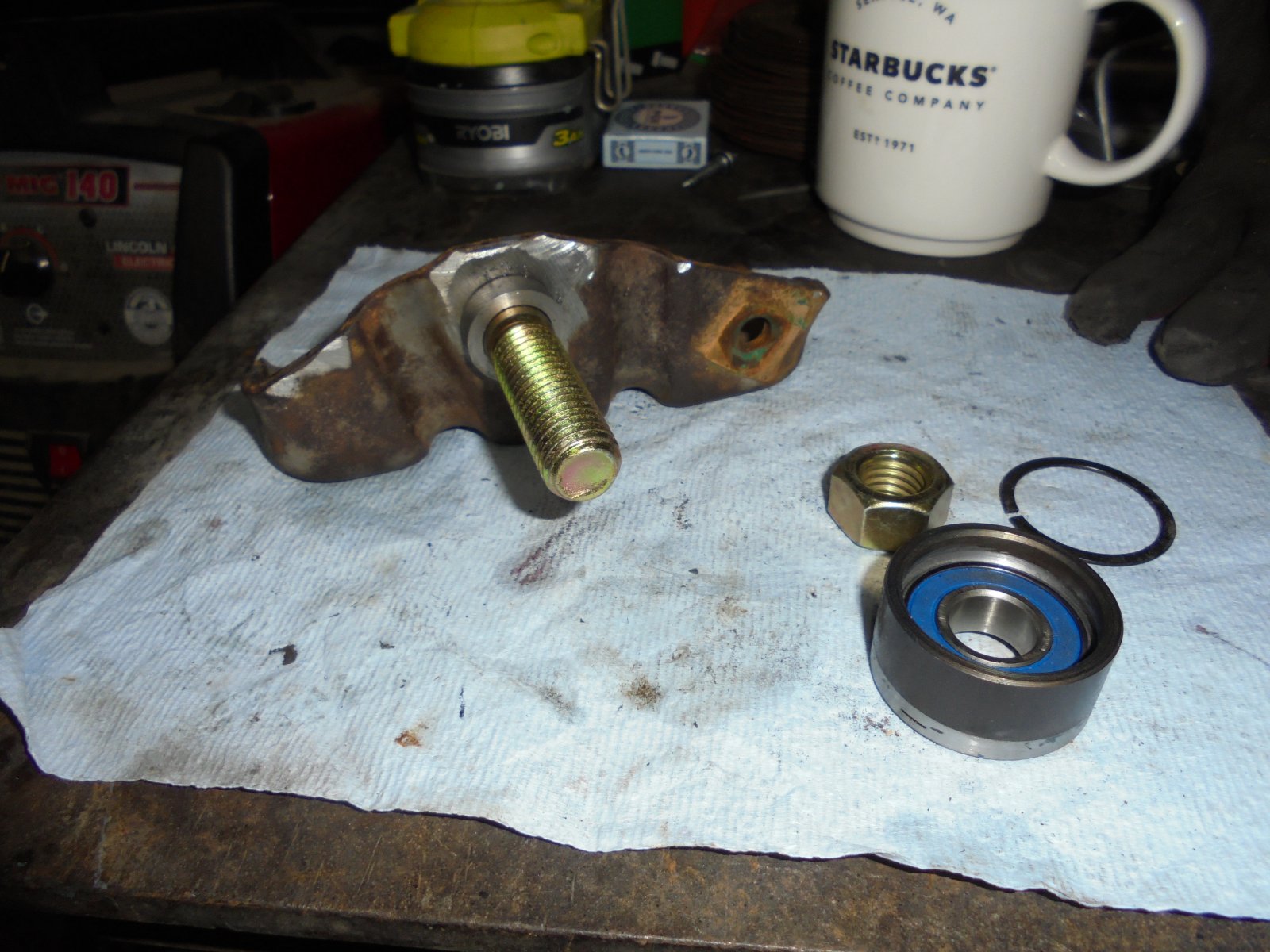

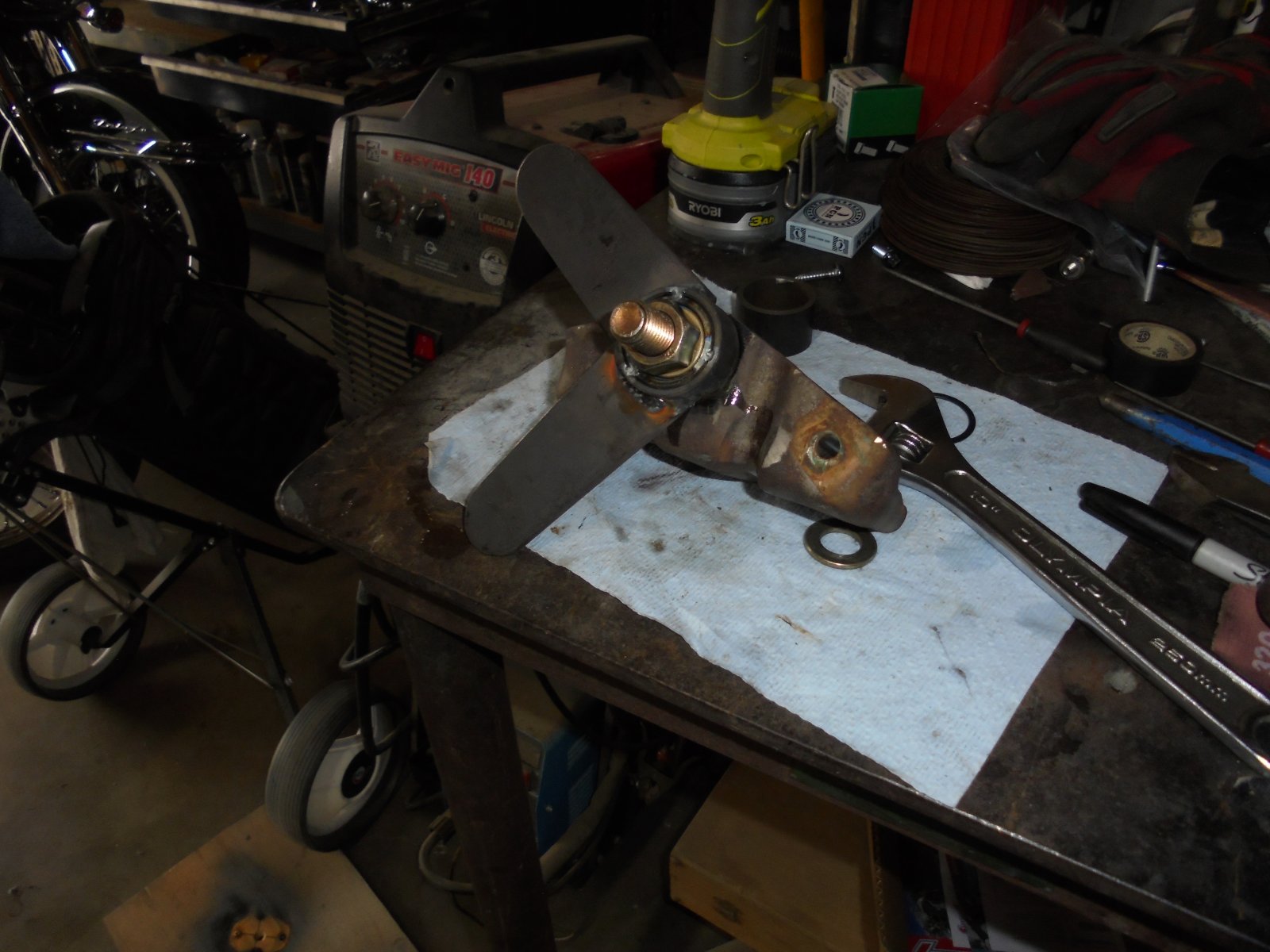

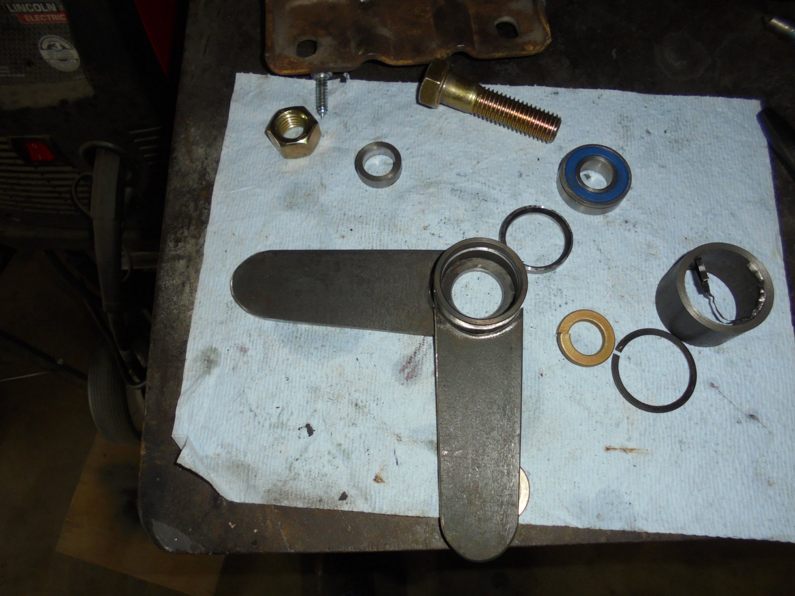

    The ball bearings I was waiting for to finish up the fab work on the pedal cluster arrived. So I set the bearing retainers up and TIG welded 'em on.
    So, with that stuff complete, I can squirt some primer on and paint everything, and get it all ***embled and into the truck.

    I like that you put bearings in the pedals.... Great idea
  8. Mike Lawless
    Joined: Sep 20, 2021
    Posts: 741
    Mike Lawless
    Thanks. Not my idea. The idea was stolen fair and square!
    I will say that after the trial fit of everything, it was very smooth and friction free.
    The pull rod bellcrank that will actuate the hydraulic master cylinder will also be on a bearing like that and the pullrod itself will have spherical rod ends, rather than the end of the rod bent over and shoved into a hole.
    I want the clutch effort to be light enough for my wife to drive it.

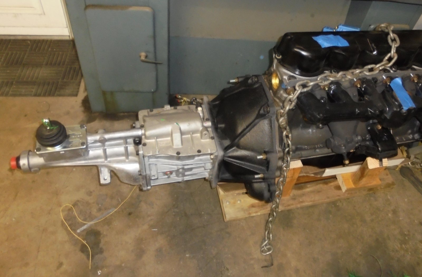

  9. F-ONE
    Joined: Mar 27, 2008
    Posts: 3,715
    F-ONE
    from Alabama
    You may want to rig up some kind of support for the front of that engine. More than one of these has broken at the bellhousing. The more stuff you bolt on front, the more leverage against the bell area. Just be aware, and be real careful not to jar it moving it around the shop.

    Someone else mentioned that too. Yeah, it was getting a bit bouncy!
    Not long after that photo I had moved to a wheeled dolly so I could get the flywheel, clutch and bellhousing on. So now it's sitting close to the ground, supported at four corners at the motor mounts and just in front of the bellhousing area.
    It's almost ready to back into the ch***is!
    Thanks guys fer lookin' out!

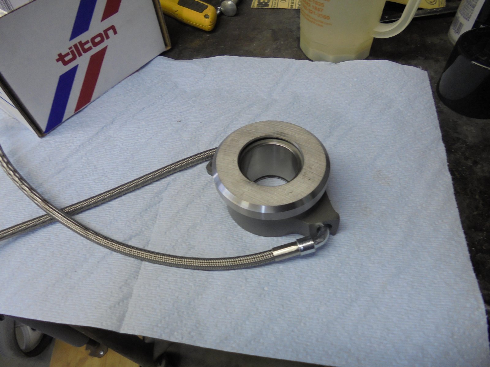

    Well, we had ourselfs a little set-back today. I had ordered up a Howe Hydraulic throwout bearing for my Tremec T5. The one that was shipped was NOT for a T5. So, I sent it back. Five days later, I call to find what's up, and they are getting ready to ship the one that fits a T5.
    But wait! After just a bit of checking, I found out that throwout bearing only fits a GM T5. Damn. I thought a T5 was a T5. Seems the input bearing retainer sleeve diameter on a GM T5 is smaller.
    So, I call back....STOP THE PRESSES. NEWS FLASH!!! Cancelled the order just as it was being packaged to ship.
    I did find one that did fit. Aaaannnddd it figures. It's more than double the money.
    Dang, dang, triple dang.

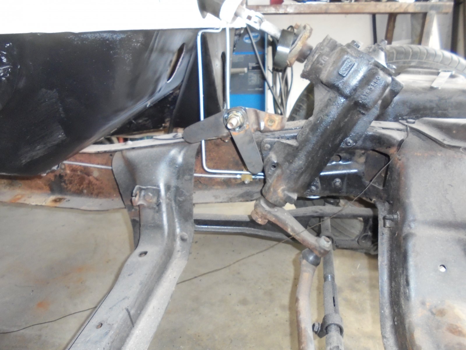

    Back to the pedal cluster. Got the pieces and parts all painted up, and got the ***embly....re***embled. So, into the truck it went.
    So from pictures perhaps you can see how the pedals go together. The clutch pedal has a shaft those goes through the bracket, and that is what rides on the ball bearings. The brake pedal has bronze bushings, and rides on the shaft. The shaft protrudes on the right side of the bracket and the clutch actuating arm attaches to the end and is held on with a nut. When the clutch pedal is pushed with the foot, the actuating arm pulls up, rather than pushing down. Seems kinda b***-ackwards.
    So now I need to make up a pull rod that will use a spherical rod end on each end. That will attach to a bellcrank on the frame rail and actuate the master cylinder under the cab.
    And now I can finish plumbing the brakes!
  20. Mike Lawless
    Posts: 741
    Mike Lawless

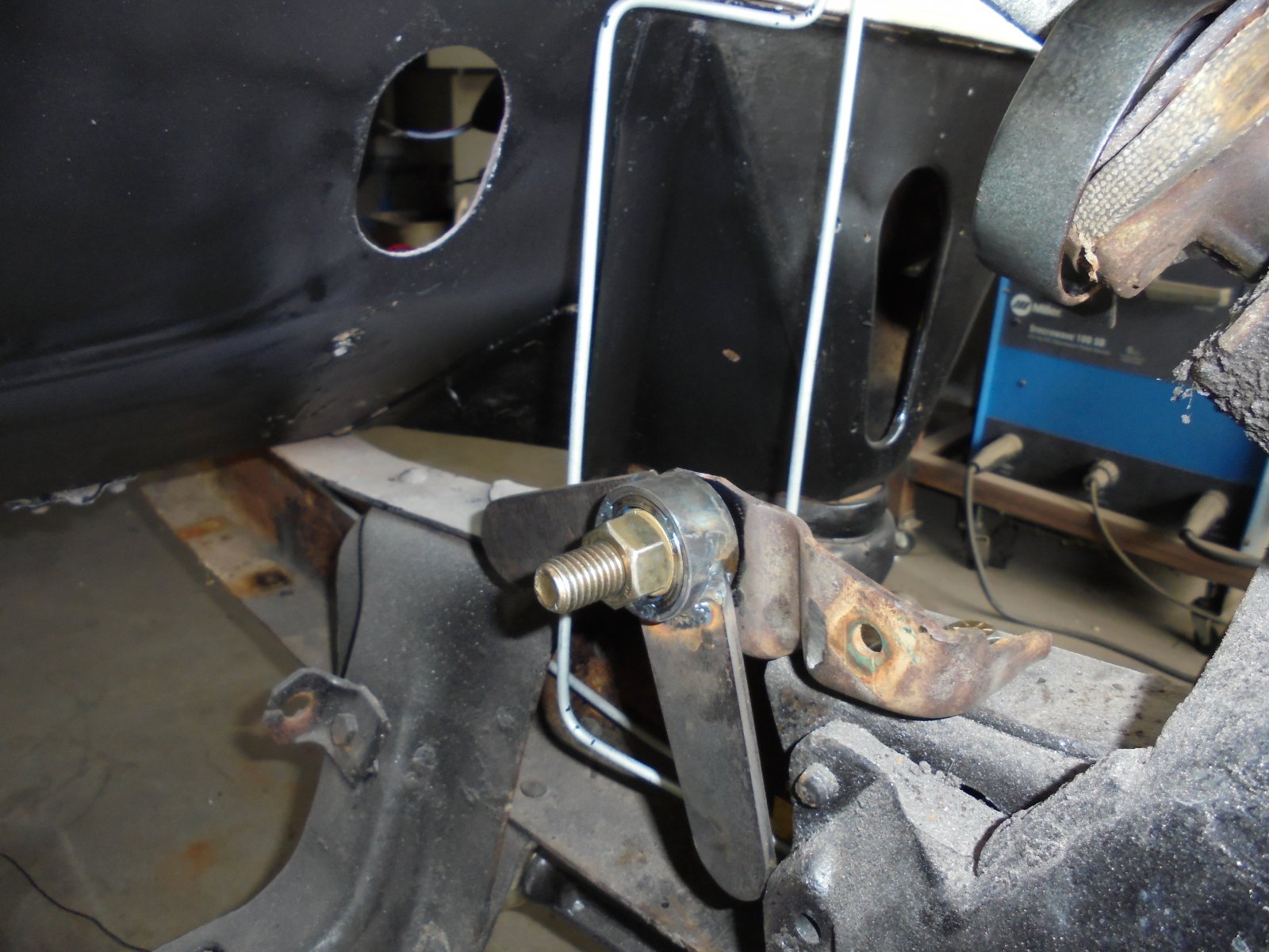

    This last weekend, I got the pedal ***embly installed, and on the photo, you can see a spherical rod end on the end of the clutch arm, along with a line going down to the floor opening for the stock clutch pull rod.
    I'm not gonna reinvent the wheel so to speak here. Merely a refinement of factory. I see most people who convert to hydraulics come up with some elaborate linkage arrangement to put the clutch master on the firewall next to the brake master. WAY too much unnecessary engineering, with firewall reinforcement, extra bracketry under the dash...
    I've decided to try a simpler approach.
    The stock linkage rod pulls up. The factory Z-bar has a nice reinforced bracket on the frame rail. I'm gonna use that bracket and where the stock pull rod attaches to that, the only difference from factory is that the bellcrank and pull rod will be on bearings rather than bushings, or the bent end of a rod shoved into a hole. The bellcrank will rotate on a ball bearing and it will act on the clutch master mounted on the side of the frame rail under the cab, with a remote reservoir up on the firewall. Easy.
    The clutch master will attach to the Tilton hydraulic release bearing in the photo via short -4AN lines. Right through the stock clutch fork window. So all that friction, from the pedal shaft, through the pull rod, the bell crank and the master pushrod will be on bearings, and the stock clutch fork is eliminated. No more clutch adjustments will be necessary, as the hydraulic release bearing is self adjusting.
    Hopefully it all works out as I have envisioned.

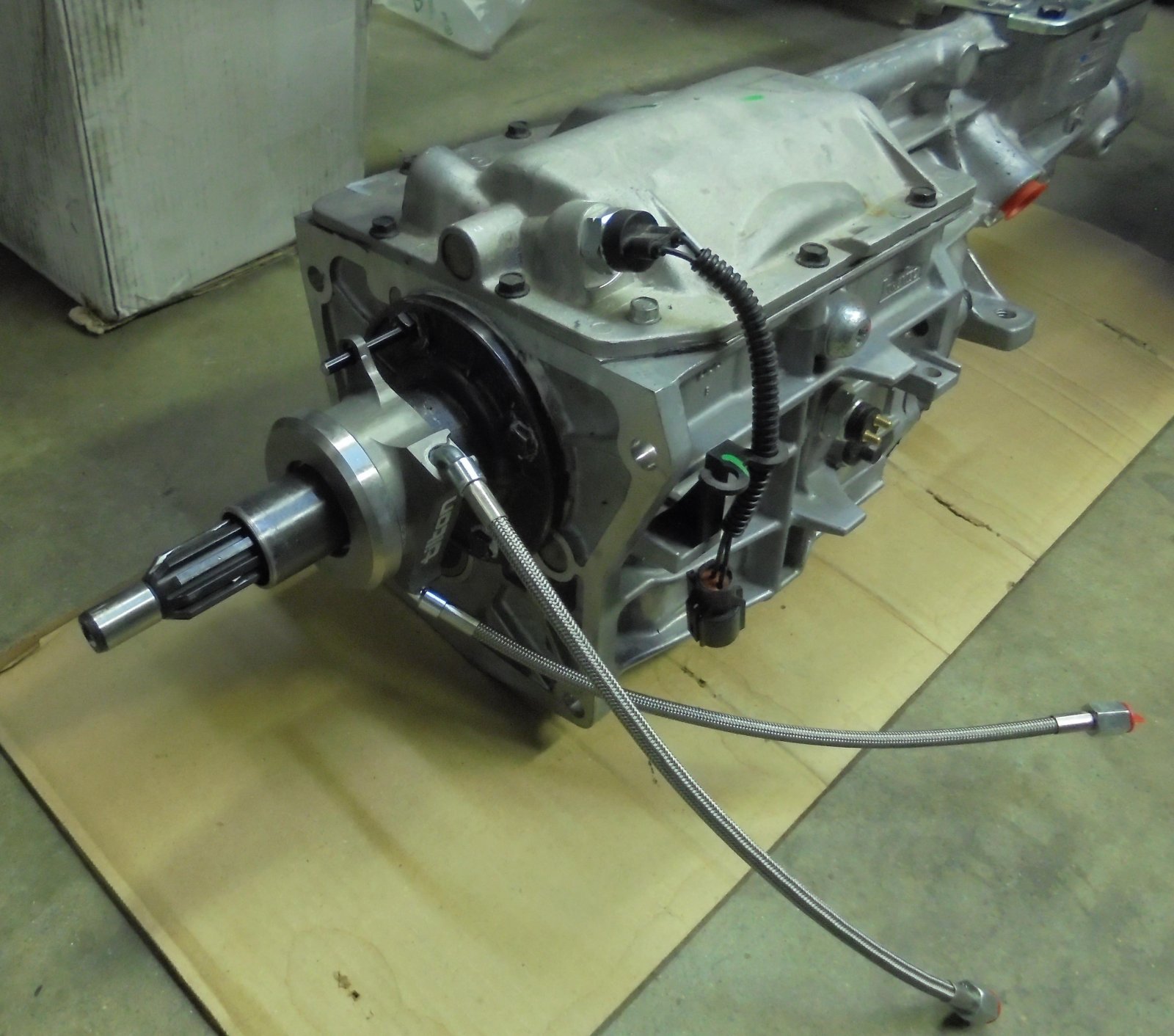

    And, my home built T5 trans adapter worked out perfectly!

    Stuck at home today while we get solar panels installed. Nuthun' much to do but knock some clutch stuff out. Dang it! :D
    I had the bellcrank bearing holder already cut a couple weeks or so back. Same stock as the pedal shaft bearing holders. I knocked out the stock Z-bar pivot from the frame bracket, and welded a 5/8" bolt in it's place. Then, a couple pieces of 3/16" plate were cut for the arms and TIG'd to the bearing holder. Let that cool a bit, and then made up a little bearing retainer ring that will keep the bellcrank bearing in place. I didn't wanna put too much heat into it so a little spot weld in three places. Won't be too much trouble to cut the welds if the bearing ever needs to be changed.
    90° between the two arms will do nicely to change direction. I just have to figure out the "gearing" so to speak. For that, I'll need to make up the pull-rod from the pedal cluster to the rearward facing arm and then figure out where to drill that hole. After that, I'll need to have the actual master cylinder on hand to figure out how much actual "push" it needs, as well as the best mounting location. That mount location should be just behind the crossmember as seen in the photo of the bellcrank installed. As it turns out, the steering box makes a convenient "stop" for the bellcrank!
    Just a little bit of measuring and some basic math. Soon, I can check this one off as "DONE!"
    Also got the steering wheel and column painted with urethane single stage. Same Wimbledon white as the upper part of the dash.
    DSC01440.JPG DSC01441.JPG DSC01442.JPG DSC01443.JPG DSC01444.JPG DSC01445.JPG DSC01446.JPG DSC01447.JPG DSC01448.JPG DSC01449.JPG So far, Mikey likes! A leather s***ch on cover will go on the wheel when the finish work is being done.
