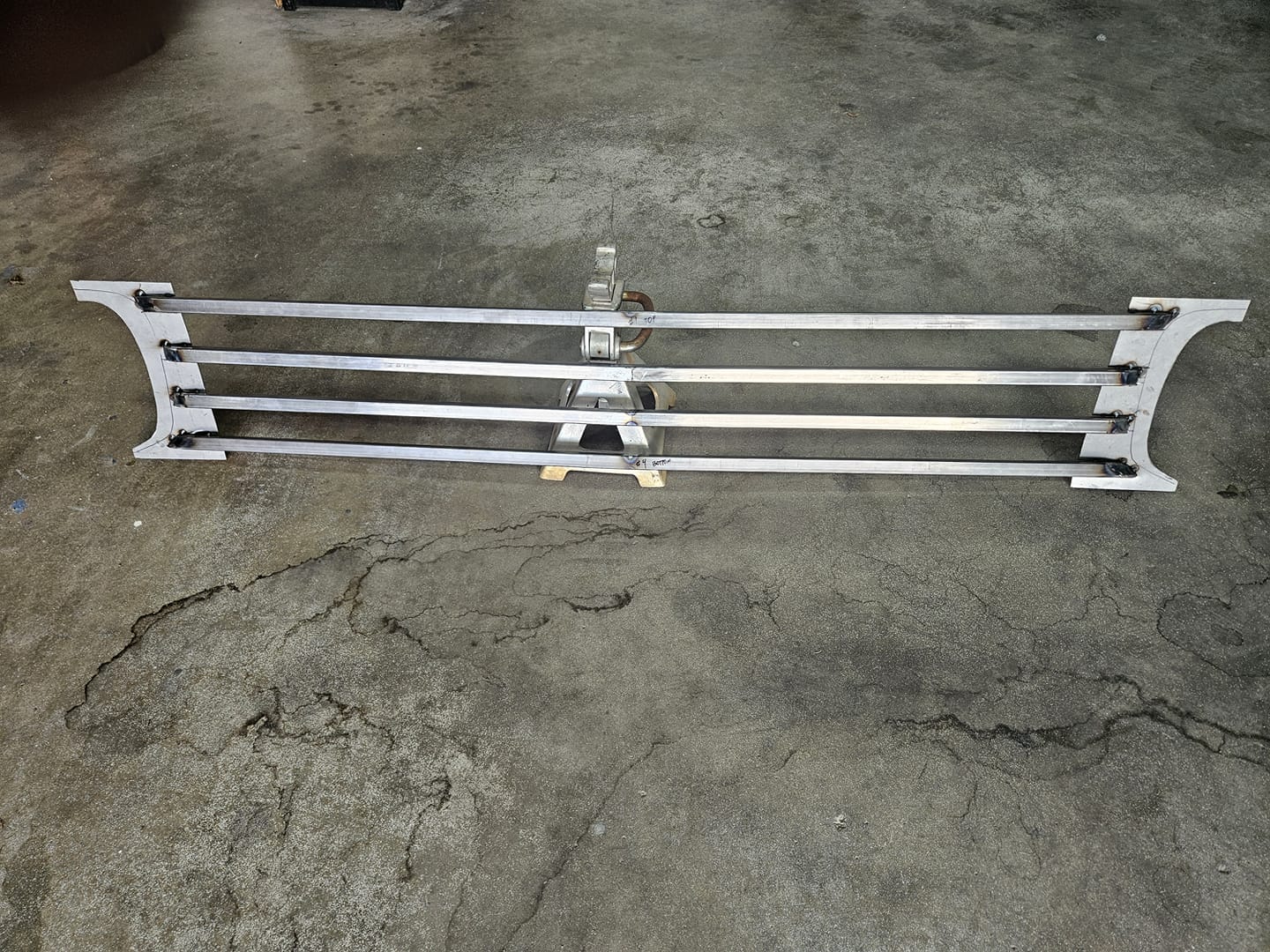

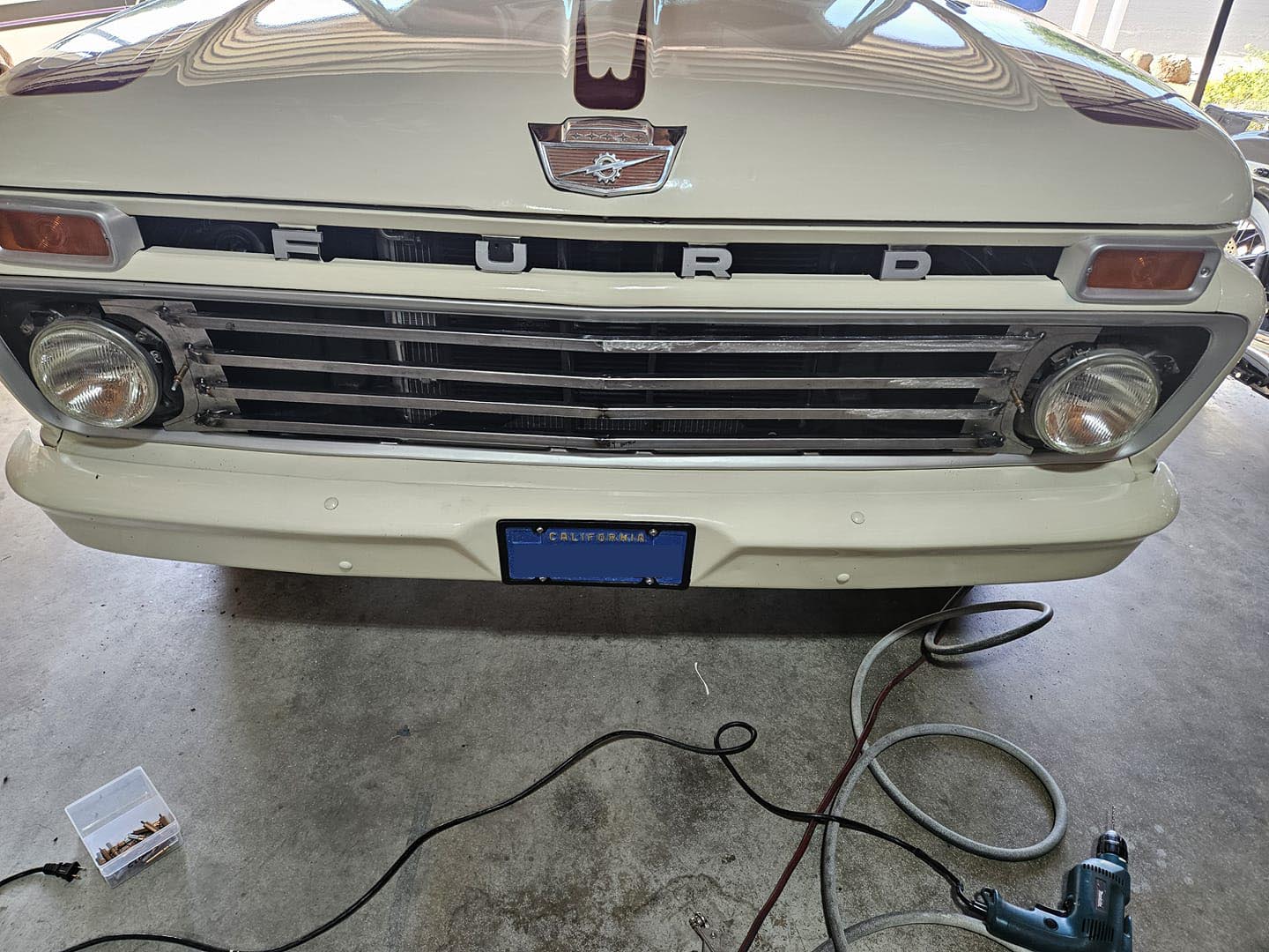

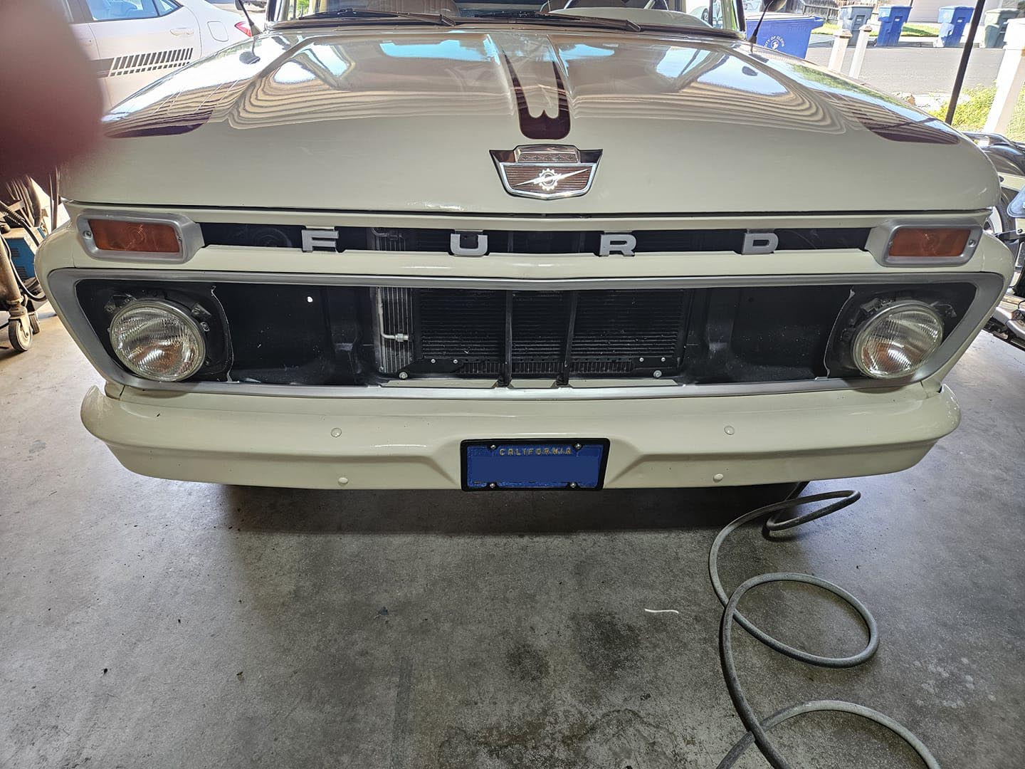

    On to the next refinement. Strictly aesthetic. But, it's been buggin' me since I got Ol' Furd on the road. If you would kindly refer back to post #168, you would see the section of grill that a previous owner had cut out. Cam swap? I dunno. I kinda scabbed it back together with pieces of aluminum, pop rivets and epoxy, then painted it. For a driver it's fine. But, it's been on my mind ever since. Repop grills are available. 1966 model style. Which is fine, but at well over 800 buck plus oversize shipping...too rich for me. Used ones pop up occasionally. But I haven't seen one local for less that $300, and even those need work.
    So, for $50 in materials, and about 15 hours of my own labor, I have something I think is nice. I used a 1963 year as a reference.
    I used the existing perimeter, and built an inset from 16ga (.065" wall) steel tubing, then painted it to match.
    Behold the result...

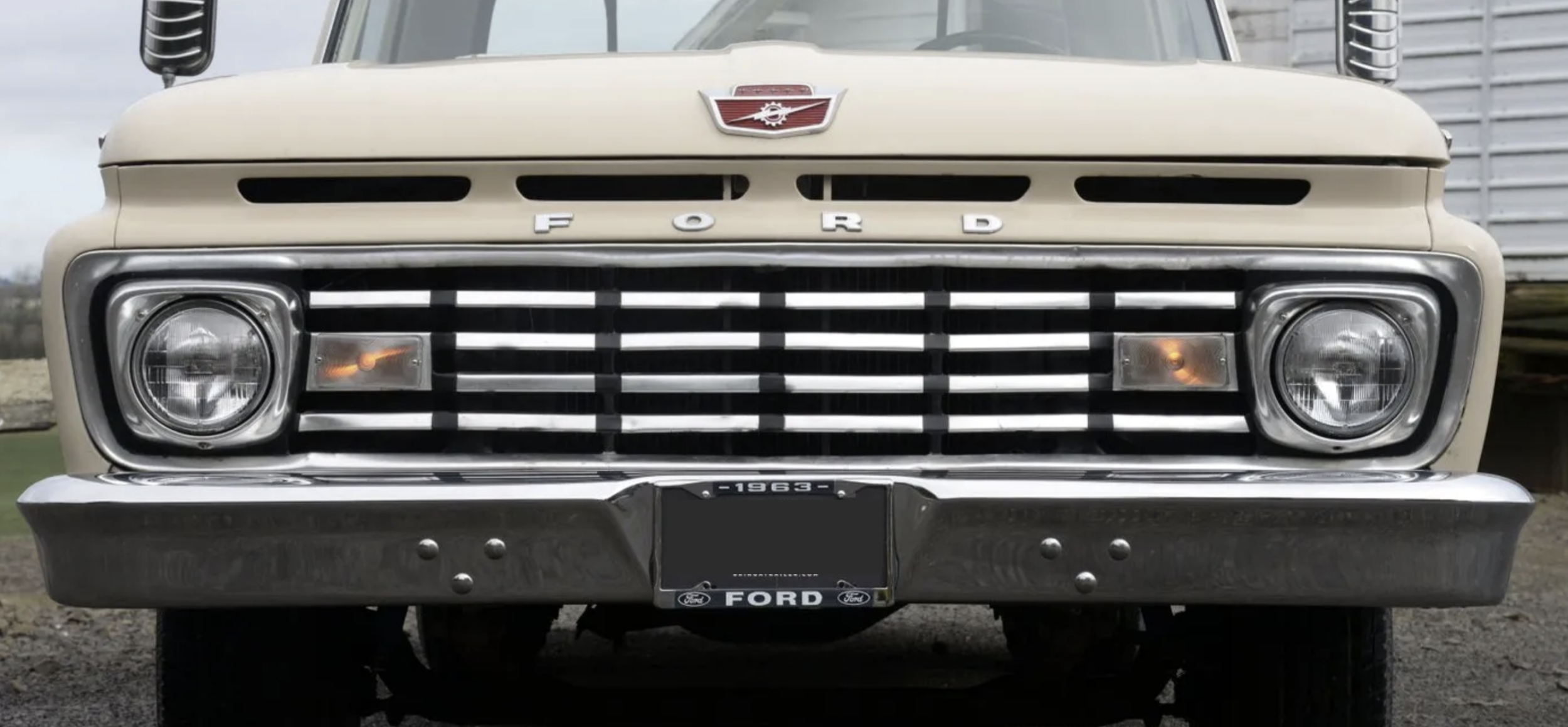

    Before and the 1963 reference. Note turn signal in the grill. I didn't do that. Nor the black lines breaking up the horizontal bars.
    The new grill....as delivered, and before a bit of cuttin' and welding..
    No turning back...
    First fit up...
    What's hard to see is the vertical uprights that attach the center part to the outer perimeter as well as the body/hood latch braces. It's solid!
    Even with all the work, most won't be able to distinguish it from a stock grill.

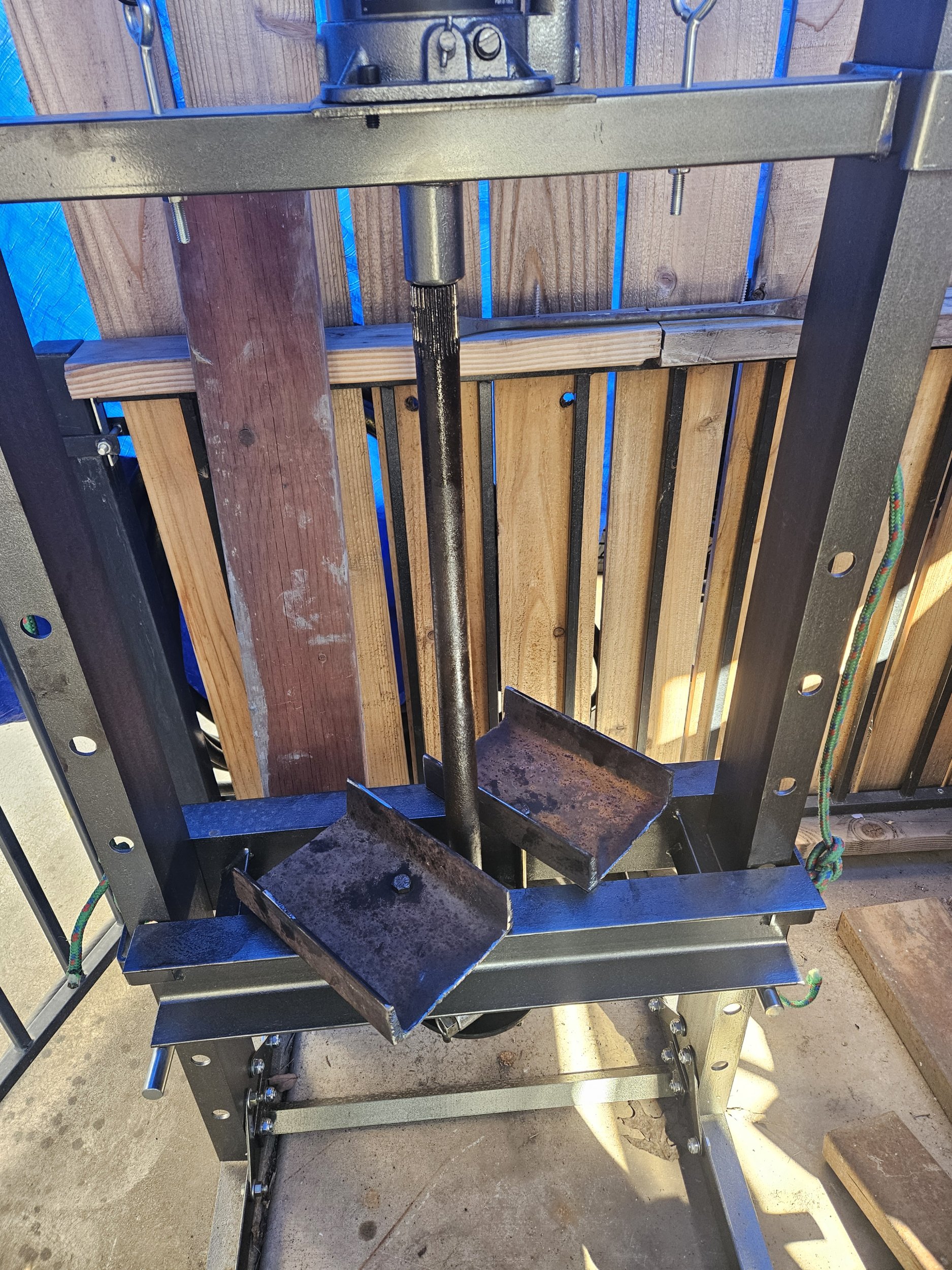

    Next up is dealing with the rear wheel bearings. I got myself a Hobo Freight shop press (the big one), so It's down to just gettin' er done.

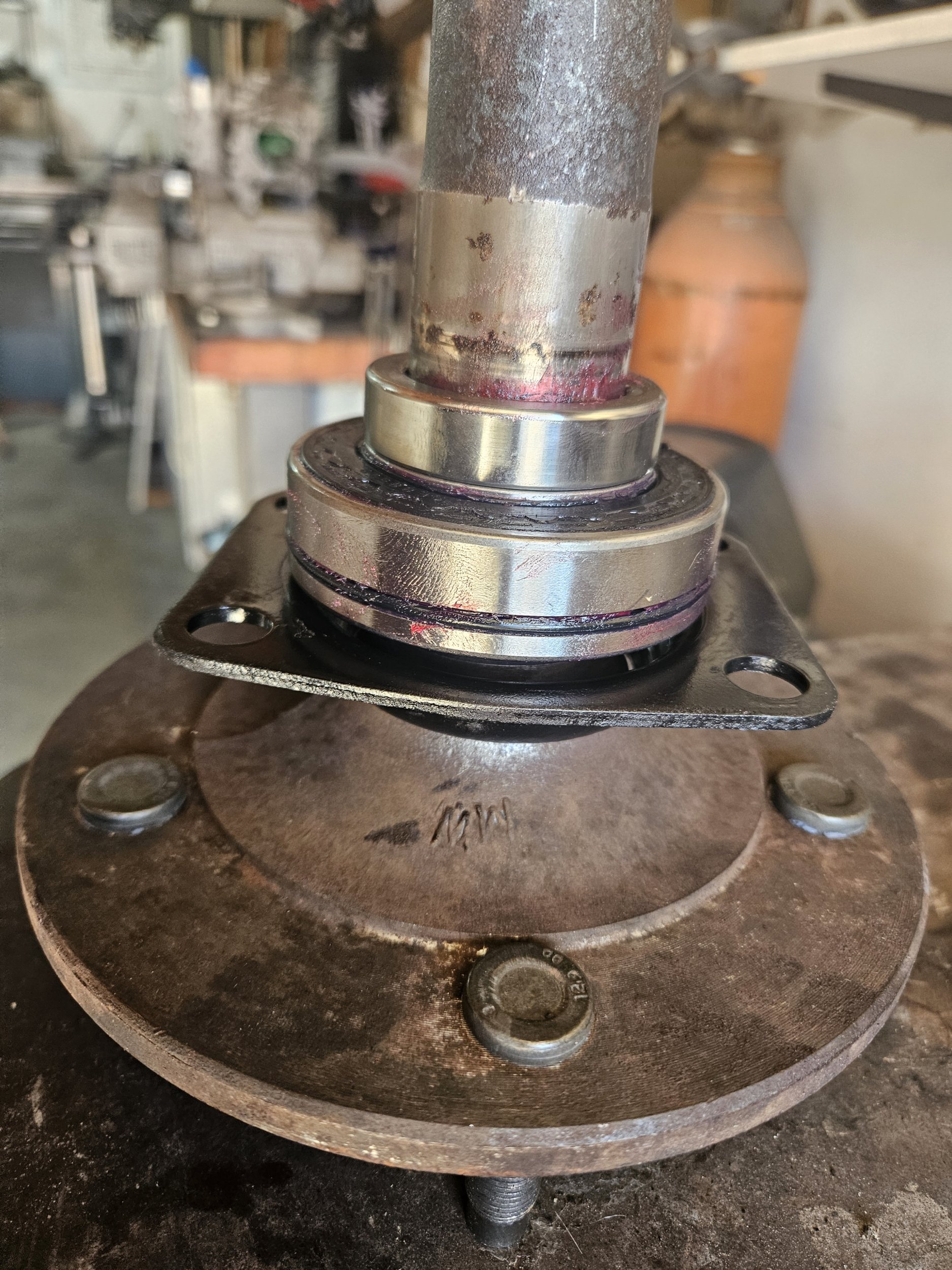

    Rear wheel/axle bearings....DONE!

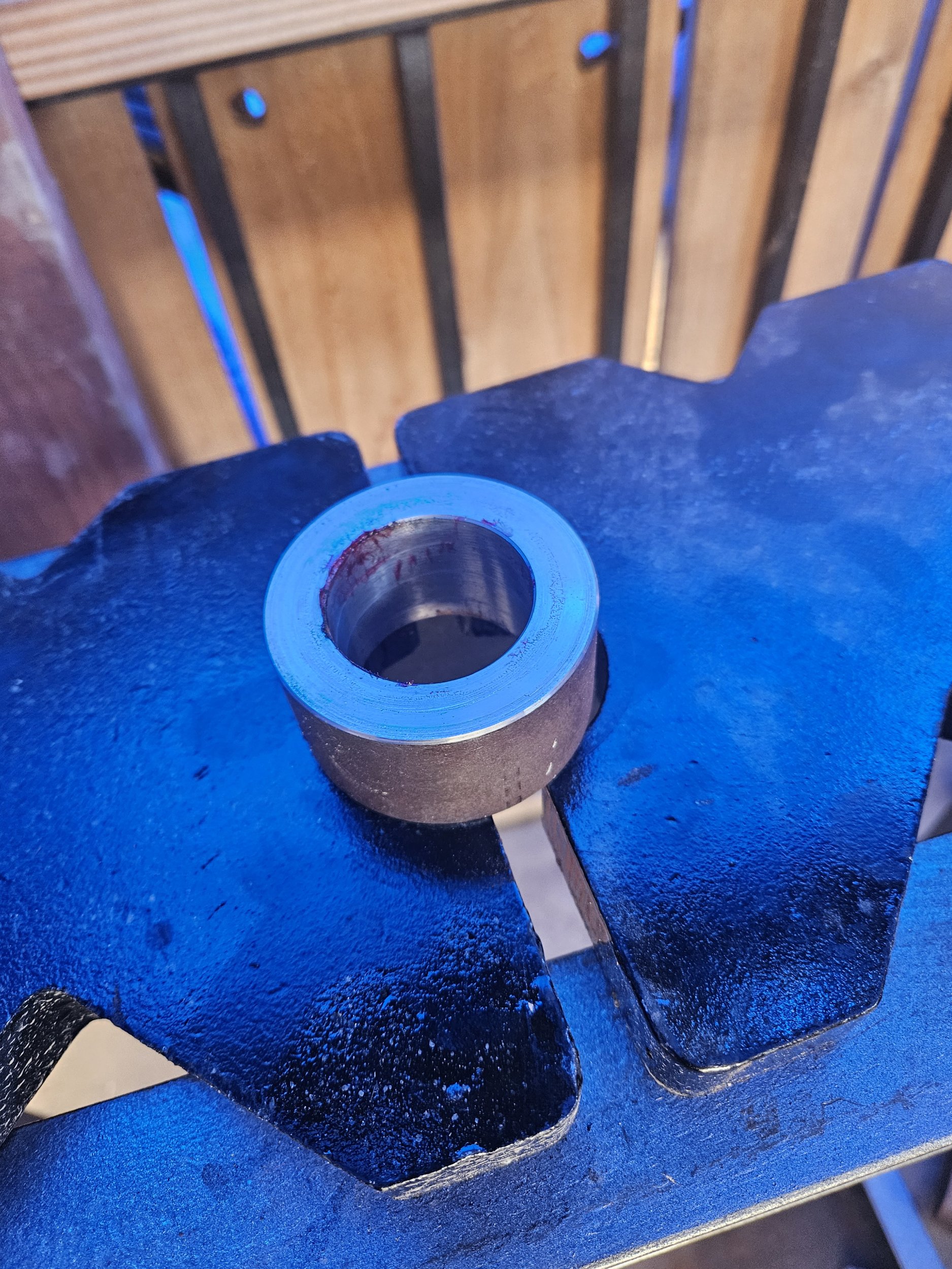

    In typical fashion, I had to torch the retainer rings off. Plenty of practice doing that without touching the bearing surface on the axle itself. I think I can count the number of times on zero hands that I didn't cut those off. Anyway, no drama there.
    I used a bona-fied bearing separator to get the bearings off. I rigged up a bolt together contraption to fit all this in my brand new hobo freight press. It worked. Just about the time I'm thinkin' it taking a lot of pressure...POP! Then the bearing came off smooth.
    I used @wfo guy 's suggestion on a pressing collar by cutting a chunk of heavy wall pipe, and boring the inside to .020" over the bearing ID. Smooth as silk!
    The old bearings....one was a bit crunchy. The other felt a bit dry. So I'm glad I decided to do this before taking any long distance drives. 20251011_111340.jpg 20251011_120546.jpg 20251011_120747.jpg 20251011_121037.jpg
