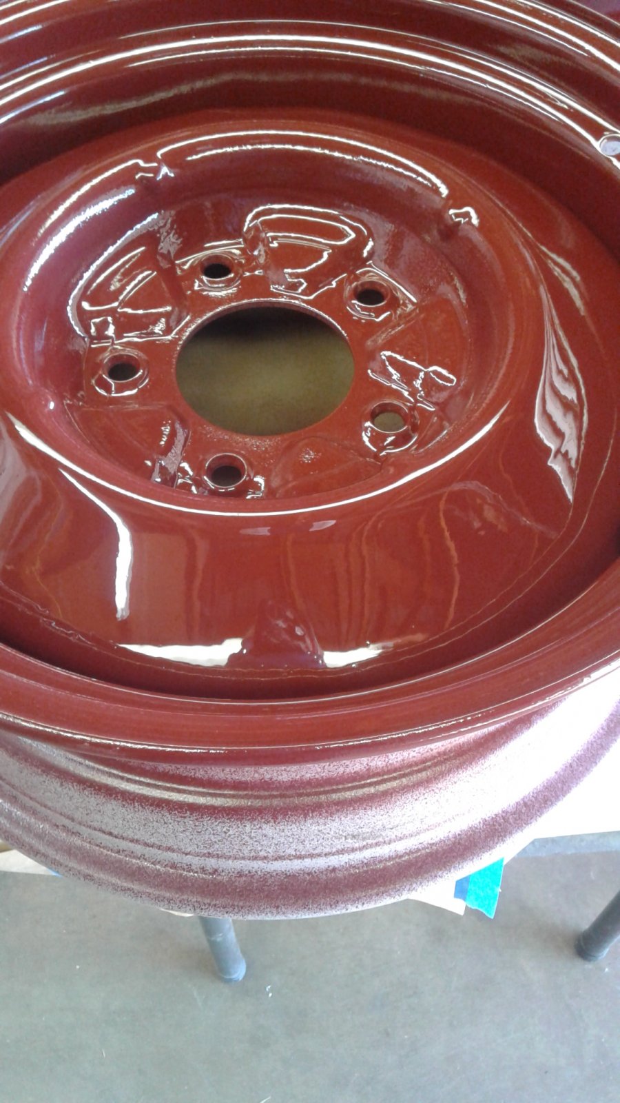

    Screwed the pooch so to speak on painting my wheels. Orange peel? Nope. Orange peel on steroids! I used Urethane single stage. Same stuff I used on the dash, the maroon color. Different gun tho. According to the directions on the paint can, once mixed with activator, it says no reducer is needed. So I'm thinkin' it does, because I used reducer on the dash and used my touch up gun. Probably not enough air through the gun either. It came out in bigger droplets than I've ever seen. I though it would lay down. It did not. I shoulda stopped and dealt with it. I did not. Well, I'm not a painter by any stretch, although I do have a few completes under my belt....many many years ago. And all this means is a bit of work to sand flat and re-shoot. I'll paint a test piece first this time.

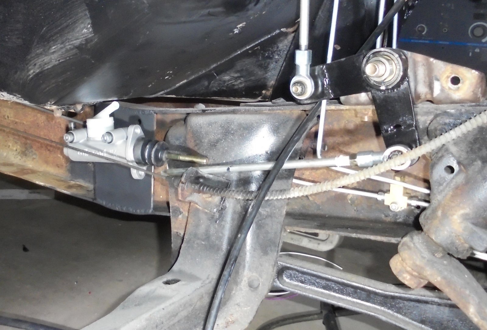

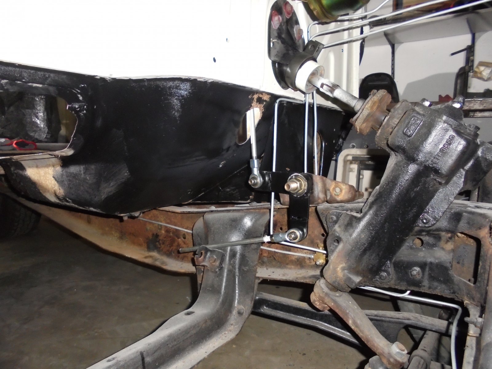

    Clutch linkage is finished minus mounting the master cylinder. I have a spot for the mount and that has the mount holes drilled, but I need the master cylinder in hand before welding it to the frame rail. Once that's in, then the motor can go back in.

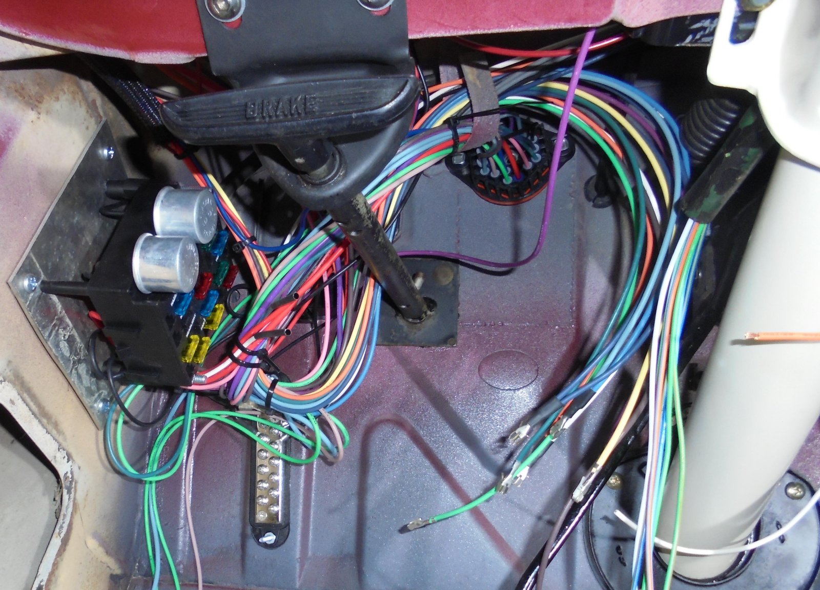

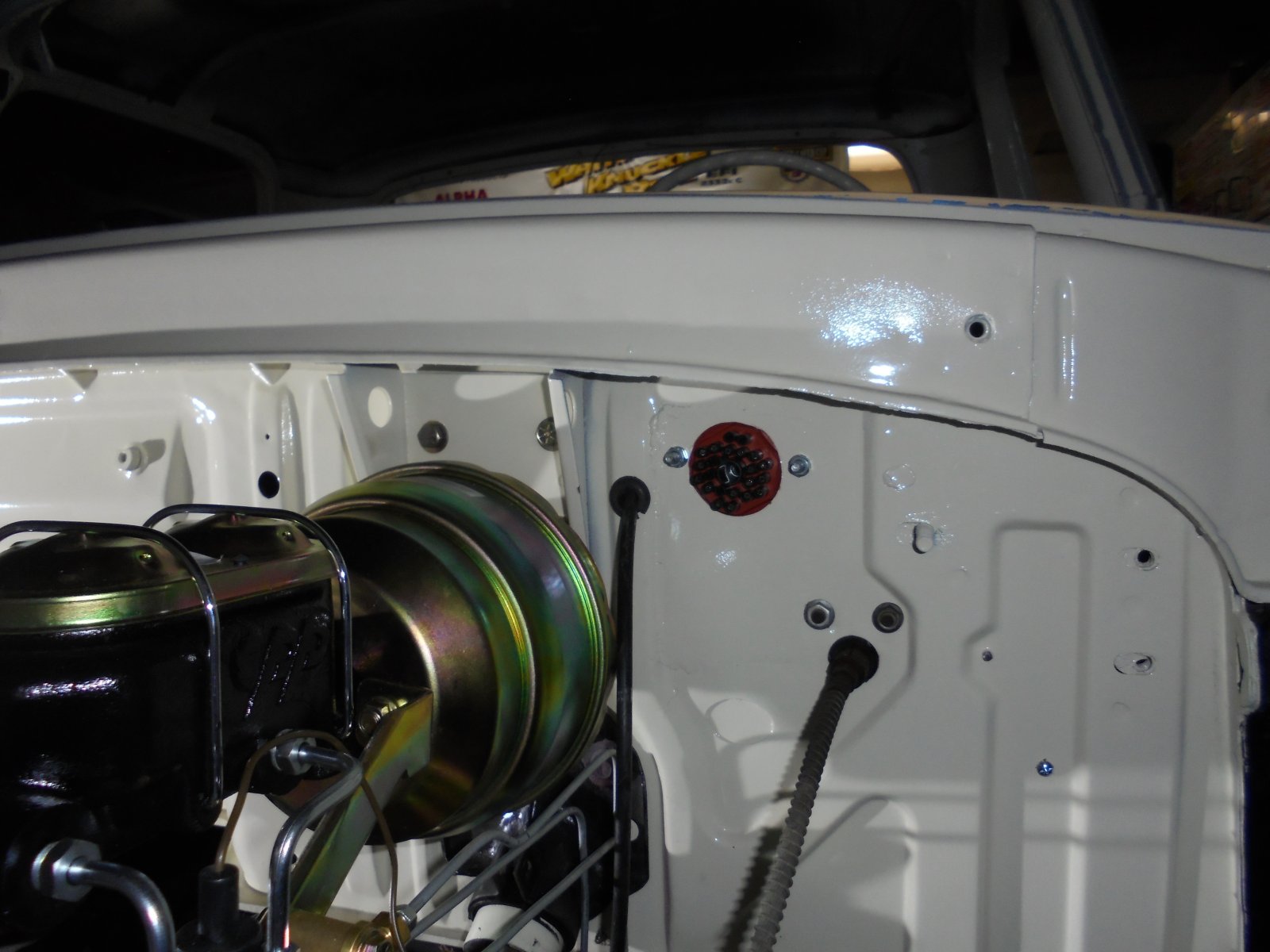

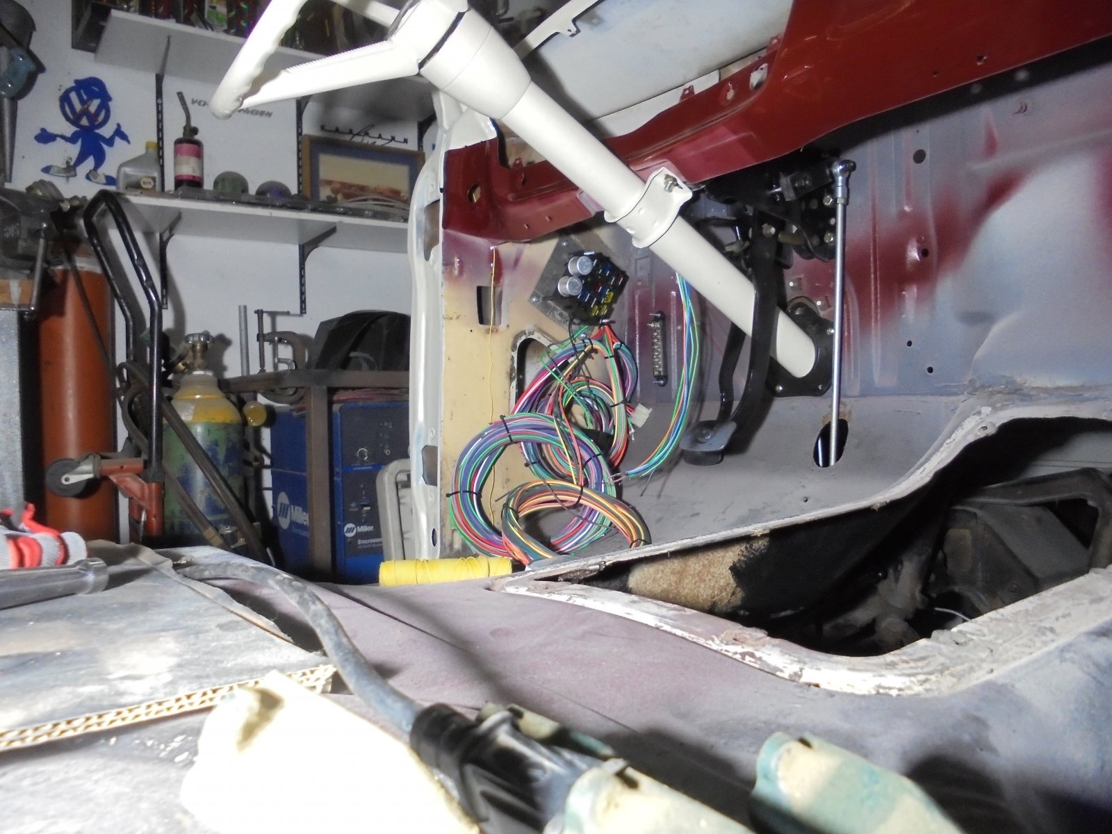

    It's been all fun and games until this point! The EZWiring fuse box is mounted, along with a ground strip.
    This will be a time that will test my patience. Fortunately, my son is going to lend a hand and has provided quite a bit of guidance on things I'd need to make this a clean install.

    I put my fuse box in the same place as yours. Then I covered it with a toe kick trim panel.
    Mistake. Now to check for a bad fuse I have to remove a few screws to check the fuse box. I suggest a separate easily removed cover if you plan to trim it out.

    It seems the fuse box will be out of the way there. Most people seem to want to mount them to the firewall. The stock one mounted there, but it was much smaller. The grounded strap lined up perfectly in those same holes!

    Nice day today, brisket on the traeger. So while I wait, I re-shot the wheels.
    More gooder! Still not perfect, but a nice gloss and very few dirt particles. I'm satisfied with that, especially since this will be a daily driver and not a show truck. I have to keep reminding myself of that so I don't go way overboard on some of this stuff. So, here's the before after sanding flat, and after three coats of urethane. The only difference seemed to be making an air adjustment and using a little reducer.

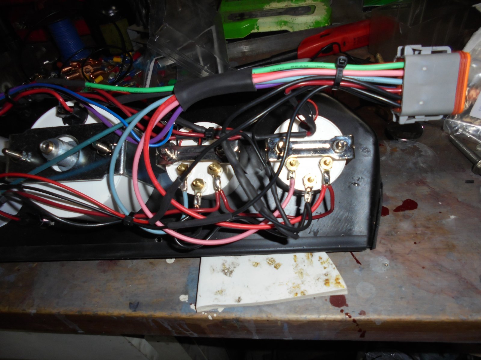

    It's coming along. Very tedious work. I had removed the stock harness and all wiring completely, since it was 56 years old, brittle and corroded. None of the switches worked either. I bought a 12 circuit universal harness, along with a GM headlight and wiper switch, as well as a new ignition switch with a new lock cylinder. The truck did not have keys.
    The harness and switches came from EZ Wire. Very good quality with fairly clear instructions, but I did have to add in a fuel pump circuit and relay. It also has some circuits, I may or may not use in the future, such as power antenna. For now, I'm gonna cap the wires for those off under the dash.
    Hey! maybe I'll use that to power up some brake fluid squirters out the back to squirt on a tailgaters car. (Not really. Fun to think about retribution sometimes, but I ain't "that guy").
    To clean things up and simplify final ***embly, I'm using weatherpack connectors for the firewall plug, the gauge panel and turn signal switch. The firewall plug is a 22 pin round block with a sealing rings, and the gauge cluster is a 12 pin connector. Still waiting on the 8 pin connector for the turn signals.

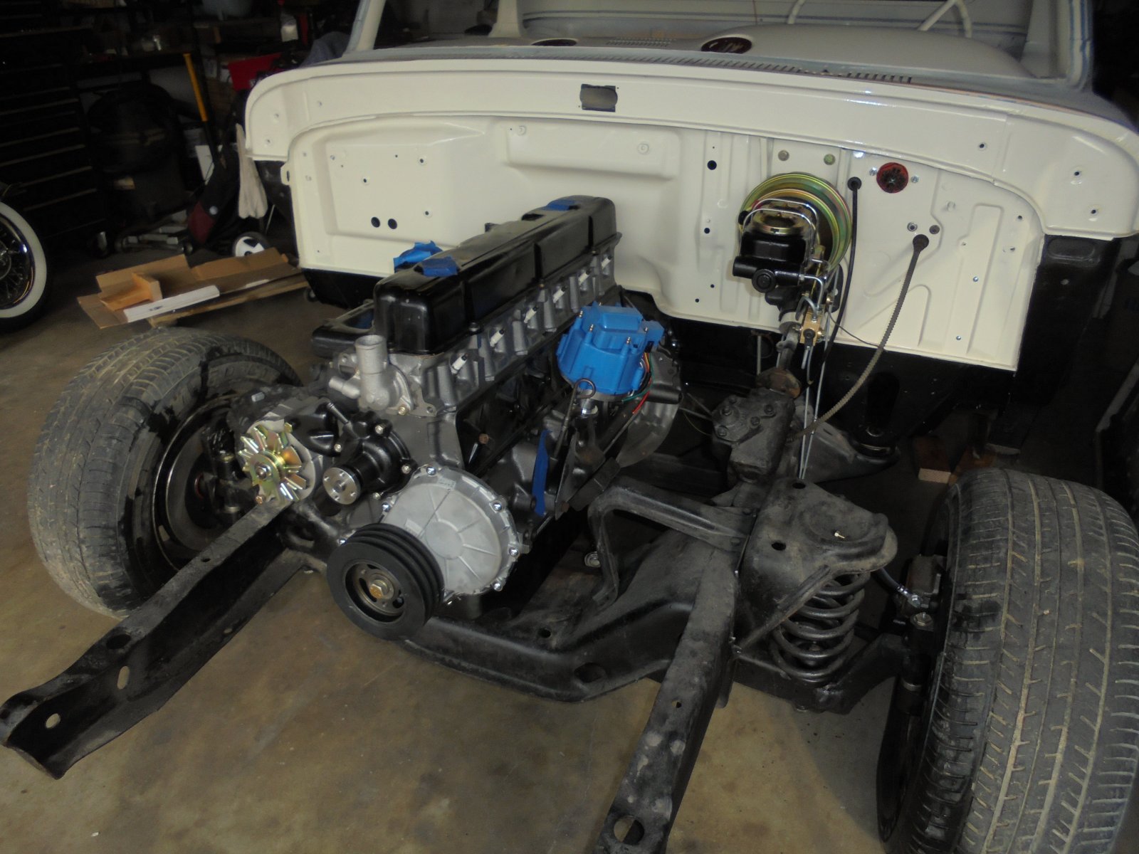

    Engine & Trans goes back in this weekend!

  8. Make sure the pin connections in that bulkhead connector are rated for the individual circuit current. Don't forget that you need to de-rate them down by 20% to ensure that current inrush doesn't excessively exceed their ratings. Headlights, horn, and fuse panel feed will be the ones most likely to cause issues.

    Thanks for making that point Steve!
    The main panel feed wire is separate. The headlight wires and horn will power relays on the core support, so the load on those wires in the bulkhead fitting will be minimal.
    Also, it didn't really occur to me until I looked at these photos regarding that factory metal wire sling. I think I'll change that out to some kind of synthethic non-conductive material that won't chafe the wires.

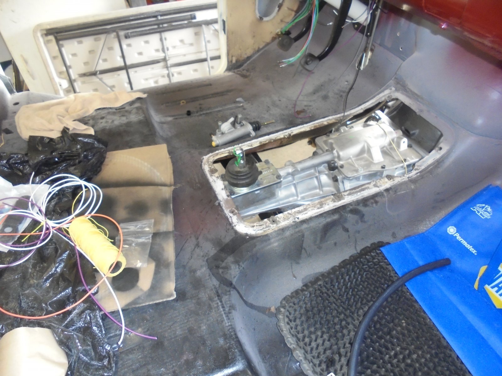

    Thanks Andy! An overhead is exactly what is needed. I'm the kind of guy who would rather spend my time fabbing something than searching. It'll be fun! Building it all into a one piece enclosure and headliner. Probably chip board and fibergl***.
    Anyway, we have touchdown! The shifter ended up at the back of the trans tunnel opening, so a custom shaped shifter handle will be on the drawing board soon. I'll have to put the seat frame in to see how much of a bend I'll need to get around it.
    The stock T89 trans mount bolted right on, and the crossmember only needs a couple holes elongated. Almost like it was meant to be!

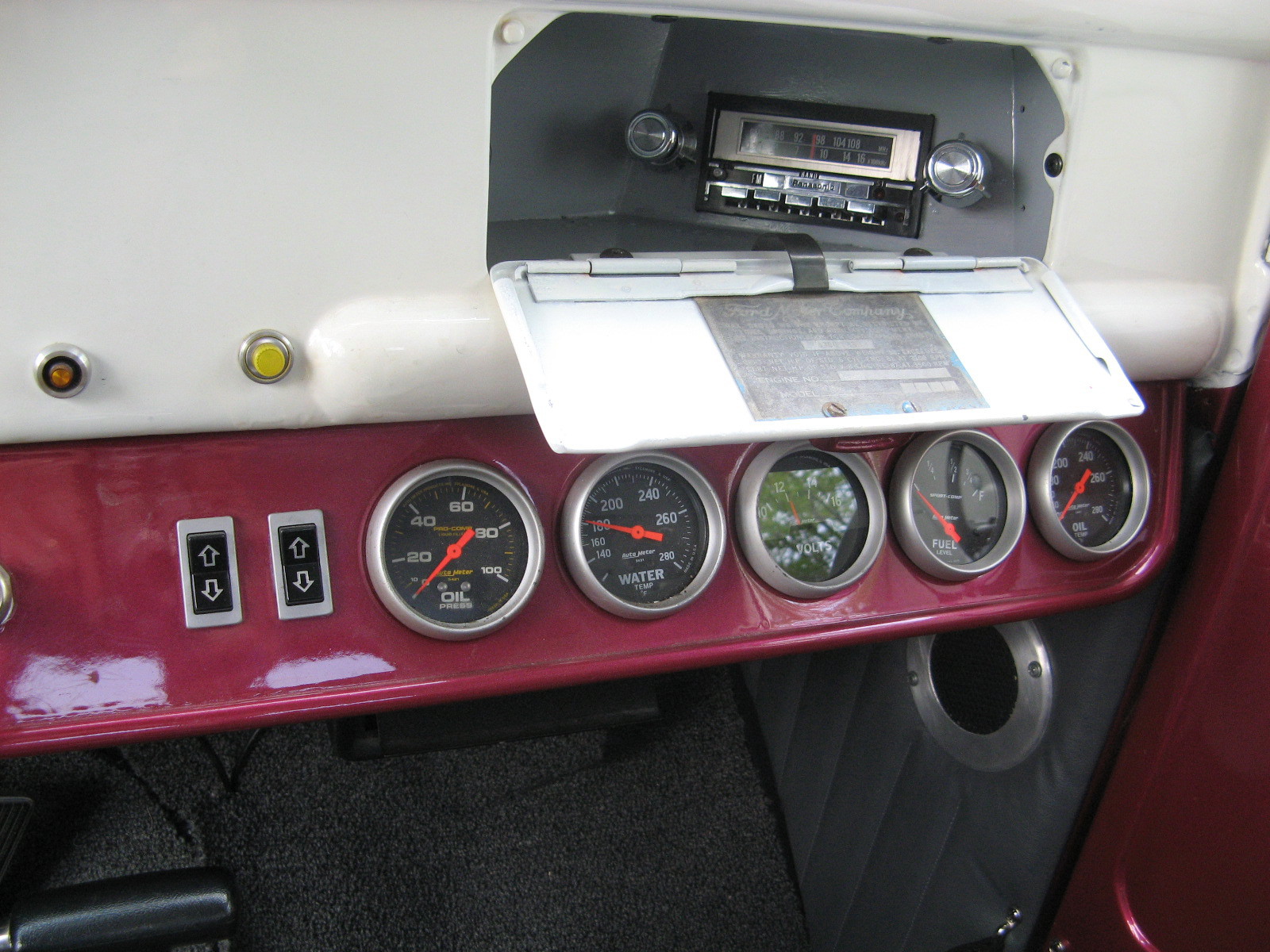

    On the seat, I wanna keep the bench, so's I can have my sweety sittin' next to me! I'll shape the foam myself and cover it with Mexican Blanket material. And I'll take the stock lower door panel, and build a pocket. The upper door panels will get covered with that same material.

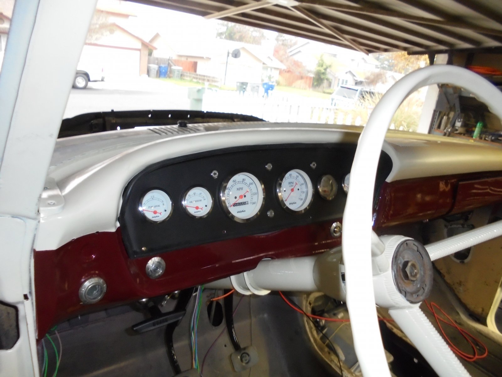

    With the gauge panel finished, and most of the under-dash wiring complete, I went ahead and installed the gauge panel. Just the turn signals and brake pedal switch left....at least until I figure out what to do with the wiper motor and I get the AC/heat unit. But that's on the other side anyway

    Clutch linkage....finished!
    There were a few challenges along the way and one yet to be resolved. The master cylinder had a captive pushrod with a 5/16" X 24 thread. Ok, simple enough. I had a full length pushrod already made that was 1/2" diameter. A piece of drill rod I had on hand. I figured I would just cut it and thread the master's captive rod into the end of it. Chucked it the lathe, drilled it to tap hole size, and my tap would not go in any further than 1/2" or so. It got that far, squeeked, and that was it. (Yes I used cutting fluid, and yes I backed it out frequently to clear the chips) It was stuck. I managed to get it unstuck without breaking it after about a 1/2 hour of slowly working it back and forth. Even so, that particular pushrod was not gonna get finished. That was all it took to work harden the inside. I even tried to drill it out to 5/16" and use a set screw to attach it to the masters pushrod. It wouldn't drill either. Just rubbed off the end of my drill bit. ****ola!
    So, I moved over to finish plumbing it and went to connect it to the hydraulic release bearing, which had a #4 AN line. I had ***-UMED that the master came with a #4 adapter. I thought for certain I had read that into the description when I bought it, so I didn't bother to order that fitting along with the master. As it turns out...it had a #3. I wanted to finish it, so I ordered fitting on Summit (not available anywhere local) and paid the $12 shipping fee for a $9 part.
    While I waited for that, I took the master back out and did what I should have at the beginning. Remove the captured pushrod and make a one piece pushrod. Took less time that what I spent fighting with the extendo piece I was trying to make, just to keep from have to pop the retainer out of the master that held the original pushrod.
    So clutch linkage and plumbing complete! Except I am having trouble bleeding it. Master is below the release bearing, so it's just gonna be stubborn. It just won't bend to my will and simply bleed. I've tried arguing with it. It still insists on being stubborn and uncooperative. So, I'll have to resort to buying a vacuum bleeder I reckon.

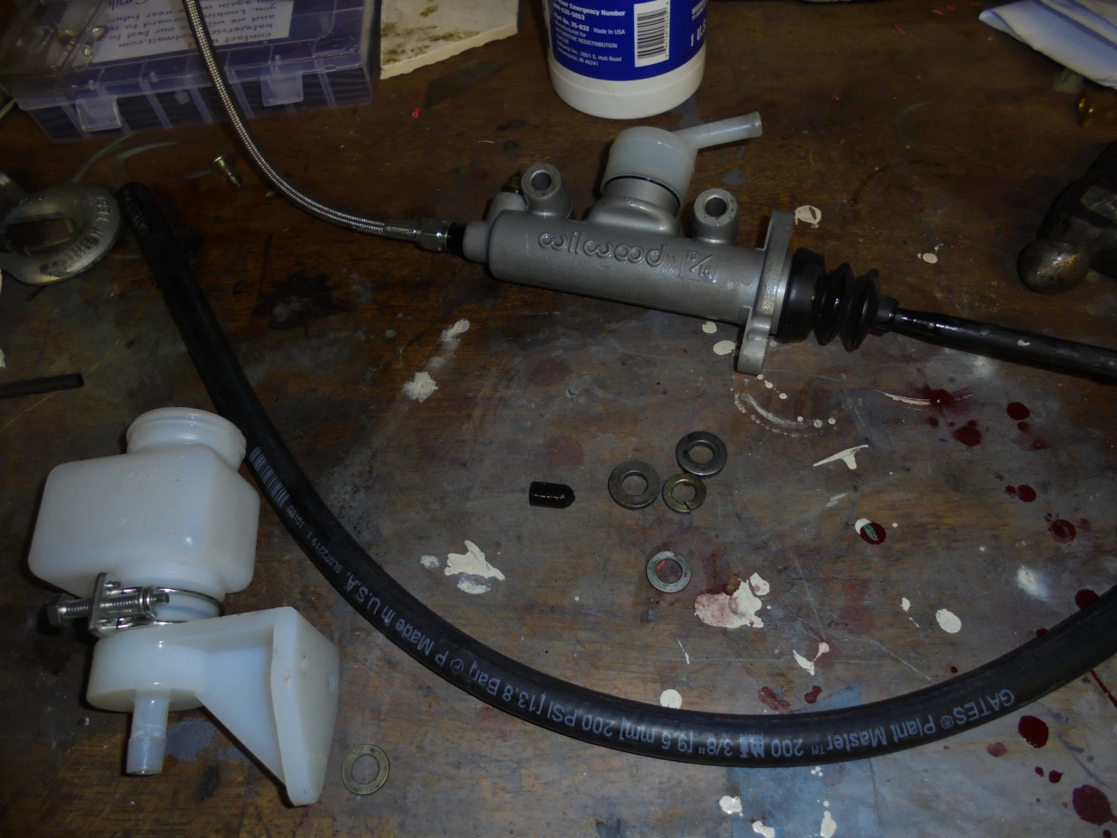

    The mystery of the "Non-Bleeding Clutch" continued last night. I put it all back together, knowing the master was properly bench bled. I knew it moved fluid. I knew the reservoir had fluid, and when I filled it, air bubbles came up as it filled the line, as I knew it should have, as it is mounted probably around 2 feet above the master.
    Yet, it would not bleed. Again!
    After a few grumble sessions and raising questions about the truck's parentage, and even comparing it to Oedipus, I decided to begin again. All of it this time, top to bottom. Because when I took off the hose attachment car from the top of the master.....no fluid. It should have instantly drained the reservoir into the catch basin beneath.
    At last I knew where the problem lie. Somewhere between the reservoir and master.
    My initial su****ion was that there was a chunk of molding **** left in either that plastic cap, or the reservoir itself.

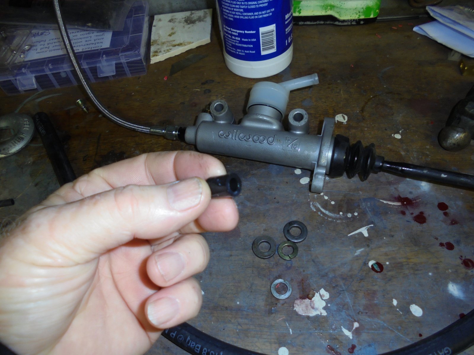

    Upon inspection, I found those to be free of defects. But when I took the hose off, the fluid remained inside the hose without freely draining. At last! The culprit is close at hand!
    No light would shine thru when the hose was straightened, so I shoved a length of wire in.
    Lo and behold....The Culprit revealed. And, it was my own doing.
    A vacuum plug inside the hose. (seen in the first photo next to some washers). A plug that fit snugly inside the hose that I had put there to keep debris out while I located a spot for the reservoir, and drilled the holes. It had become the debris itself! And the result was the master was not getting fluid.
    I have found the culprit and it is I!
