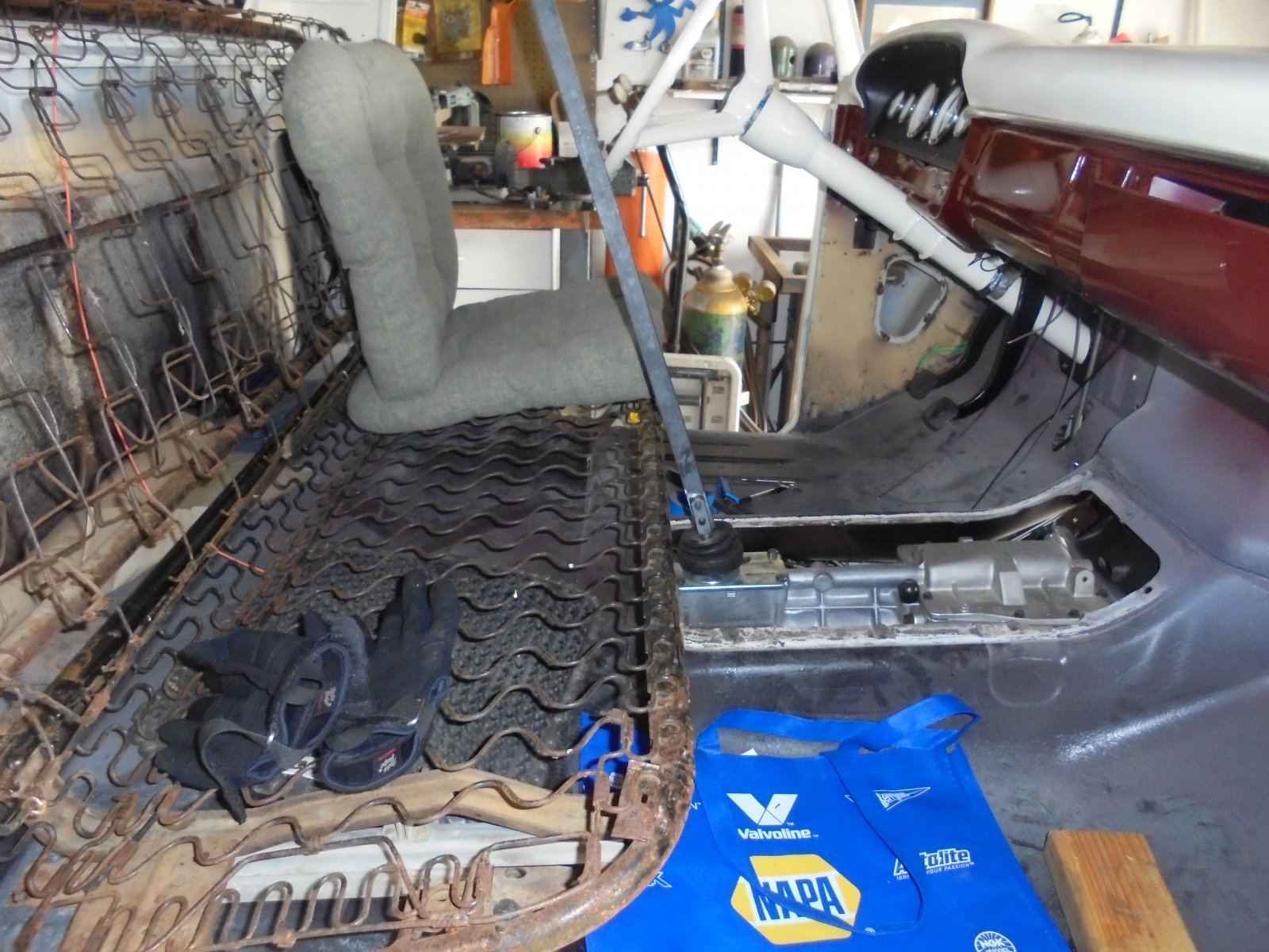

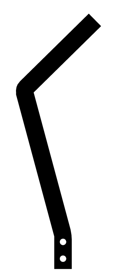

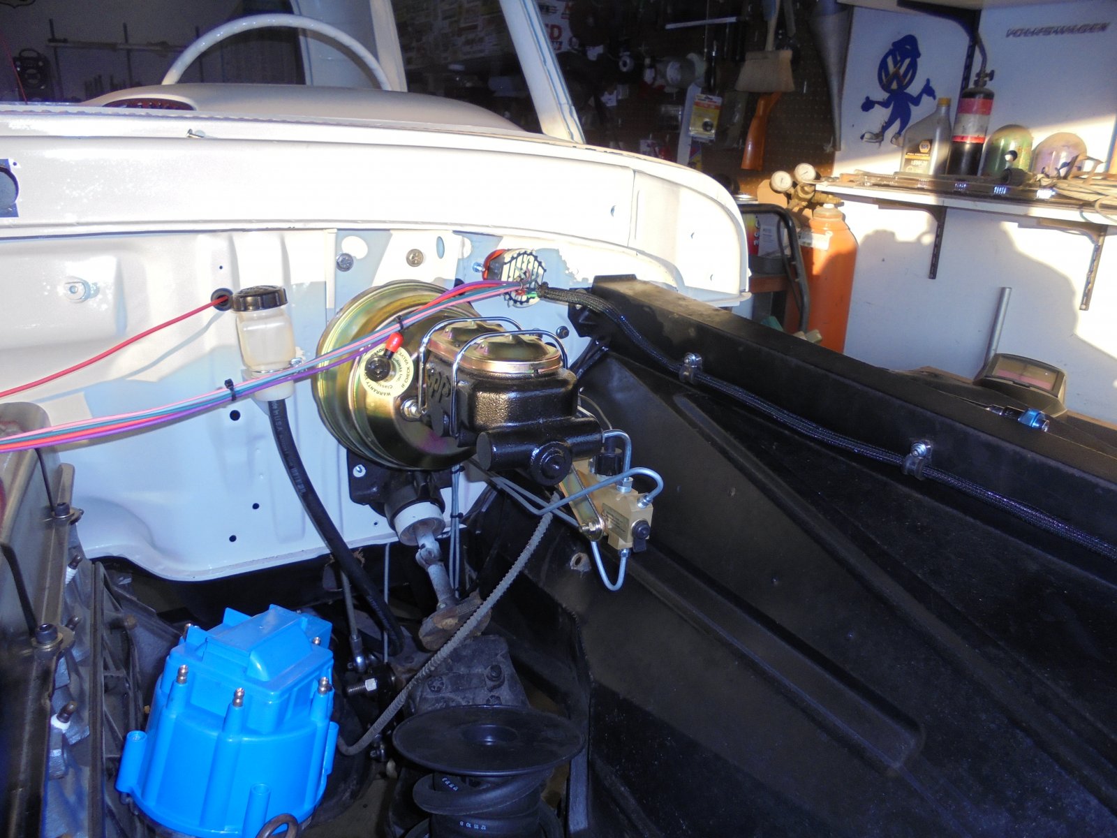

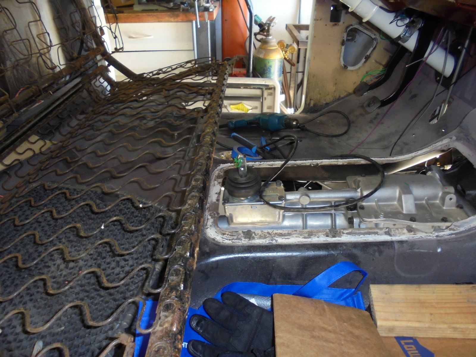

    It was good to FINALLY move on the from the clutch! But before moving on completely, I set the seat frame in and pushed the pedal to get a feel. I am very pleased with the result! Smooth and easy. It’ll make it much easier around town in traffic. The effort is so easy, I could probably teach my 10 year old grand daughter to drive a stick with it.
    Having the seat frame in also gave me an idea of how to proceed with the shifter. I have a piece of ½” X 1” rectangle steel bar to make it with. Looks like it’ll need a forward bend, and then a rearward bend to get it around the seat. 18” long seems to be a comfortable height. I may make it longer. Just because.

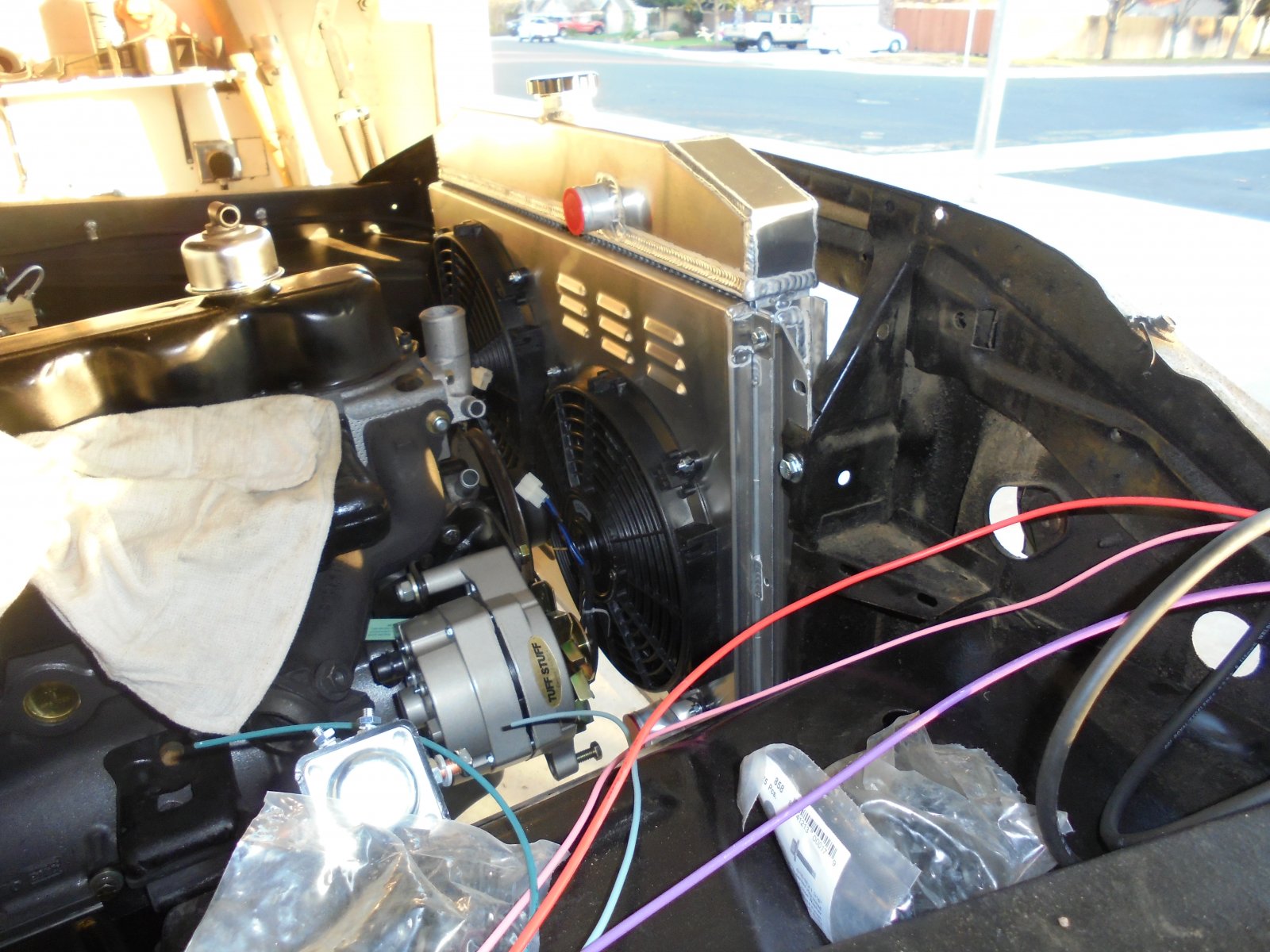

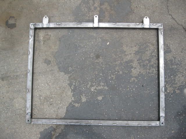

    Over the weekend, I got the radiator installed. It has a couple electric fans, and I will stagger the temp at which they start. It’ll be controlled by the unmentionable fuel metering system I’m using.
    I was a bit surprised at how close the fans are to the water pump. There’s about an inch. But like they say, an inch is as good as a mile! Three row aluminum, semi-specific fit. It’s actually for a ’64. Just about all the common suppliers do not list a radiator for a ’65 for some reason. And the ’66 and later was nowhere near the dimensions of my original. So I rolled the dice and bought one for a ’64. If it ends up too close, I can always space it forward some. The core however is exactly the size of the opening in the radiator support.
    I went way overkill on radiator size because here in Central California, it gets hot in the summer. Really hot. 60+ days of 100° or hotter. 105 to 110° is common too. Dang near Texas, Las Vegas, Phoenix hot!
    I went overkill because a couple summers ago, we headed to the coast to escape the heat. And wouldn’t ya know it, traffic comes to a standstill at the junction of Highway 41 (the main corridor from Fresno county going west) and 46 (the main corridor from Kern County going west) due to an accident. Everyone else had the same idea and there was no escape. No ther side roads out to make a detour. Nearly an hour sitting there and it’s 109° outside. My ’12 Ram handled it fine, and I wanna make sure the F100 does too!

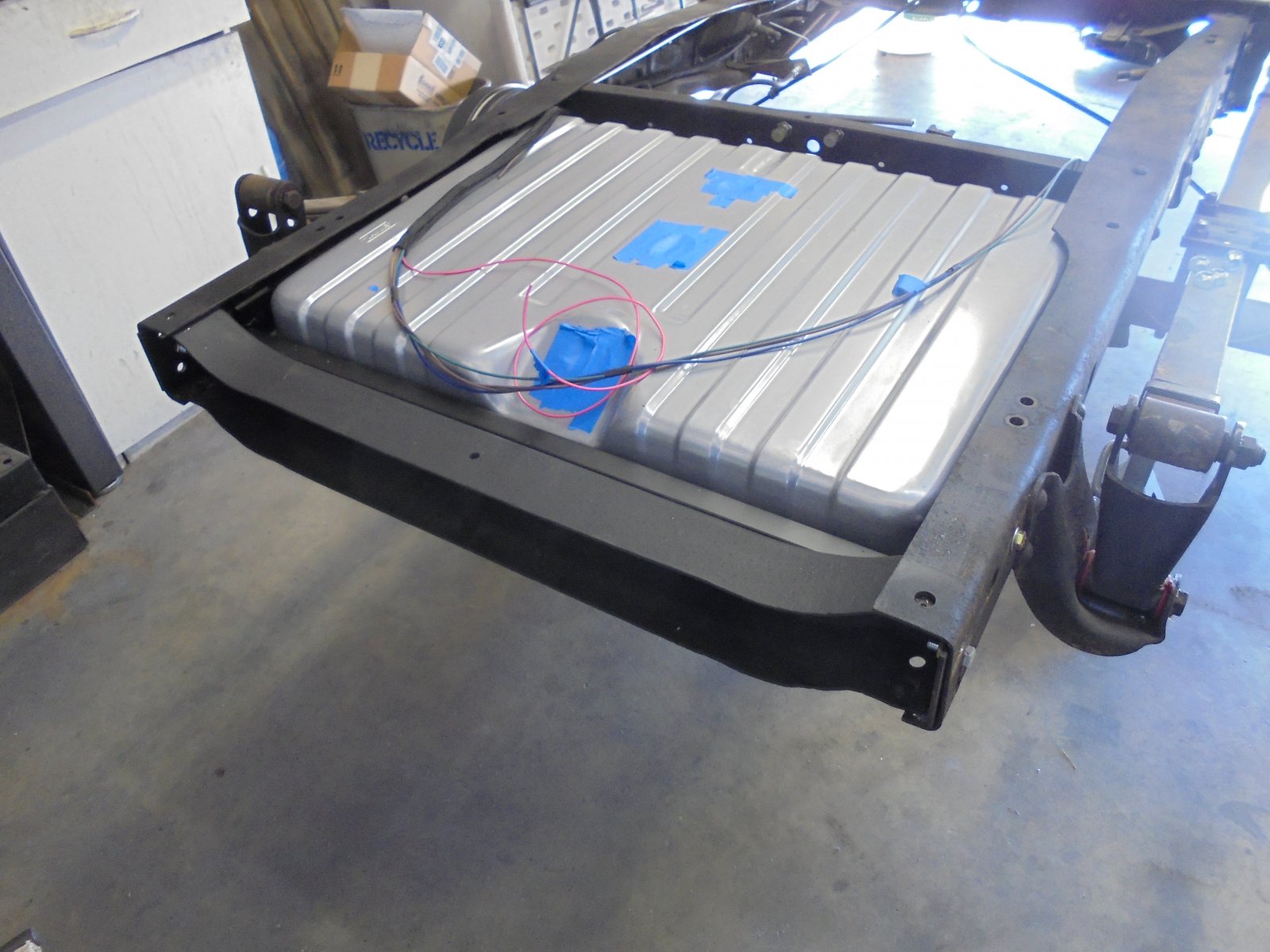

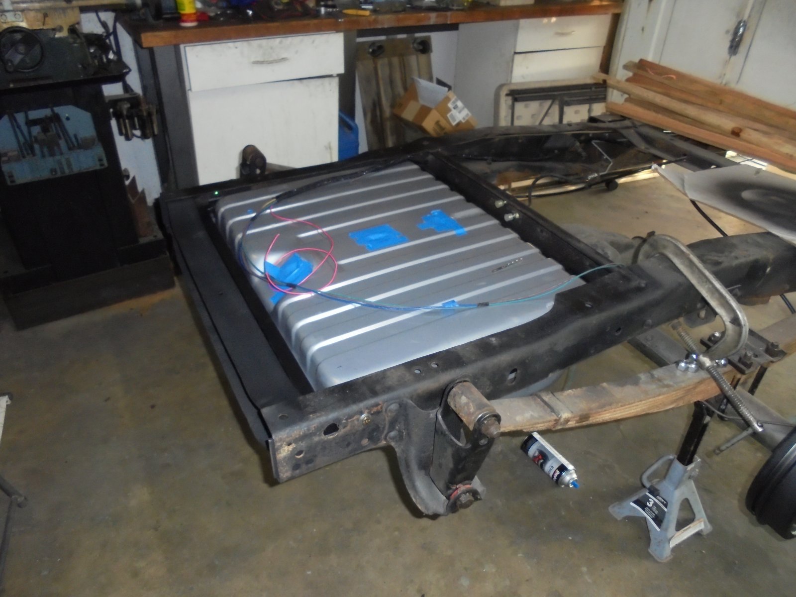

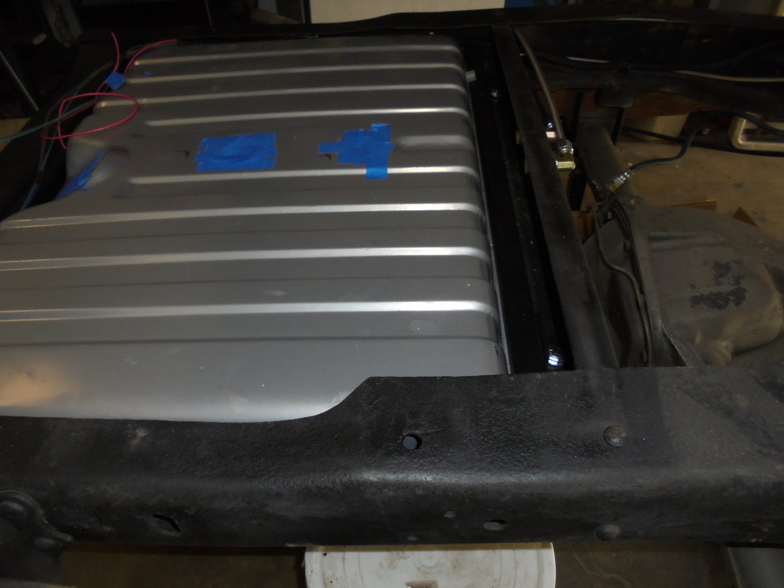

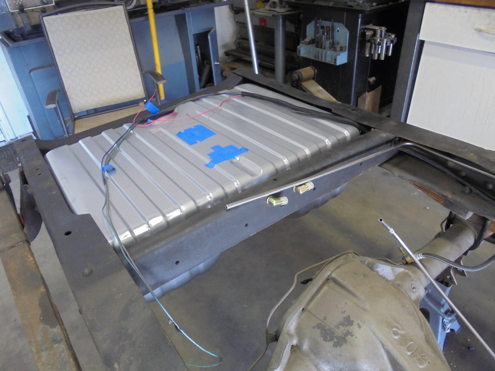

    Fuel system plumbing….

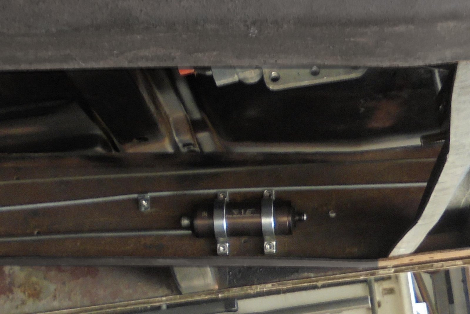

    That unmentionable fuel system needs a return line, so I had to order up another length of 3/8” stainless steel fuel line tube. Until that arrives, in the meantime, I used the one I had to get the feed line routed. I have a couple 90° bulkhead fittings near the tank for the in-tank fuel pump, and a couple up on the firewall (red arrow). The flex lines in back will be less than a foot long. PTFE lined hose. I haven’t decided yet if I will run hoses to the throttle body, or another pair of hard lines from the firewall bulkhead across the firewall, behind the motor, so the hose can be short.
    I also had a nice fuel filter “in-stock” from the drag racer. I bought this filter years ago as an “After the pump” filter, from Fuel Injection Enterprises. Good quality unit with -6AN fittings….with the exception of the element itself. Even thought the product description said it was compatible with methanol, it was not. It was epoxied together rather than soldered. And the epoxy used to join the screen material to the end pieces degraded and dissolved, loading the fuel system up with nasty debris. Anyone who has ever run mechanical injection, knows what happens when the fuel system becomes contaminated. Making it worse was the drag racer’s fuel system is far more complex that a “normal” MFI system. Along with a boost valve that raises the pressure when the turbo comes up on boost, it has the added complexity of feeding a rear engine driven pump on a full bodied car with a front mounted main fuel tank….I’ll just say that the filter degradation made a BIG mess of things.
    But it is a quality filter, and with an element replacement, it’ll work fine on the ‘ol truck!
    The tank mount is nothing new. Done countless times this way, so there’s no need to go into great detail. Just a Mustang fuel tank for which I made a perimeter mounting frame, that bolts to the truck’s frame.
    For a fill, it’s common for people to just have a hatch in the truck bed as a fill location, but I’m gonna work on something a bit more elegant sometime later. I’ll have to get the bed back on to look at options. Later.
    I also started laying out the under-hood wiring. So that will be a work in progress over the short term. DSC01470.JPG DSC01471.JPG DSC01472.JPG DSC01473.JPG DSC01476.JPG DSC01477.JPG DSC01478.JPG DSC01479.JPG DSC01480.JPG FuelTankBracket1.jpg

    My next trick will involve snaking a bent SS fuel line through the ch***is from front to back. It would be far, far easier to split in two and use a union somewhere in the middle, but what's the fun it that?
    It still may come to that

    Mike, will the shifter move forward by turning the plate 180 degrees? I know it does on the tko trans. Might make the shifter mounting easier.
    loudbang, Thor1 and Mike Lawless like this.

    I haven't looked into that, and in fact have not heard of doing that. Something to think about if my shifter lever idear doesn't work out. The schematic attached is what I have in mind. 18 to 20" high Start with a 15° forward bend right at the mounting point, then somewheres between 45 and 60° back. Taper the top and put on my shift knob.

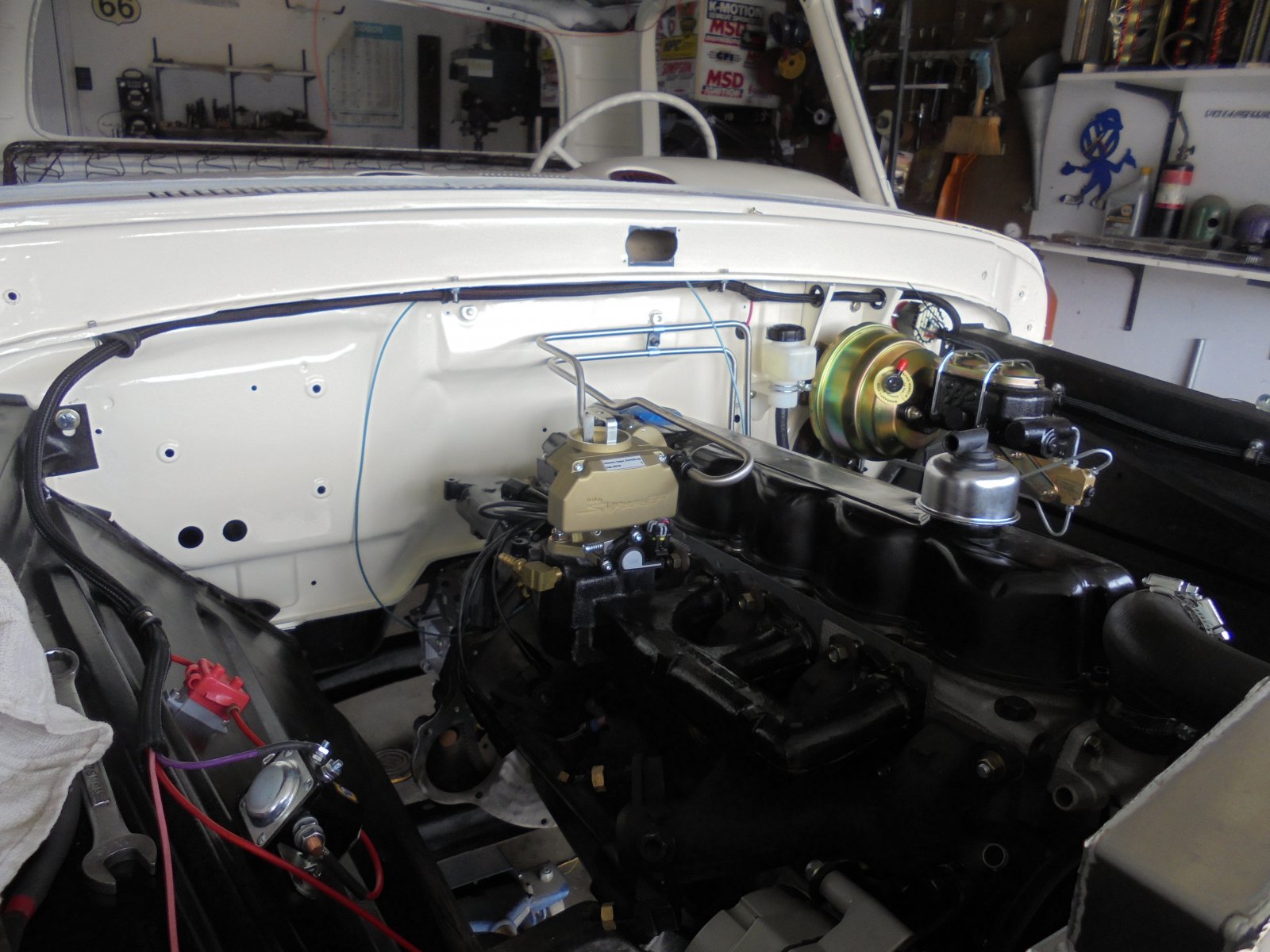

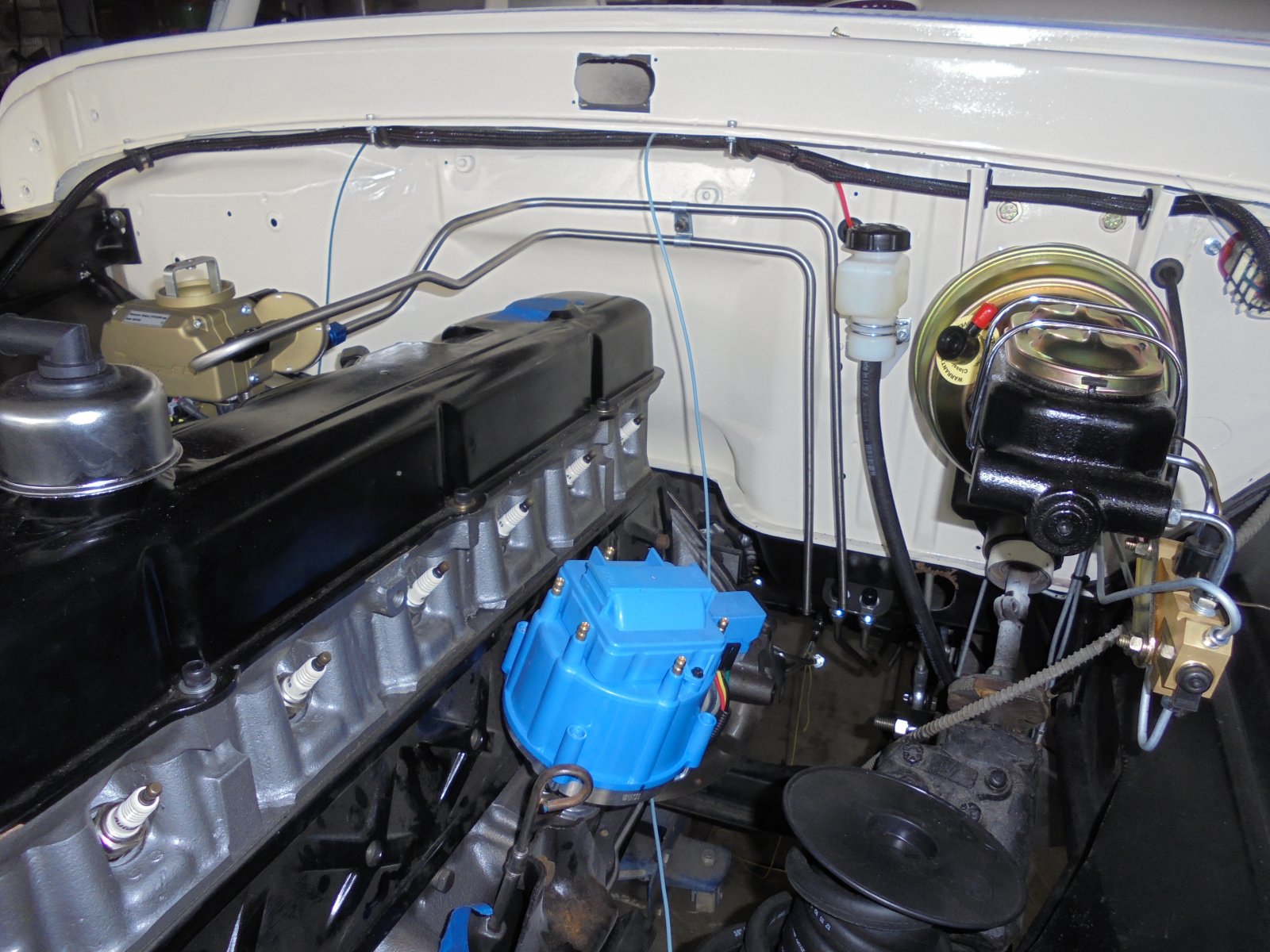

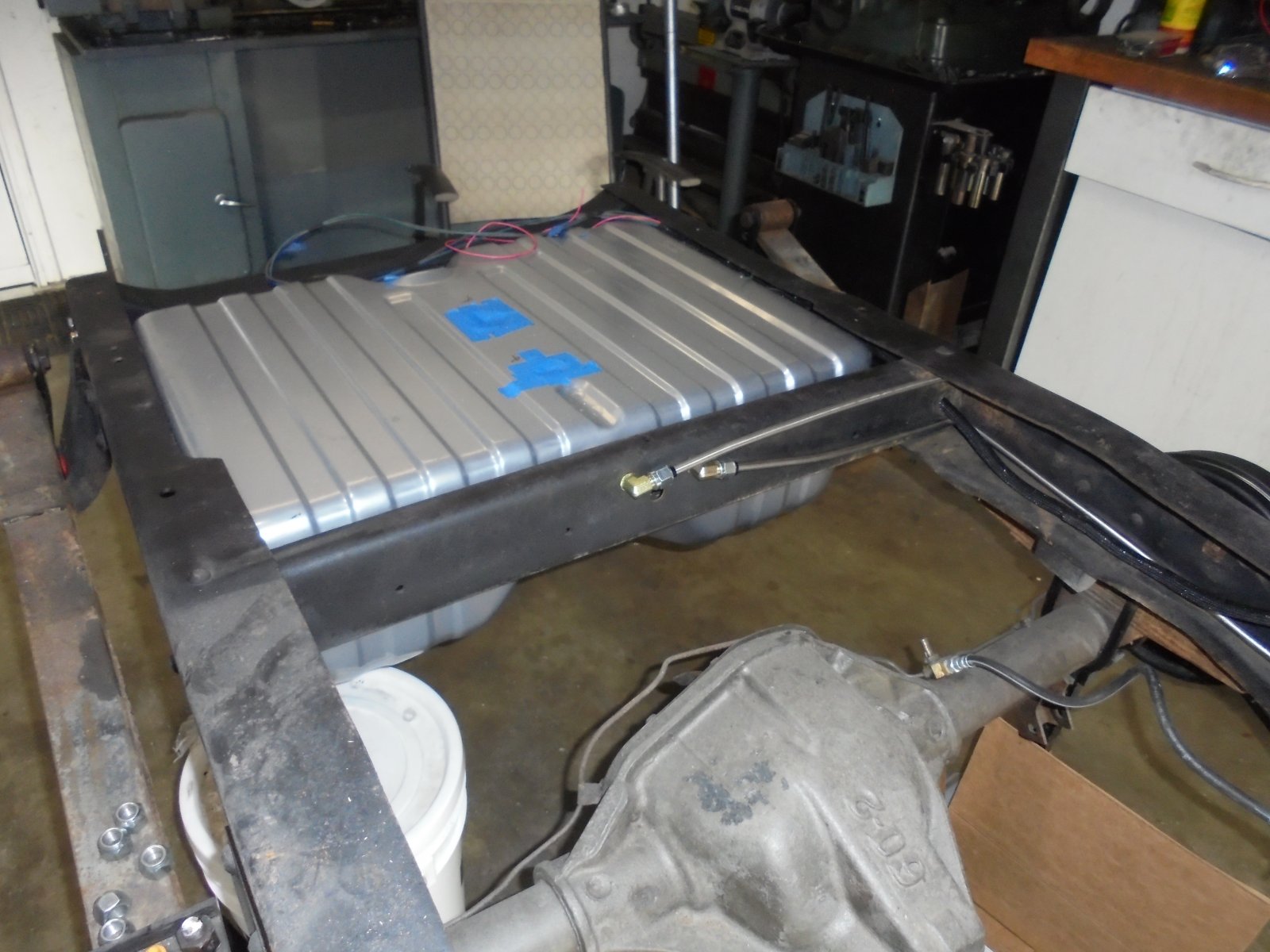

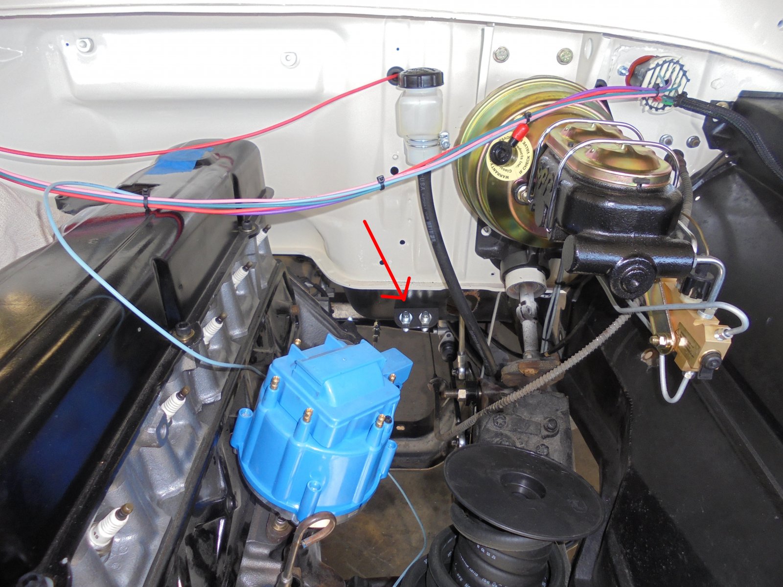

    Fuel lines....done! Well, almost done. I need to make up some flex lines to go the bulkhead fittings. In the back, from the fittings on the frame to the tank. In the front, from the body mounted bulkhead fittings to the engine, which will be anchored to the block.
    Pay no attention to that device on top of the manifold. It's existence will not beacknowledged!
    One thing that I noticed in thinking ahead, is that with the fuel tank in the rear, a couple of the middle bed bolts will have no access. So, I think I'll have to make a nut plate to under the frame rail, so the bed bolt can just screw in from the top.
    Also needed to lower the radiator a couple inches. I thought it looked a little high. So I measured the hood depth with a chunk of angle iron to see how deep it was from the shut line to the peak. Measured the height of the radiator cap using the angle iron to the top of the rubber hood bumper. 3/4" too high.
    Easily fixed with drilling four new mount holes in the radiator frame.
    The piece of steel for the shifter was bolted on to see where it ended up relative to the seat frame. I think a 15° forward angle will do the trick. I think I'll take a couple small pie cuts and weld it after bending. Bending on the wide end might not go well.
