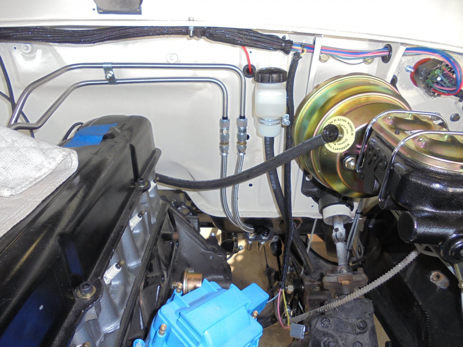

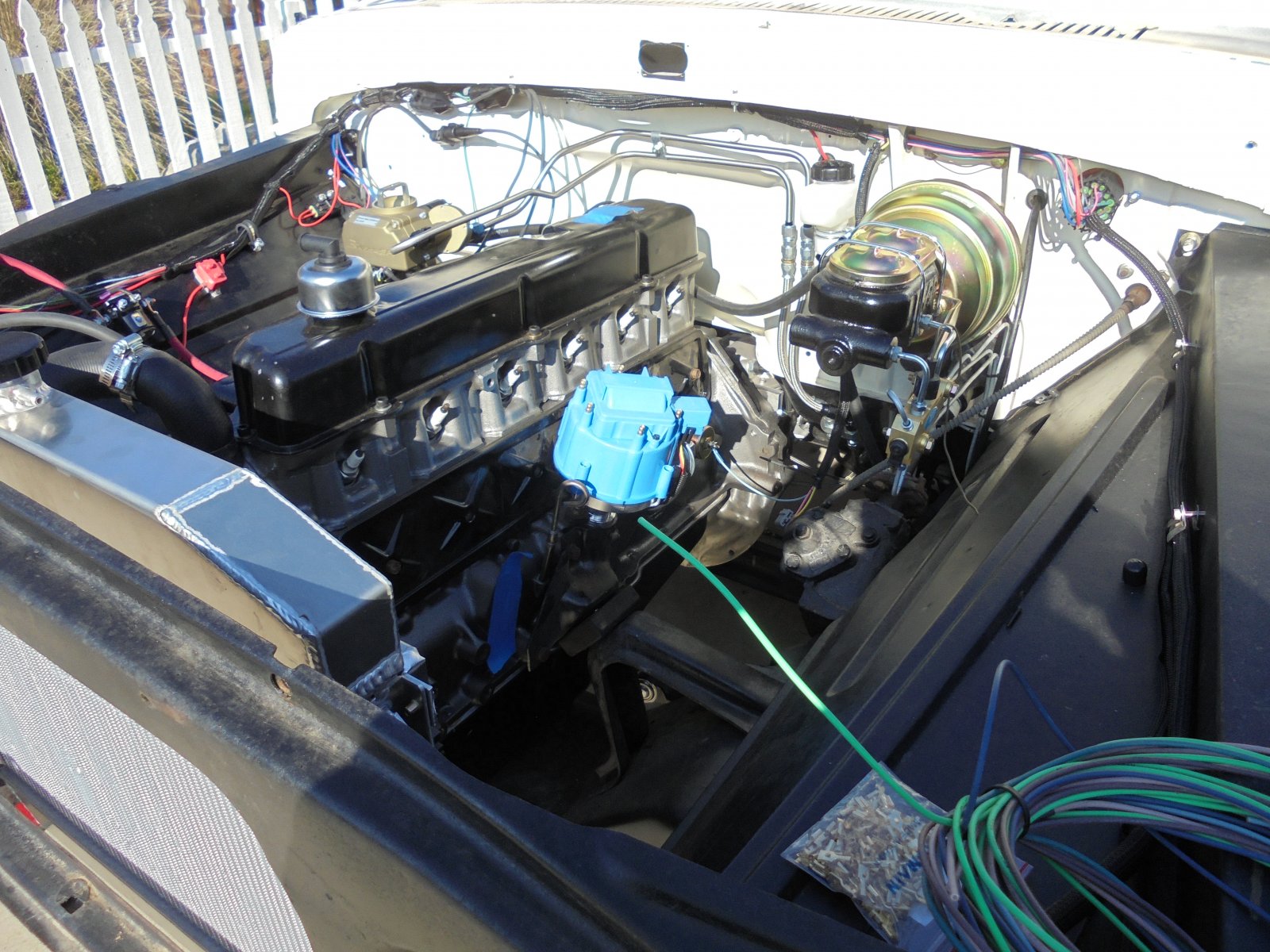

    Not much picture worthy for this post. I've been working toward wiring and plumbing completion.
    Then I run into a hitch....

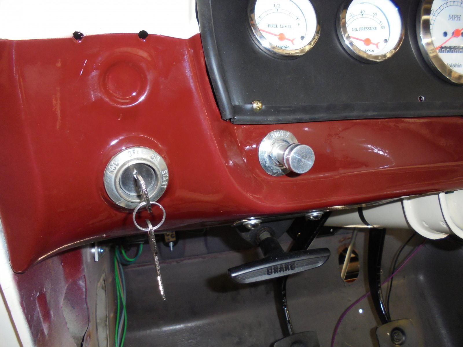

    My wiring kit came with a standard GM light switch. Somewhere around eight blade connections on top and a triangle rod that's supposed to slide in and snap into position. Sounds easy!
    Well, it slides in dang near all the way in and seems to bottom out, and just won't snap in. I haven't tried installing the rode before, just in case I needed to take the switch back out.
    After watching video on how it's suppose to go together, it ain't doing that. I think it's FUBAR.
  2. Try pushing the release ****on for the knob ***embly on the switch when pushing in before you decide it's bad. Sometimes these need a bit of 'fiddlin' to get the knob shaft properly engaged. Once it's in and latched, verify it will come back out by pushing the ****on again.
    chryslerfan55, Thor1 and loudbang like this.
  3. Mike Lawless
    Joined: Sep 20, 2021
    Posts: 867
    Mike Lawless
    Thanks Steve. I fiddled with the dang thing for quite a while. Pushing the ****on several times, twisting the knob, pushing hard on the knob and the ****on. The ****on was leaving a dent on my thumb. I think I'm done with it. They may be fiddly, but they can't be that fiddly.

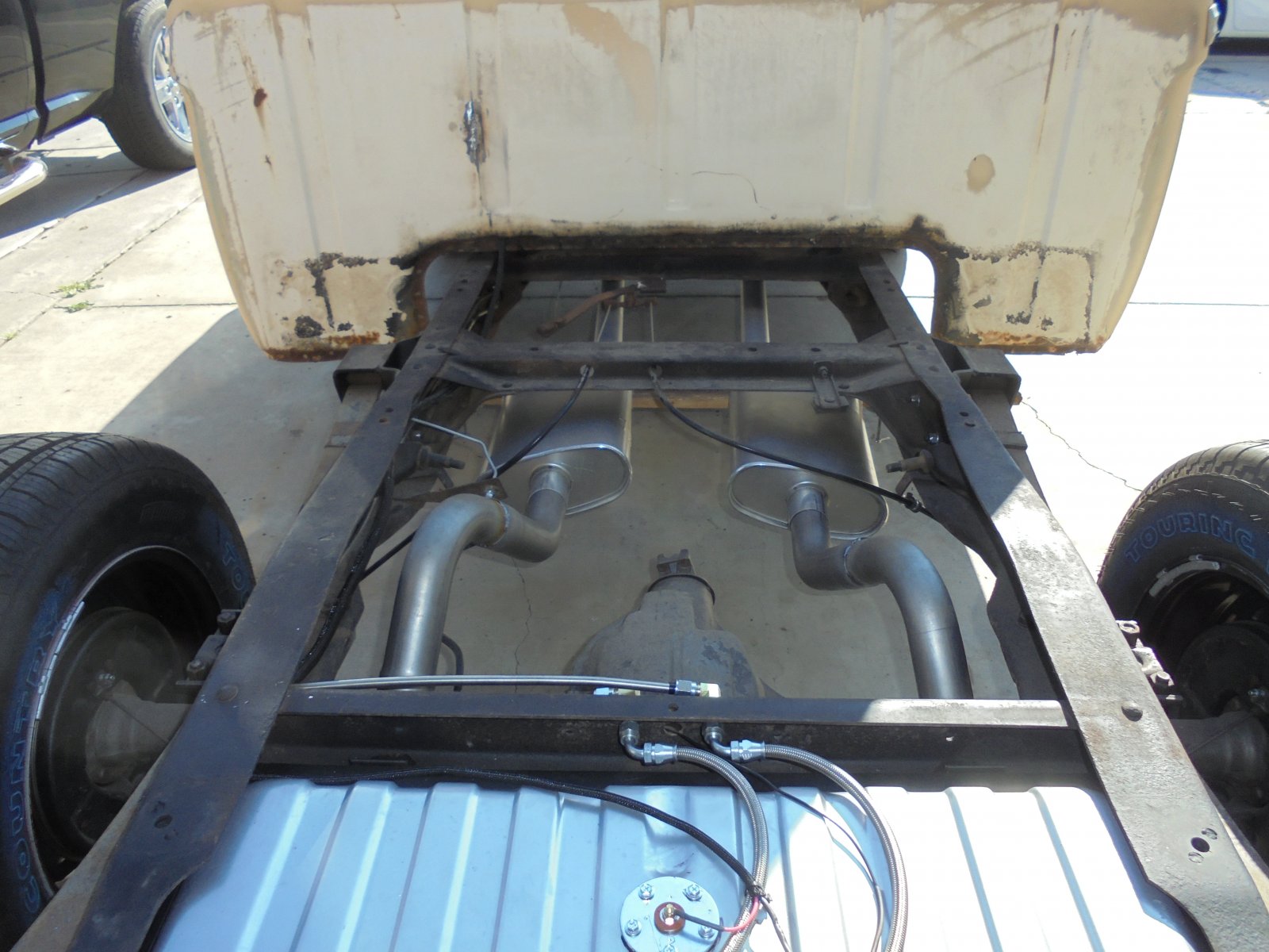

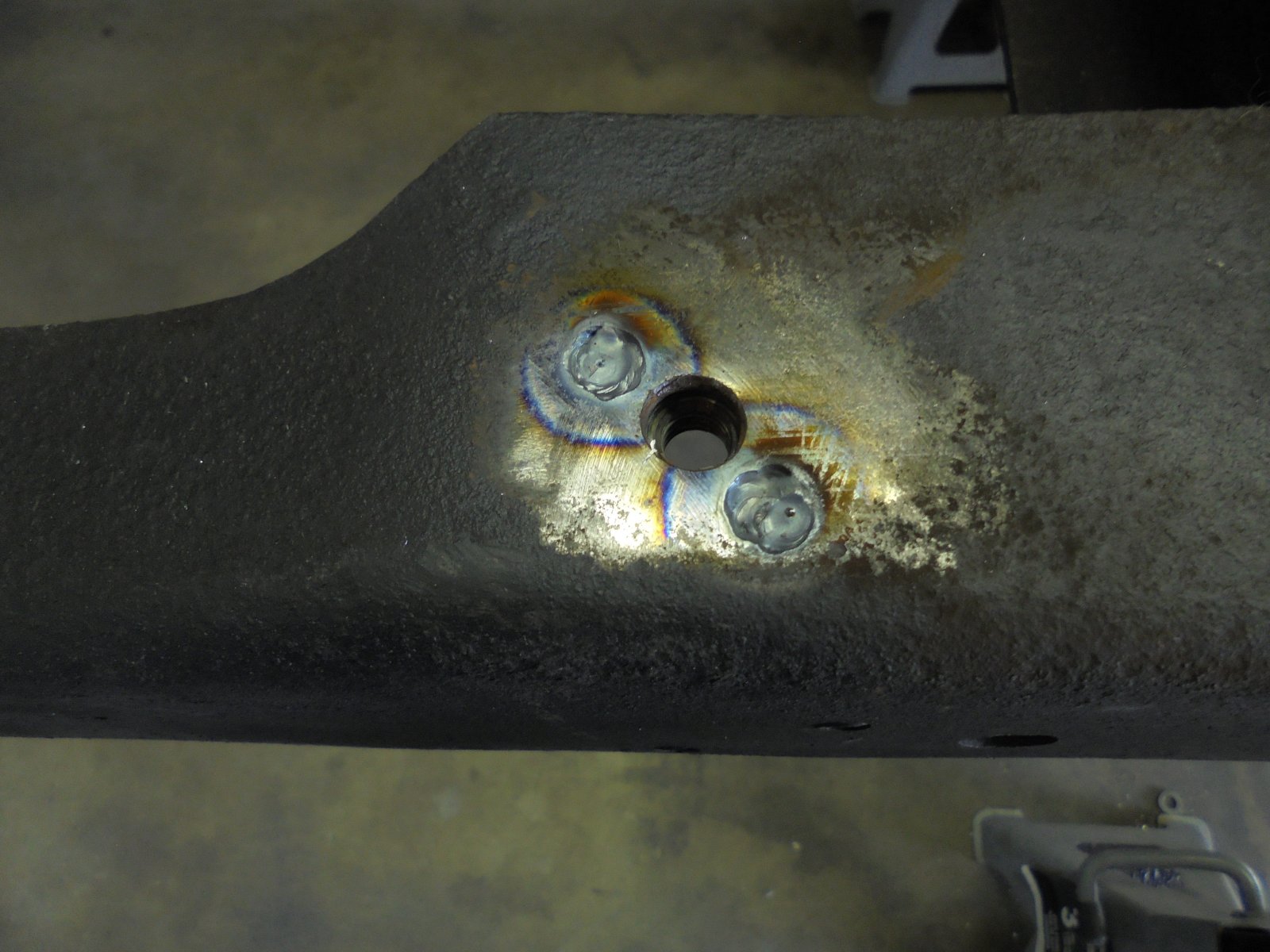

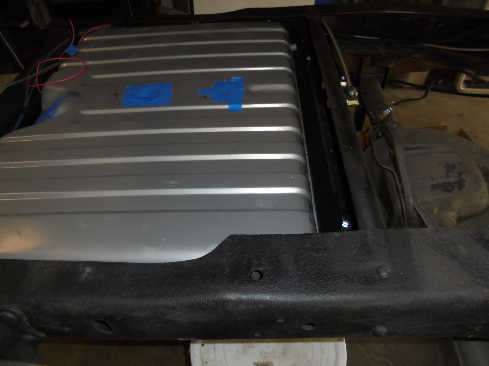

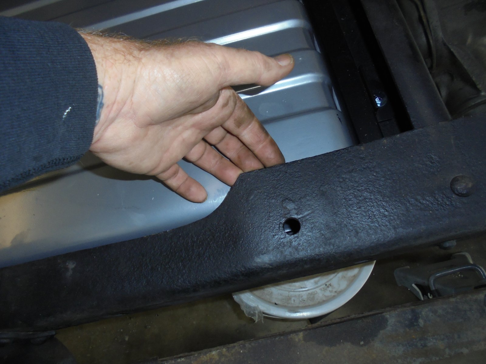

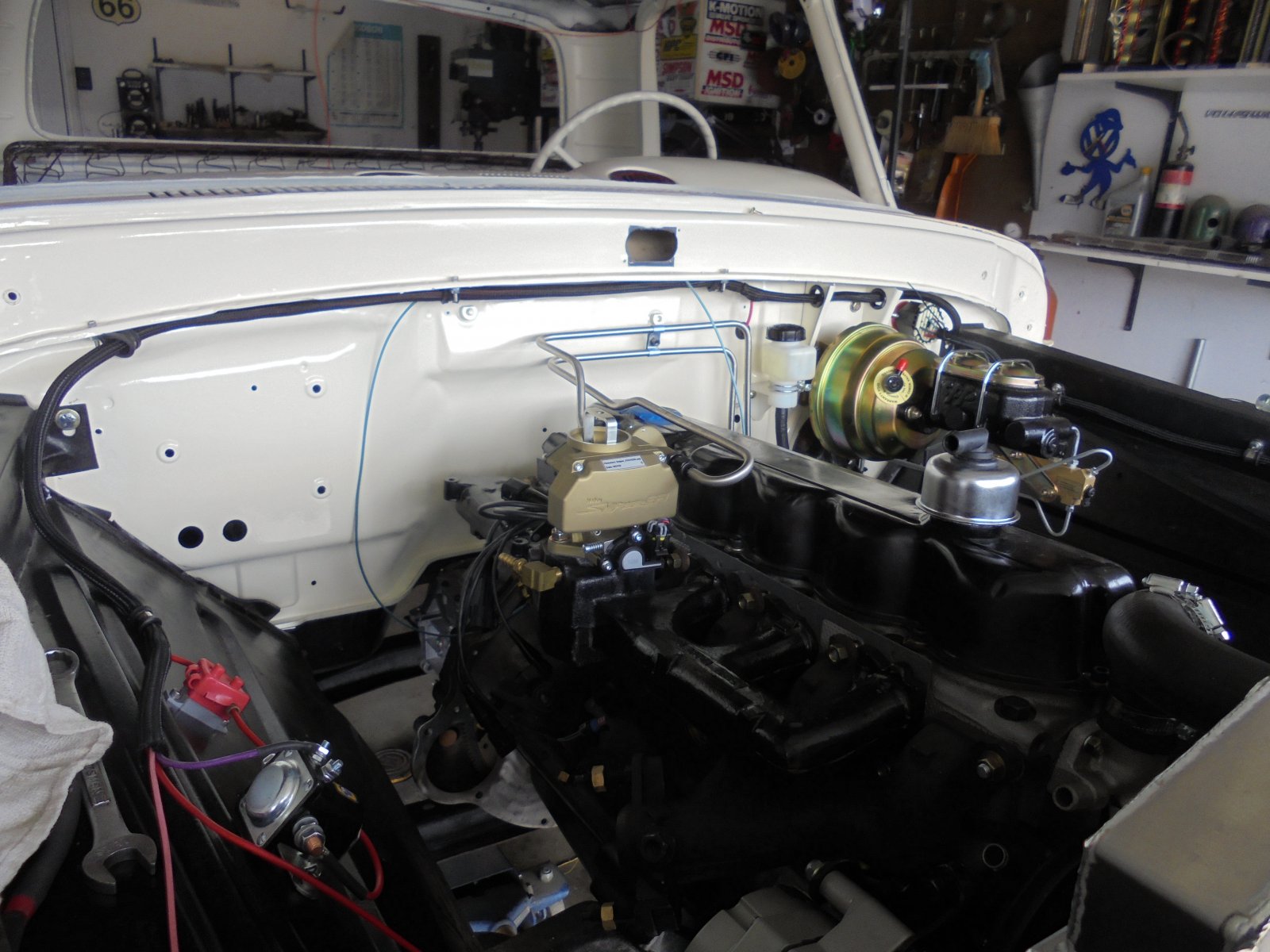

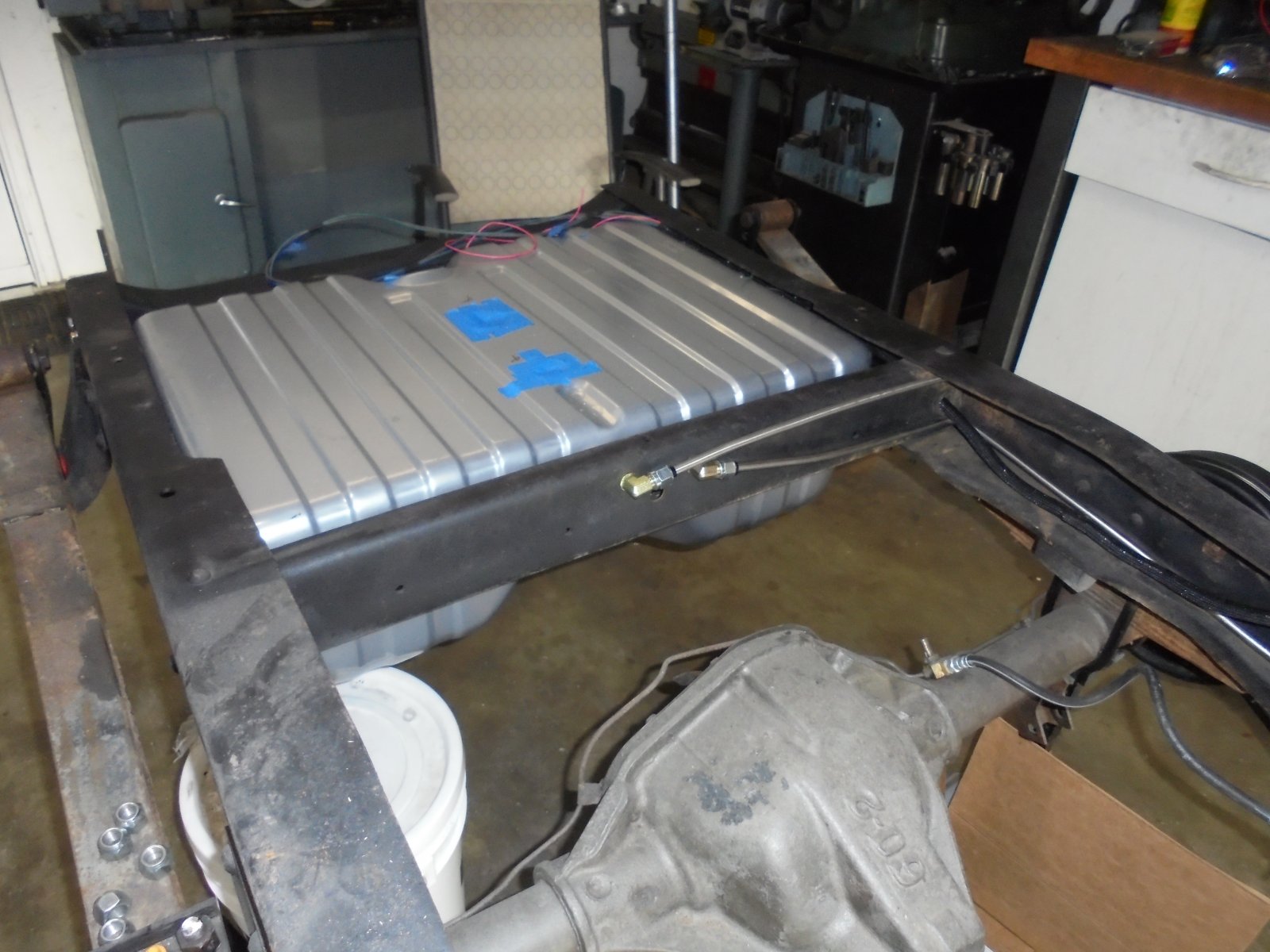

    When I installed the Mustang fuel tank in the back, I noticed there were two bed bolts that were no longer accessible. I welded a 7/16 nut onto a chunk of flat stock and then drilled a couple holes on either side of the bed bolt hole, and welded 'em on under the frame rail with a rosette weld. I'll have to the same with the bumper bracket holes.

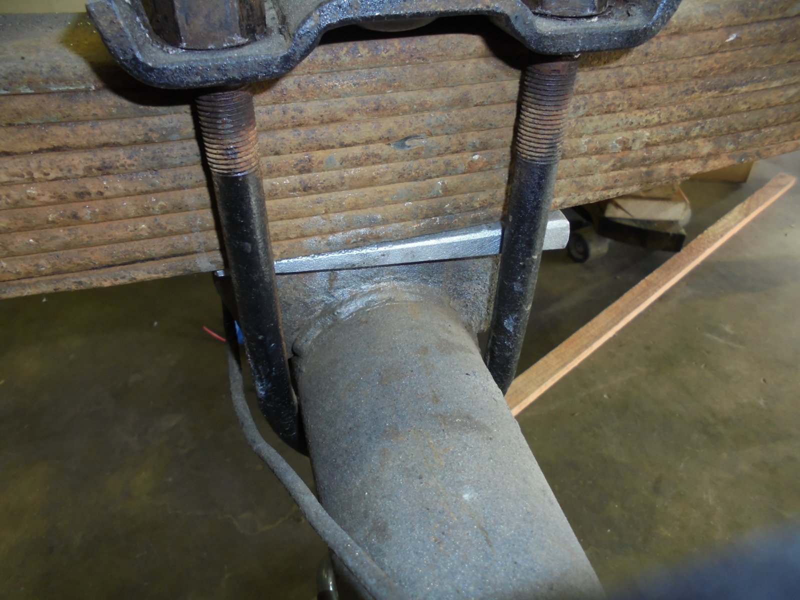

    Then I corrected the pinion angle. It was 5° up from the ****** tailshaft angle. A 5° wedge fixed that up.

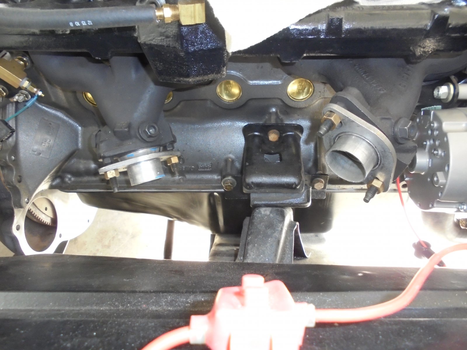

    Then made ground cables for the body to frame, and engine to frame. I made a tab that bolts to the motor to attach the ground cable to. The "convenient" bolt hole was 7/16". so basically a way to step it down to 3/8" so cable terminals could easily attach.
    I found some heater hose outlet caps instead of looping a hose until I get the Vintage Air unit I plan on using.
    And finally, made up the stubs to start building the exhaust. I ordered one of those "U-Build It" kits that has a bunch of 180s, 90s and 45° bends along with straight sections, plus two Thrush turbo mufflers.

    It's always the small things that keep one from finishing a task. In finalizing the fuel lines, all I had to do was cut and flare the ends of the tubes going to the throttle body, and make four hoses. As it turns out, I had Aeroquip hose and most of the hose ends I needed. I had bought two Fragola fittings that are supposed to work with PTFE braided hose.....apparently, just not aeroquip's hose. But, just two hoses left to put on one fitting each, and the fuel system will be done!
    I did finish all my ground cables. Body to ch***is to engine block. So, I connected the ground cable to the battery. No big sparks, no smoking wires....which is usually a good sign! And, she has some brain waves! Dash lights work, gauges cycled, ignition wire to the coil is hot, headlight wires are hot.....won't be long now.

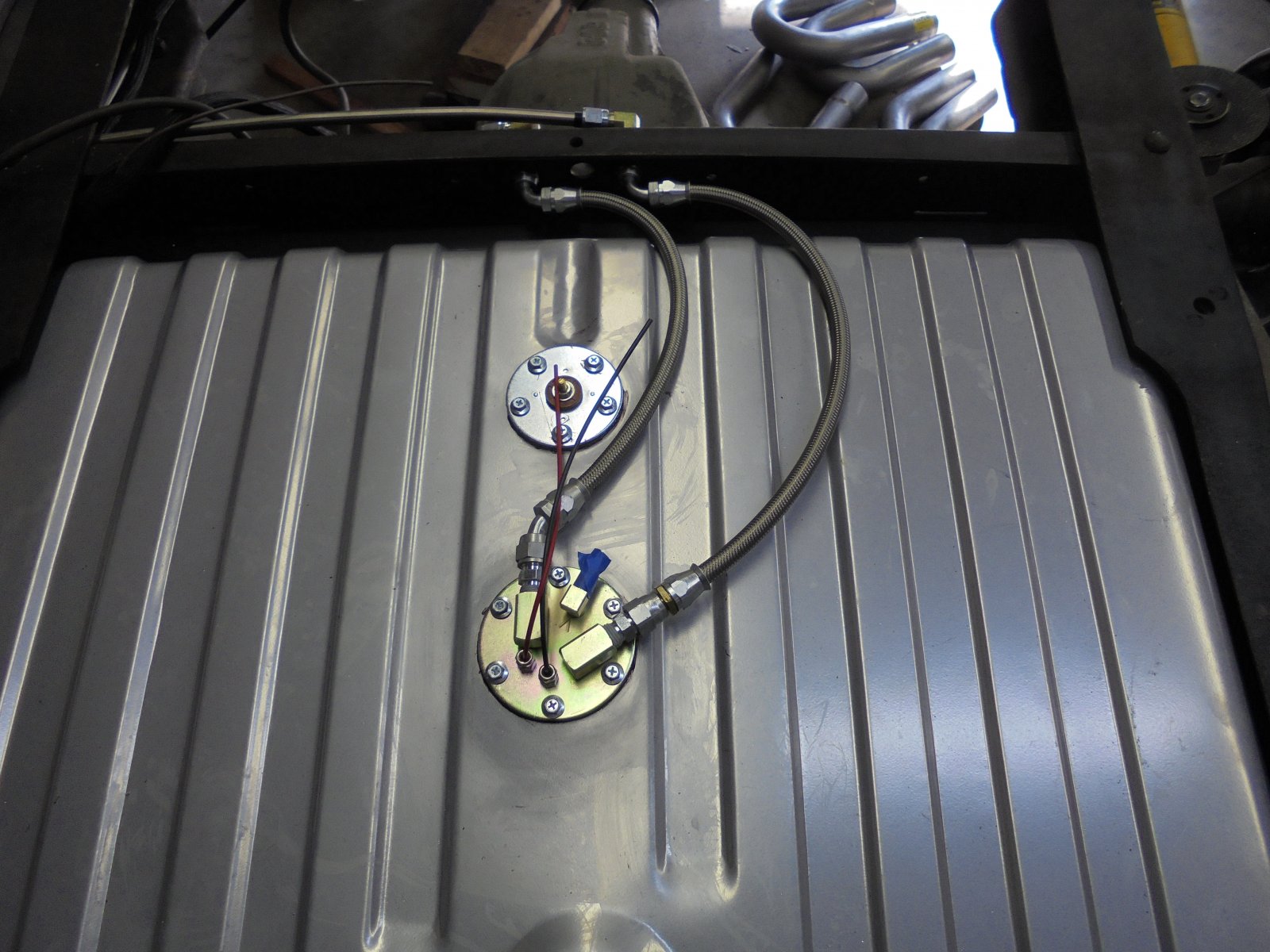

    Fuel system plumbing is DONE!

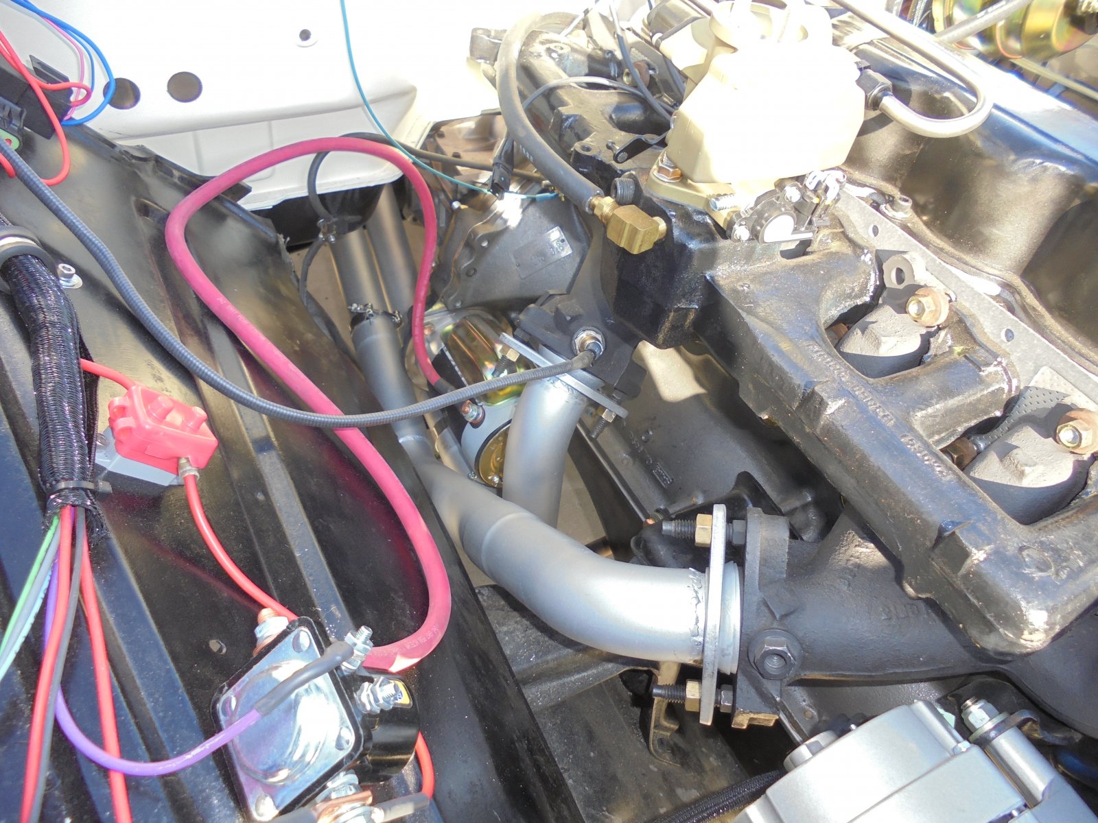

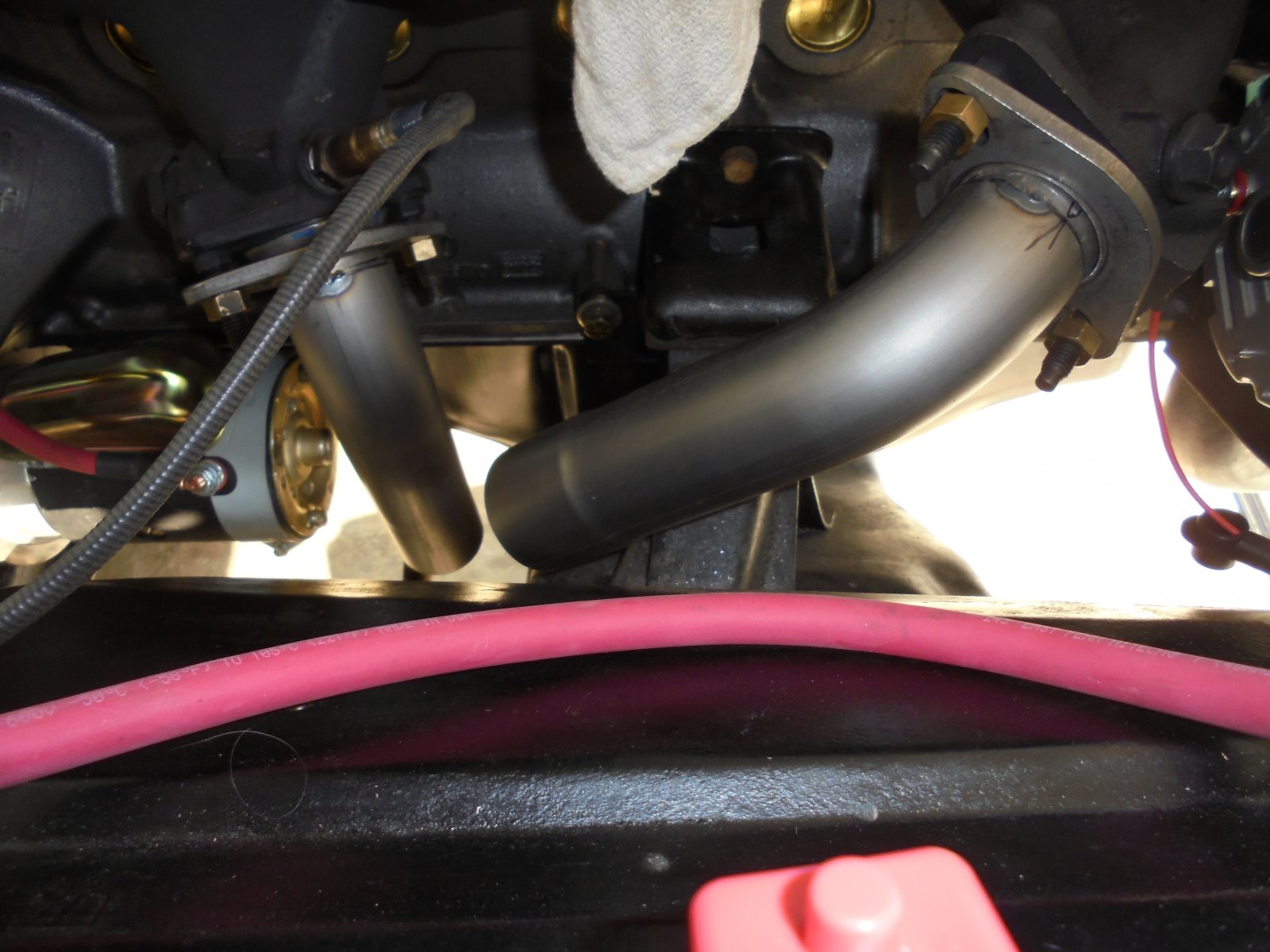

    Finally got around to picking up a starter, and made the last of the heavy battery cables, which was from the solenoid to the starter. Connected the battery again and checked that circuit. And I'll be danged, it works!
    So now with the starter in, I can start getting the exhaust routed.

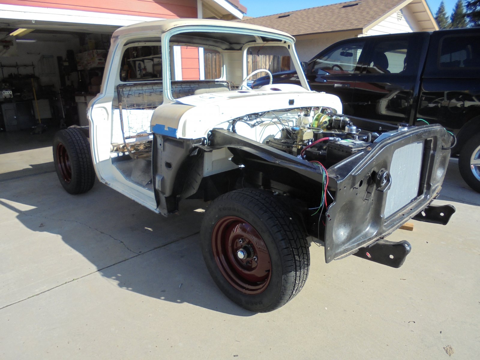

    Seems that things are progressing quickly now that I have a bit of time on my hands! This retirement thing....Still not over the guilt feeling of not going to work every day.

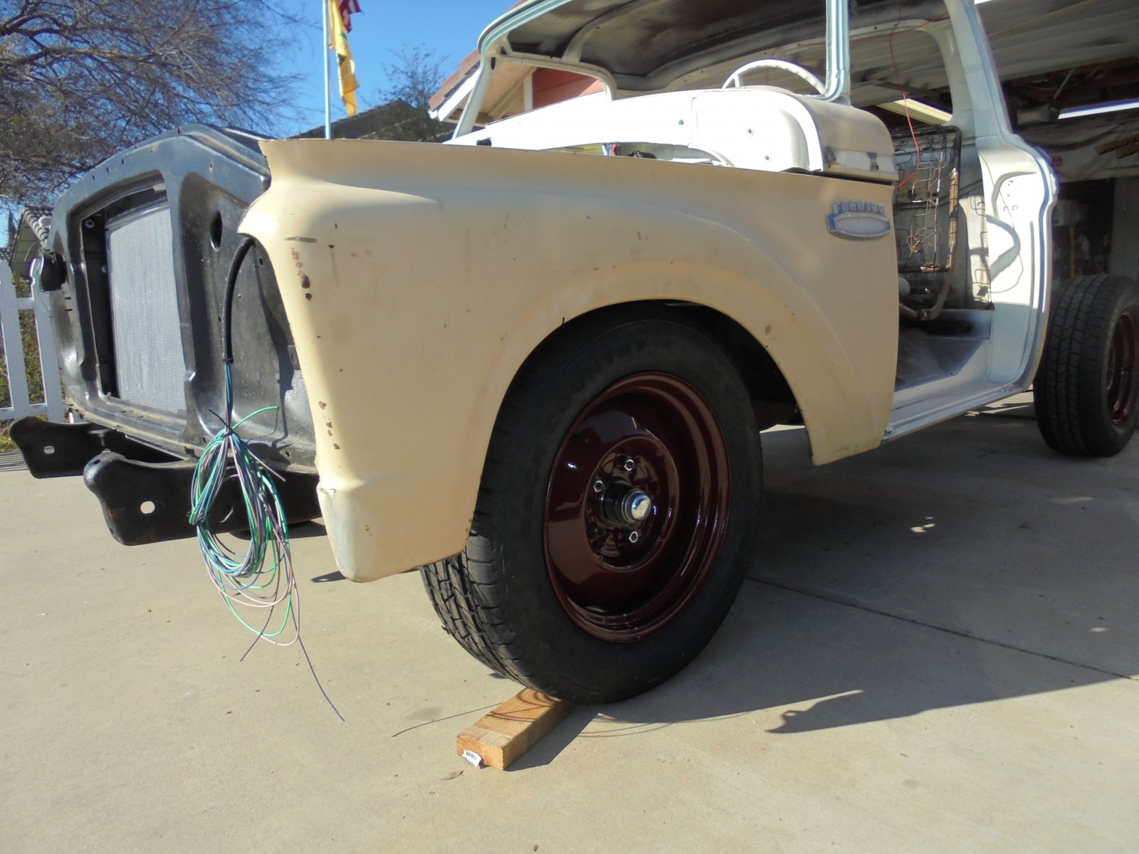

    Anyway, got tires mounted and on the truck. Staggered sizes. 255/65X17 out back, 225/65X17 up front. Should have a nice rake!
    Exhaust head pipes are tacked together and pointing rearward. I ran out of argon, so I stopped for the day at noon yesterday and went to play golf with my neighbor. A couple of duffed greenside pitches cost me the Championship of the Entire Street!

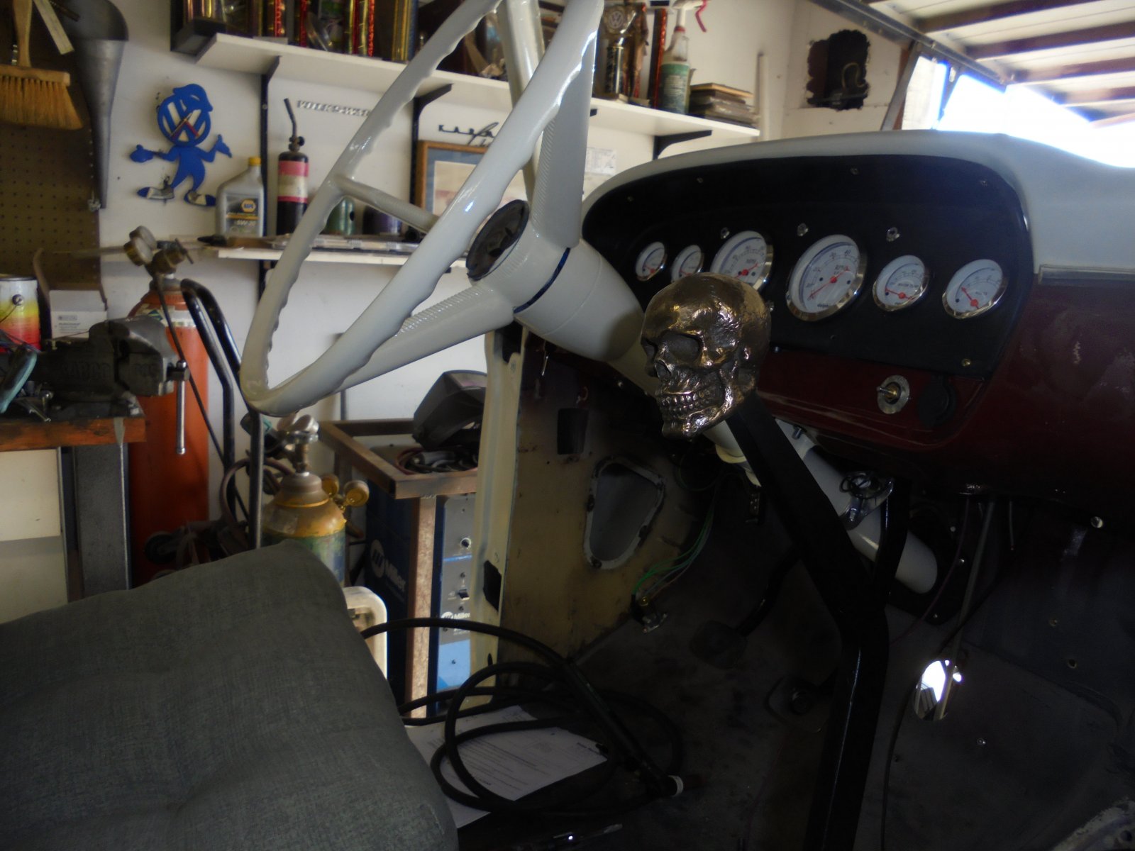

    But, with the truck sittin' on all four, I had to wheel it out and admire my work....as well as clean up under where the truck has been sitting.

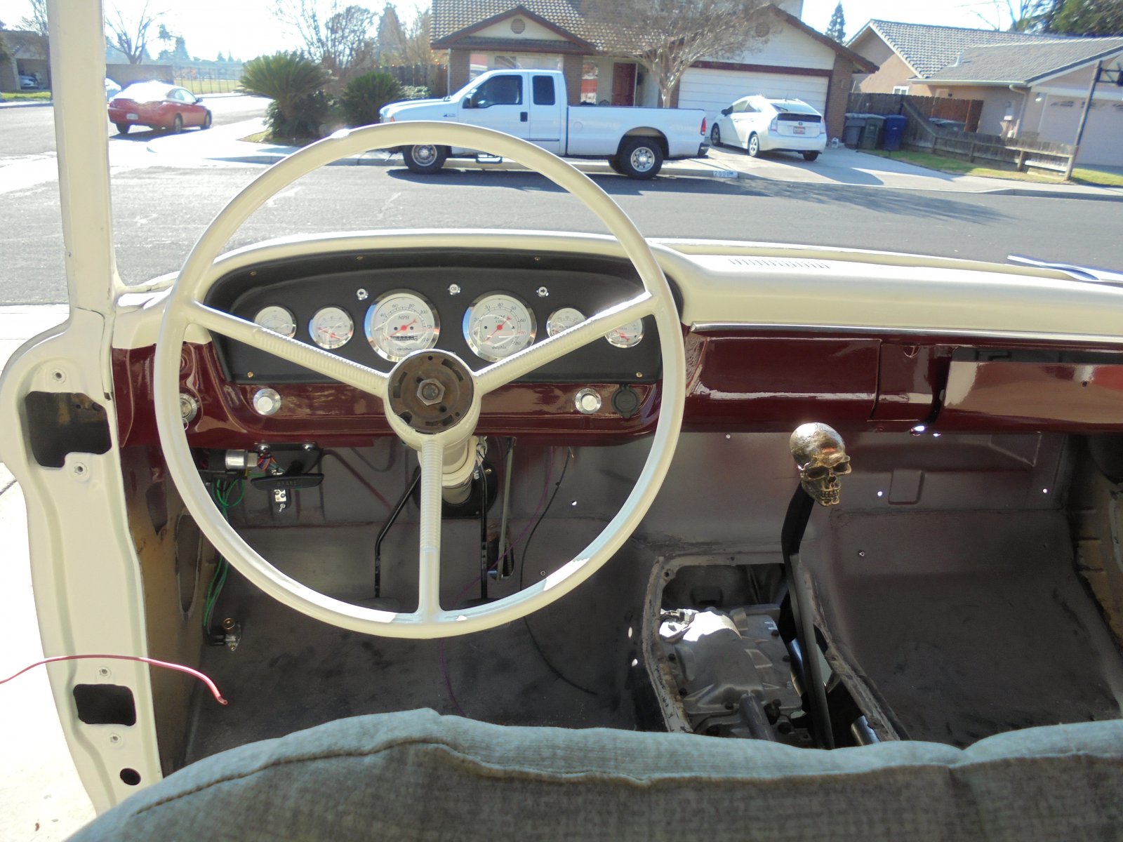

    That shift knob is just a cheap knick-nack I picked up in New Orleans a couple years ago at a street fair. The comments of friends neighbors and relatives have all been, "Do the eyes light up like in Armageddon?"

    Get a couple of LEDs in there that light up - maybe off the reverse back-up light circuit.

    Maybe later. Might be kinda funny to do that with the turn signals!

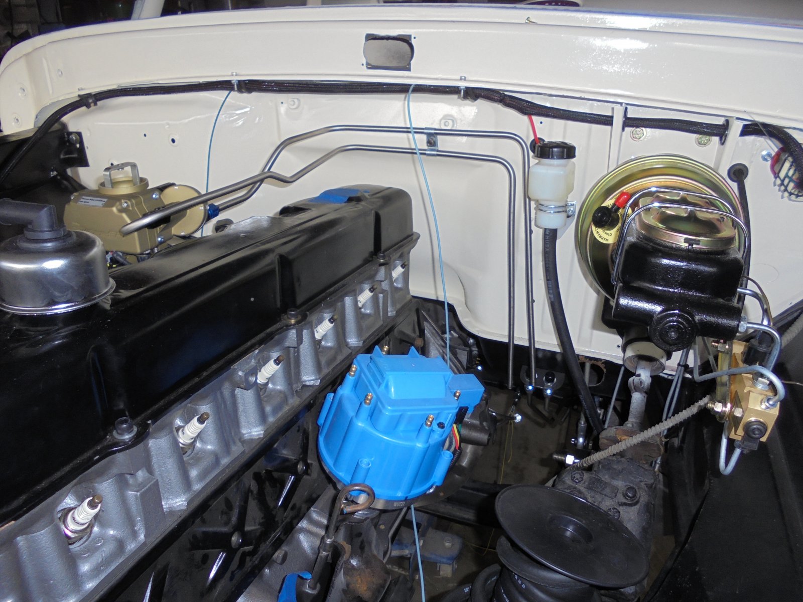

    connielu
    Nice work! I usually don't comment on designs of someone's build but shouldn't your fuel flex lines be between the firewall and engine?
  18. Mike Lawless
    Posts: 867
    Mike Lawless
    They are. The hardlines below are anchored to the body. The hardlines you see seemingly on the firewall, are (or will be when I finish the brackets) anchored to the engine in two places.

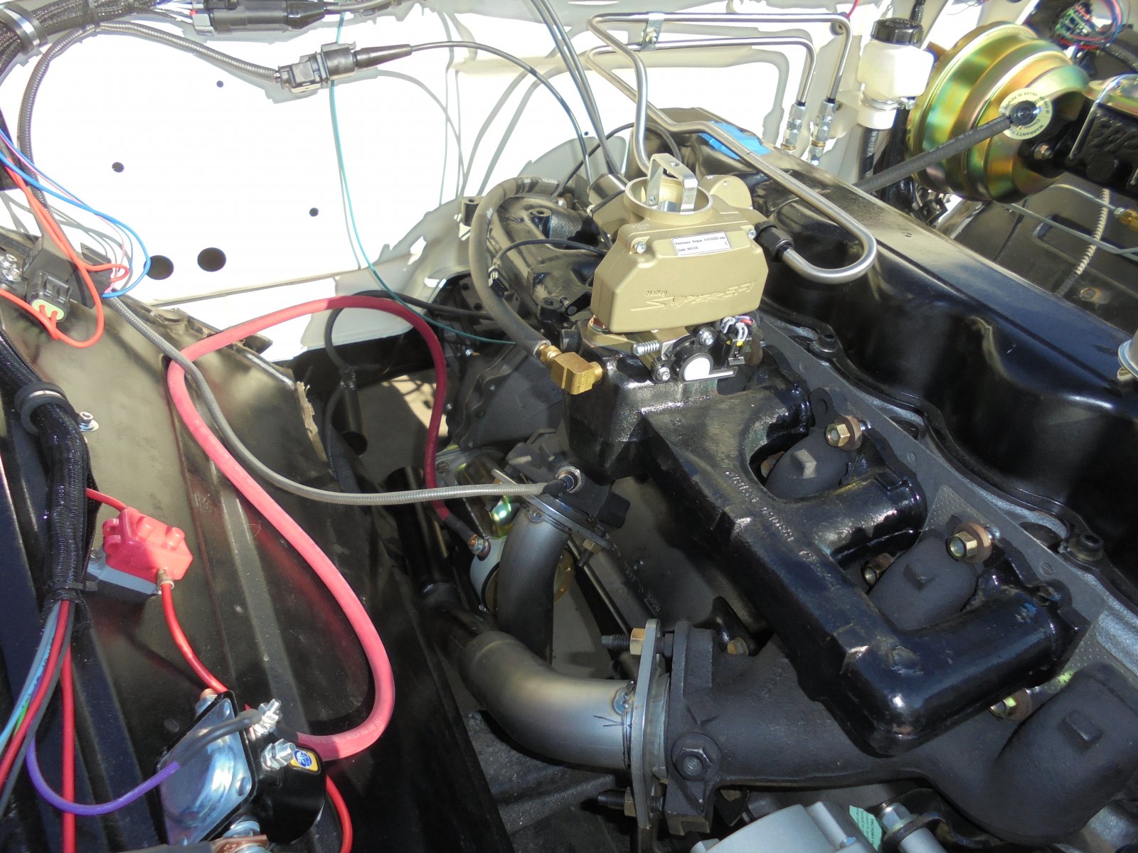

    Productive day! Finished the exhaust system to the back of the mufflers. Just need to figure out the hangers. I painted the entire thing with VHT high heat aluminum to keep rust away.
    Also finished up a lot of little mundane tasks, such making the fuel pump electrical connections, clamping radiator hoses, making an alternator adjustment arm. The one that was on it just disappeared somewheres. So I just bought a generic one and made it fit.
    I hung a front fender because I was anxious to see how the front ended up with the dropped beams. The top of the fender arch dips below the top of the tire by about 1/2 inch. Once the rest of the bodywork is back on, it'll likely drop around another 1/2"
    Then I smeared the face of the lifters with ARP molybdenum break in grease, popped in the holes and ****oned the side cover on, permanent like!
    The next big hurdle is spinning the motor over without plugs or rockers to build oil pressure without wiping all the lube off the cam and lifters. I always wait to put the valvetrain on until after I do the spin thing. I want to give the cam it's best chance of breaking in correctly.
    Anyway, spun it over with the starter for about 15-20 seconds, and it showed 40psi. Done!
    Now, with the timing pre-set, and as long as the fuel pump turns on like it should, it should fire right off.

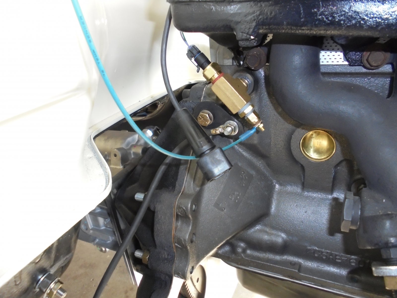

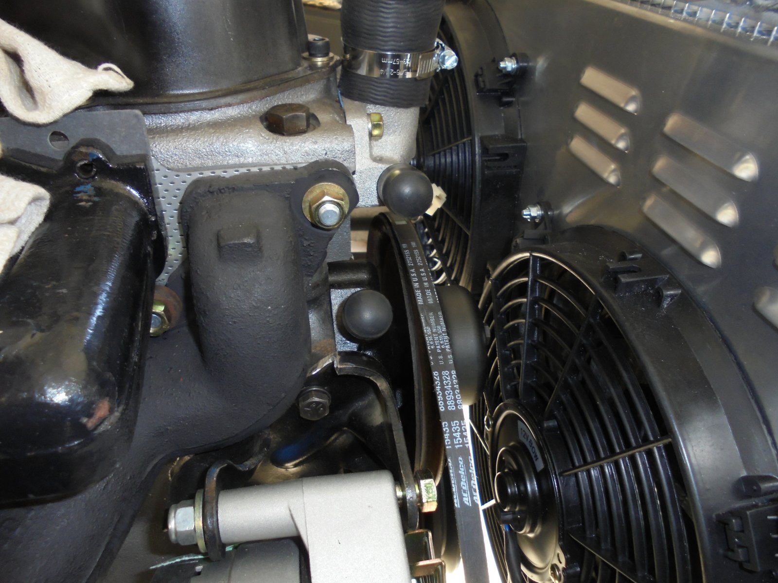

  25. You probably know this but I thought I would mention it. Where your upper coolant sensor is in the tee, it may create a bubble and fail to read properly. If you bleed it some how, you may have one less item to deal with. I used a sniper on my latest project. I only have 150 miles on it so far but by following directions, it fired up 1st try. People look for shortcuts that cause problems. :)
    Thor1 likes this.
  26. Mike Lawless
    Posts: 867
    Mike Lawless
    Thanks WFO.
    That is the only port. I know it could be a potential problem. If it does cause trouble, I reckon I'll have to figure something out.
