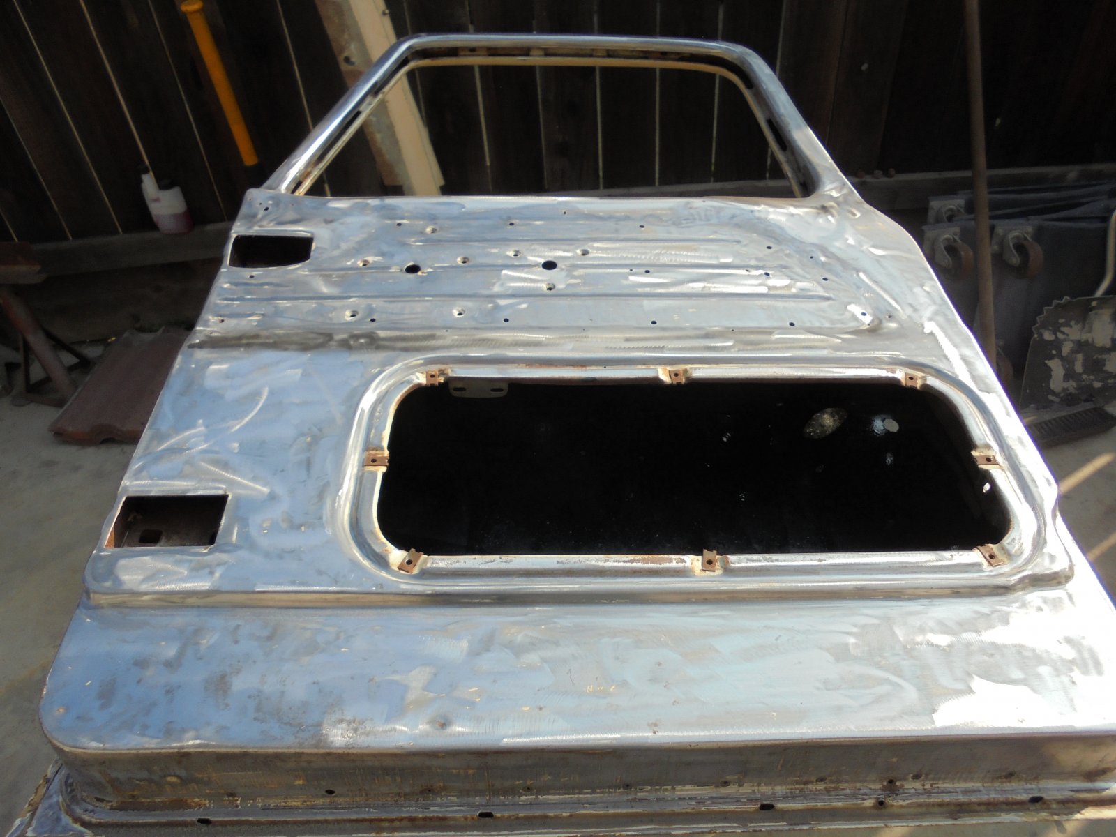

    So onto the doors. They are a mess. Not much rust on the sheetmetal though, which is good. No metal repairs!

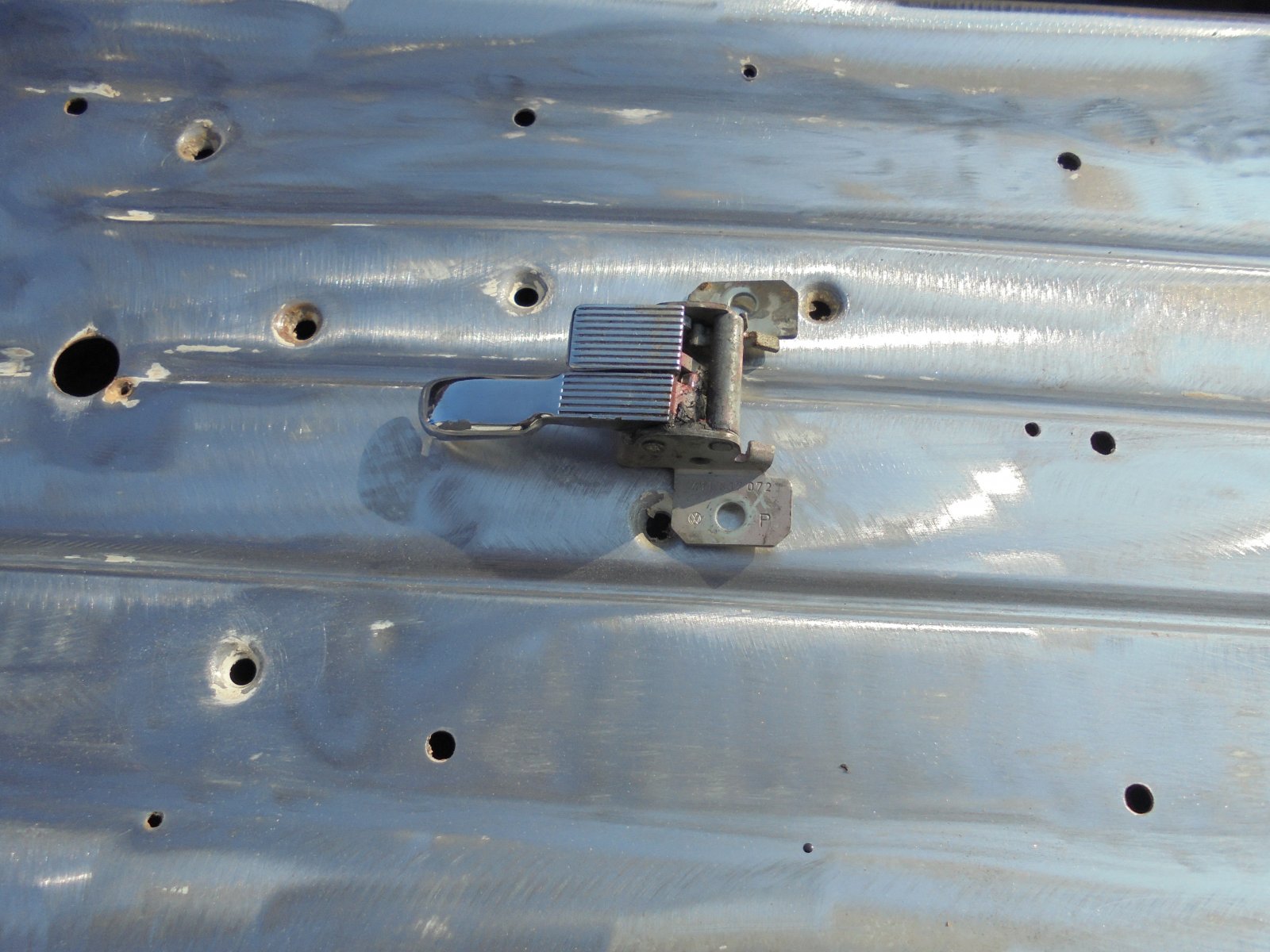

    All the mechanisms are FUBAR. The spindles that the door handles fit on are stripped. Either really ******ed up splines or none at all. Someone had drilled and tapped for set screws going through the handle and into the spindle. That ******ed 'em up pretty bad too.
    Repopped stuff is listed, but the window risers are out of stock and pretty expensive as compared to other types. For an extra hundred bucks or so, I can just go with a power window kit. So I think that's the way I'll go.
    On the door latch lever, rather than go with a clunky stock style lever, I'm gonna retro-fit a pull lever out of something else, and mold in a surround into the door panel.
    The p***enger side door took a few hours to strip and sand for etching primer, which I will spray later today to get some protection. Pictured, laying on the door is a lever from a late 60s VW. Very simple. Very cheap and easy to adapt with plenty of pull travel.
    The driver side door won't be so easy. The riser mechanism is locked up. So that should be interesting to get apart!
    The big rectangular hole at the bottom of the door just has a sheet metal panel the screws on. And nobody ever cut it for speakers! Amazing!
    But I think I wanna fab up some door pockets. I goota think about making something from ****ch or cutting up the existing panels. First, I gotta see how much room there is between the door and the seat.

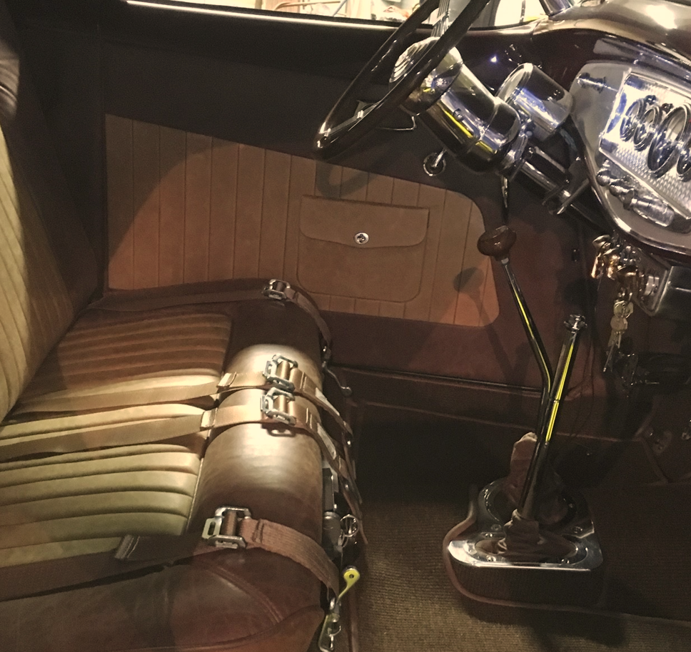

    This is not a great picture of my interior but you see the door pocket?
    It is practically flush with the door panel but it extends into the door 3 or 4"
    Deep enough for sungl***es and such. Just an idea when space is a premium

    I am aware of the factory door pockets. Although that would be easy, I still think I'd like to do something custom though. Much like Bandit Billy's.
    Thank you for the reference to Nu-Relics. Looks like just what the doctor ordered! The price is right too! I bookmarked that to come back to it later when I get ready.
    That is nice! I like that idear a lot. I just might steal that idear fair and square!

    Your for the takin. They surprise people when I pull out gl***es or a flask, er I mean water bottle, out of them since they look like map pockets.

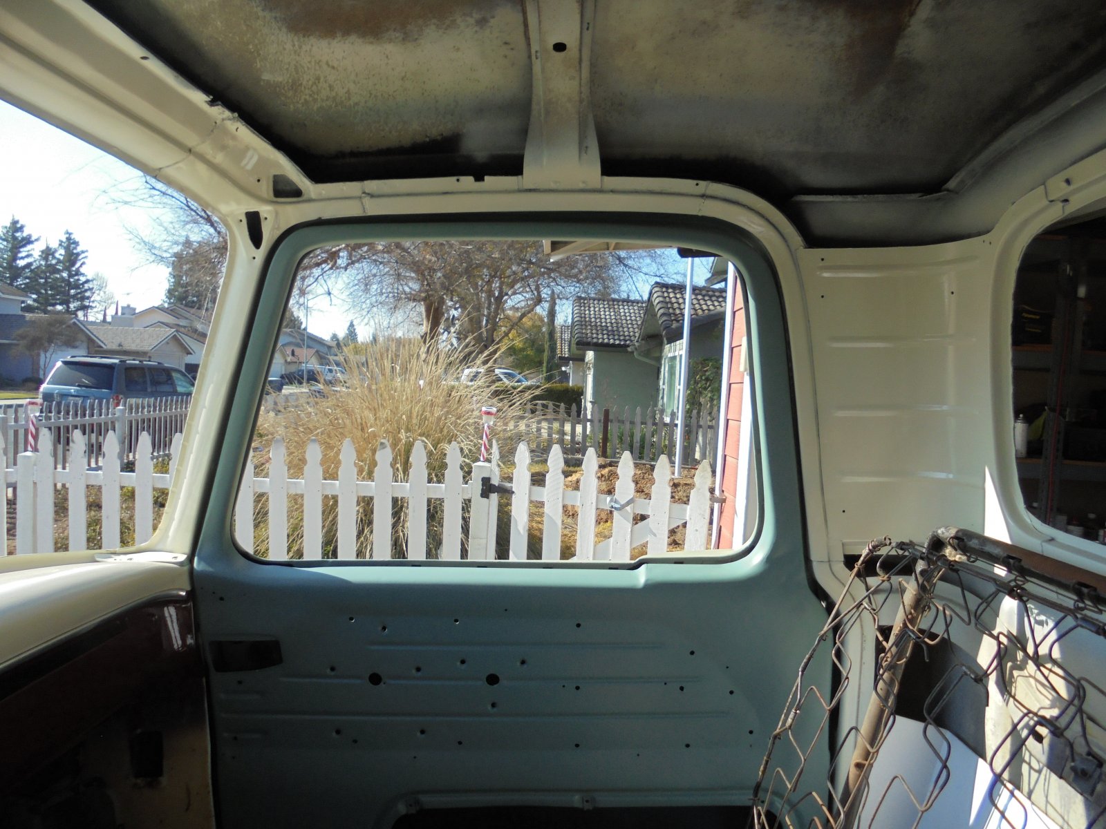

    I finished the unpleasant task of getting the doors apart, and getting the paint stripped off the inside. I pretty much have a blank canvas for arm rests, door latch levers, etc.
    I got 'em both fitted up back onto the truck, with door gaps as even as they are gonna get, unless there is considerable cutting and welding involved. Not gonna go there. It is by no means gonna be a show truck. This is just factory tolerances of the day I think, where close enough was good enough. (especially on a friday). After all, it's a truck, and not a p***enger car.
    The truck does not have any signs of ever being hit in the door. Although the driver side door has some filler where multiple types of mirrors have been mounted. Looks like maybe a mirror got side-swiped at one time, or something to that effect.
    But something presented itself that I just have to ask questions. While the exterior door gaps are within reason, the top rear of the door, while pretty close on the outside, has a pretty big gap inside. Big enough that I don't know if off the shelf weather stripping is gonna seal.
    So the question is, have any of you guys used any kind of spacers or foam shimming to take up big gaps on these older cars?

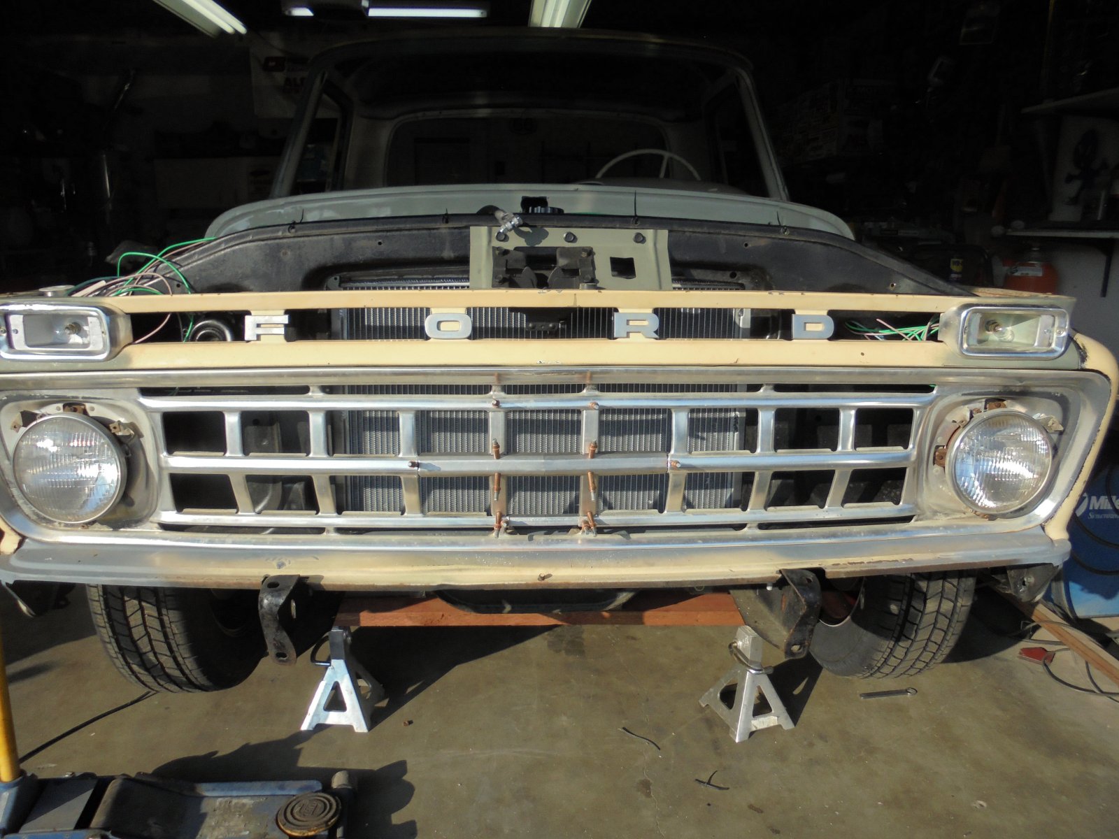

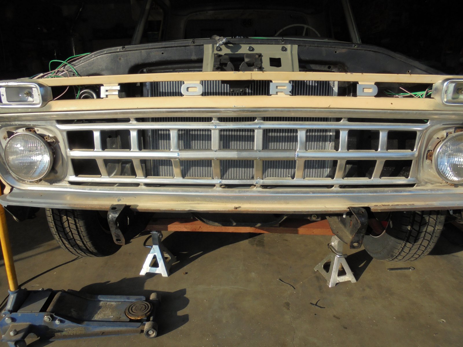

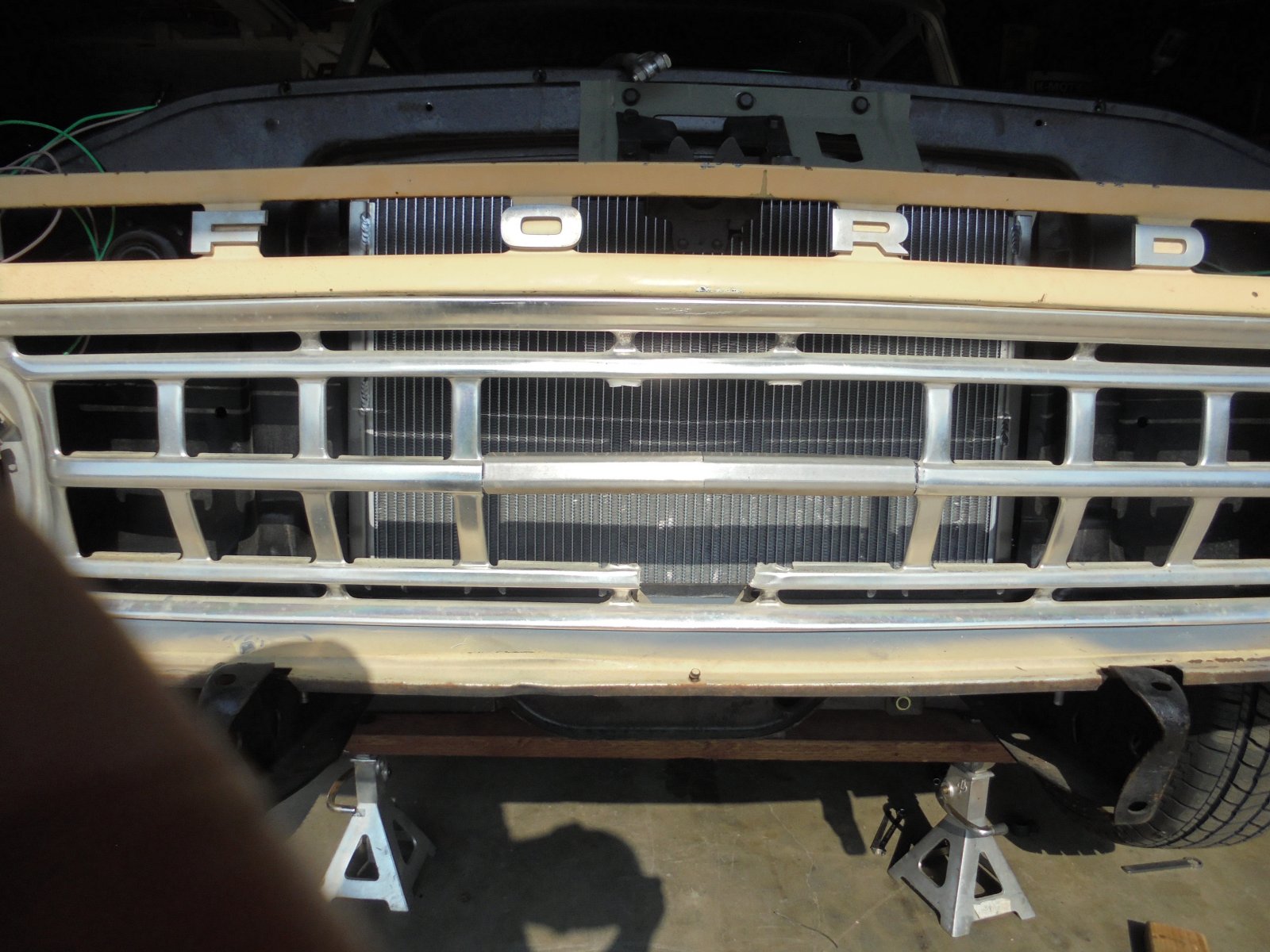

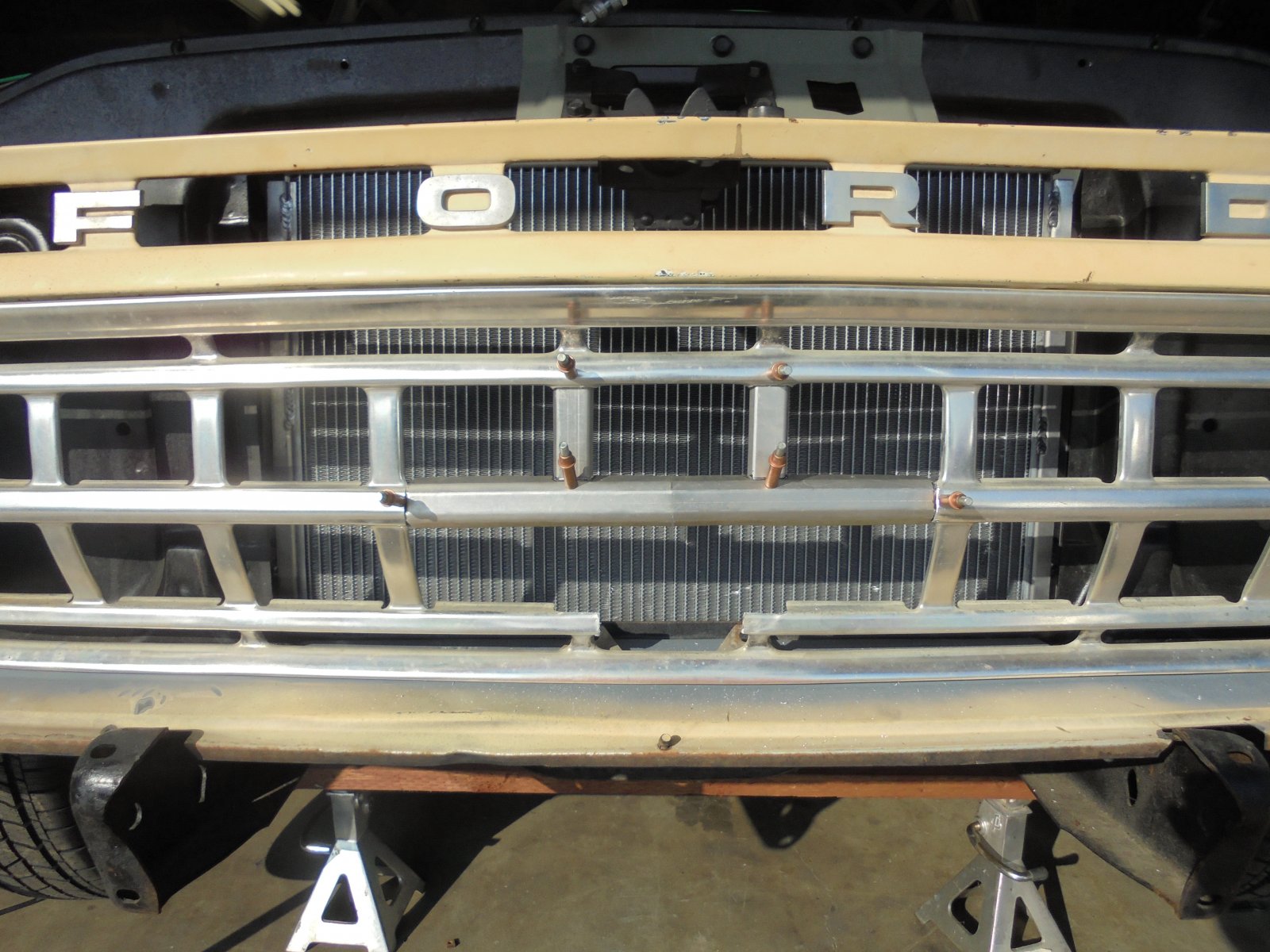

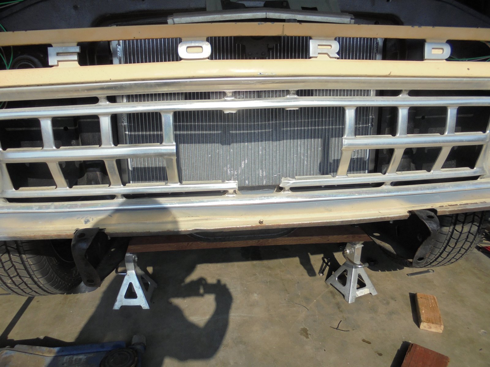

    The grill. Not much thought is given to a grill unless one needs one. Or in this case, has a grill, but somebody knocked its two front teeth out. Coulda been one of those argument of "Which is Better? Ford vs Chevy." Then led to violence and the ol'Furd gettin' it's teeth knocked out!
    Anyway, reproduction grills are beau coup bucks. Add in shipping, and it's near a grand.
    I thought about finishing the job, and removing the rest of its teeth and adapt a "billet" tube grill over from something else.
    However, being the tightwad that I am, and with a bunch of .050" thick aluminum sheet in stock, I decided to give 'er some false teeth.
    The result is far from perfect, and from 20 feet away, no one will even notice once I fill the seams with epoxy and paint it. Probably something along the lines of argent trim and wheel color.
