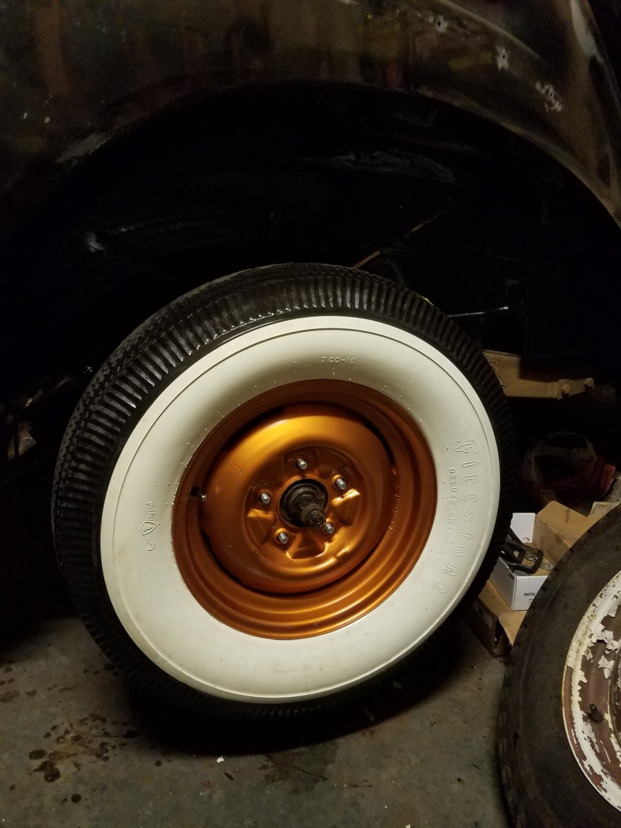

    Excellent progress, Jason. Everything looks great. Color on the wheels turned out nice!:)

    Had to see how the wheels looked after getting home with my boys from camp. I'm really digging it.

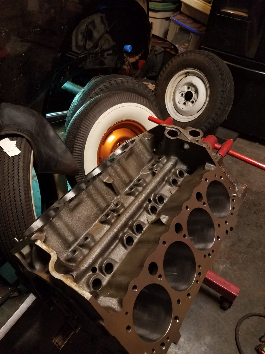

    After having the block, crank and rods in bags from the machine shop for over a year....its finally time to ***emble the motor!! Got my parts out and staged for cleaning in the morning. After a good block and crank scrub I'll be ready to start putting stuff together!! 20190728_210728.jpg 20190728_210736.jpg

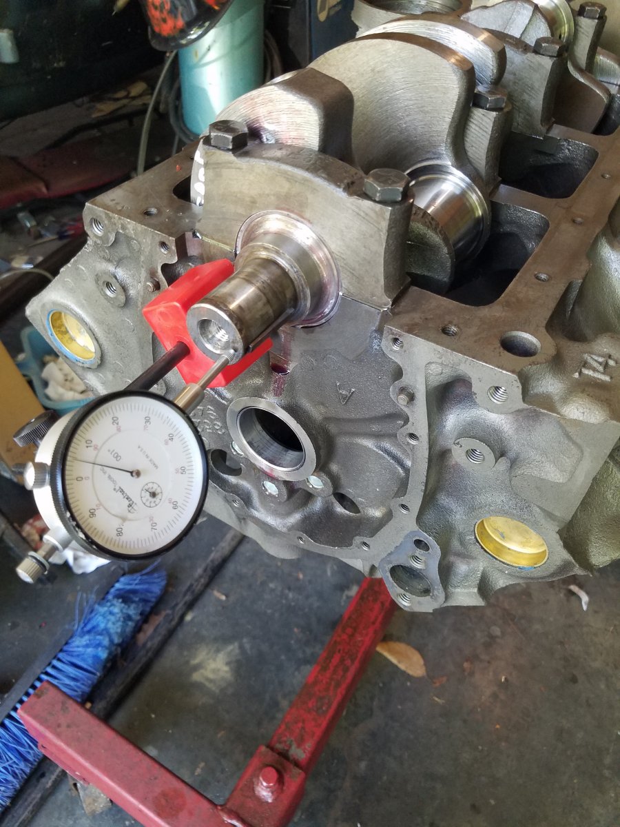

    Got the block, the crank and all the rods and pistons scrubbed and cleaned good. Then got all the clearances checked and everything p***ed. Got the crank in the block and then the rings on the pistons. I'll get the pistons in the block tomorrow after work.

    Started scrubbing this thing at 11am. Scrubbed the snot out of it for about 2 hours. Its clean now!

    And short block is ***embled!!! After not being able to find my snap on ring compressor I had to fight with a a band compressor. But I got them in and rods torqued. I hate you only torque these little rod bolts to 35 pounds. 20190731_222357.jpg

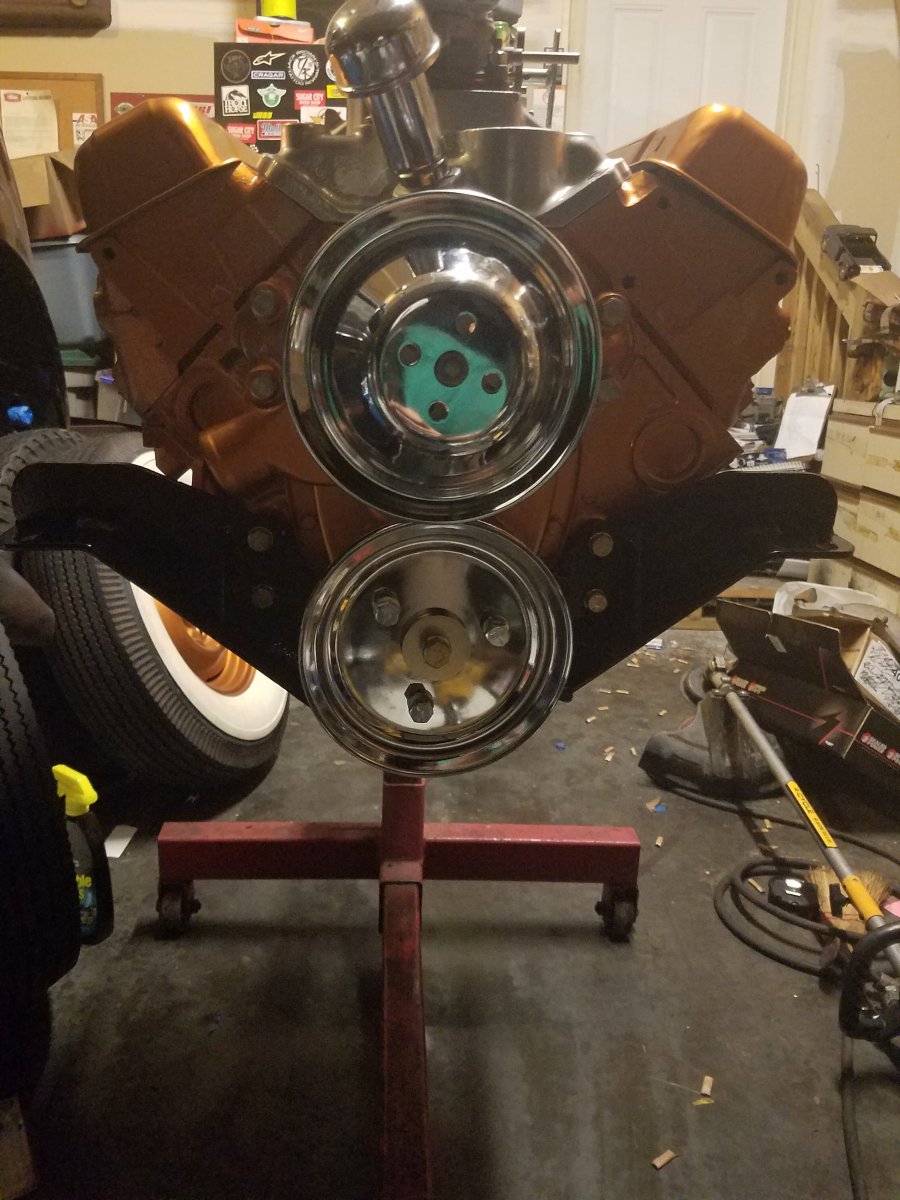

    I just put the hurst mount, crank hub and pulleys on it and something seems off shouldn't the one of the pulleys be smaller so it turns the pump faster than the crank? These are the same size so it would be a 1 to 1 ratio. This would make the water pump spin the same speed as the crank. I'm gonna search for my original pulleys, these are just cheap chrome ones from speedway. 20190803_234051.jpg

    You don't want the water pump to be turning too fast. I believe you're good with your pulleys, although I have to save it from that view, they look kind of close to each other. Maybe it's full in my eyes somehow. But here's a picture of a stocker.

    The water pump pulley is not tight just loose on the pump. When its flush on the pump have about 7/16 inch between the pulleys. The crank pulley is 6 3/4 inch across and the water pump is 7 1/8 inch across. So, after a little math..I think this is right.... if the crank pulley is spinning at 1000 rpm the water pump should be turning at 947 rpm making it under driven....I think this is right...
    Crank pulley 6.75 inches x 1000 rpm = 6,750
    6,750 rpm ÷ water pump pulley 7.125 = 947.368 RPM
    I remember the old pulleys were close but this crank pulley seems larger. I'll have to dig up the old ones, if I can find them.

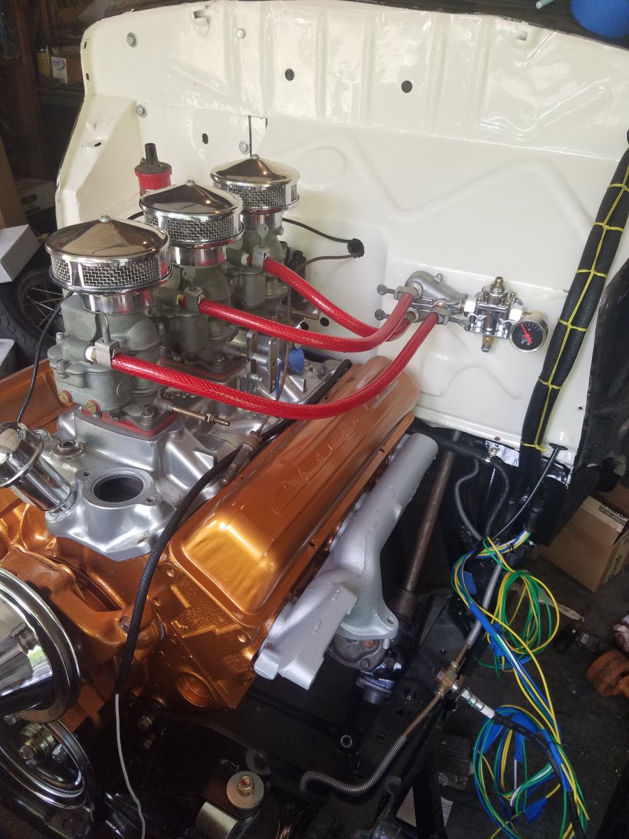

    Major milestone achieved tonight. After over 2 years with the motor out for rebuild and crossmember repair / frame cleanup and paint.....the motor is back in!!! Relly living how it looks against the white firewall. Gotta order those u shaped spacers for the motor mounts as my aluminum pan hits the bolts and its gonna need them for the motor to be at the right angle with the rake that's got. But it's in!!!! Now it's just do everything else to make it run!!!

    Got the wiring sorted to where it needs to go on the engine and put through the asphalt loom. Also got the exhaust manifolds ready to go and installed. Gonna work on building pipes so I can get this thing fired up. 20190808_233442.jpg 20190809_212719.jpg 20190809_215726.jpg

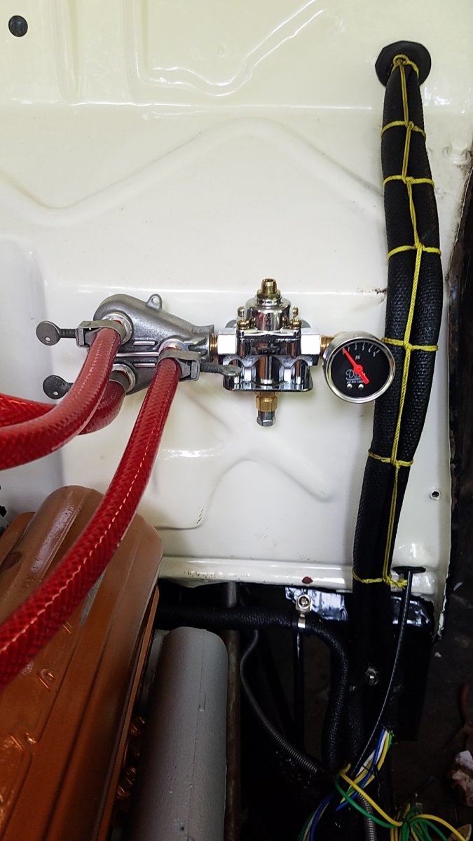

    Got the motor properly installed today and got the fuel pressure regulator and fuel block installed today. Even got some NOS Wittek clamps for the fuel lines to the carbs. Love this killer low pressure fuel pressure guage from ****s Hot Rod carbs. 20190810_161846.jpg 20190810_161900.jpg 20190810_155101.jpg 20190810_155105.jpg
