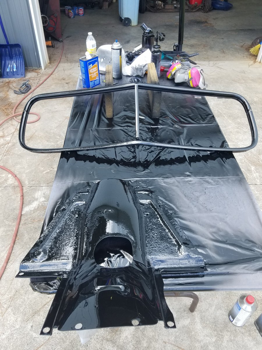

    Got the rest of my black parts painted and ready to go in, column tube and drop, horn ****on, trans cover panel and the wind shield frame. Got the Drop re***embled and installed with the column tube and got the column switch wired up. Finally got to bolt the banjo wheel on, and its looking pretty good.

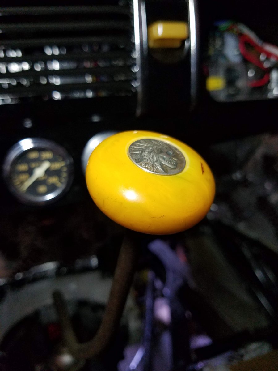

    finally get to put one of the shift knobs on that I got from @jimmygrrr it matches the factory knobs almost perfect.

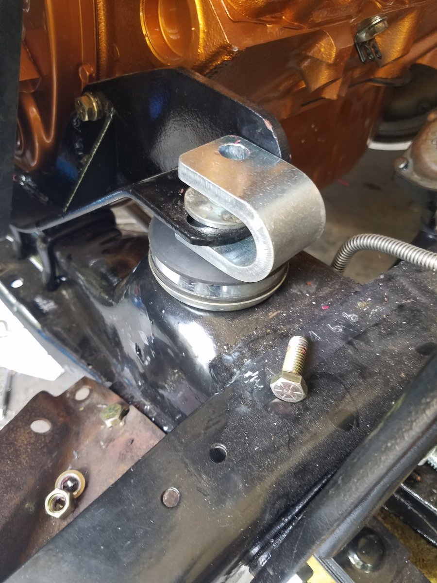

    Also it was really tight against the firewall with the distributor. So to remedy that, I swapped out the oil pan back to a steel one so I could get the clearance need at the front crossmember to lower the motor back down on the spacers. Dropping the motor down gave me another inch almost of space. 20190906_143429.jpg

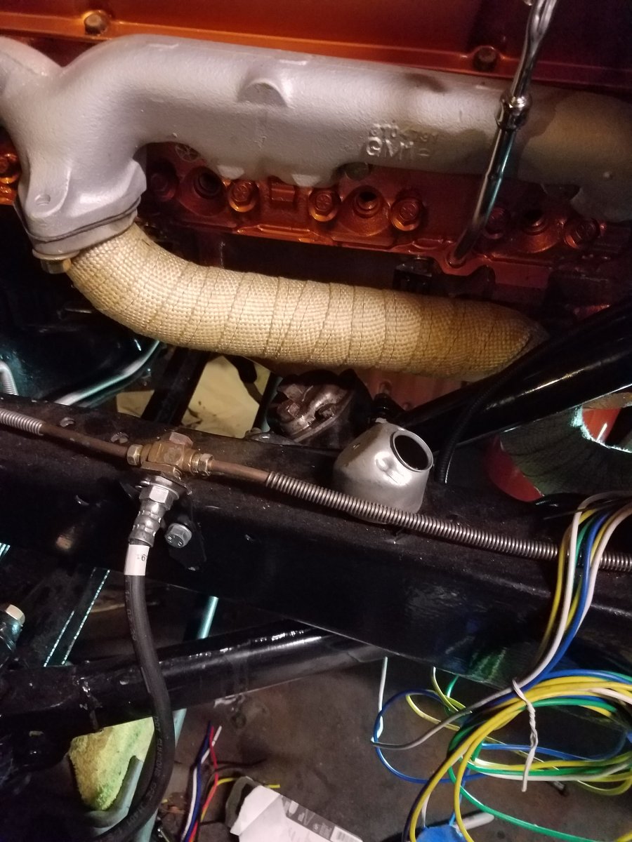

    With the motor dropped down some and clearance gained at the firewall, I could fab up the exhaust. Got it snaked around the steering box and pedals using a pile of 2 inch J bends from speedway and some 2 inch exhaust flanges. Once welded up, I wrapped them in exhaust heat wrap a d put it all back in with the 24 inch gl*** packs. With time running short I just made some turnouts in front of the rear wheels. I'll trim the tips to the appropriate length once the running boards are back on. Has a great a great old hot rod sound with the 097 cam.

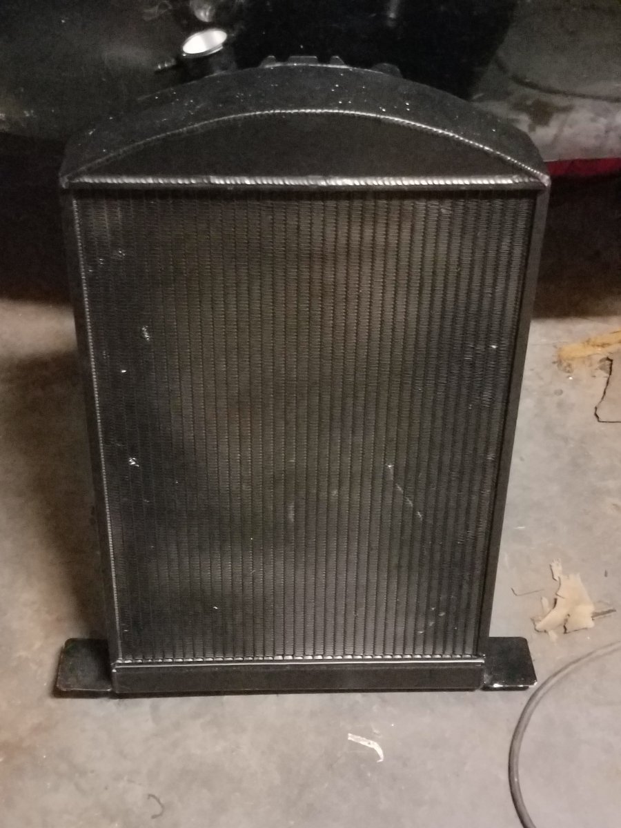

    Got the cam broke in last sat and some base running done on sunday. The radiator leaks like a sieve. But I should have a replacement for it tomorrow, plus I'm gonna drop this one off and have it re cored and all sealed up.

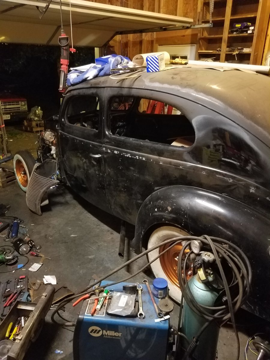

    Last night I got the gl*** in the doors replaced and about half done with changing the drivers quarter window. Steady progress, but I have a ton to get done by the 26th of Sept to head to the Old North State Invitational. It will be close but I get it there!

    Huge thanks to @A_Burly_Wind for hooking me up with a new Radiator so I can make it to Old North and TROG!! I'd be dead in the water without this!!! 20190918_213637.jpg

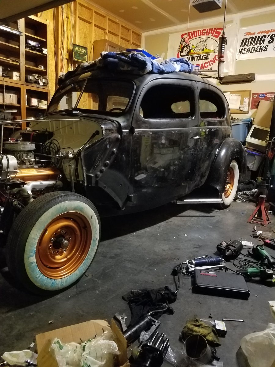

    Spent most of today getting everything wrapped up, greased and ready to test drive in the morning. My son Aiden helped me get the brakes all bled. And he stripped and painted the running boards for their coming new covers.
    Then I went over then entire ch***is and made sure everything was tight and installed about 1000 cotter pins.
    Finally I got all the wheels put back on it, had them balanced yesterday, and set back down on all 4 tires for the first time in 3 years. The stance looks awesome and cant wait ti roll it outside in the morning!! I'm 6 foot 2 inches and the top off the roof is right an my knose. Test drive tomorrow!! FULL ON THRASH IS IN EFFECT!! 20190921_223048.jpg 20190921_223106.jpg 20190921_232627.jpg

    She needs some fine tunning with the clutch and the timing....but she drives!!! First time in 42 years it has moved under it's own power!
