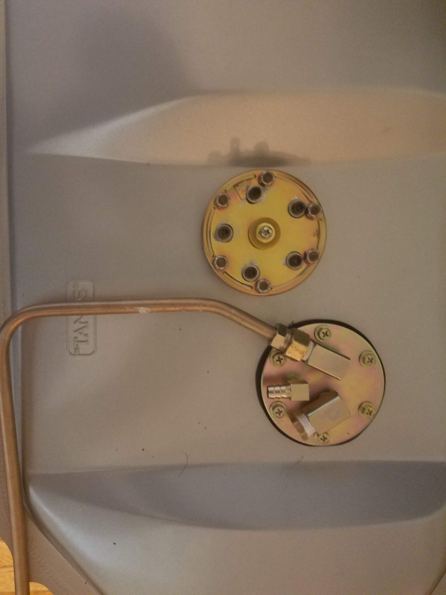

    Wow, now i know I'm a slacker! Is this an 'in tank' pump? Just asking cos Id like to use one, but cant find one thats low enough psi for carbs. Did you run a return line? thanks
  4. Nailhead Jason
    Joined: Sep 18, 2012
    Posts: 4,515
    Nailhead Jason
    No its not an in tank pump. I used a low pressure Carter fuel pump that just bolts to the frame rail. The Tank is A Tanks brand tank and can be equipped with an intank pump, as well as has a provision for a return line. I plugged my return port and just run the supply line. I will be going to a larger fuel pump soon as the one that I put in it was to supply 3 94 carbs, so I need the super low pressure. The edelbrock 4 barrel I ended up using just about out runs the fuel pump so I have a bigger one to swap it out with.
  5. Nailhead Jason
    Posts: 4,515
    Nailhead Jason
    If you want to run an intank pump, talk to TANK's and then run a pressure regulator. I believe in pressure regulators and a guage when running electric fuel pumps, Mine put out barely 2 PSI so it would work well with 94's or 97's.

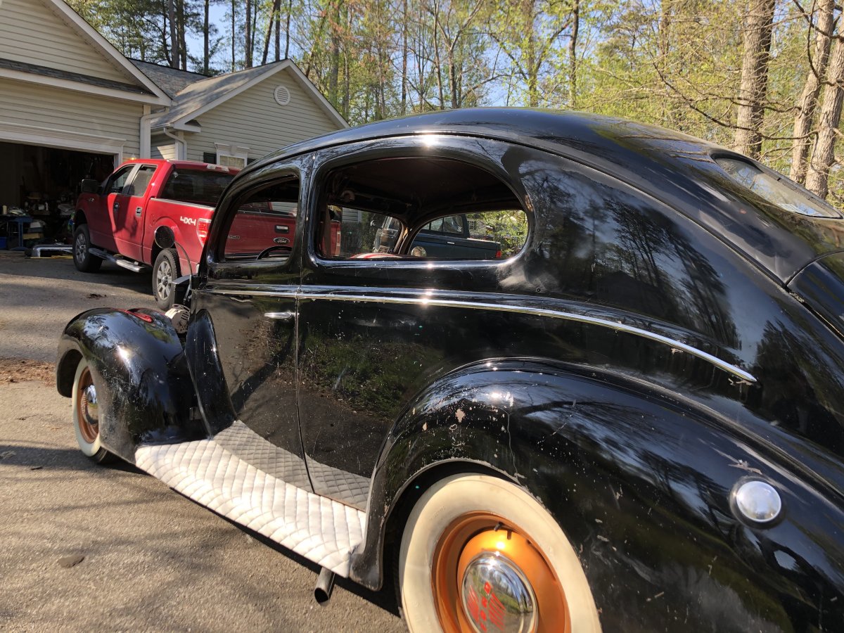

  9. Nailhead Jason
    Posts: 4,515
    Nailhead Jason

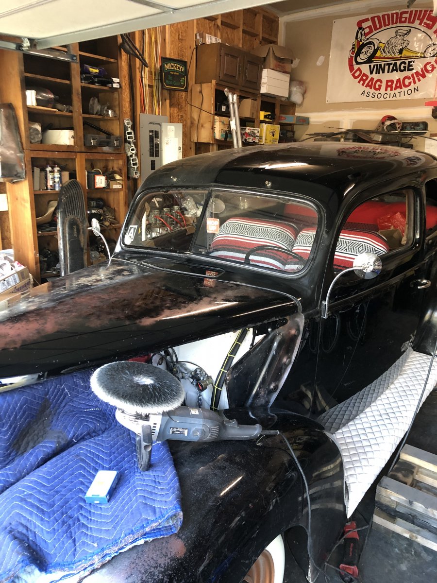

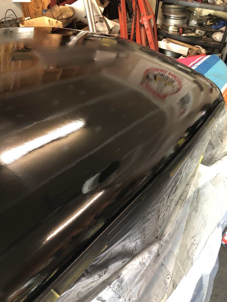

    Haven’t updated this in a while. Been working on getting the paint looking better. I started with just hosing it off and then going at it with the buffer. 35571E5E-D2BF-4E9D-976B-6AF7D35D7424.jpeg

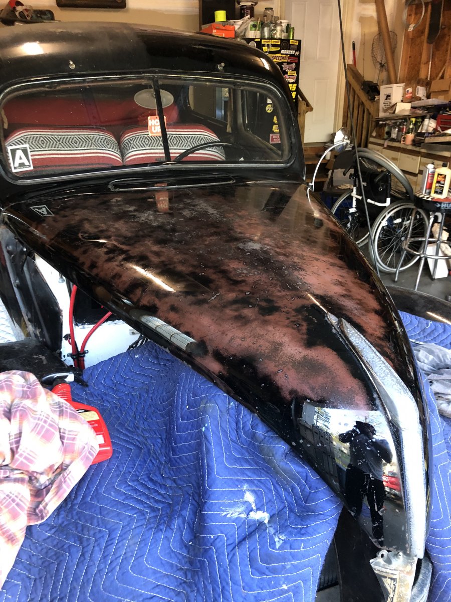

  10. Nailhead Jason
    Posts: 4,515
    Nailhead Jason

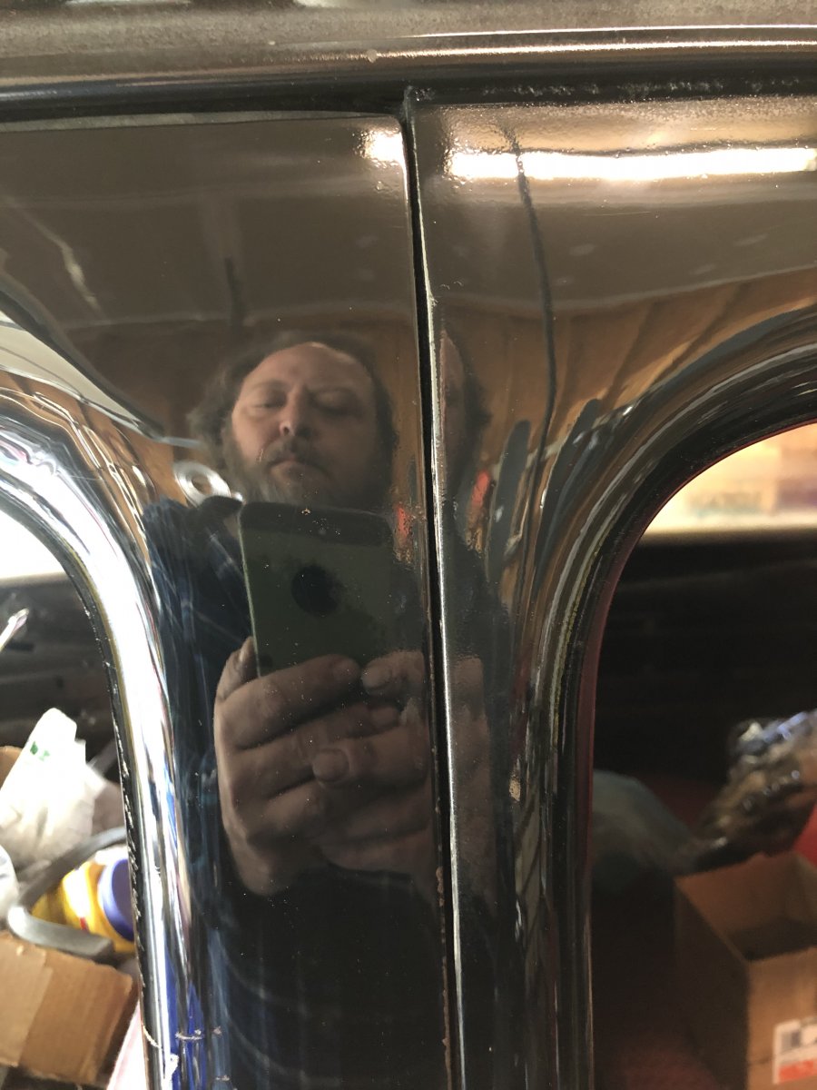

    I got the drivers side looking pretty good. Using Meguiars 105 cutting compound on a wool pad on my 8 inch buffer at around 4000 RPM. This stuff works just as good as the expensive stuff from the paint store and I’ve used it on a bunch of cars. Plus you can usually get it at Auto Zone. 530FCAA6-497F-44CD-979F-BA421A5AE6CB.jpeg

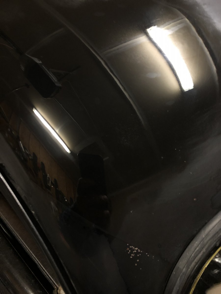

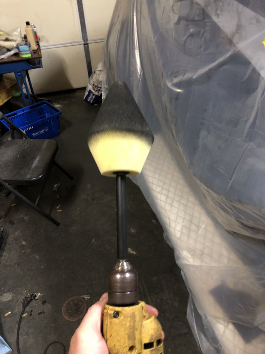

    There were some spots on the car where there just was no paint. Like an antenna hole I welded up and the tops of the doors that had the paint peeled off. So I figured it was worth a shot and sprayed some Rusoleum black lacquer on them. Let them dry for a week wet sanded and buffed them. Kind of amazed at how well it turned out. When I buffed these spots I used a Meguiars aluminum wheel polish cone for your drill since I thought I might have better control with it. Still using the 105 cut compound.

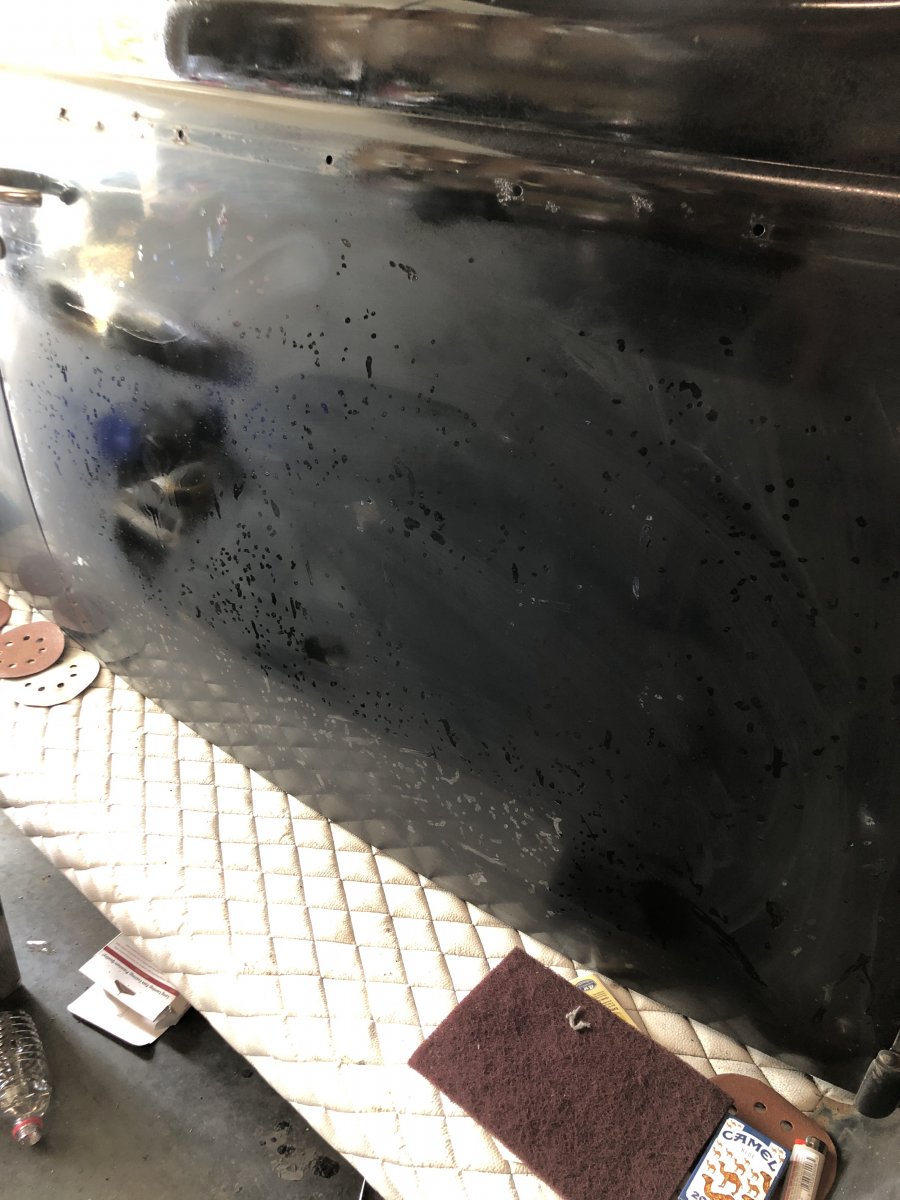

  12. Nailhead Jason
    Posts: 4,515

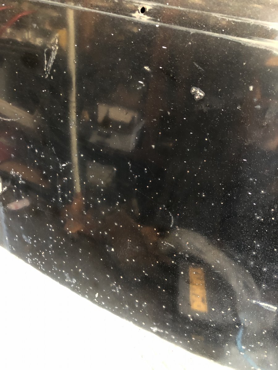

    Nailhead Jason
    After I gotta the hood buffed I decided to tackle the two worst parts the p*** side door and the roof. The door had about 15 million little chips in it that when I buffed it it just highlighted them. So I took some of the spray lacquer and squirted it in an old bottle and then took a small brush and proceeded to touch up all the spots. Once it’s dried for a few days I will wet sand the entire door and buff it out.

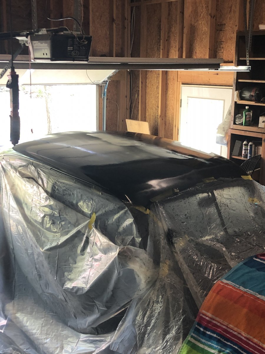

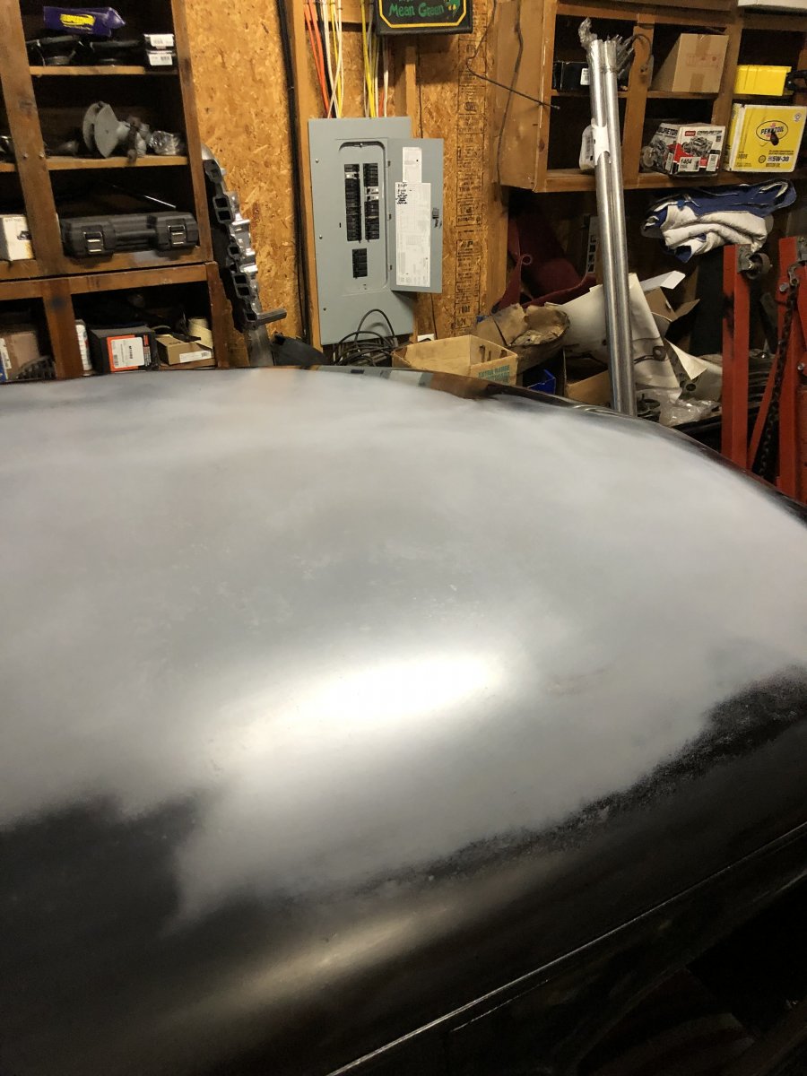

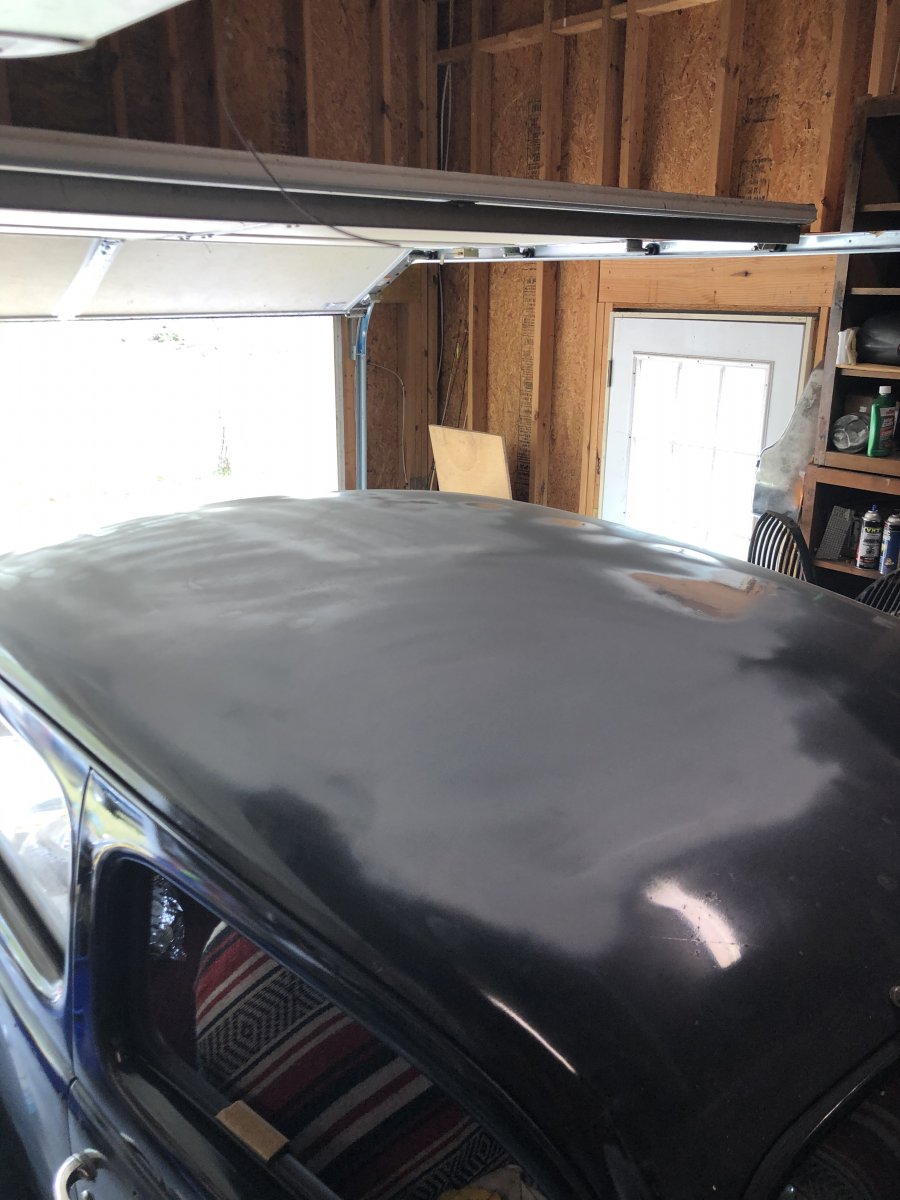

    The roof was a different story. When I tried to buff it it was just pulling the paint right off. So I said screw it and sanded most of the roof down to bare metal and the sprayed some filler primer on it to fill the thousands of little pits in the metal. After that was good and dry I blocked it down with 600 paper and proceeded to spray 6 cans of spray lacquer on it. I’ll let this get good and hard and then wet sand and buff it as well. Will it be perfect?? No. But it will be sealed up. And look good and I won’t worry about it like I spent 8 months block sanding and 2000 bucks on paint for it. Plus all the paint stores around me are closed unless you have a corporate account. So that screw being able to be better paint. Stay turned and I should have blocked and buffed buy the end of next weekend. 0C8F6A47-9DB4-4497-80D3-742BB8FE9427.jpeg A02F133B-EF7D-4902-95E6-452F6BA4B6BF.jpeg 5DB806B5-D944-48EB-99D3-728D72FC7E33.jpeg 7DE83A9D-BBF6-4D81-B76D-99E928FDE8CD.jpeg 256B6F82-17FD-437F-B436-80189147F7ED.jpeg 8214FCA3-CBAD-4AB7-BE18-39549659F47B.jpeg 396CDDDF-4084-4233-B0C7-2E34A4670CDD.jpeg

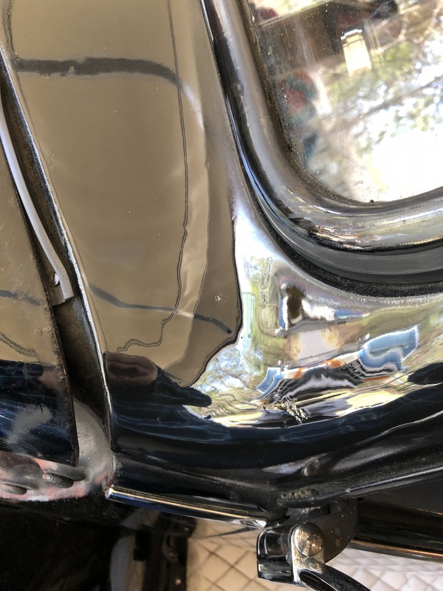

  15. Nailhead Jason
    Posts: 4,515
    Nailhead Jason
    Also got the stainless polished up and put on the drivers side. Man it looks good back on there. DE1BC741-6506-4B47-9C44-0BA64A2CA7D5.jpeg 41C496DD-FB10-4BB2-8E3A-B3E8EA51FCD2.jpeg

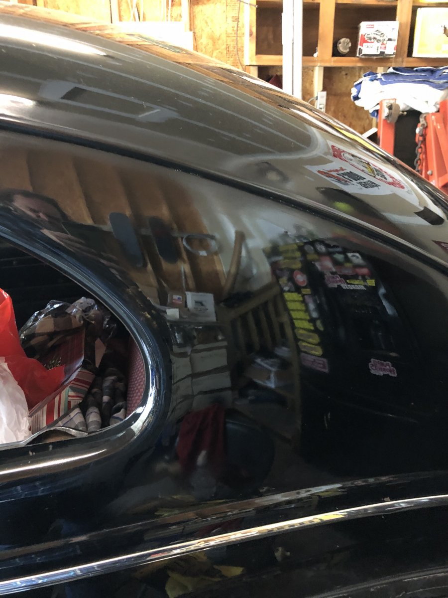

  25. Nailhead Jason
    Posts: 4,515
    Nailhead Jason

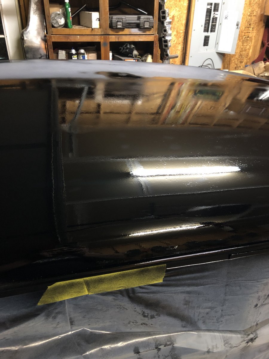

    Letting it sit in the sun today made the paint harden up enough to start wet sanding it. Start to flatten out nice. 7563D1DA-2708-443B-84B9-1B0C9978C1AA.jpeg 6A7B4AD7-1F1E-430A-A4EA-D844B09BDEFB.jpeg A3B5BD51-8C99-4A83-8883-A854166F4027.jpeg
  26. Nailhead Jason
    Posts: 4,515
    Nailhead Jason
    Couldn’t resist a test spot after getting it back inside. Show car???? Hell no!!! But good enough to seal it up and still be shiny!!! 1079423C-C67C-461F-BBB0-4AABB711EF04.jpeg CA8DCBD2-01EA-4401-9236-62D49A94BD8C.jpeg

    Ha!!! I’m hoping my back yard bodywork paint skills will have just enough imperfections that it matches the rest of the car!!

    Nice work on the cost effective patina'd paint fix! It really makes a difference! Keep going, you make me want to get my 40 back on the road but I've just got too much to do at the monent.
