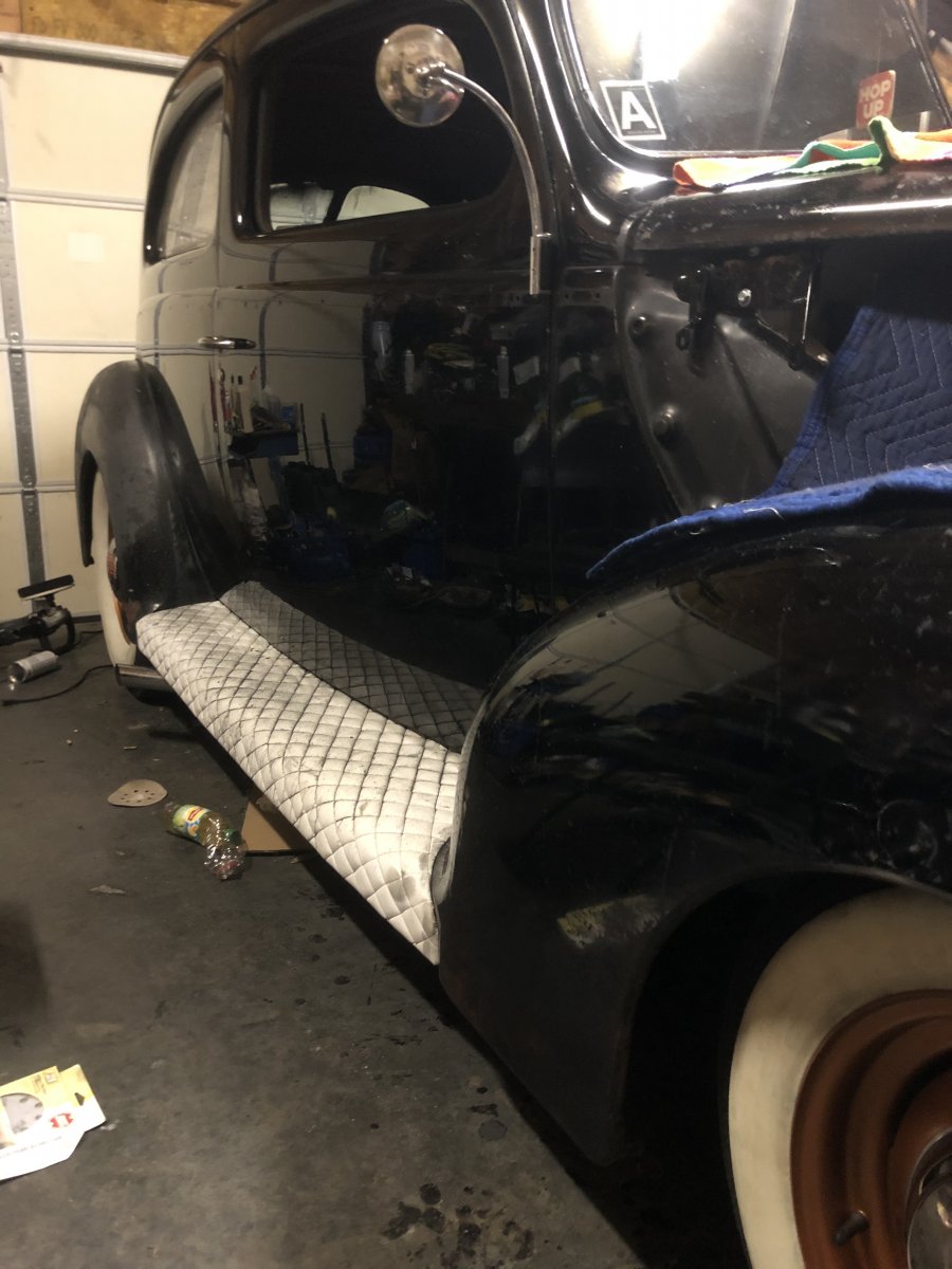

    Got the whole car done with the cut compound and the roof wet sanded and cut. Not ashamed to say it’s turning out great. I got the trunk lid, p*** side quarter and some of f the roof polished and ready for wax. Still need to do the entire drivers side and the p*** door plus the front clip. The polish is really making it deep. I’ll have the whole thing polished up and waxed tomorrow. FDFD2EAF-C893-4E6D-9249-B58E5C8A1A0B.jpeg 4AC821BB-F4A6-4272-B9CD-2B5D520ABC29.jpeg 46E2C7C2-6BEC-4B13-B737-D8E2712314D8.jpeg

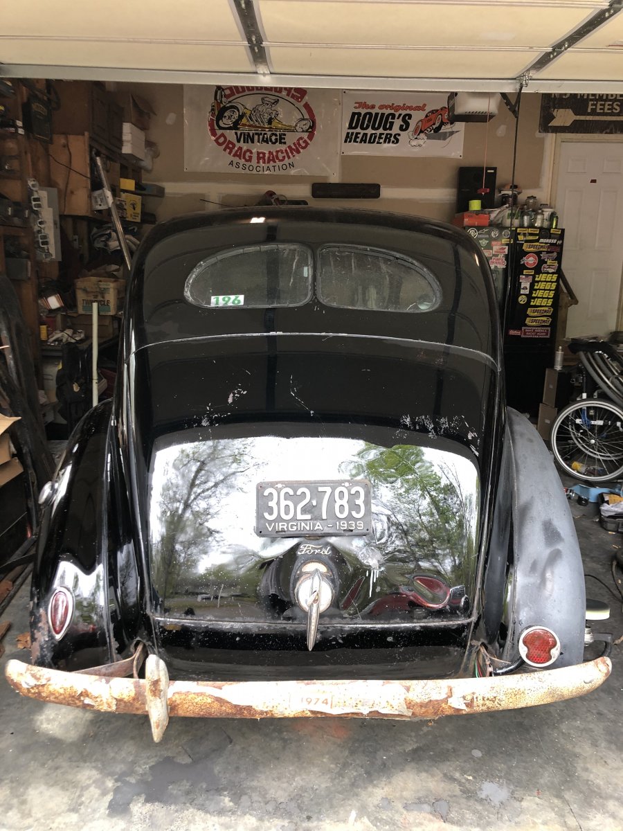

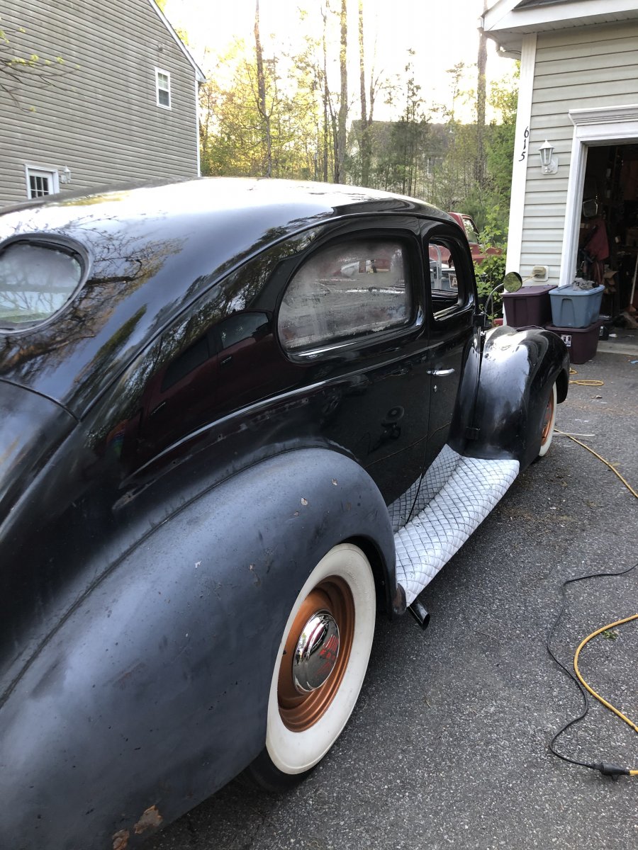

    Here is the p*** side quarter behind the quarter window. This is after the polish. 84F36D15-D926-475A-A3C7-624084849C07.jpeg
    This is the P*** side door that a touched up about 70000000 chips in it, then wet sanded and cut, still to be polished. Looks pretty good.

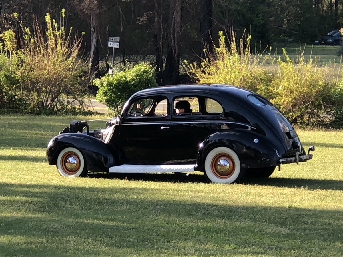

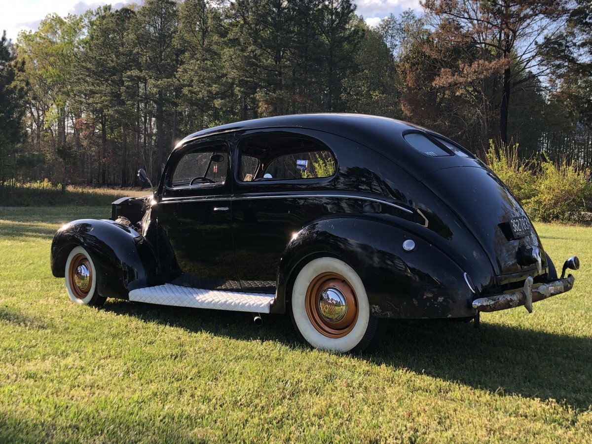

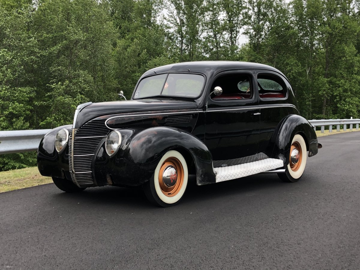

    Still have a little more to do on the bottom front edges of the front fenders. And I haven’t totally decided what I’m going to do about the grille yet but this is where we are now. The rustoleum re spray on the roof was a complete success. The rest of the paint buffed and polished amazingly for beaten abused paint from 1939.
    This one is the roof sprayed, most of the car wet sanded and cut with Meguiars 105 compound, finish polished with Meguiars 205 finishing compound and a coat of Meguiars gold cl*** wax. It’s far from perfect but 1,000,000 times better than it was. More importantly I saved the majority of the original paint and it only took about two weeks.
    85704DEC-4686-4E13-B856-B77AC0ADBF4F.jpeg 196FCEB1-A955-4D72-B597-8B7B14356B7D.jpeg DB662441-09CD-485E-9609-80F6347694B0.jpeg E6573385-45CE-4560-A37E-686FB0D5BE79.jpeg ECCB57C0-E806-4370-97F6-9DD537B55DBF.jpeg

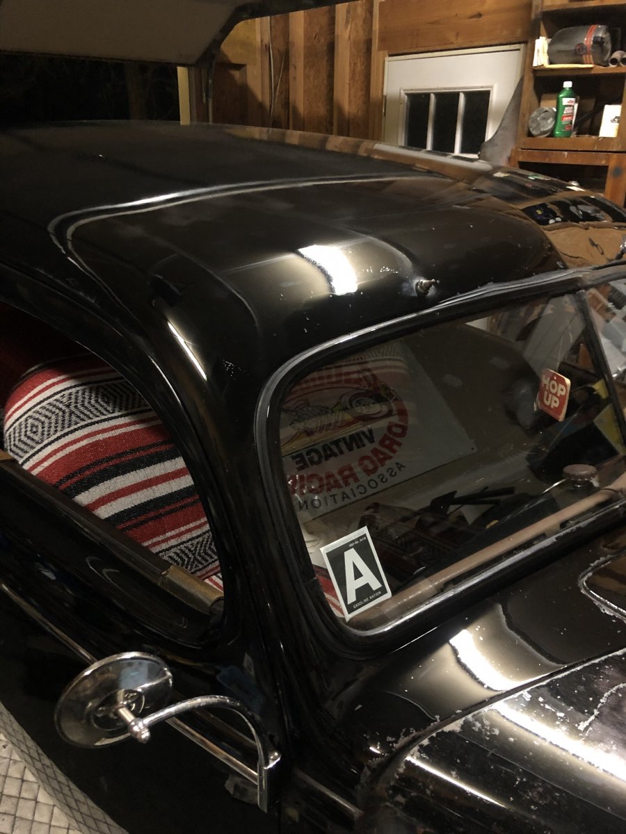

    The top blend looks pretty good. You have to be right up on it to really see it. B59B4FF8-82B5-49A7-8832-8E25A26DFC67.jpeg

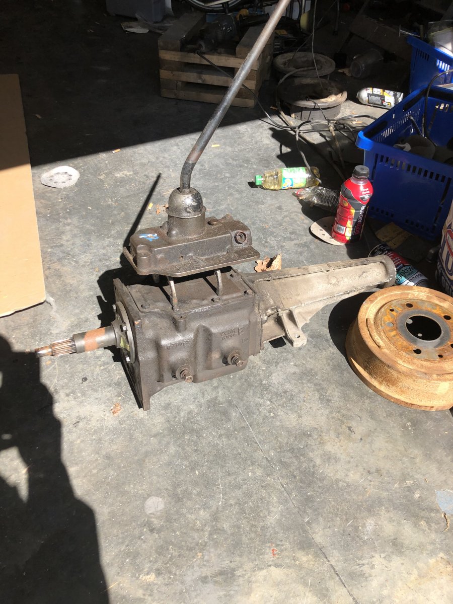

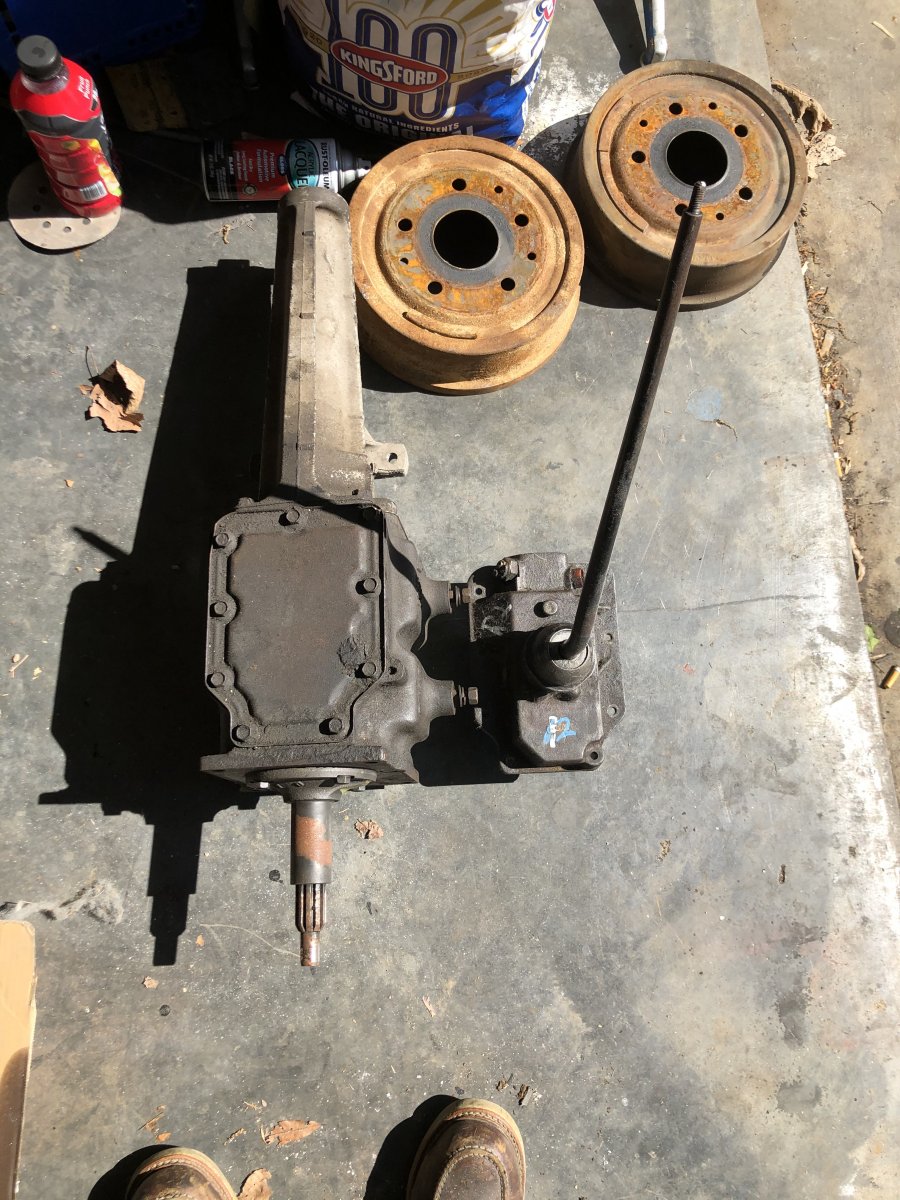

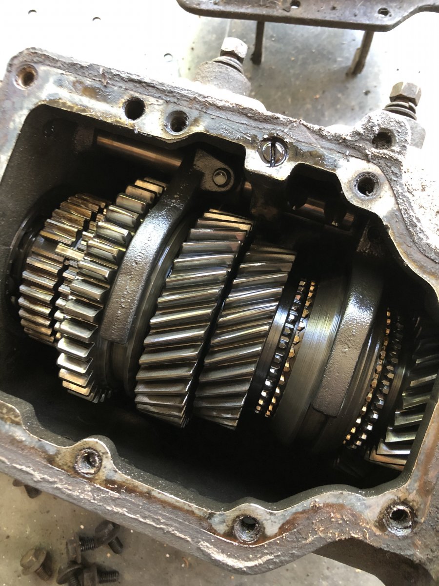

    I’ll be swapping the rear out soon with a Bronco 9 inch and swapping transmissions at the same time to a 1963 3 speed top loader with a Jeep shifter conversion. I like the banjo just fine but I know it’s a mater of time before I grenade the trans. My buddy Rob dropped off the top loader today for me. It was at another friends house in NC. Opened it up and dam it looks good inside.
    83FE0417-BF0A-4CEC-8C2D-F18B7CACD458.jpeg C8B83F61-D925-4F02-8C2B-DEF18BF06098.jpeg 8BD93554-A94E-4234-9F7A-6BDF08EE5E13.jpeg

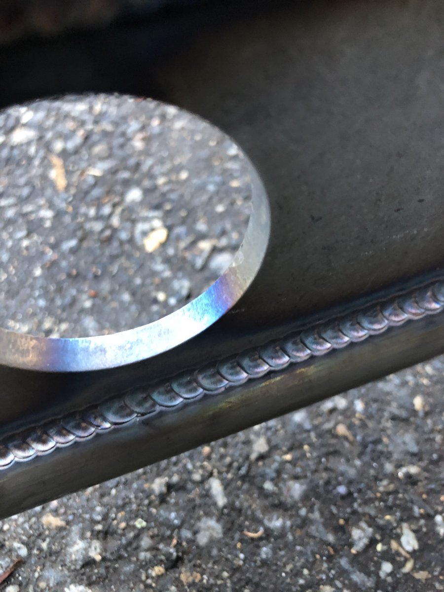

    Bye bye leaky banjo. Got some killer stuff from R Jays speed shop in the mail today. The banjo is coming out in favor of a 68 Bronco rear and the trans being swapped for a top loader 3 speed with a Jeep shifter. I waffled on weather or not to do this or parallel leafs. Leafs are probably easier to do but I just didn’t want the ride height to change. This way I can use my same Posies leaf in the back and it should be the exact same ride height. I just didn’t want to do leafs and then have to put lowering blocks in it to get it to sit right. Plus R Jays makes a killer set up that is bullet proof. It’s the same ones on the Gold Chainer 32 built by Dave Gray. And that thing yank the front wheels at will....and hard!!!
    2F5DA93D-4ABF-4568-9E2B-579F59E69F3B.jpeg 8A58F0CE-5310-46EE-861D-84C3801E87EA.jpeg A150B3AB-3332-44F9-A184-3BFB109124CB.jpeg 818C271D-6195-4892-A9E5-645F580FF378.jpeg

    Those welds are a work of art!

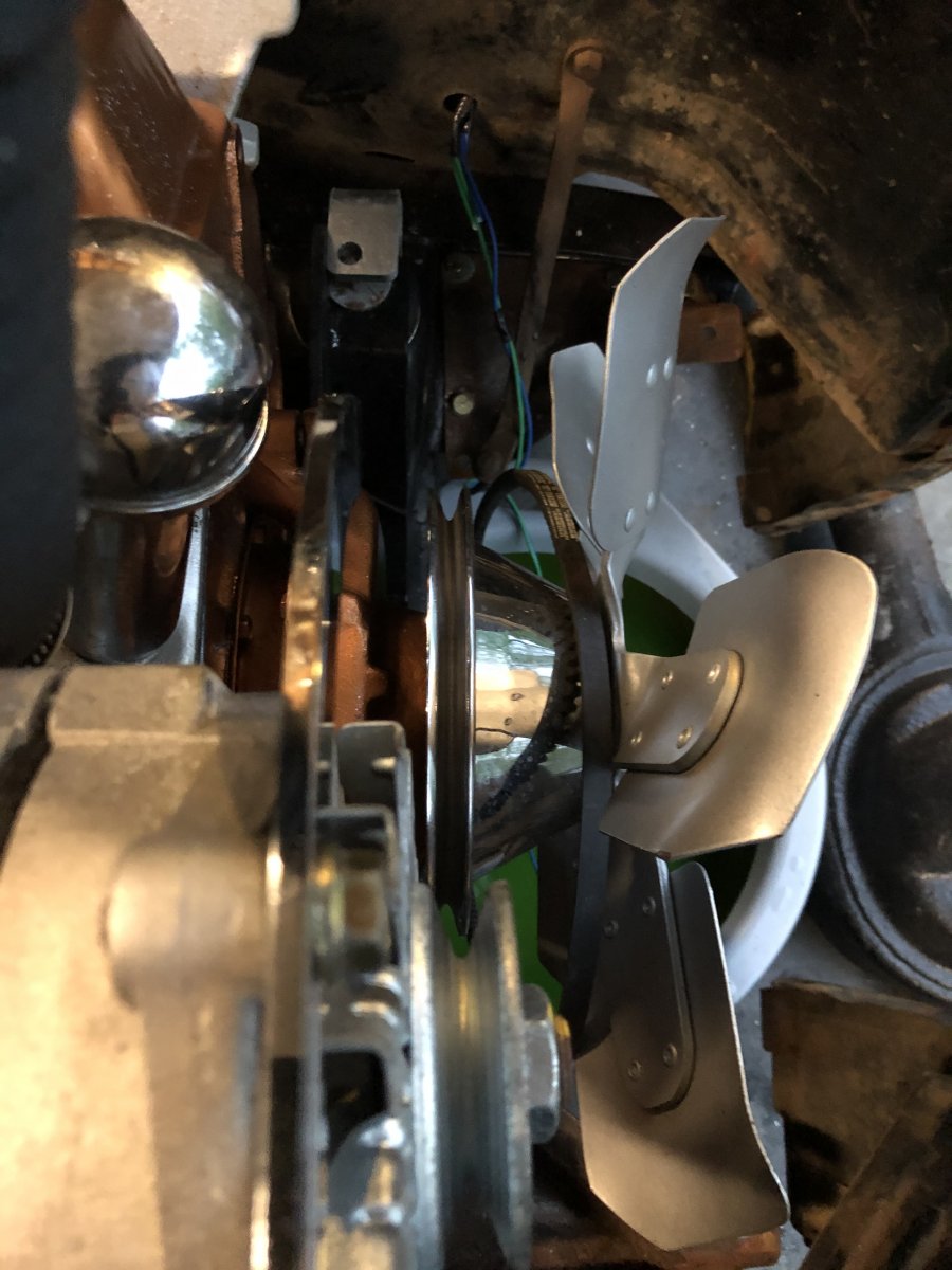

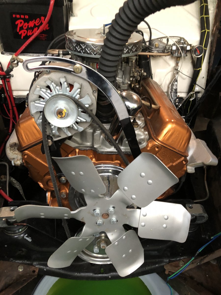

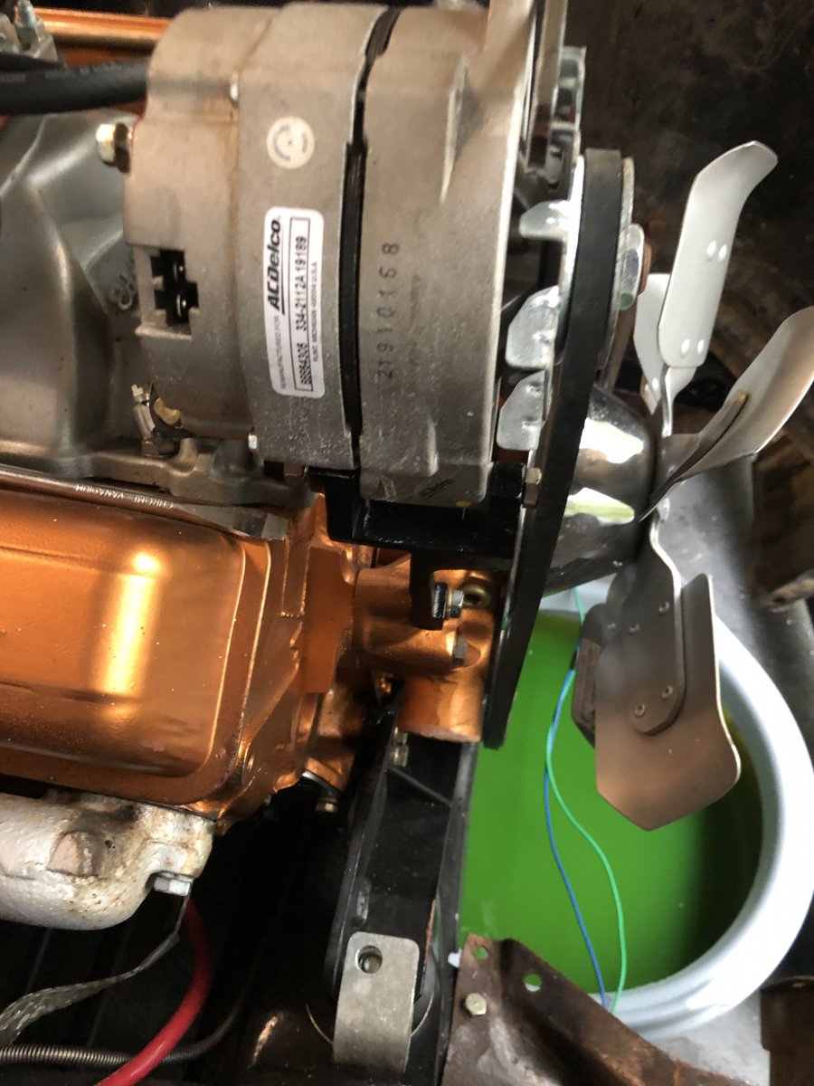

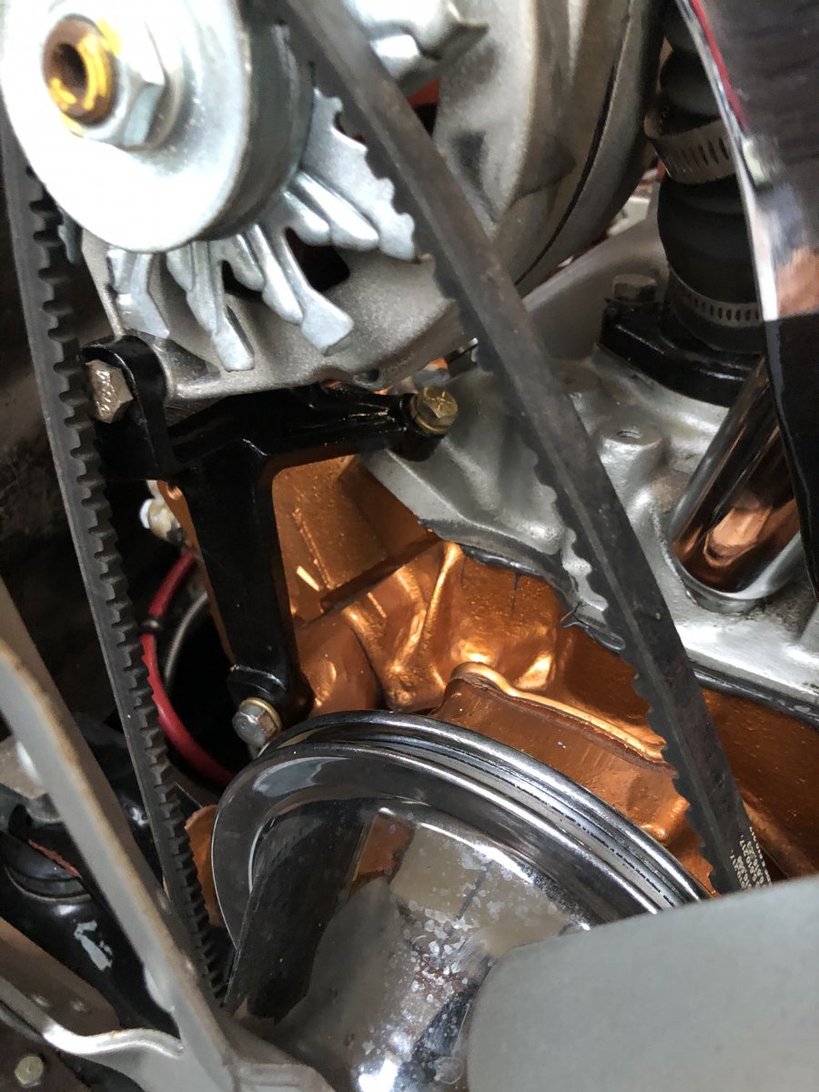

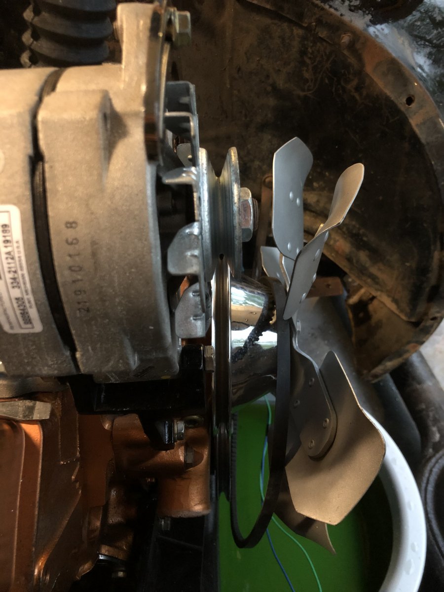

    Before I start doing the rear end and trans swap I needed to lower the radiator down a few inches to clear the hood. And relocate the alternator to the p*** side so I can fit the hood side on. F3DF40CE-F37E-46A3-B5CF-135AD3424C17.jpeg 8800C87A-A0EF-4C1C-85A1-EECACF3D599D.jpeg 94EF14B2-7A09-41F1-B776-DCC240ABB275.jpeg
    For the alt bracket I used a 70 corvette smog pump bracket and made an adjustment arm out of 2 old ones I had. That’s why half of it is chrome, I painted the plain steel side!

    Blue One
    from Alberta
    I hope that is just a bad angled photo (the last one) because it looks like the belt pulleys aren’t lined up very well.
    Looking at the picture it could be a belt thrower.

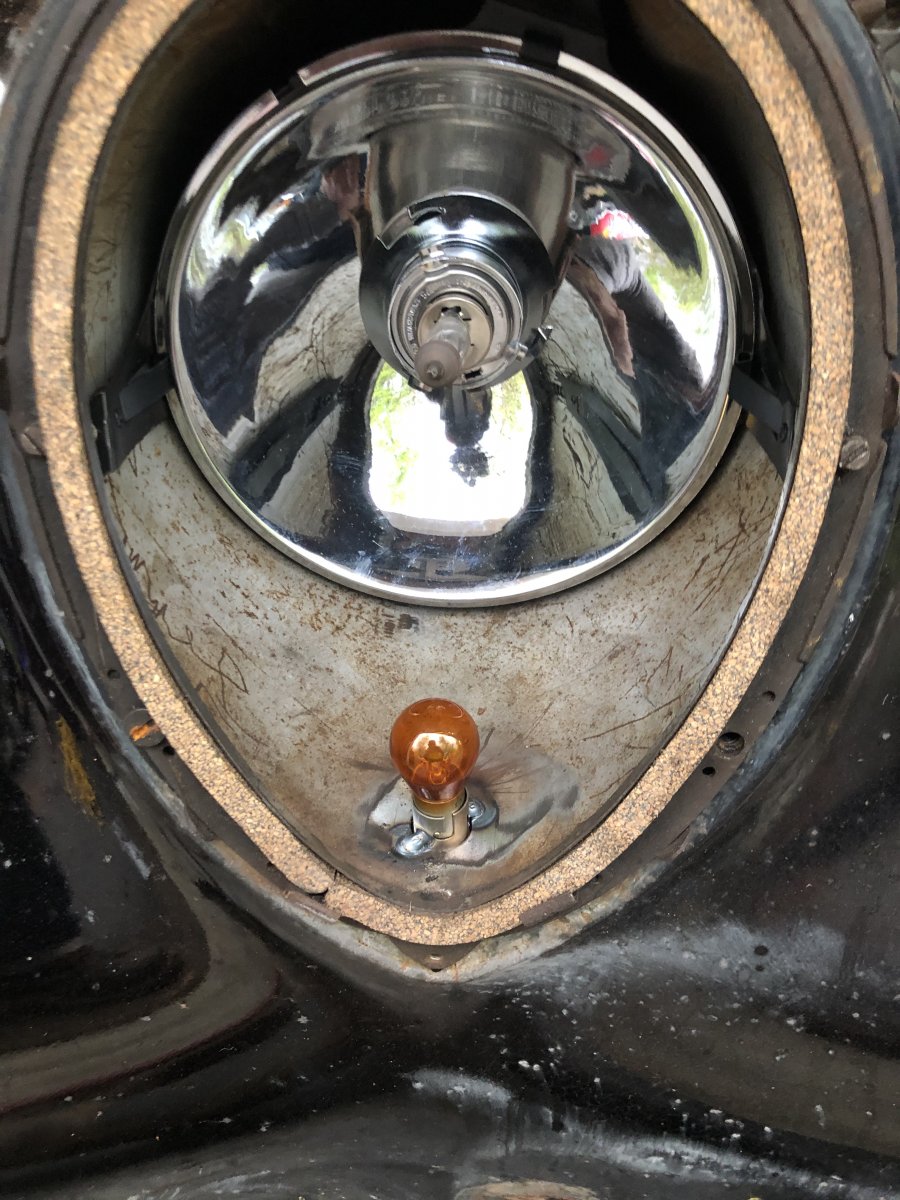

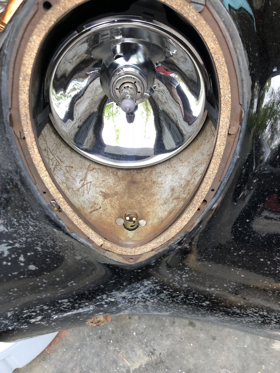

    While doing this alternator and rad move it was a good time to go ahead and put the turn signals in the head lights and straighten out the headlight wiring that was rushed for Old North State and TROG. 43C9C0D0-658B-4B9B-A0B3-F0EB111D7786.jpeg 6803D876-68A8-4FC0-9C43-DAD4F5CCB540.jpeg 6604DB60-FC2F-4438-8093-54479BB111F7.jpeg
    for the turn signals I used some universal 1157 socket from amazon. Drilled a hole in the bottom of the bucket and tacked them in. I’ll seal the buckets with 3M strip caulk after I paint the inside of the buckets.

    7E56C2AF-2EE0-4BA7-800B-EC705A77F879.jpeg D6E8AE28-1809-4918-A950-4135A83AFE9F.jpeg
    It’s just the angle they line up perfectly.

    Blue One
    from Alberta
    That’s good because if they’re off you’ll find out quickly at the higher rev range usually :eek:
    What’s that racket? ( As the belt departs for places unknown :eek::()

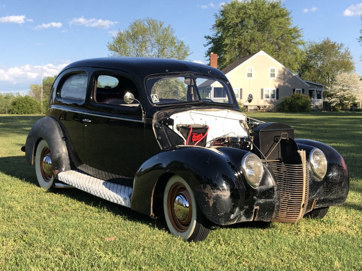

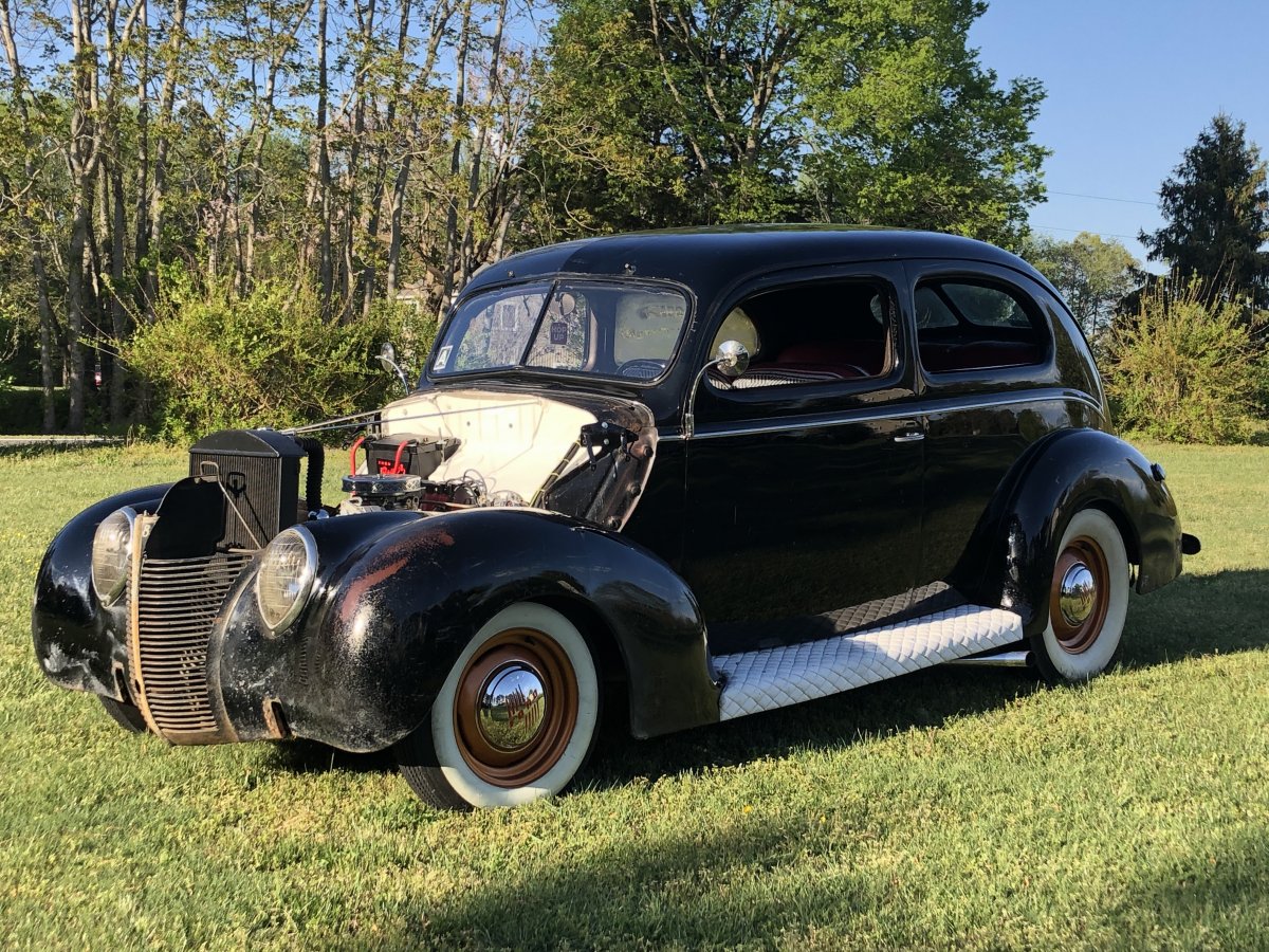

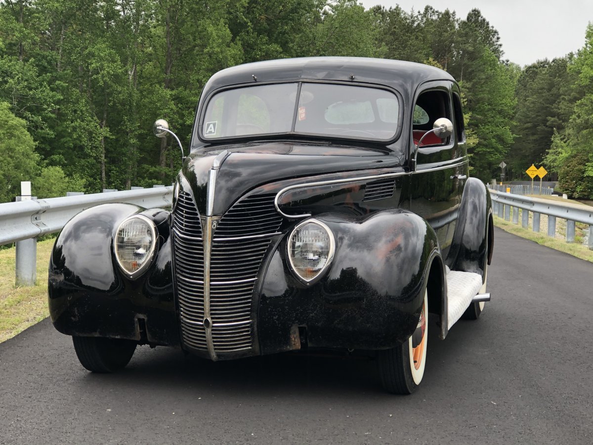

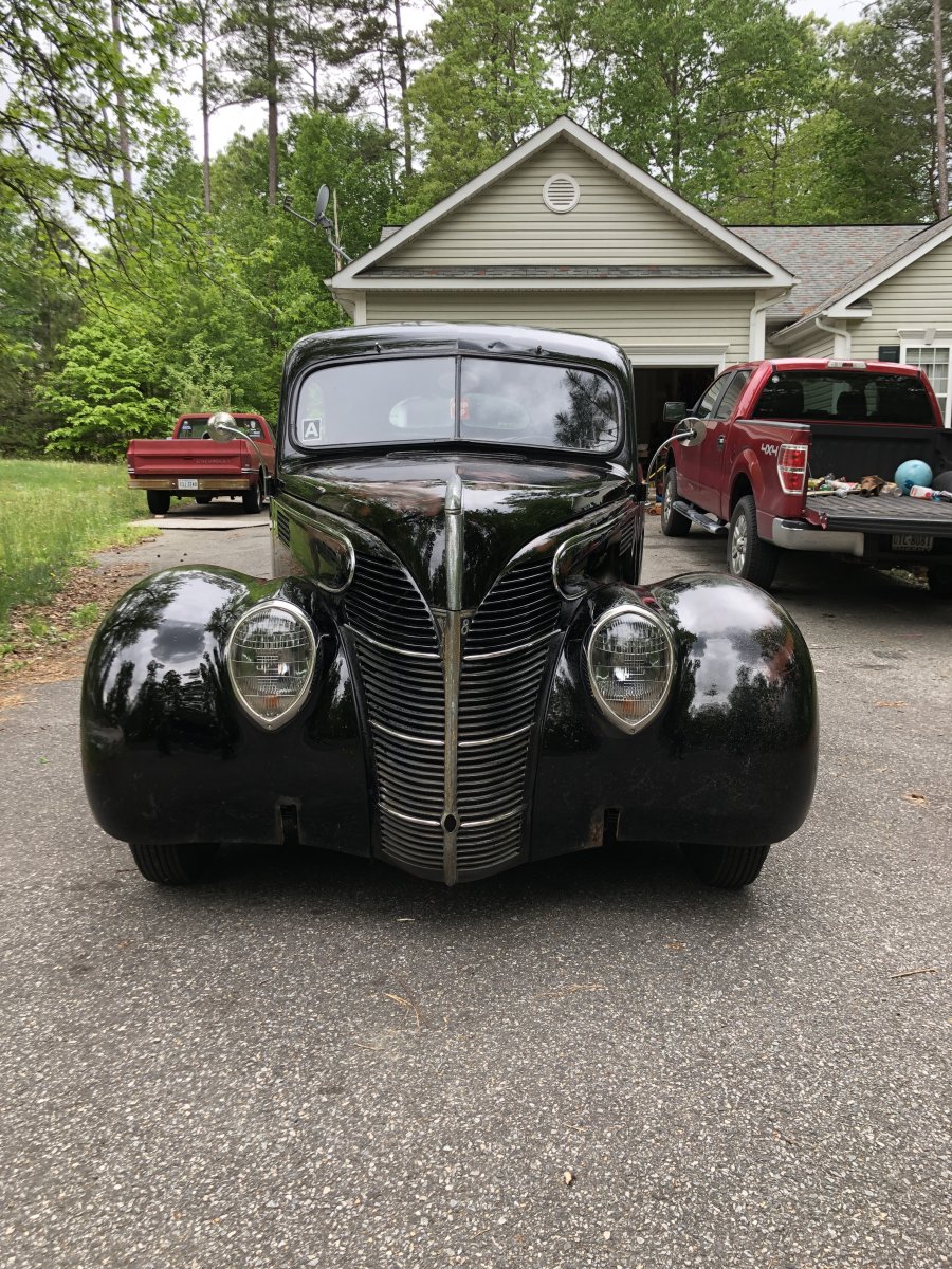

    Got the stainless and all the paint (save for the p*** rear fender ) shined up as best I could. Got the front sheet metal all aligned and the hood and hood sides all back on. Looks completely different and I’m loving it.
    D6CE843B-9E7F-4352-BBAD-4EF7705BF8D4.jpeg 7B62CA2E-F874-4F4E-8BCC-94EEFA9BF154.jpeg 0520ACEB-959B-49B0-ADAD-DCB07D9FEE41.jpeg

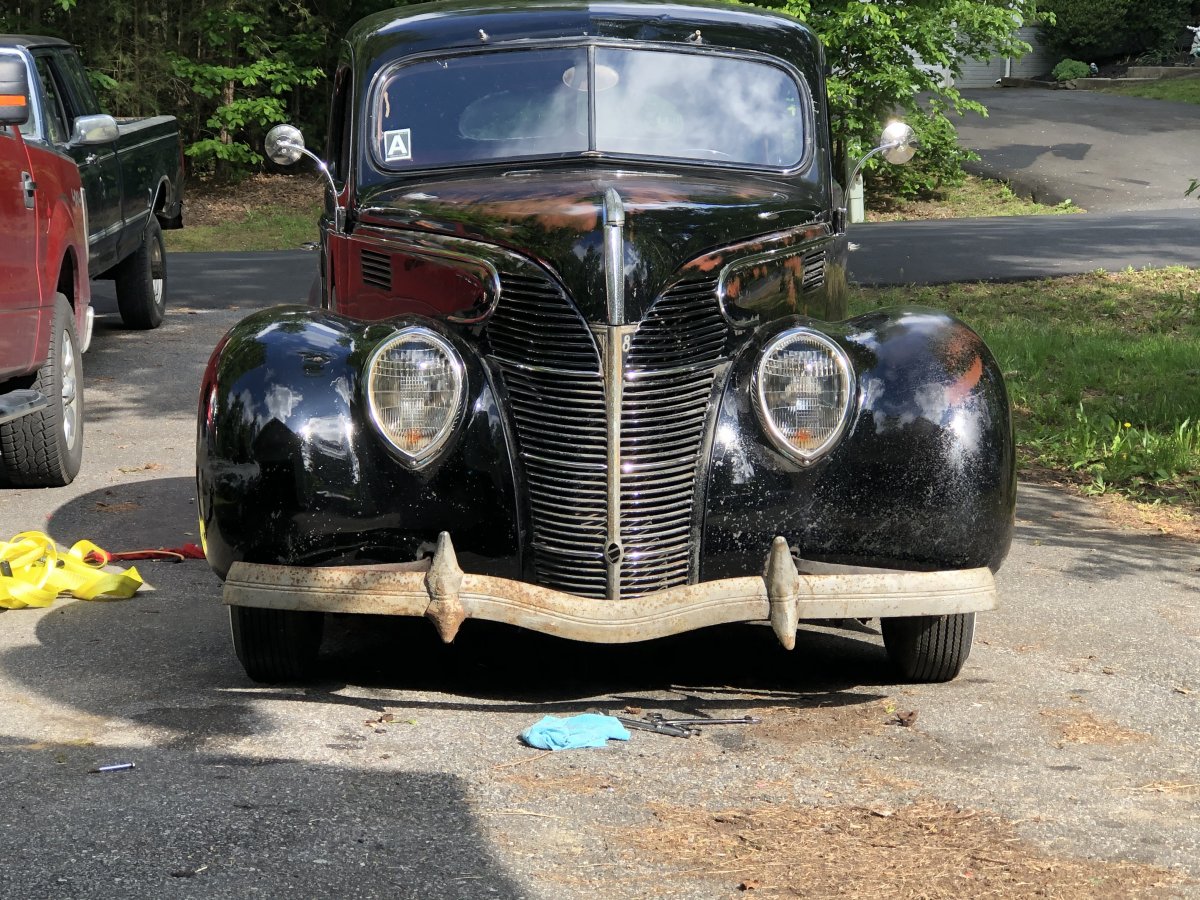

    Working on some bumper ideas too. I have a pretty rough stock front bumper that I was considering cutting up to make a bumper similar to a 40 Lincoln. But then I also had this 35 36 bumper that I’m kinda liking as well. The dip really follows the flow of the grille. C5AB1D17-0C94-454F-A3F2-CCBD86E91C03.jpeg

    Always liked those '35/'36 bumpers. Never saw one on a '39, but it works. Looks good, like it was born there.:)........Don.
  24. loudbang
    Posts: 40,346
    Yep bumper looks stock. :)

    Jason, the car looks great! Maybe Hanlon Plating could brighten that bumper up for you? Keep up the good work.

    You might try some CLR on that bumper and be surprised at what's underneath all the crud, Just a few bucks at the super market or the hardware store.and some elbow grease!

    I would if it had any chrome on it. I don’t know if truck numbers were painted or not but this one looks like it was never chromed. I got it with a 36 pickup I bought a few years ago.
