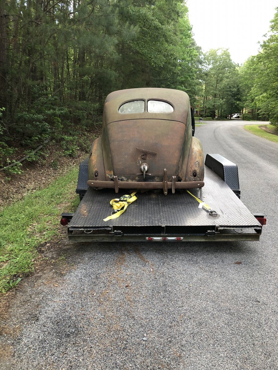

    Not that I need any more projects, but when they pop up sometimes you just gotta grab them and put them in line with the others. Picked this up yesterday. It’s just rough enough that I won’t feel bad cutting it up. Currently thinking about making it into a convertible sedan or a chopped custom. We shall see. I’ll start a new thread when this one begins. 8019B94C-EA10-461A-8FCB-E7F4562C4BC8.jpeg 818C6ABF-01B8-4418-BC0A-0DAB01573F43.jpeg F7BF5A63-5CE8-4C5B-9C85-1EE1224C4F7A.jpeg D89020CF-9702-46CD-8164-4EA63C2E2BA5.jpeg 83D646C6-45F7-4C1D-8E25-93A9C3512433.jpeg

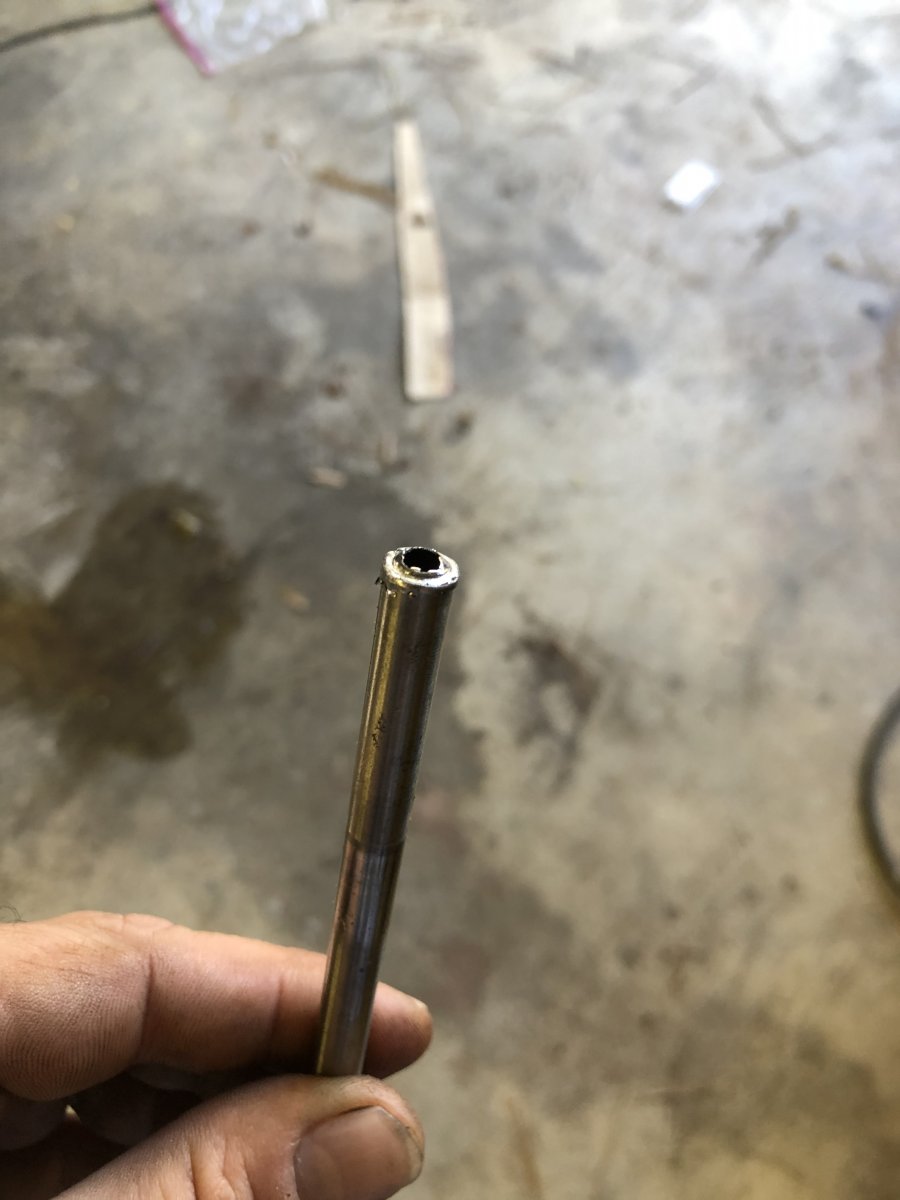

    So it looks like I dodged a bullet. Pulled the valve cover off to start inspecting stuff and found that the number five intake valve pushrod was destroyed and 3/8 of an inch shorter than it should be. I’m thinking the ball must have come off the pushrod or it wasn’t heat treated and just hammered the **** out of the end of it. It chewed up the pocket for the pushrod in the rocker too. The pics show how it looked after and how it used to look.
    So.... I figured well I’ll throw another pushrod in it and Swap a rocker on it and see what it does. Runs like a champ! I’ll be ordering new pushrods and rockers for it soon and swapping all of them out just to be safe.

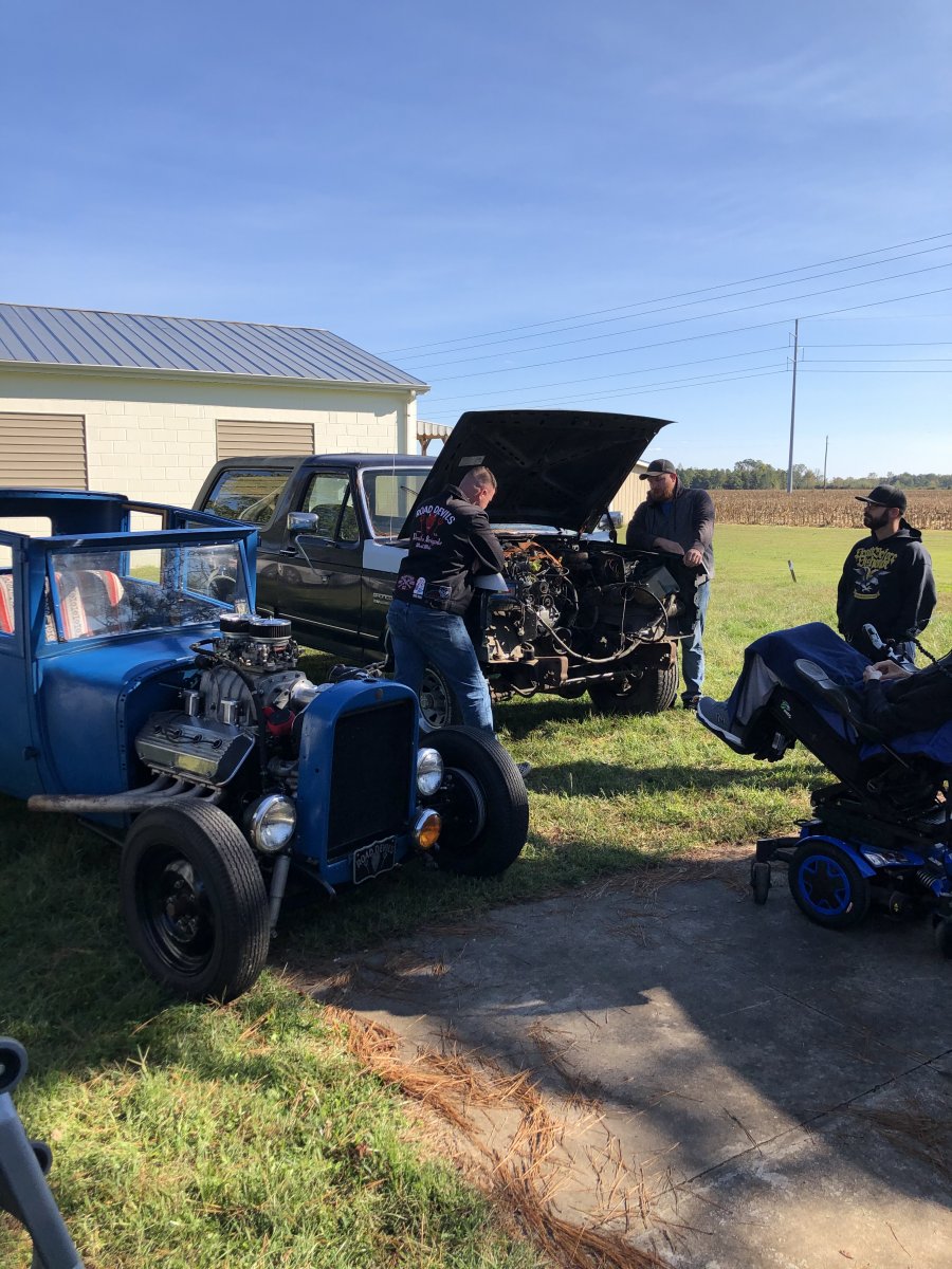

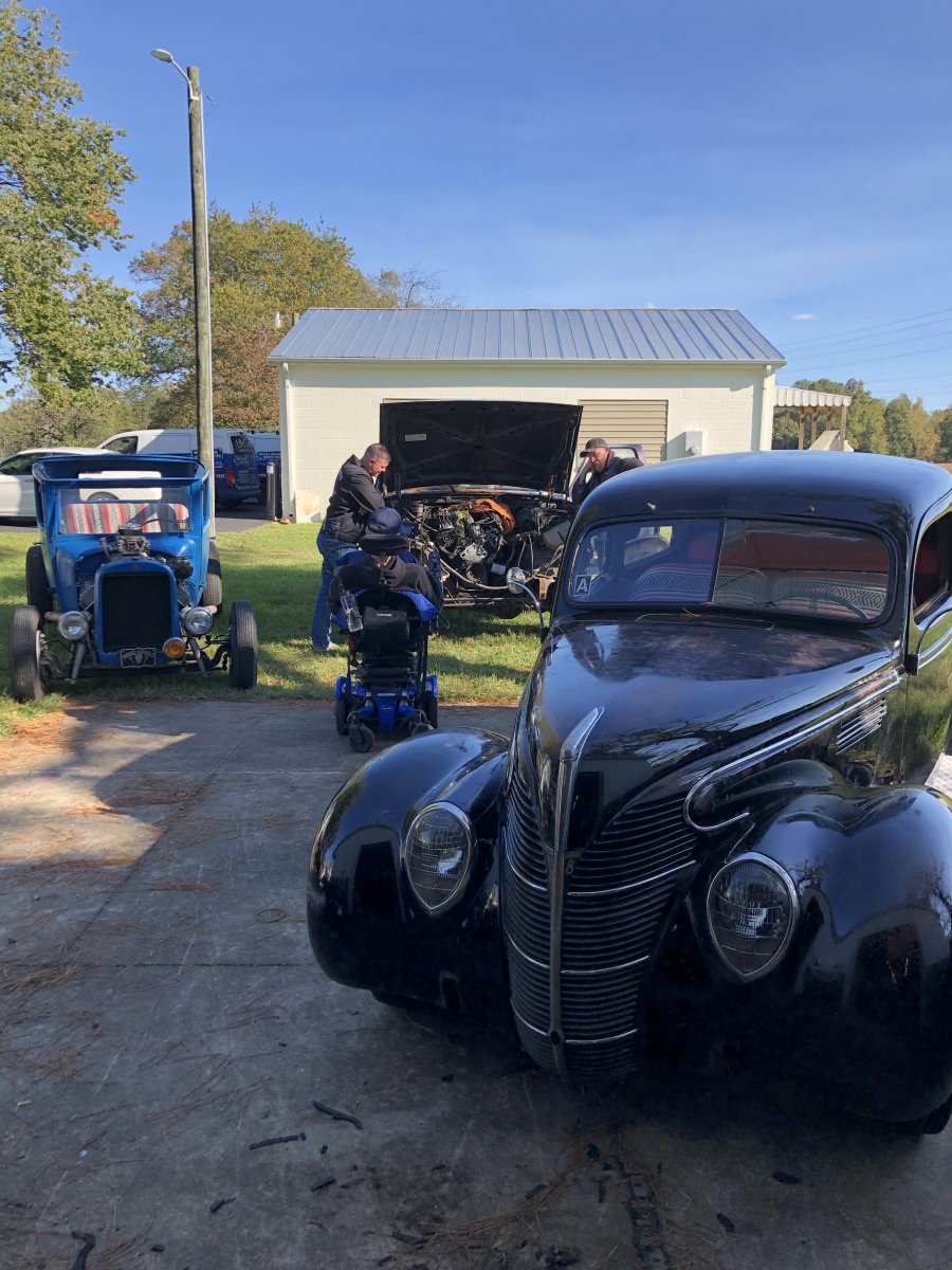

    also had some more hot rod buddies come by and hang out with Dad and I and help out. D91EA11B-D804-421B-954B-C0901A937846.jpeg 2472FD2B-8472-457E-85FB-1B6B6F1628DA.jpeg B06EF5B3-2808-415B-8F96-B5225BA6238B.jpeg 20771297-3C24-4E94-A810-A946BB492303.jpeg

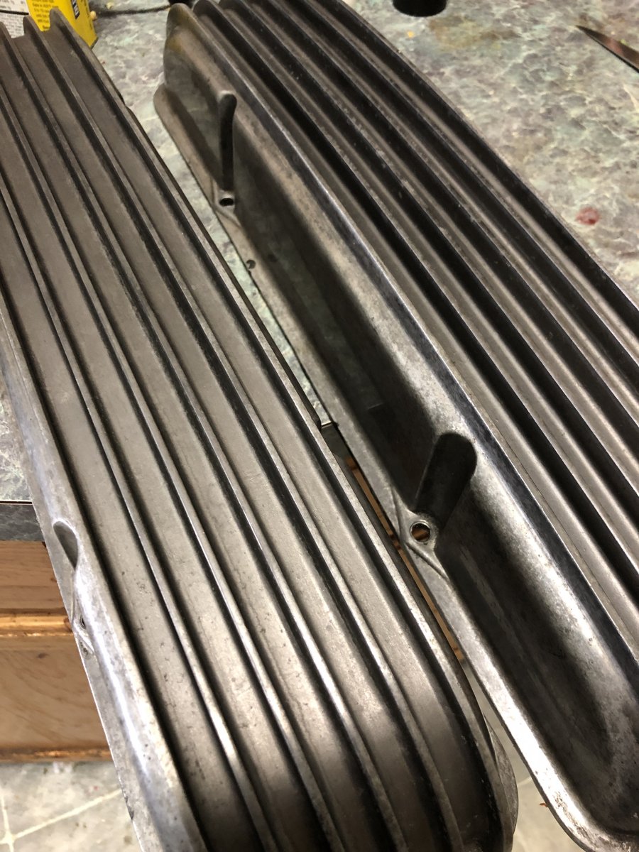

    Gonna order new rockers and pushrods for this week. Think I’m gonna pick up a set of Harland Sharp rockers and Howard’s hardened pushrods. When o do the swap I’ll be putting these cool old Cal Custom rocker covers on. Since I never could get the script ones to seal worth a dam. AAD20149-AD21-44CF-8FA0-1E00F3FA95A2.jpeg 3AE9836E-2B97-4E80-8C16-1681F033FD4E.jpeg
