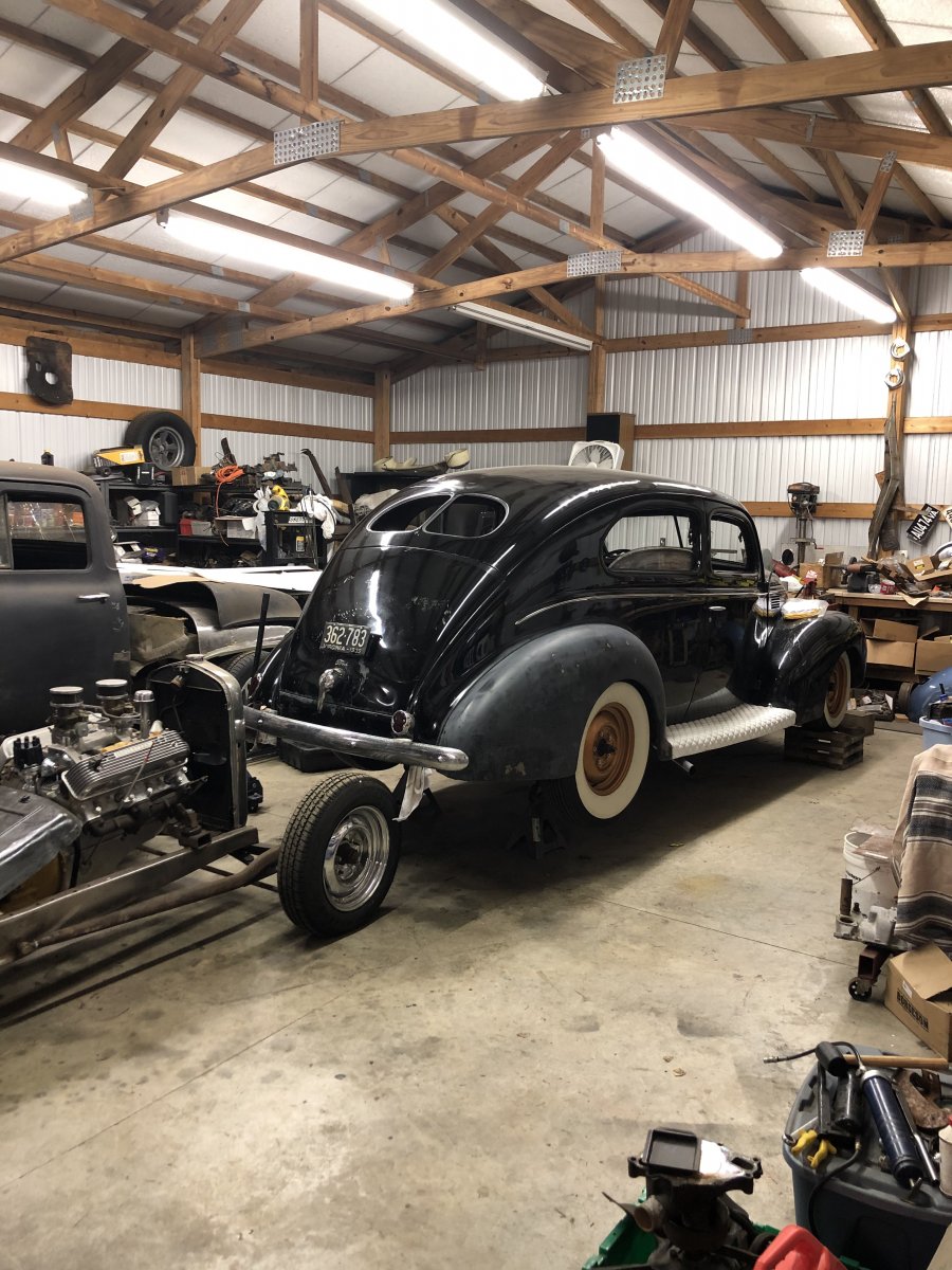

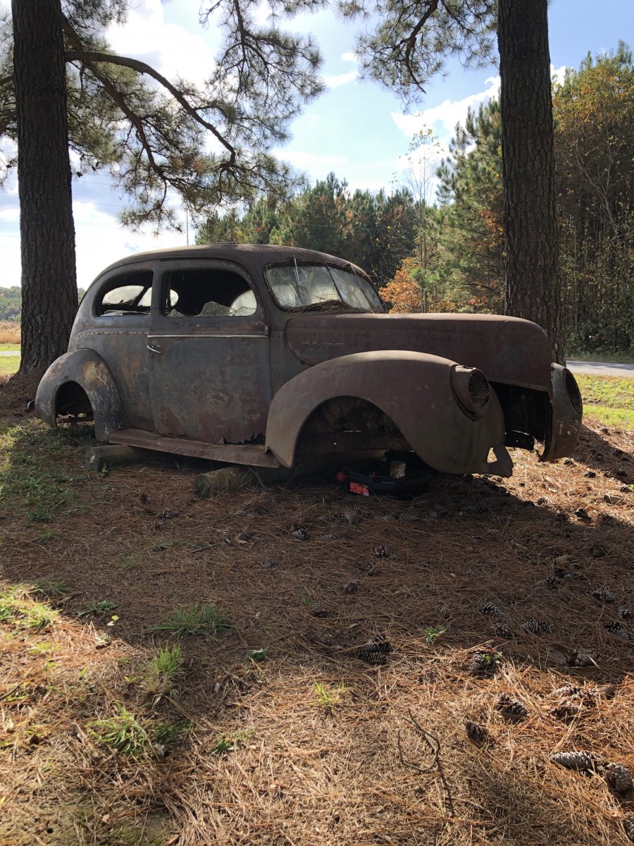

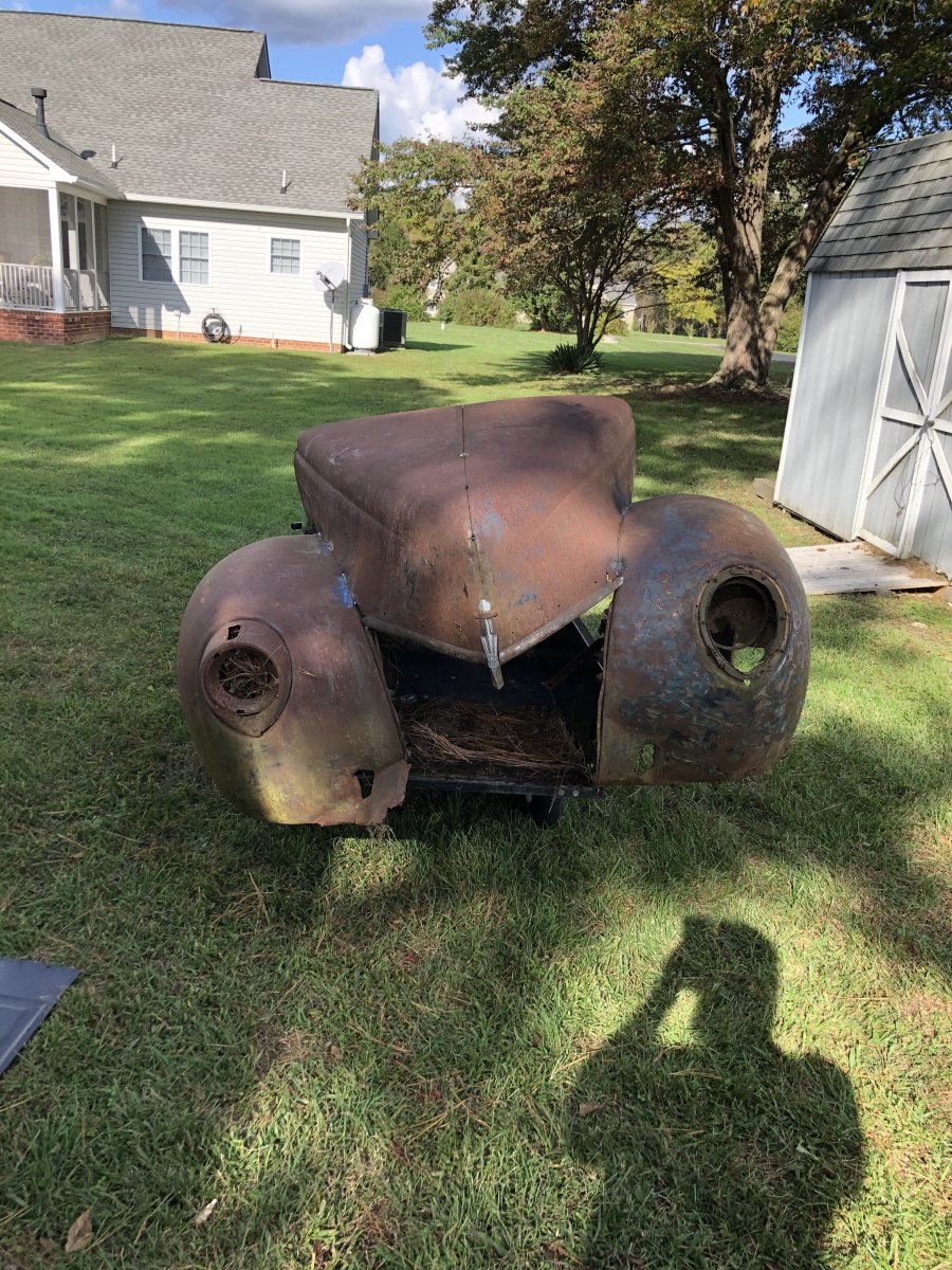

    Not much in the 39 today but I’m nearing the finish of the latest yard art. Don’t know what I’m gonna do with this yet but it ain’t going to the s****per. The front sheet metal is pretty much wasted so I just welded it together and set it on the car today. Mom wants to use it for Christmas card pictures and family Christmas pictures this year. So I need to make it look a little cooler.
    lothiandon1940 and loudbang like this.
  7. Nailhead Jason
    Joined: Sep 18, 2012
    Posts: 4,515
    Nailhead Jason

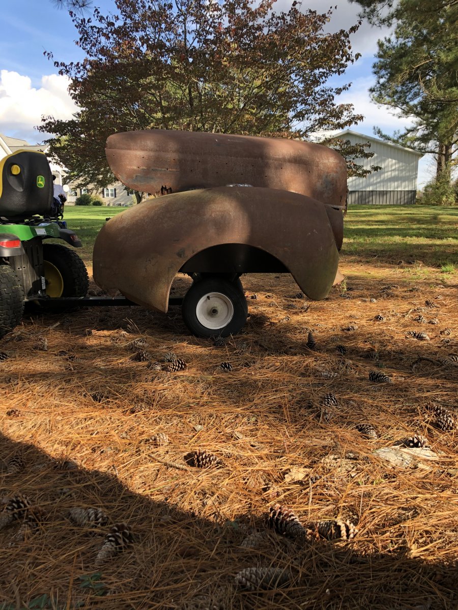

    Dad pointed out that with the front clip on the lawn trailer it looked sorta like a g***er with tiny wheels!

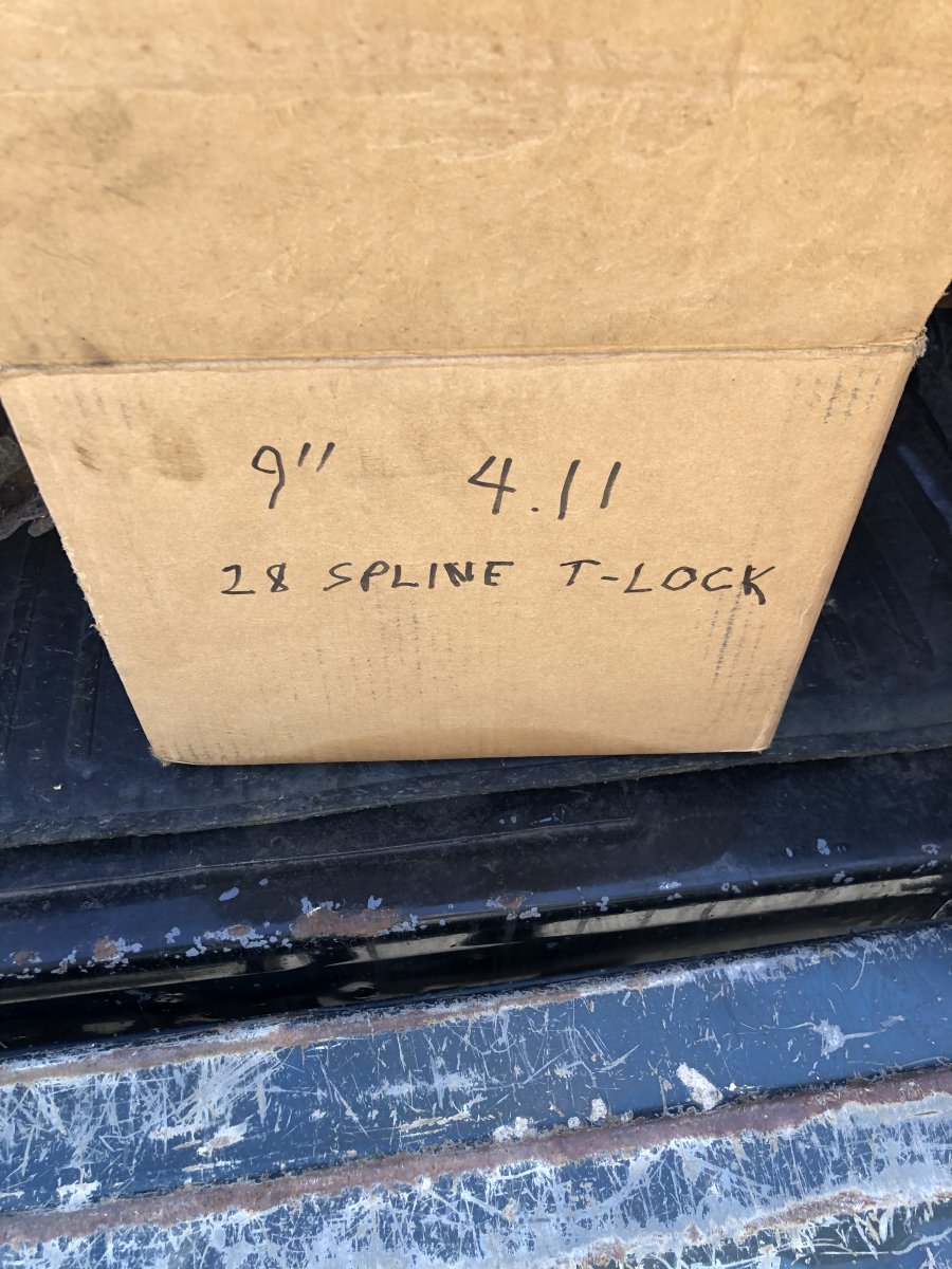

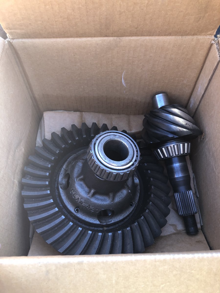

    Not much progress lately. Had hernia surgery at thanksgiving and that really kicked my ***. Now another kidney stone the size of Texas. Surgery for that in Feb. but I have managed to gather just about all the remaining parts for the rear swap. Picked up near new Trac Loc and a pumpkin to build for the nine inch. Just need bearings and a set of 3:50 gears to put in it. F231C60E-15BD-47DE-9C25-15E7AD3872E6.jpeg FB3DFE9F-4DE0-44BB-9870-0B4164135662.jpeg

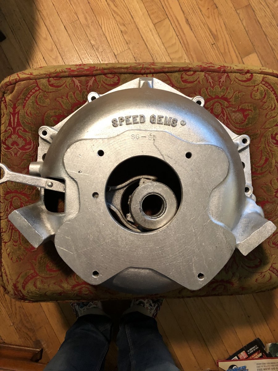

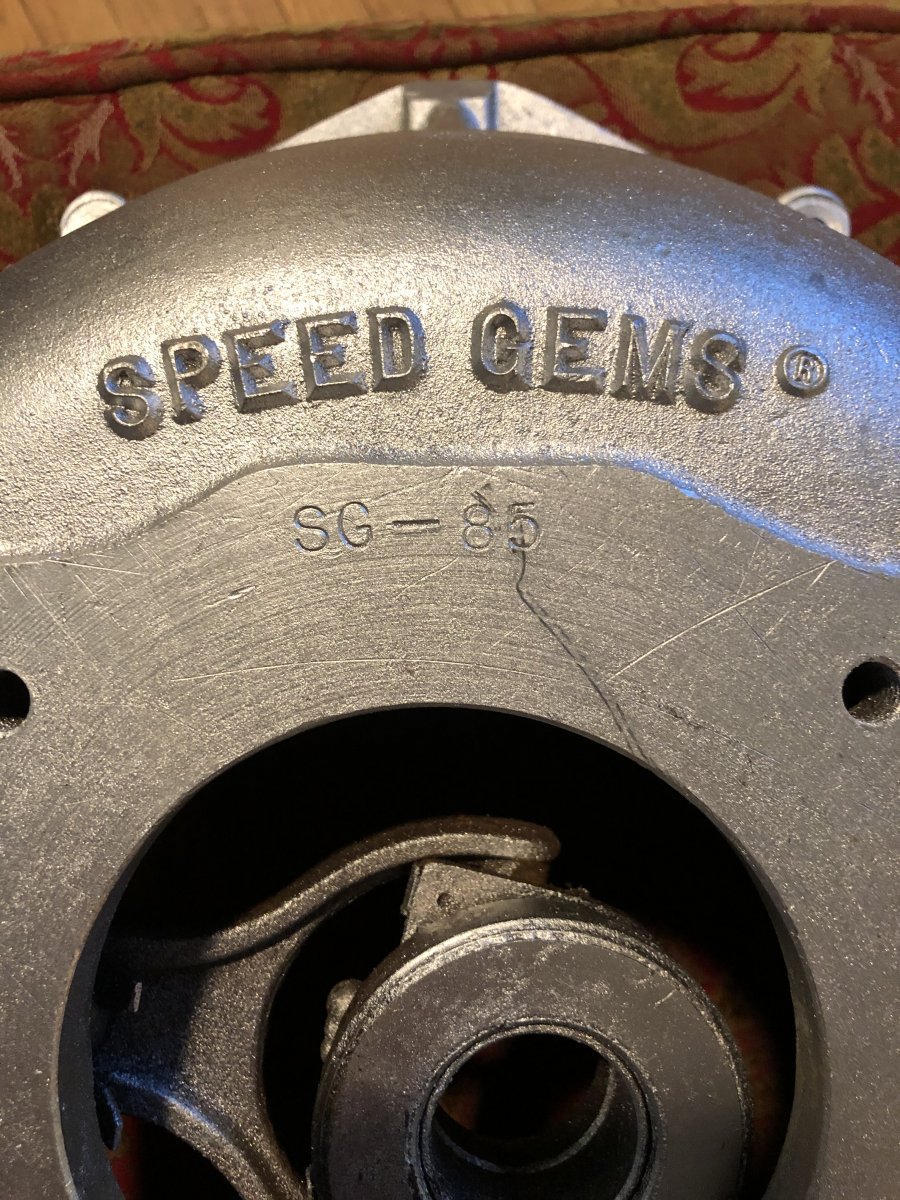

    Also picked up a 65 327 365hp short block for my 54 f100. That will be my new daily once on the road. Also picked up a sweet speed gems bell housing for the F100 to put a Ford trans behind a small block. Going to adapt a mustang T5 to it. I’ll start a new thread for that in a few months when I get to putting that together. D34749E3-9BF1-4D6B-948D-16C54874AEEF.jpeg D4FA2688-1338-4CEE-88A4-9856FE8FBCC6.jpeg 81D0B579-BD2F-43AD-A31A-EC515AD36E25.jpeg ED1578C6-DCA5-417A-880D-84A6B41B1BB8.jpeg AE566D18-E9B4-4E21-B5D8-5666D69866A7.jpeg

    Jason, @****o4u2 over in TN has a ton of 9 inch gears. I spoke with him this week on a set of 3.18 for my project. Might be able to help you out.

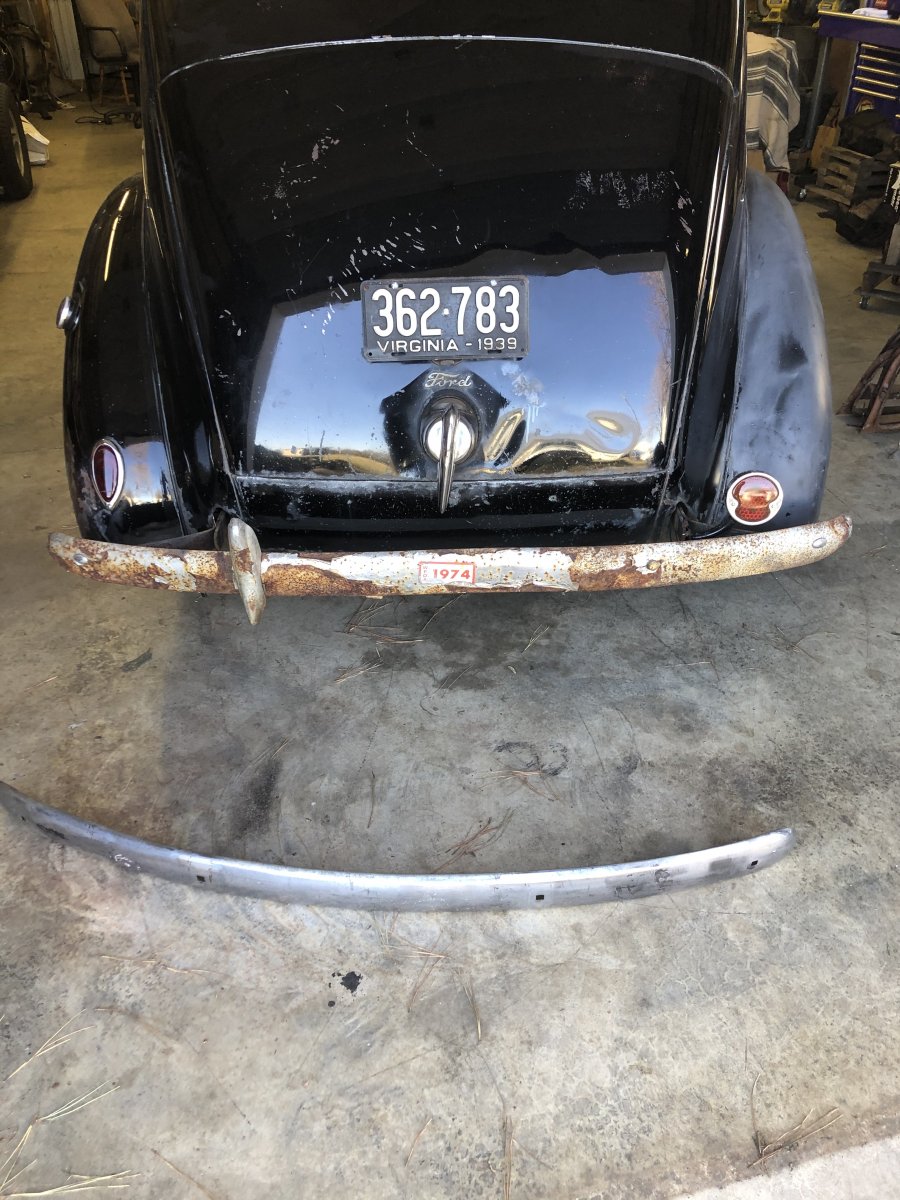

    No major updates but I was able to score a decent bumper to replace the old nasty one that the chrome was peeling off of. Yeah it’s a 40 bumper but looks way better. 484823E4-025D-4C94-B2CE-D0E6E2011768.jpeg AC4A9B0D-8F8D-404B-B78C-191DD14065CF.jpeg

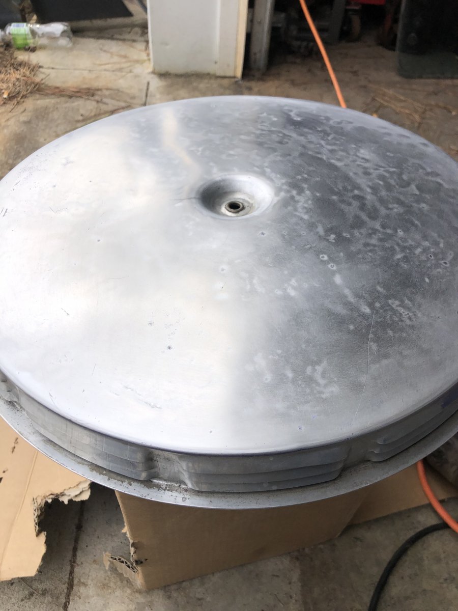

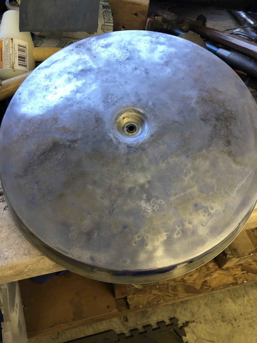

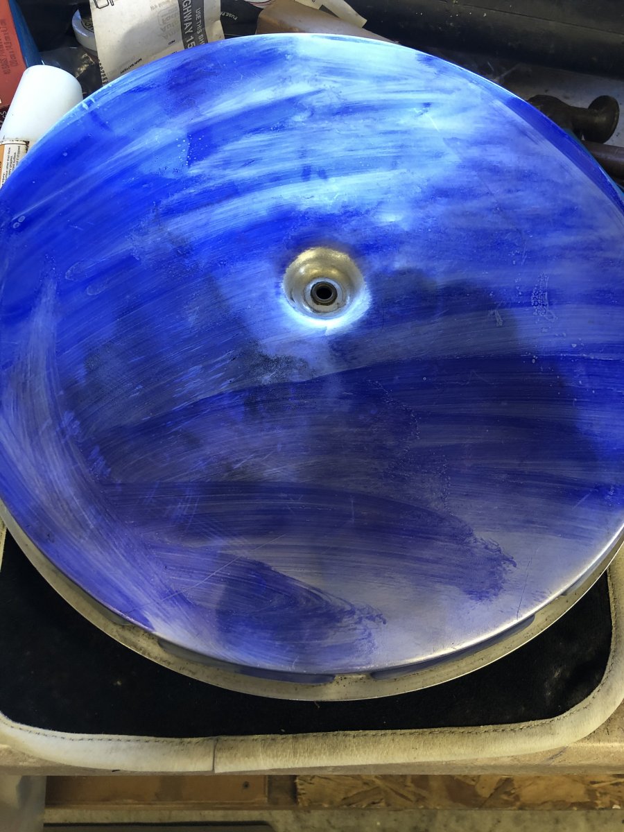

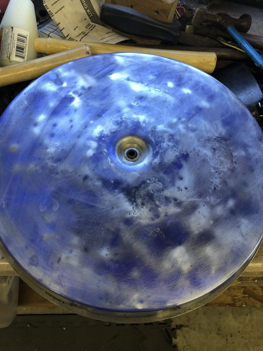

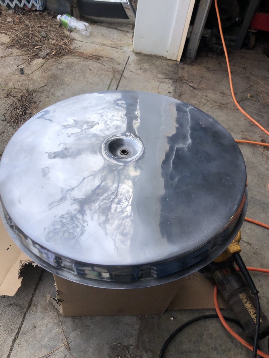

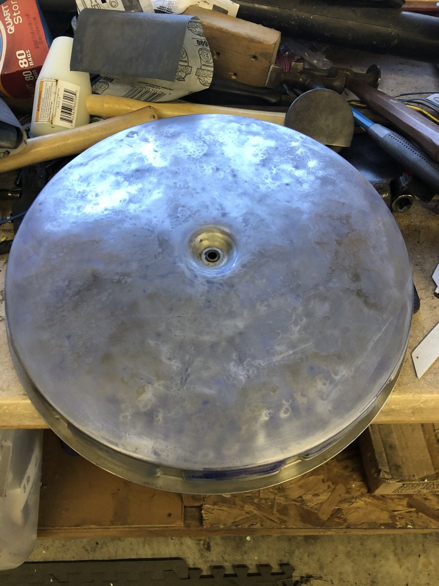

    Also I needed I larger air cleaner. That little one was restricting it with its size. So I found a super cheap early vette air cleaner that was all dented up. It was a learning experience for sure working aluminum sheet. First time I ever have. And this thing was soft. Had a big egg shaped dent right in the middle and about 60 tiny ones all over it. So I roughed it out using a shot bag and plastic hammers and then worked the small stuff out with a hammer and dolly while giving it a little crown at the same time to stop the oil canning. Then sanded it up to from 320 to 1200 grit, then 30 min on the buffer followed up with a hand polish. Looks pretty good for me. Not perfect but matches the rest of the worn car. 2082EFA5-7720-4A53-A981-973529C226EF.jpeg 39970E2E-8762-4321-AC4D-7E34B51F0B11.jpeg 11C679AB-60F9-463D-8D90-028BC84AF214.jpeg 7109C792-6B7A-4655-BDF7-BFF77AA2695A.jpeg 32BBED60-2178-4D39-BC72-EF02B5B3FFB2.jpeg 3C3C86C2-0440-4282-9979-2F810ABF7A1F.jpeg C941563D-ABC7-45A3-B490-E9C583526B81.jpeg C42E2481-DC84-44E1-9399-1C09DBAB08EA.jpeg B2183ADA-0285-4CAF-BEDE-969852044FCF.jpeg CD7DCF69-2A5C-44DC-9BCE-CF66707F3580.jpeg

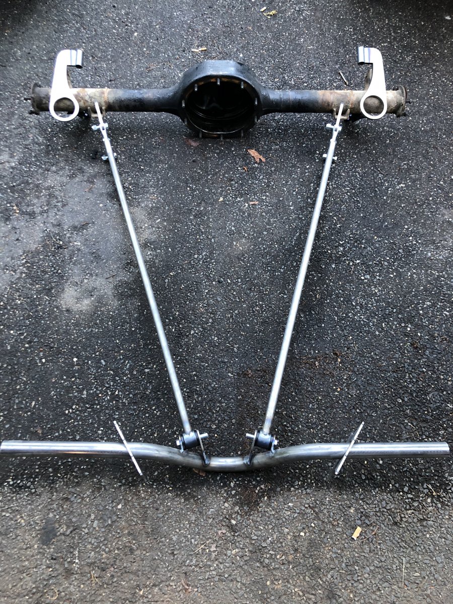

  30. Nailhead Jason
    Posts: 4,515

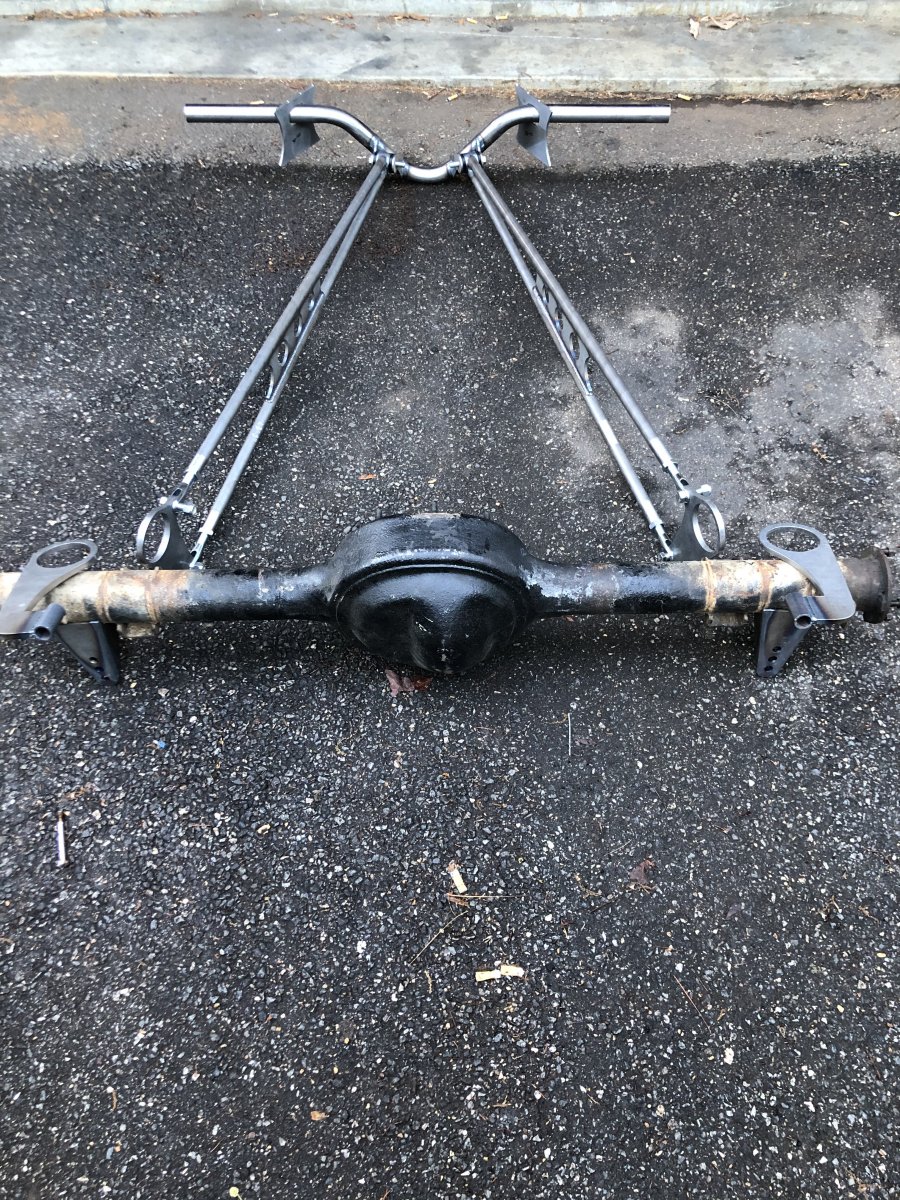

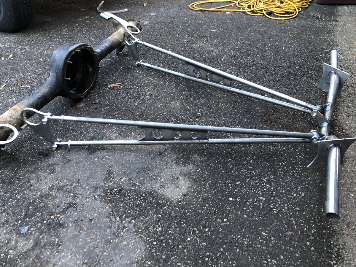

    Nailhead Jason

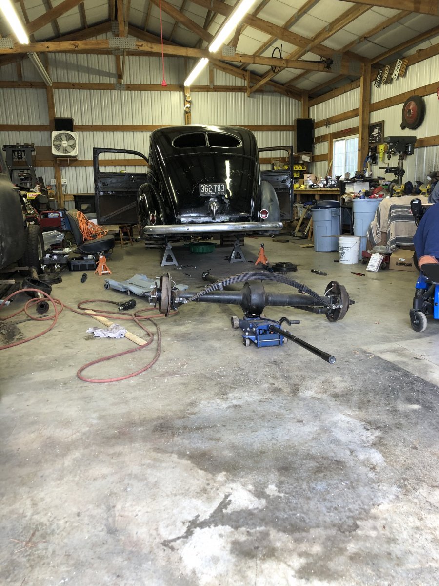

    The nine inch and ladder bar swap has begun. Got the car up in the air and the banjo out. The housing is prepped for the ladder bar and spring mount brackets. Working on a slick way of locating everything fir the install. I’ll post that up next weekend after I get the rear housing and ladder bars set up and installed.
    1159C0AA-CD16-4037-AD1F-224B8DB448E4.jpeg 68845A01-8899-4FB2-9B1C-AE7728D78B85.jpeg F9E892C3-3899-4C17-BB60-A62E623EF519.jpeg 0FE949F0-1E66-41F8-B8F0-2D983CECC0A4.jpeg 0ECAC512-018B-41C1-B118-269A10D91B4F.jpeg DAAE479D-1823-4C84-8FFD-F240E22D18C4.jpeg
