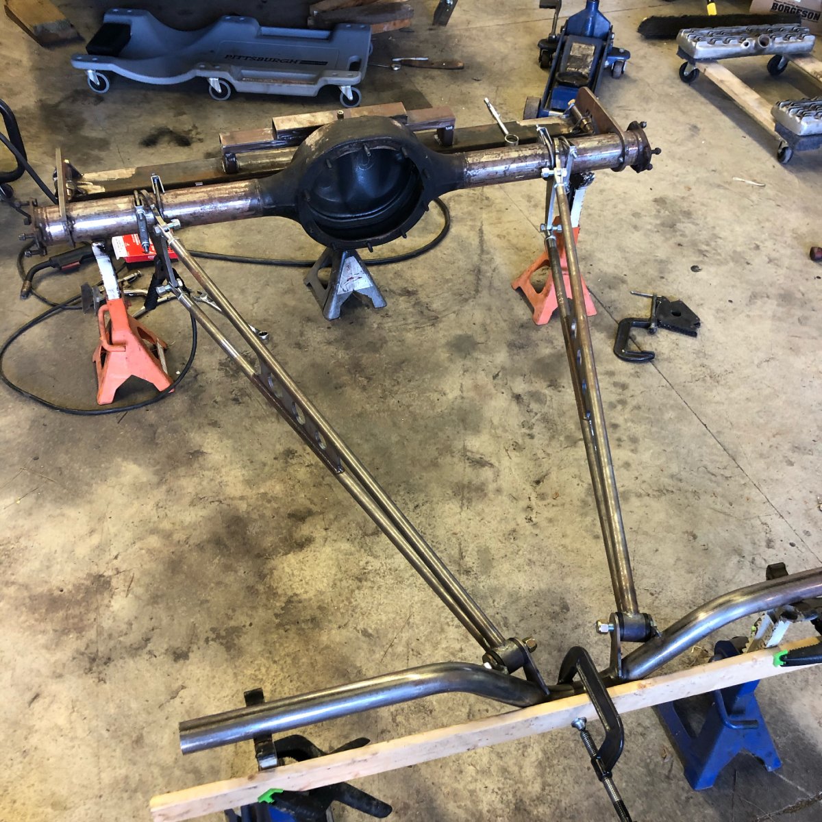

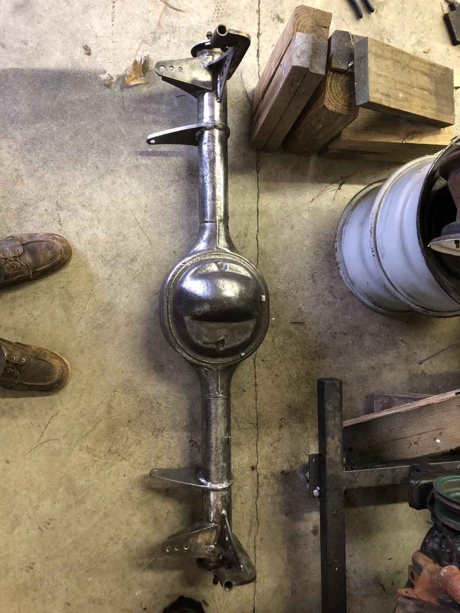

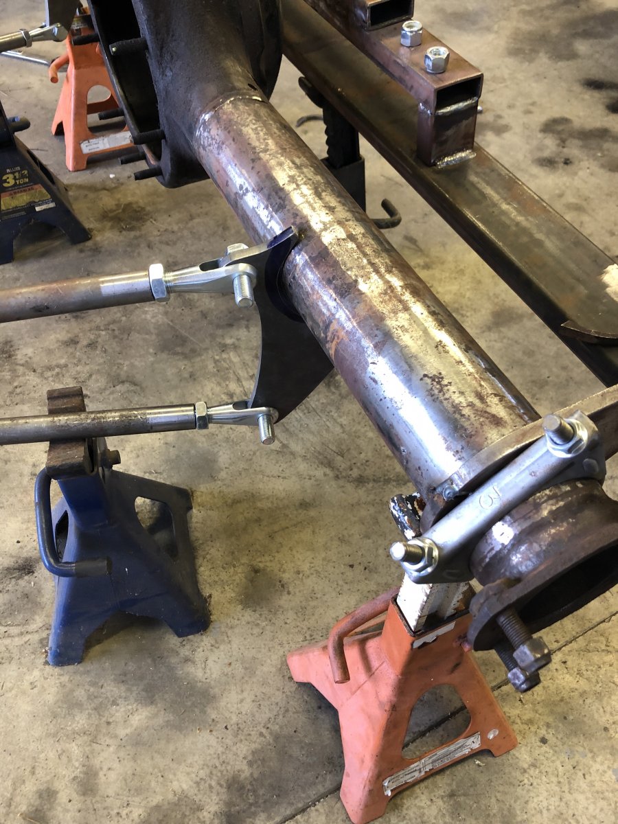

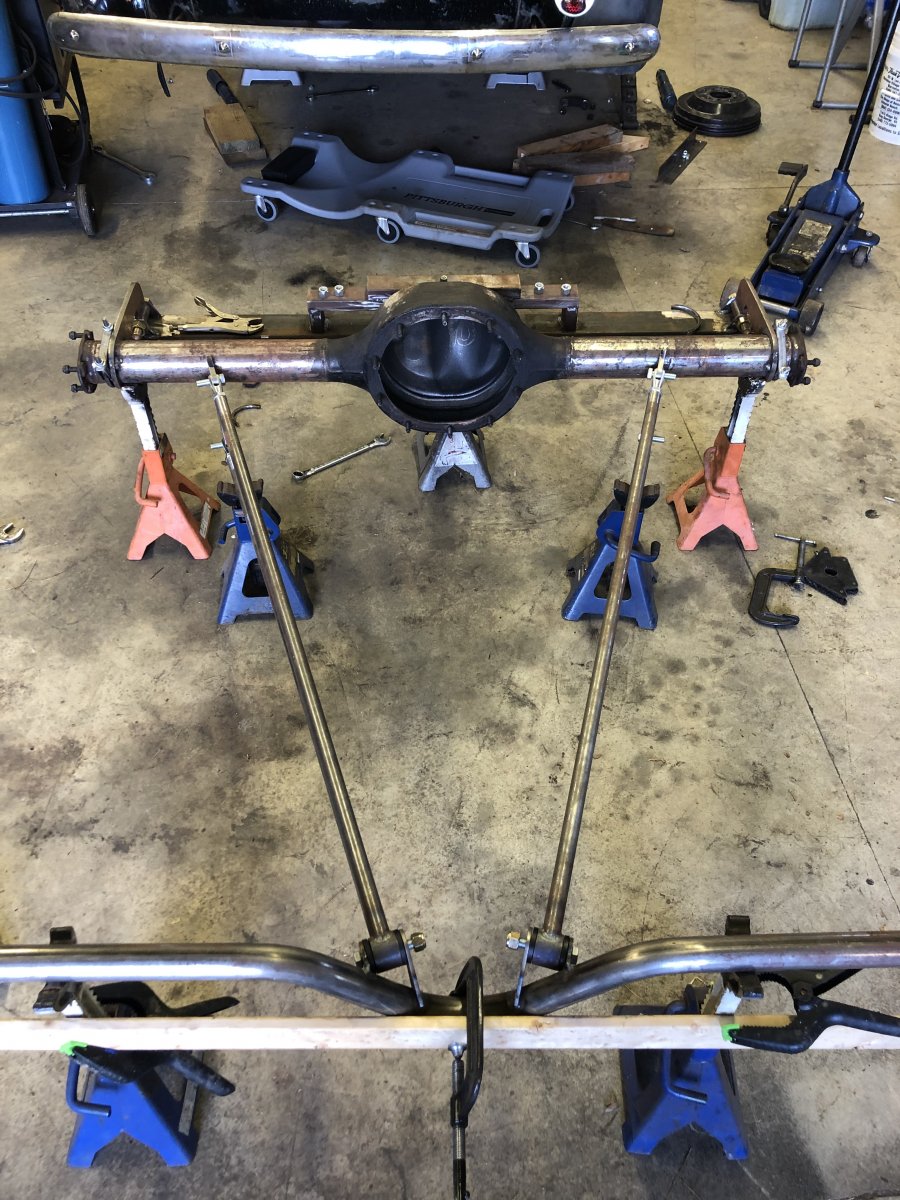

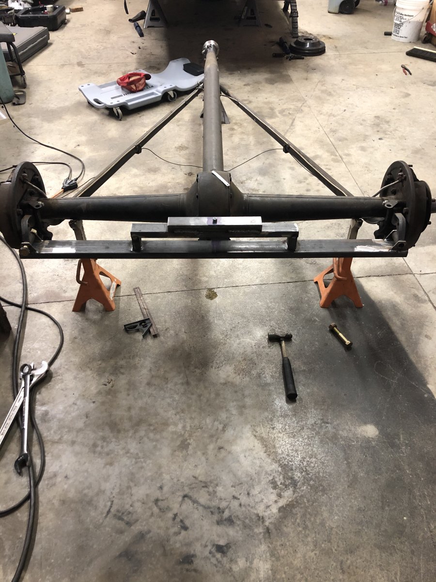

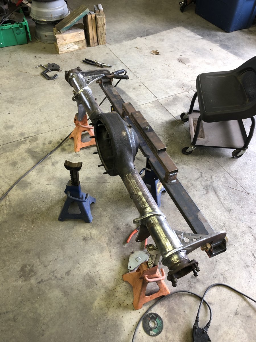

    Ok between work and kids I finally got to get this ladder bar stuff all wrapped up. After getting the housing clear of old brackets and ground clean was trying to come up with a good way of getting all the brackets on the rear with minimal amount of cussing trying to set all the angles up. So I made a jig off the original banjo that takes the place of the spring, that simulates the height the posies reverse eye spring that was on the banjo, and that I will be reusing. This would allow to bolt the entire ***embly rigidly into the car and to set pinion angle and make adjustments. I cut the full circle brackets for the ladder bars and the spring in half then tacked them back together around the axle and bolted the jig to the spring brackets. 3117F477-0F1C-4191-9891-5DD01D31E908.jpeg 2D15E9C0-BA7E-4AEF-940A-2B3C191B6039.jpeg 64E7A637-ADFF-4593-B1DF-C8988C23F41E.jpeg 548D2E94-EBC5-4D32-A092-70CB0E01047A.jpeg 04501D96-3C11-4694-8C30-18AEC459725C.jpeg 94FE80C1-854E-490C-AA07-21F1D275FDF5.jpeg 6B6FE1D6-B811-49EB-BDF4-27949660A8CC.jpeg C28EBE38-C4FB-4ABD-8F3C-3303B592DFCF.jpeg

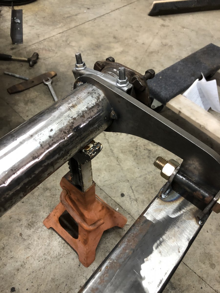

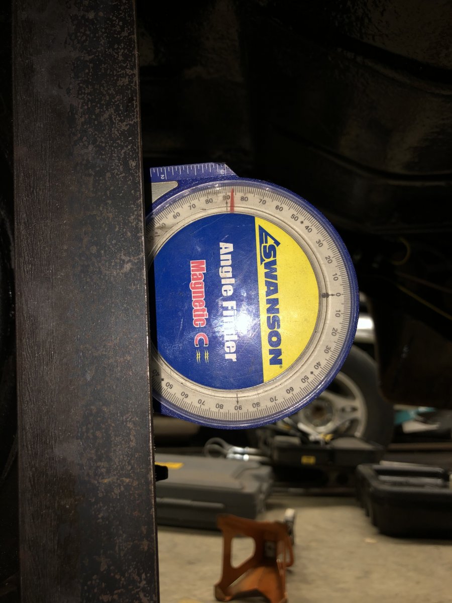

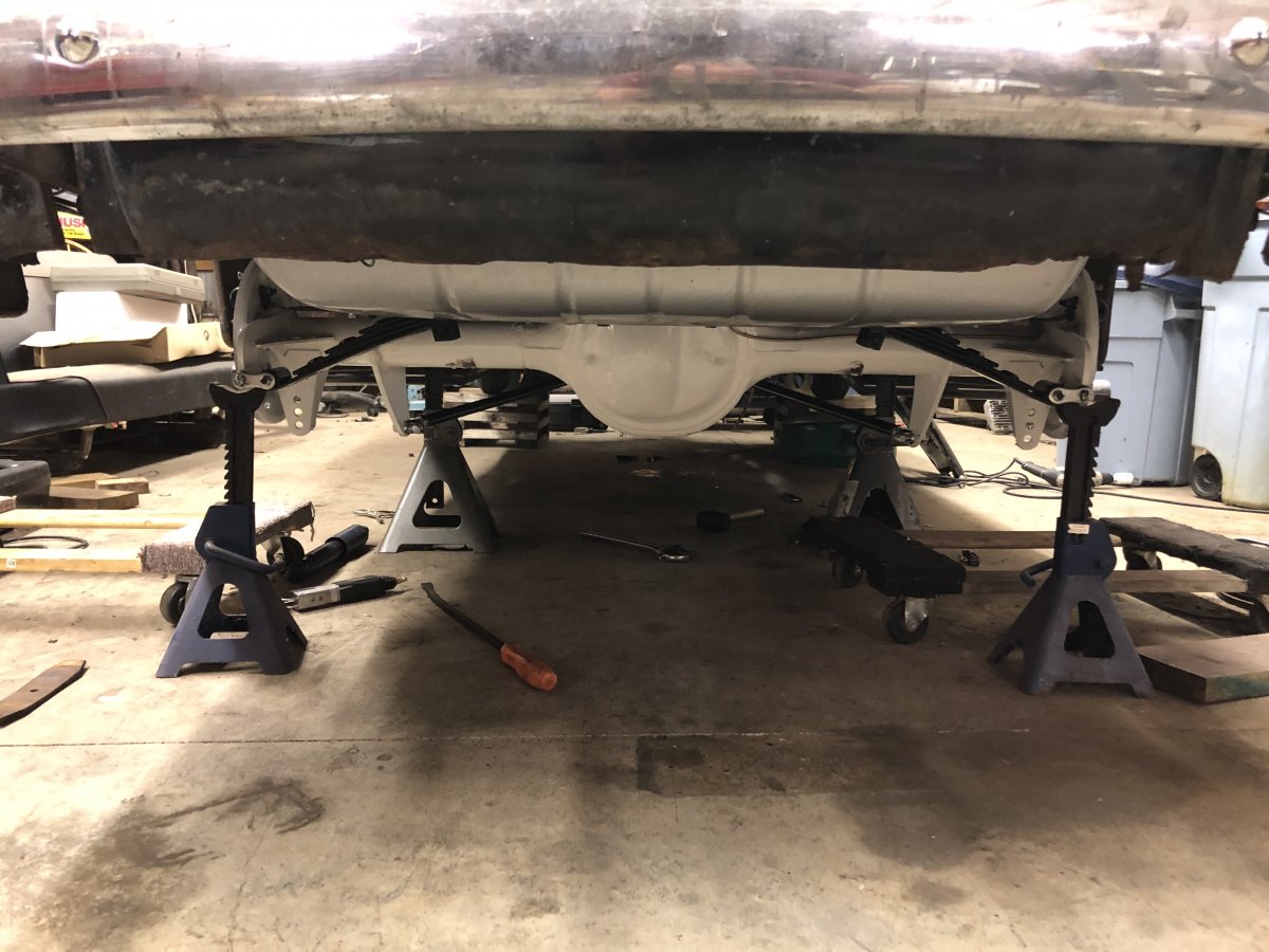

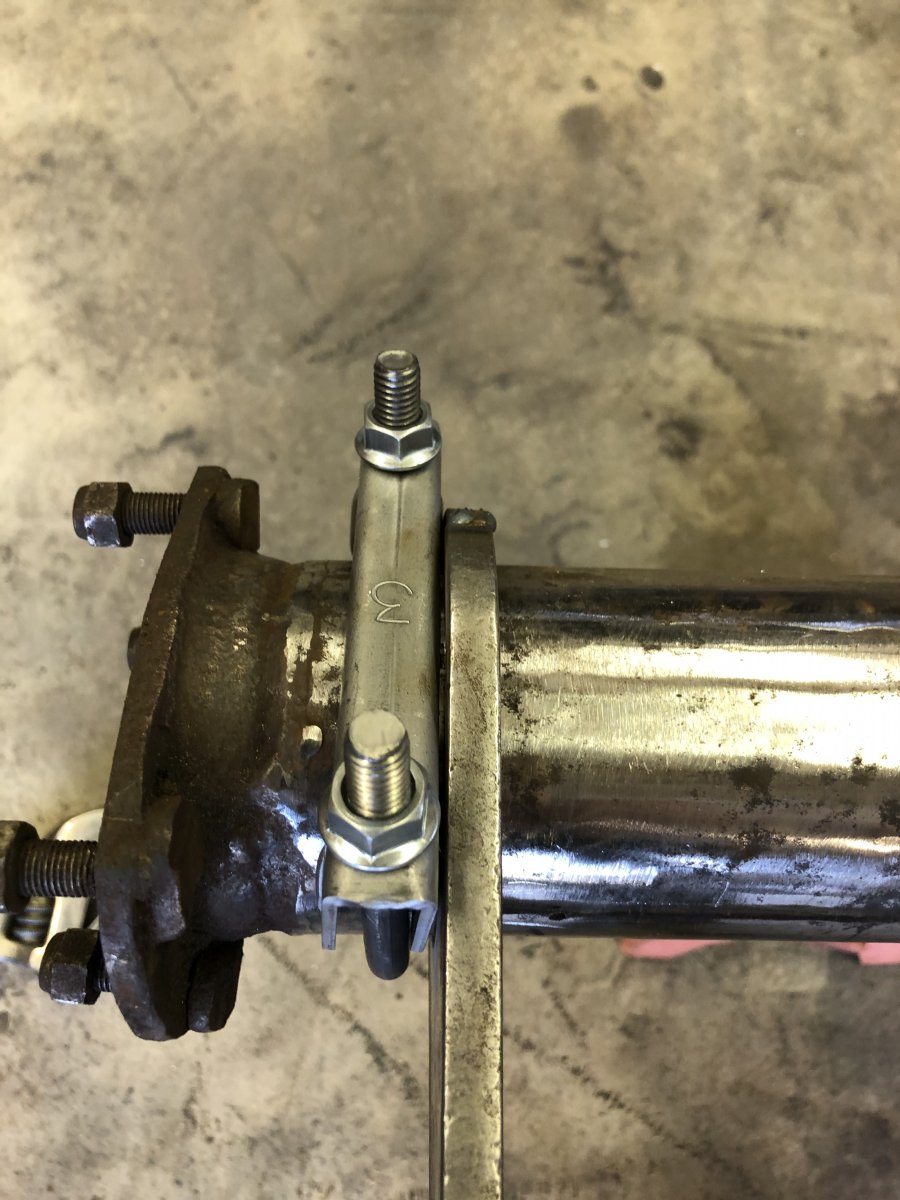

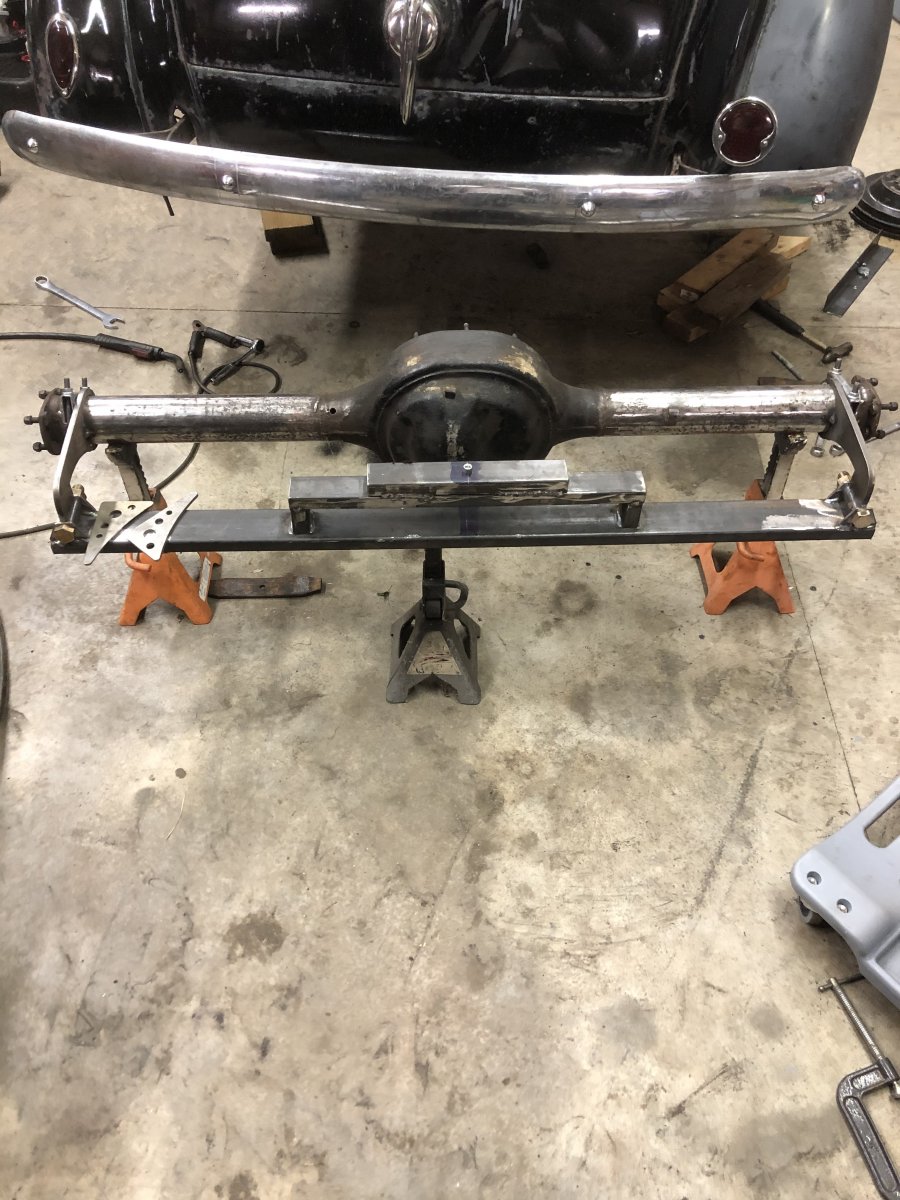

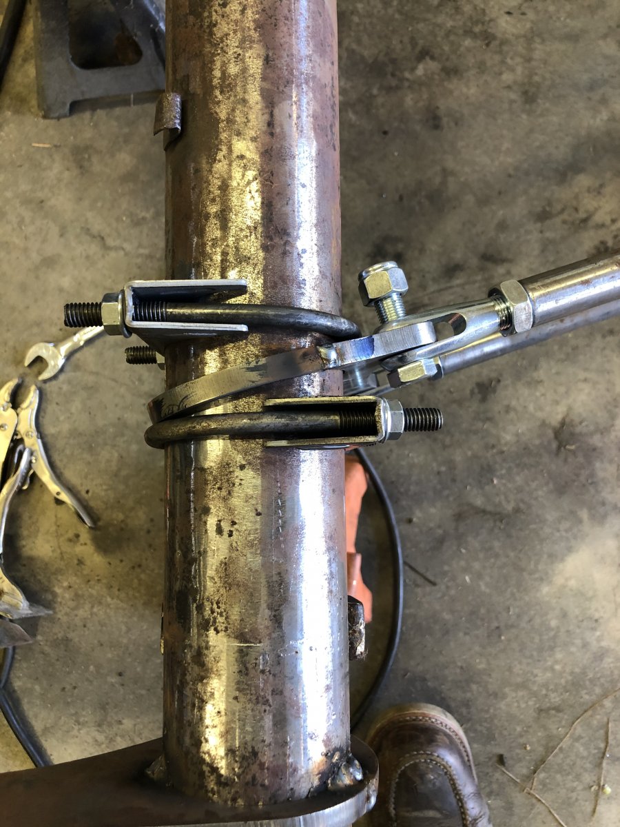

    After making the jig and getting the spring brackets on it loosely with the jig in place, I centered the rear up on the spring brackets and used 3 inch muffler clamps around the housing tube to keep it all in place. I was able to bolt it into the car with the bare housing to check fit and placement, and it was spot on, so using my magnetic angle finder I set pinion angle on the housing and tacked the spring brackets in place. A3303FD7-710E-4BF9-BCDF-F296F4FA2788.jpeg 47D84A20-1DF6-4C75-8462-C5A6F6498190.jpeg D4A52FCD-F010-43F0-8B77-13CD1910F539.jpeg B250E72E-0336-420F-9035-7D70BB0FDDF6.jpeg ADC20012-1D8F-4F28-B753-8D8C5E4B5D41.jpeg 3D25457F-44D2-40FF-B26A-F12B2DD791DF.jpeg CBC10FC7-5047-4769-9693-375DF3EC494F.jpeg

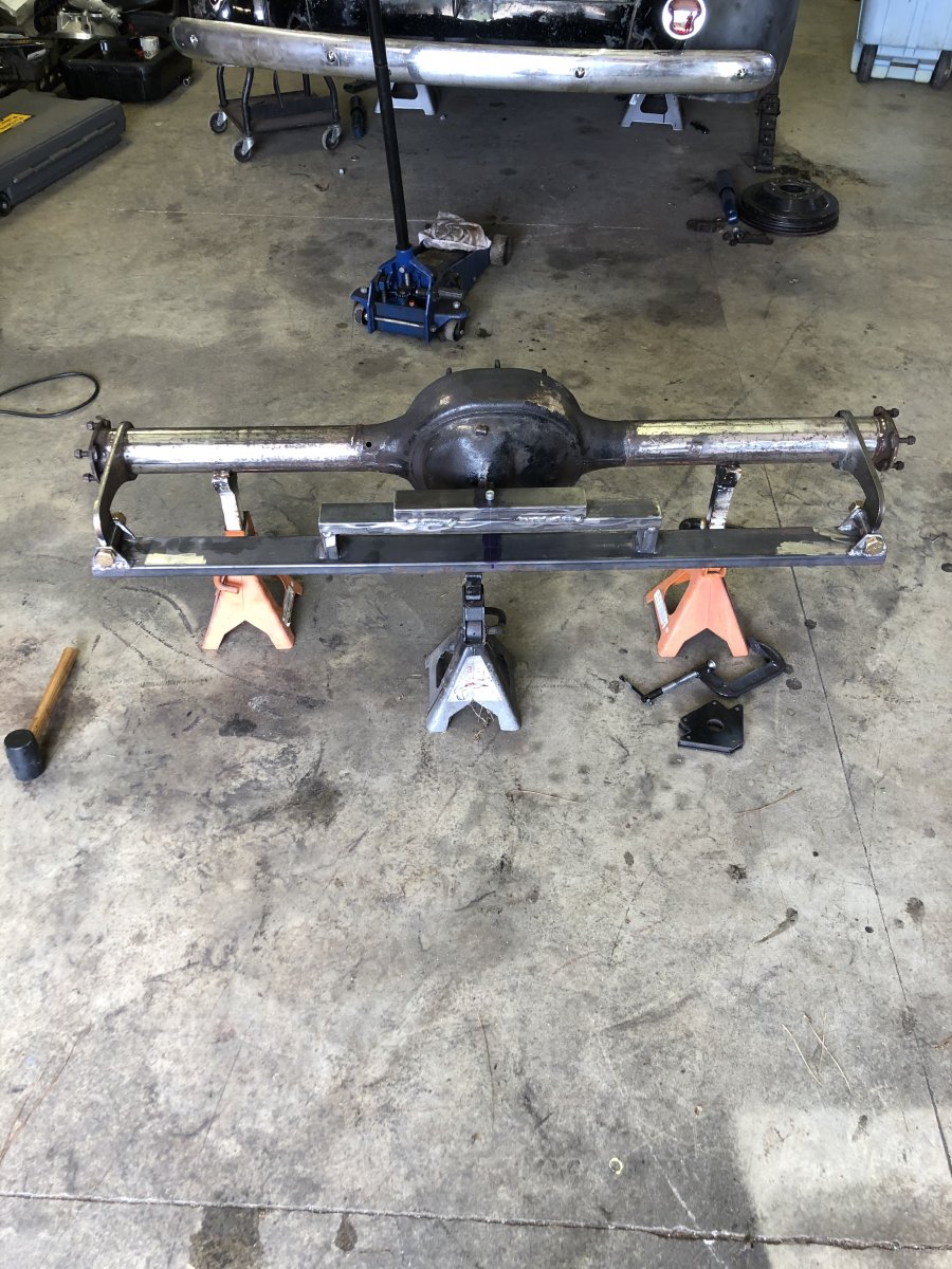

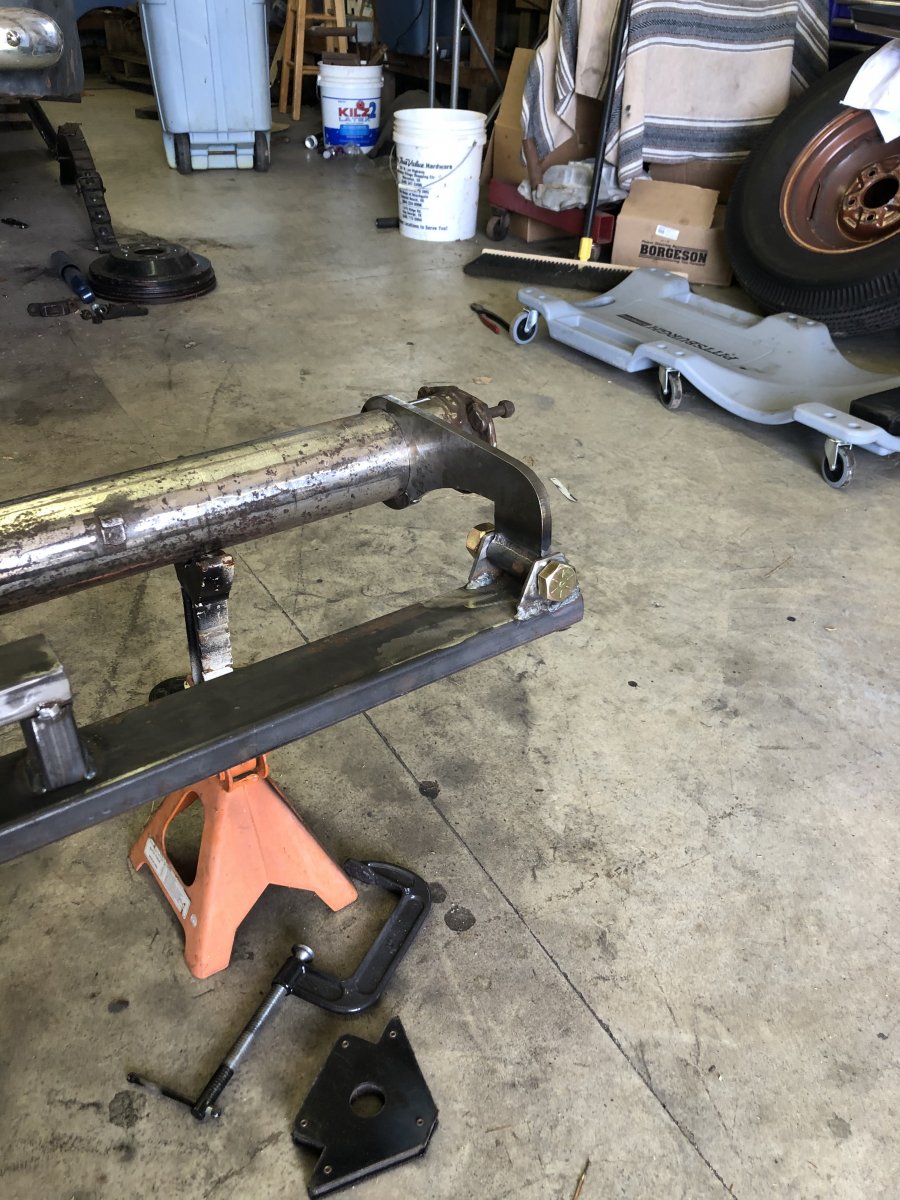

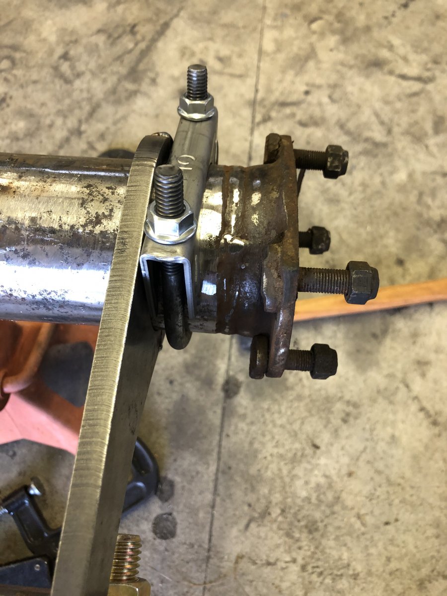

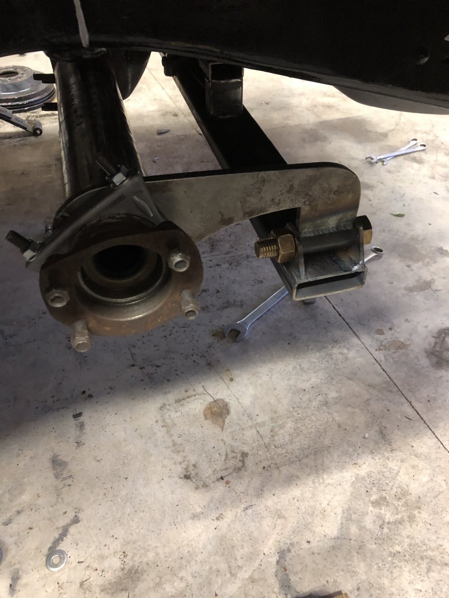

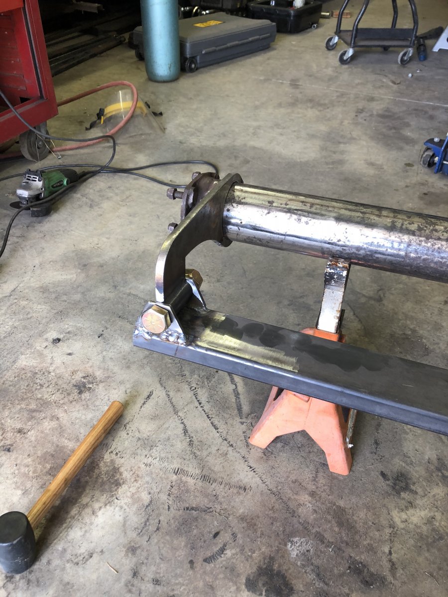

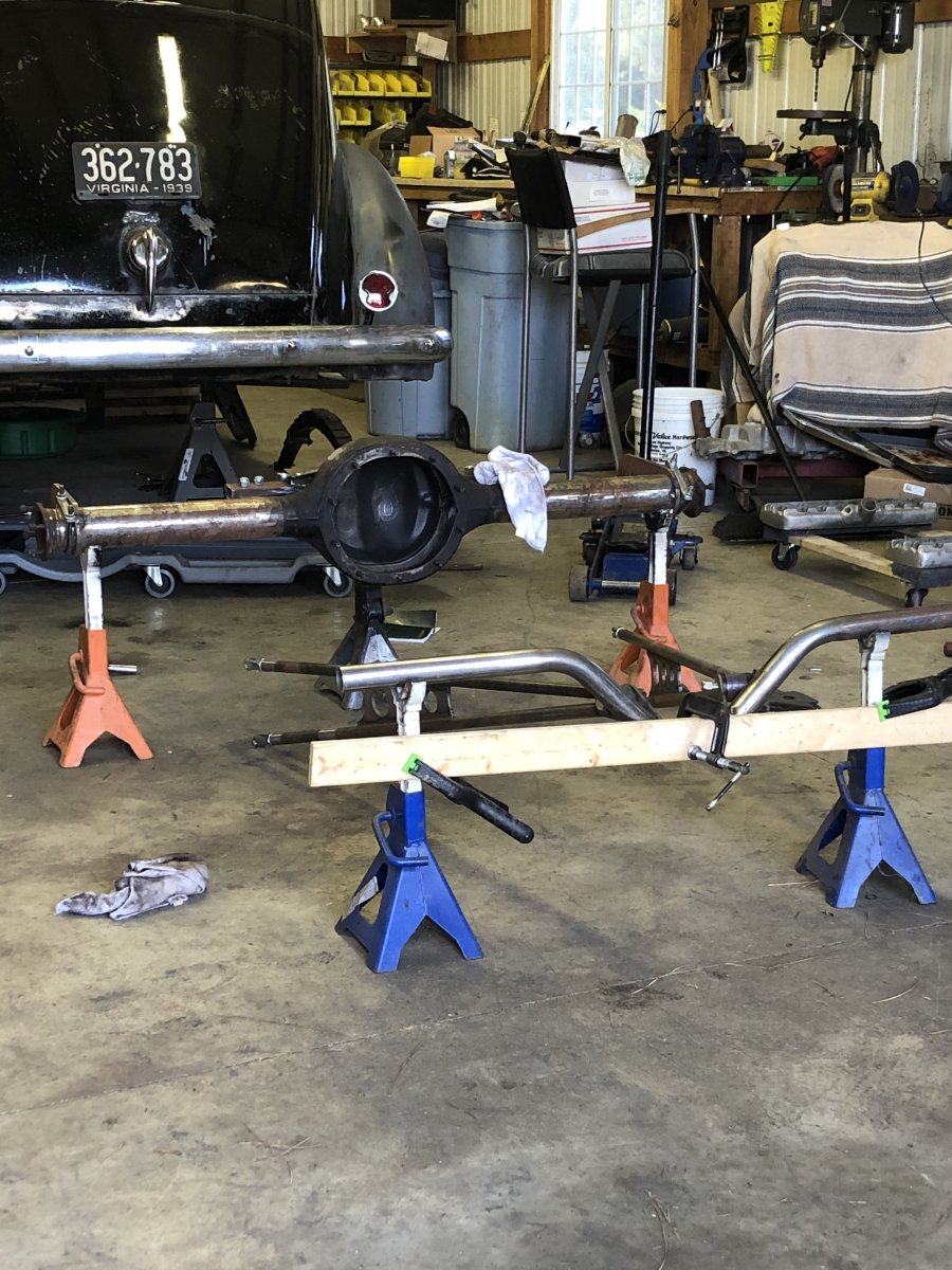

    Now that the spring brackets were tacked on, it was time to tackle the ladder bar brackets. I did the same as before by splitting the brackets and tacking them back together around the housing after beveling the edges of the brackets to allow for the angle of the ladder bars. I then ***embled the ladder bars onto the axle brackets and the ladder bar crossmember. Once ***embled, with the jig still bolted to the spring brackets, I bolted the whole ***embly back in. Once in and confirmed square I was able to rotate the ladder bar crossmember up, to mark its location on the center x member in the frame. Once that was located I took it all back out and made holes in the x member to be able to slide the crossmember into. This way it gets welded to the x member and to the Camembert boxing plate provided with the kit from R Jays speed shop. 503C4524-4182-41D8-B0CD-36B3BE1ACFCF.jpeg 94938C97-6172-4D57-96E8-C13A4969B5A6.jpeg A0E4A233-1C17-4075-AEDC-4C0229C6D5AA.jpeg 5D093589-0736-46A9-BB0B-2DE3D55DED64.jpeg BFF3AFA4-EDA1-4366-B62D-55B95C9A15DF.jpeg 408A5D9F-9E35-47F2-9F40-6A7C1F0BCD31.jpeg 522697EF-7786-45FF-A0D9-EC31A838B7FC.jpeg

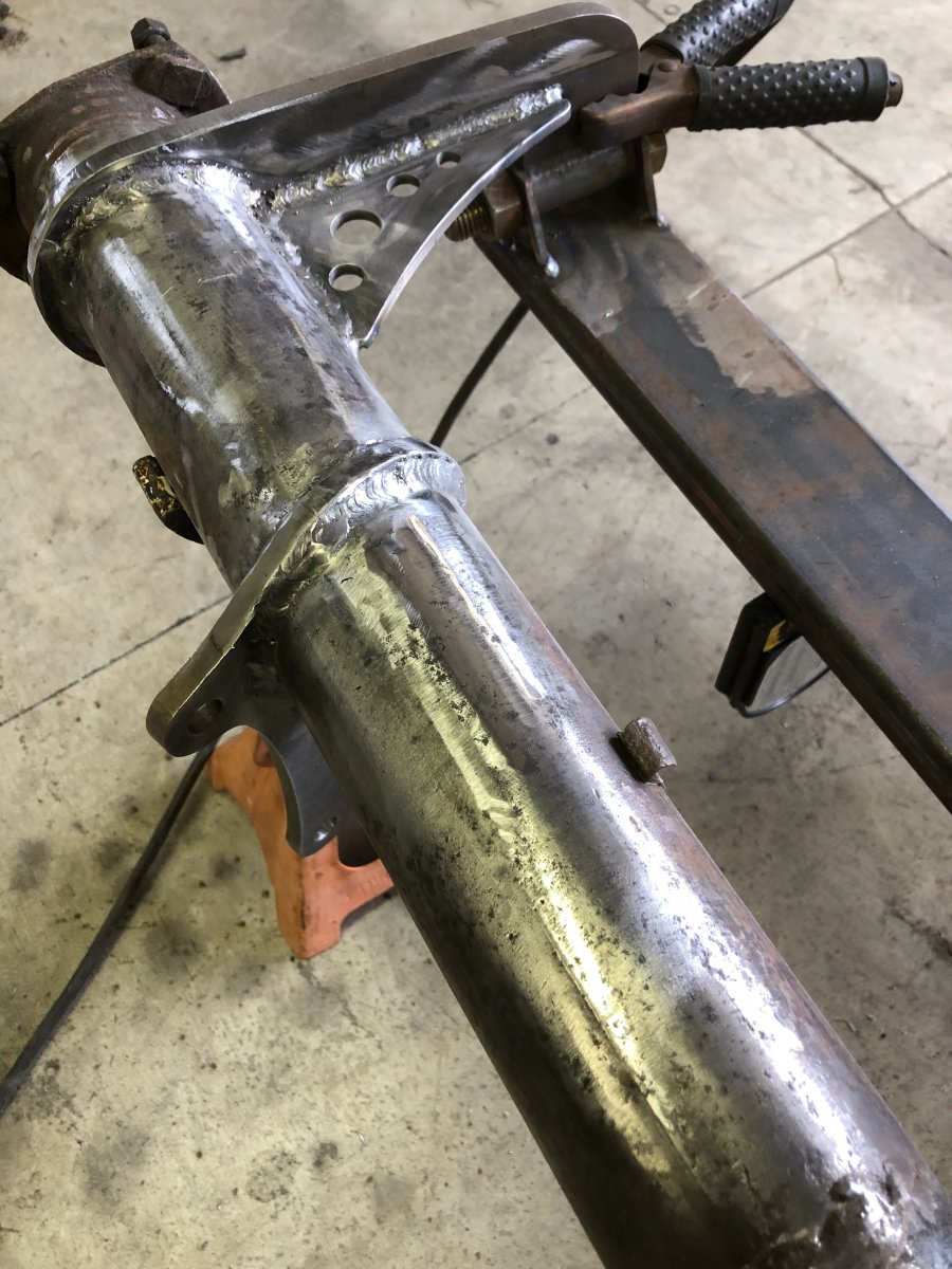

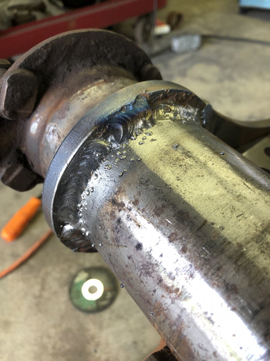

    Once the crossmember was installed I then bolted everything back in, checked all my measurements and for square and tacked the ladder bar brackets to the axle. One it was tacked took it all back out again and slowly, leaving the jig installed, welded all the brackets solid to the axle. Once welded I then peeped the axle for paint. F9BC557A-CE56-460B-BF02-72E81E7C97A4.jpeg A409D2BD-3F0F-4EB1-BB4A-044E849C9581.jpeg 617F6306-633F-43D9-BB42-74A8F77BD629.jpeg 9E228B3A-00E1-4D55-A36B-A28E66FE2FF9.jpeg F9BC557A-CE56-460B-BF02-72E81E7C97A4.jpeg A409D2BD-3F0F-4EB1-BB4A-044E849C9581.jpeg 617F6306-633F-43D9-BB42-74A8F77BD629.jpeg 9E228B3A-00E1-4D55-A36B-A28E66FE2FF9.jpeg

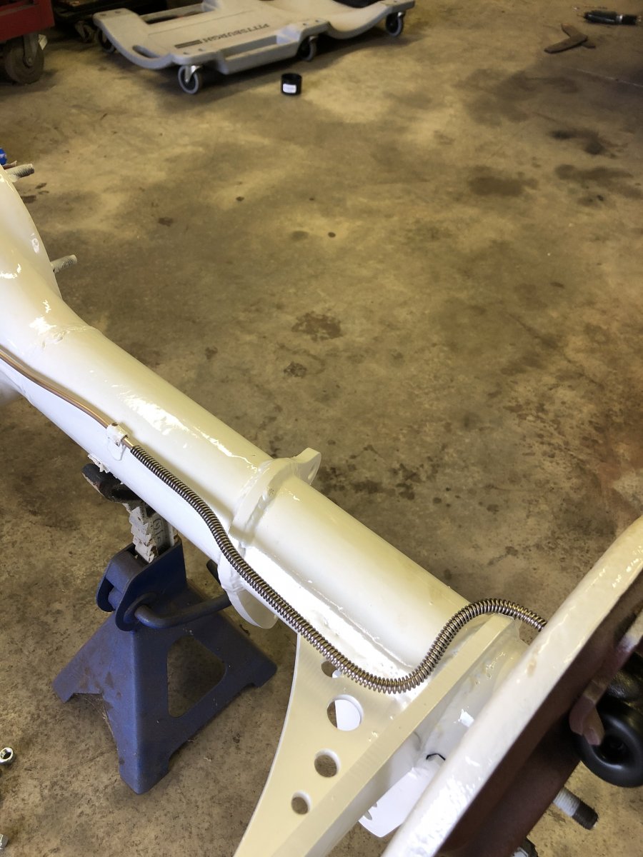

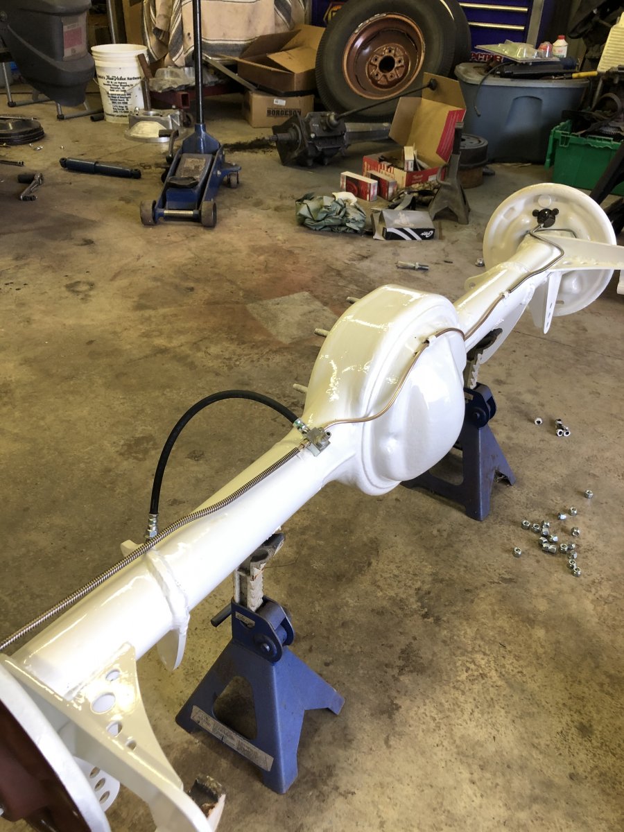

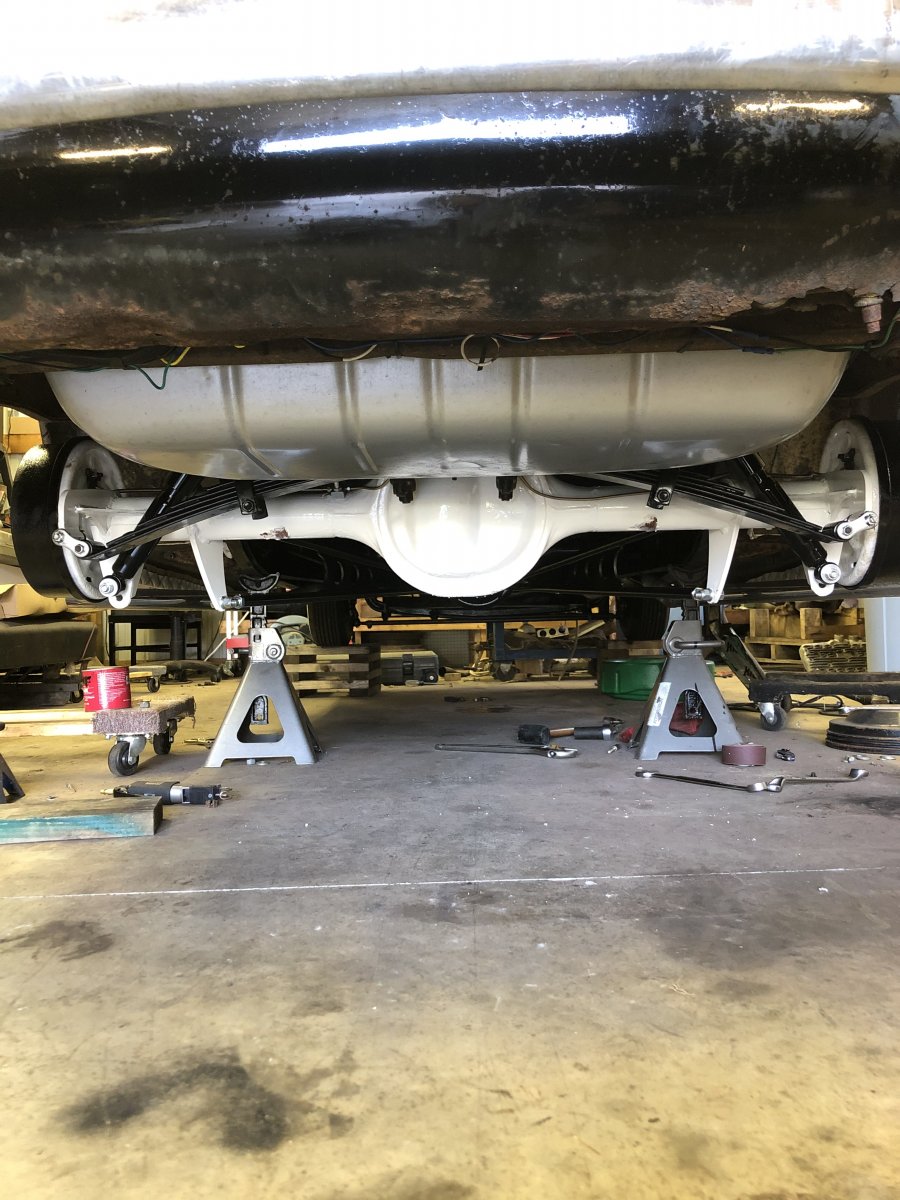

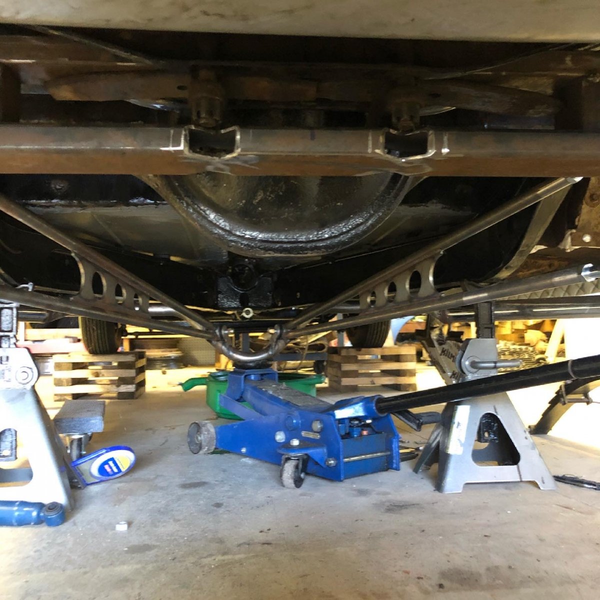

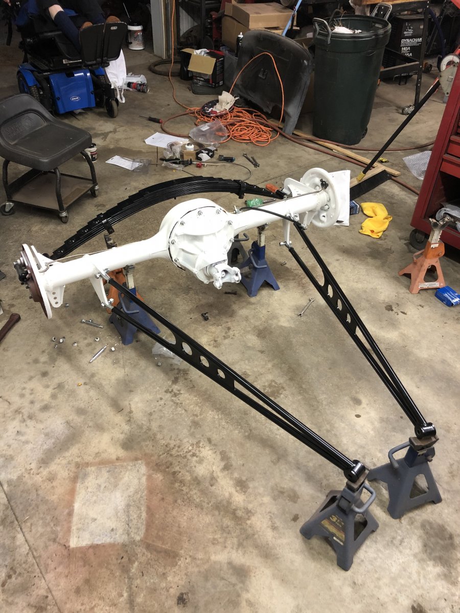

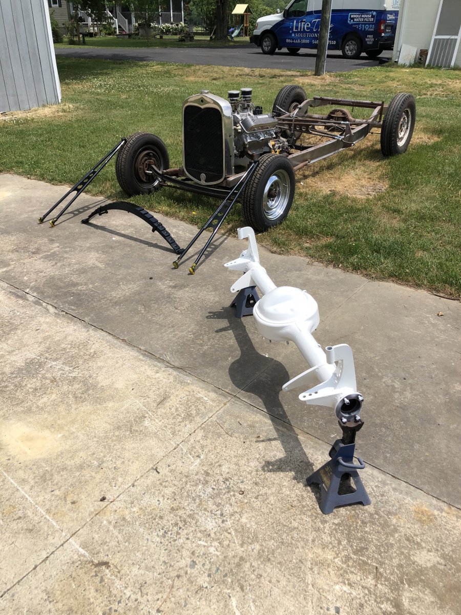

    The next day I got the paint taken care of on the housing, ladder bars, crossmember, shocks, and brakes. And once it was dry I was able to ***emble it all. New bearings installed in the axles, 3.50 gears on a track loc diff, and rebuilt the brakes and plumbed them. 71B75544-4217-4D2E-8CAF-8B945DEEFA3A.jpeg C6788A2F-F6DF-497B-9AD4-E88F7EE01060.jpeg 26B5FA23-C7C5-490D-91B9-131CC7315827.jpeg A4FB7065-F1F1-4234-B0C5-98345C87BE99.jpeg 4DFD2A6F-F1B4-4CB2-81AE-BE55CB21726D.jpeg
  9. Nailhead Jason
    Joined: Sep 18, 2012
    Posts: 4,515
    Nailhead Jason

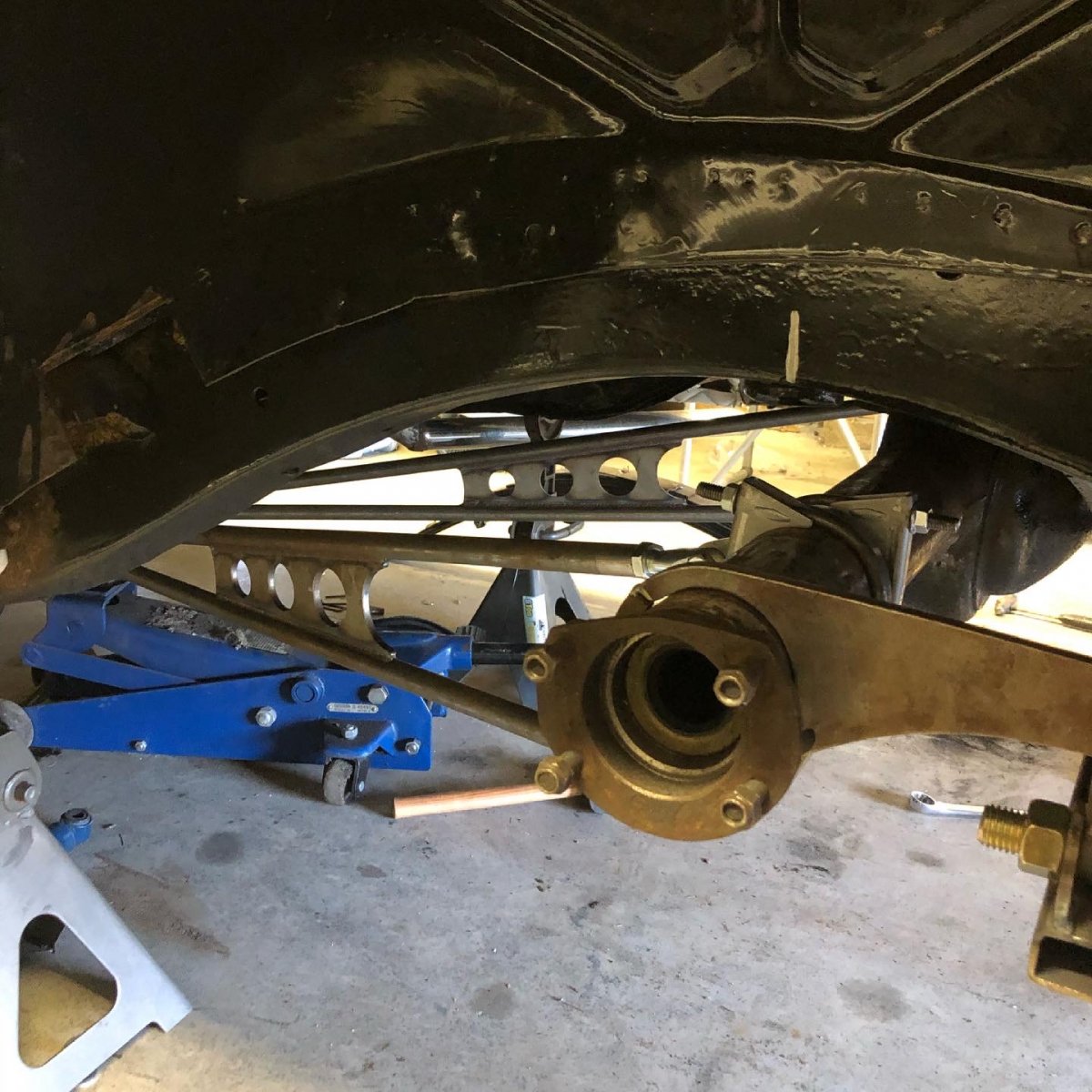

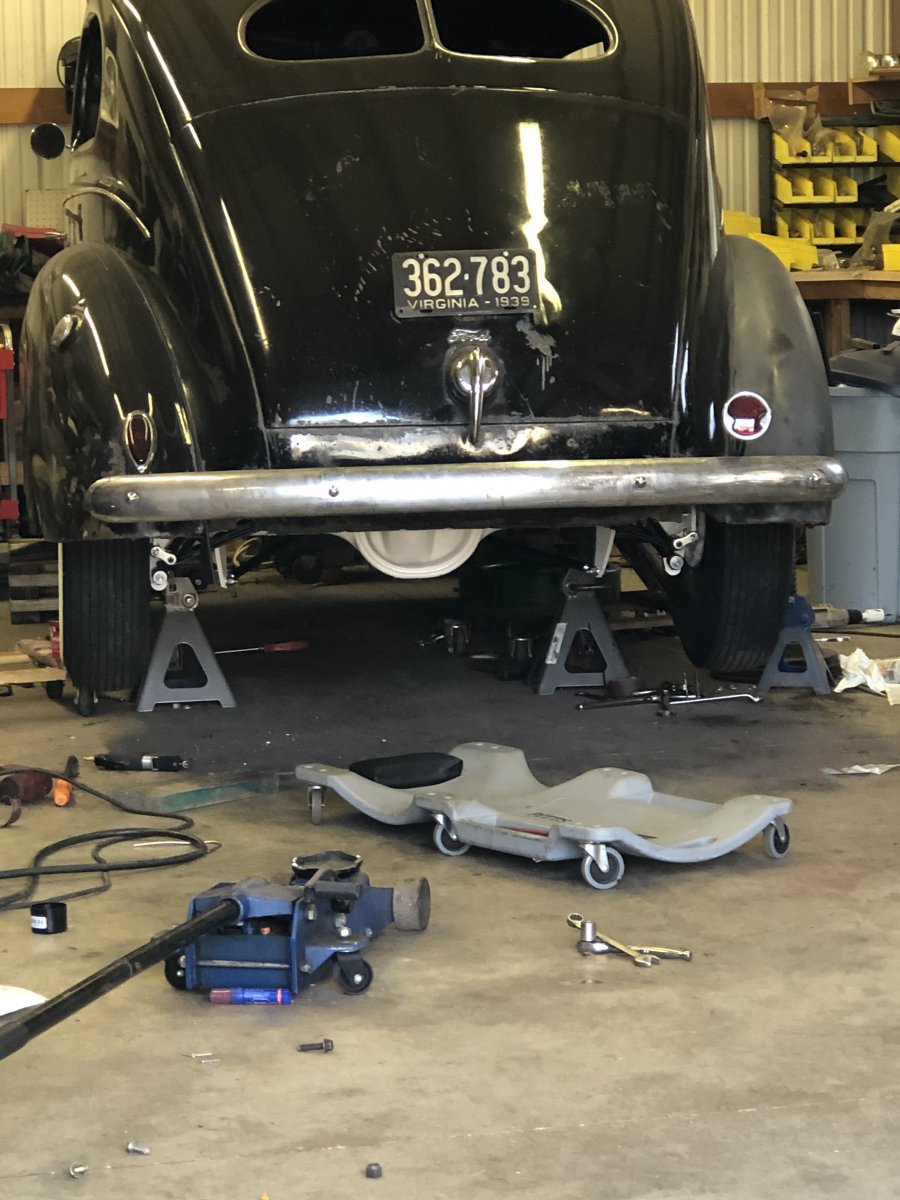

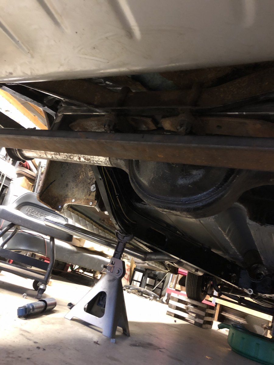

    Then I put the whole deal in! Super pleased with how it turned out. Now I won’t be scared to do burnouts. This weekend will be the trans swap and I will get all that up here as well. 7D9A8483-68F4-44CA-BF74-EFEB953E6DFC.jpeg 7477B373-E619-419E-A755-8595A7CD8193.jpeg 877F543C-BE0A-4152-9E63-A505237299B0.jpeg B08BCA2B-D36F-42BD-9291-B17E6AAF7576.jpeg

    thanks!! Always wanted a white rear axle. I have 2 other ch***is I need to put these ladder bars on, so this jig will save me time and effort on those jobs.

    A very well planned and thought out project. Jigs are a fabricators best friend , it take extra time but the effort is well worth the reward.

  16. That Jig Tech should have had its own tech week post. Probably would have won.
    -Brent-, olscrounger, Stogy and 4 others like this.
  17. Nailhead Jason
    Posts: 4,515
    Nailhead Jason
    I wanted to do a tech week post for the Jig, I just didn't have time to get it all done before the close of Tech week. One night this week I'm going to write a tech thread with measurements and step by step of making the jig and how to use it.

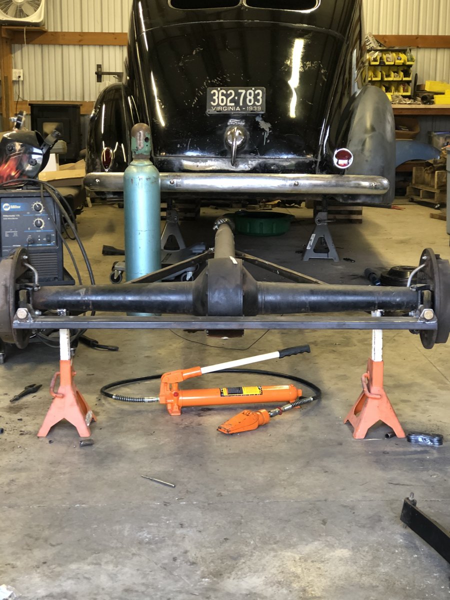

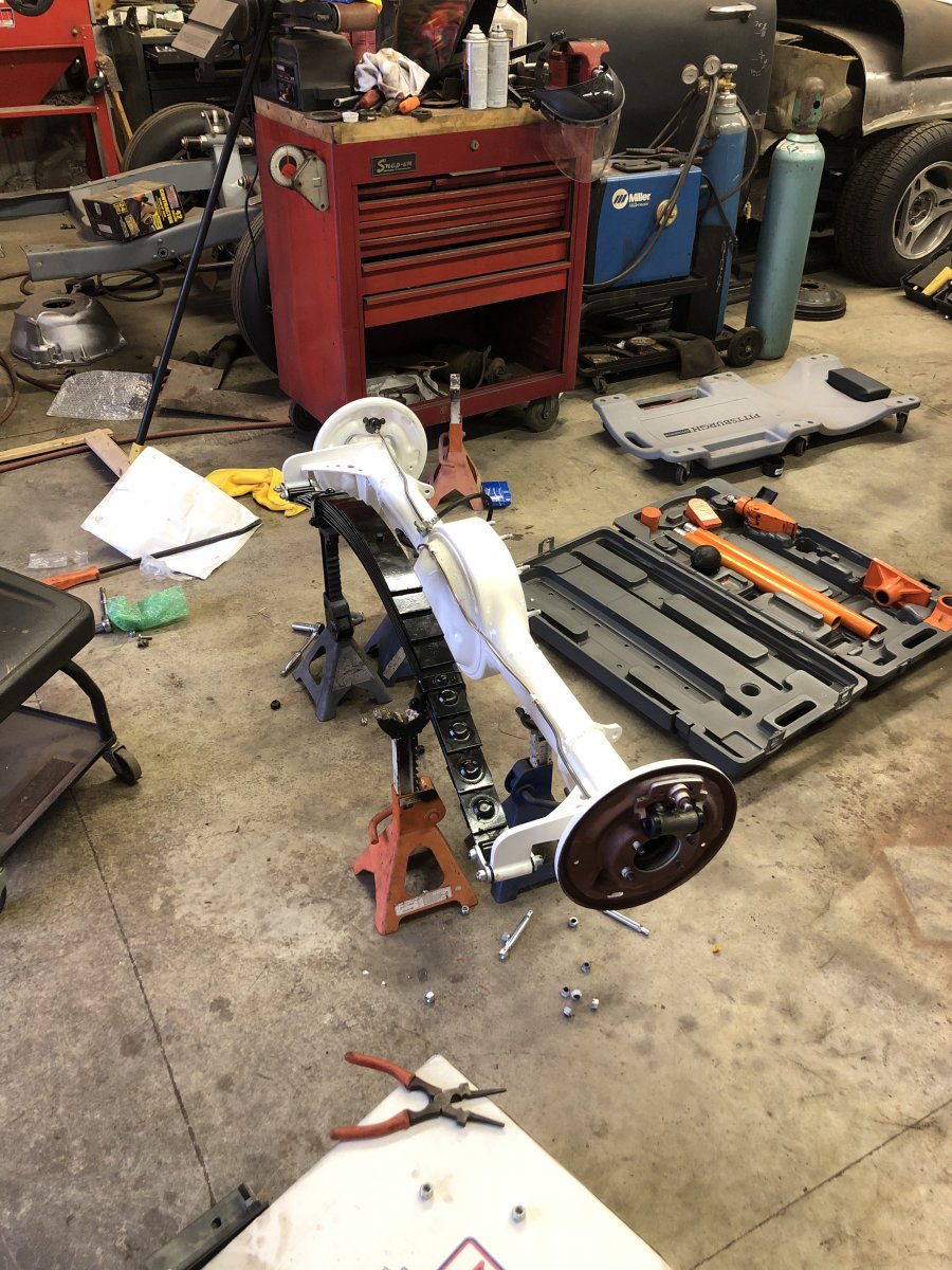

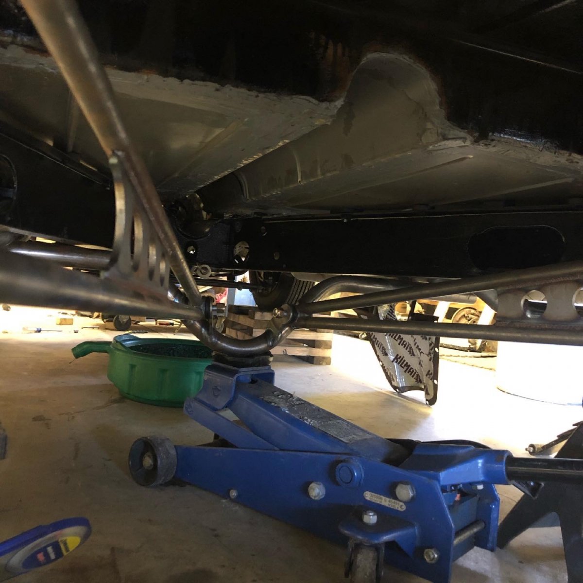

    If you look at this picture of the rear with the jig bolted to it in the car you can see the notches I cut in it to make access to the ubolt nuts easier. The first time I put it in I had to put nuts on with a wrench. Not fun. 0D80EE66-B56D-42F7-8F8F-B1FDD610CF4E.jpeg

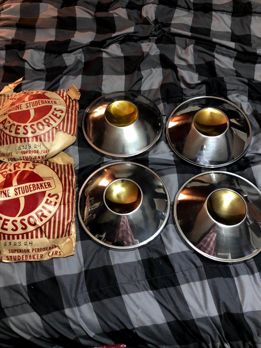

    Now that the rear has been swapped I wil finally be able to use this killer NOS Studebaker poverty caps. They would not clear the rear hubs before. They will require some adaptation to fit the Ford wheels but I have a plan..... B3F3872F-F743-4600-9CC7-8593443E21E9.jpeg

    Did you save the air from those bags Jason?...period air is precious as you know...:D
    Did you paint the center of those as it matches your wheel color...can't wait to see this latest look your working on...

    Nope that is how they came!! But this is why my wheels are this color!!

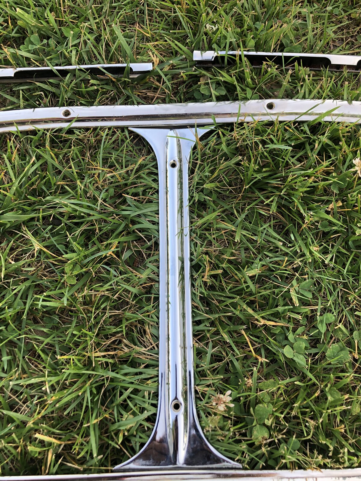

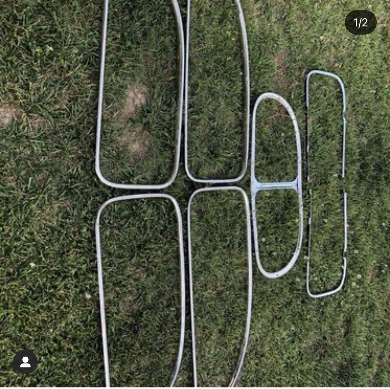

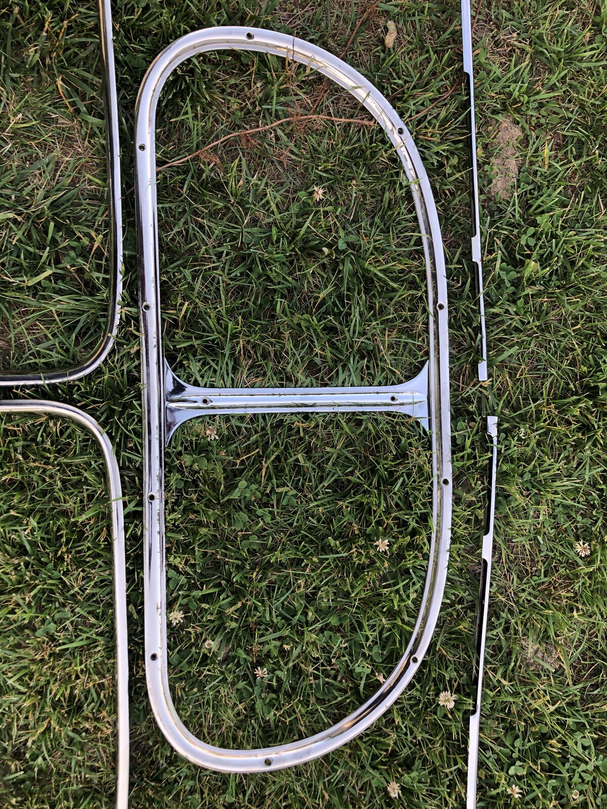

    Picked up all my garnish mouldings in NC from chrome last weekend. Now I can get the rest of the gl*** put in. 2A4408D0-B632-48B7-8D28-7D7627B0CF70.jpeg AA123FEE-CC75-4A74-98AA-71279721DA0E.jpeg

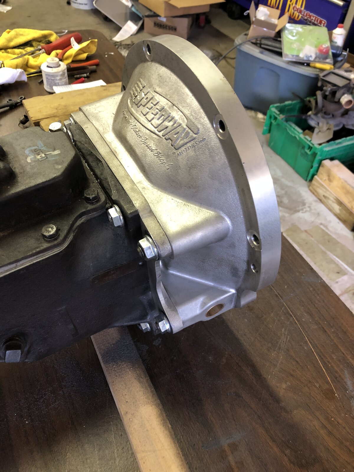

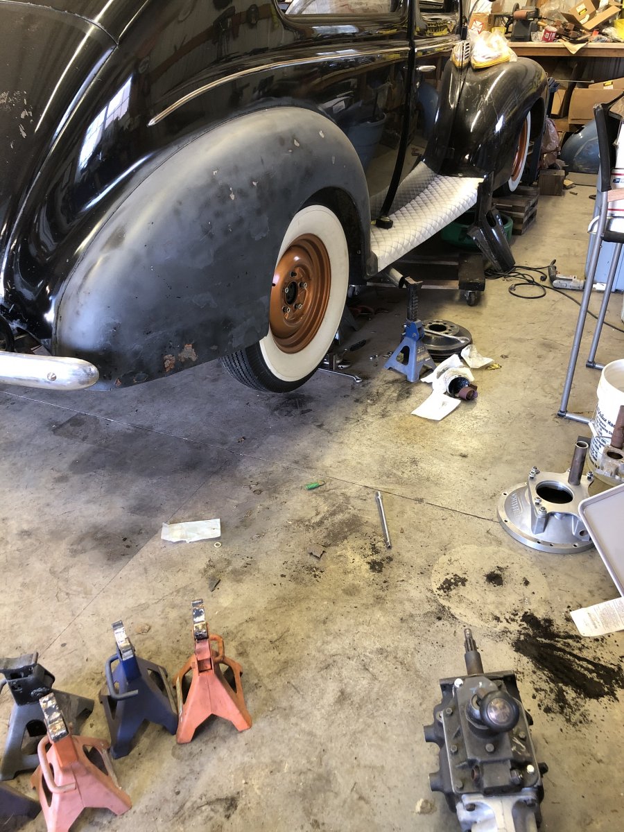

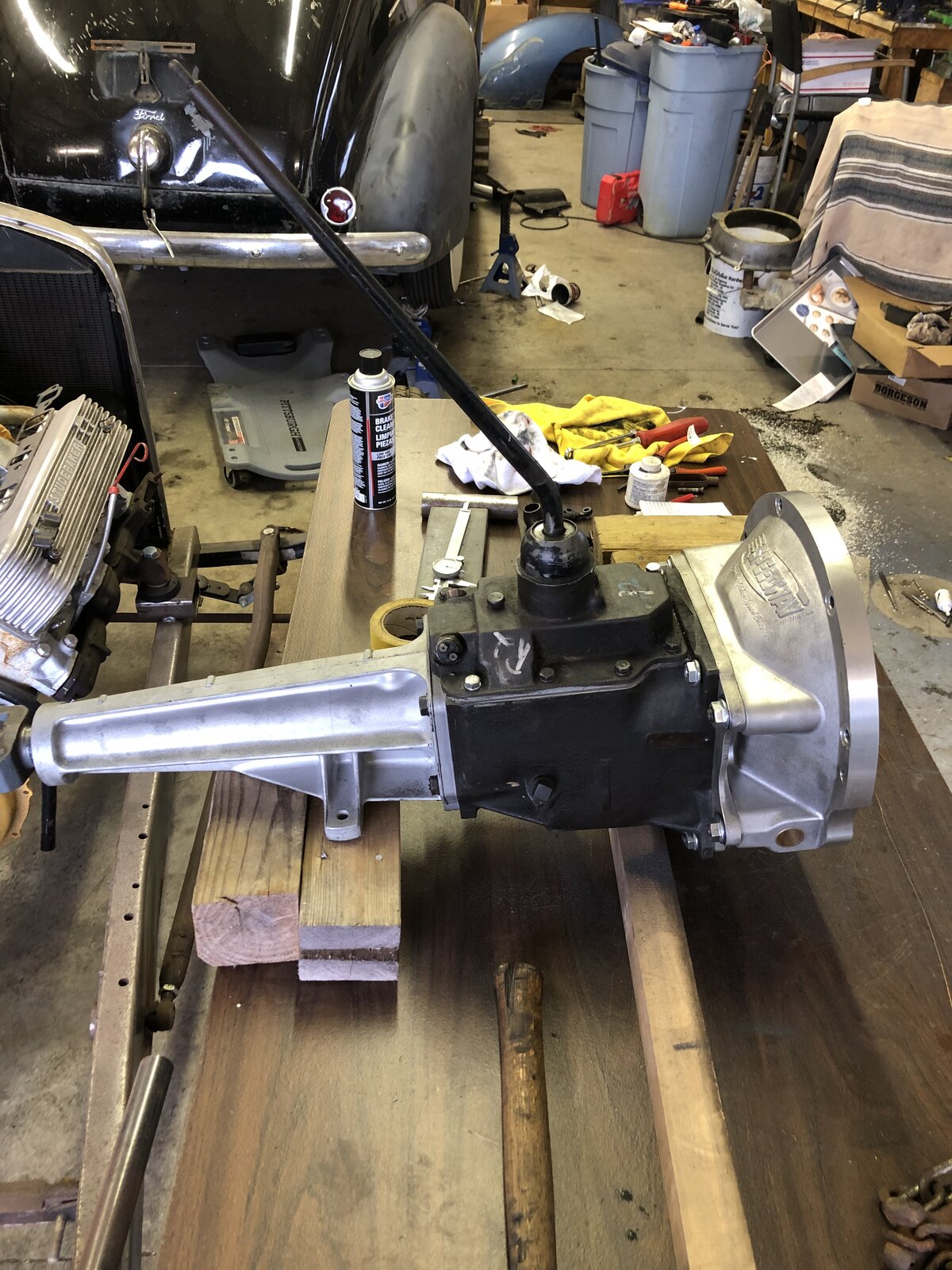

    And the trans is all fitted together and ready to go in. Hopefully I’ll have it in this evening and be able to measure for a drive shaft. 2A174A60-FE2B-40A9-A740-EC47C58E98F3.jpeg 1796B612-F733-4F6F-889D-D8B4AF437CBD.jpeg 2C1068B1-CBB0-4E91-8784-FA2687315490.jpeg

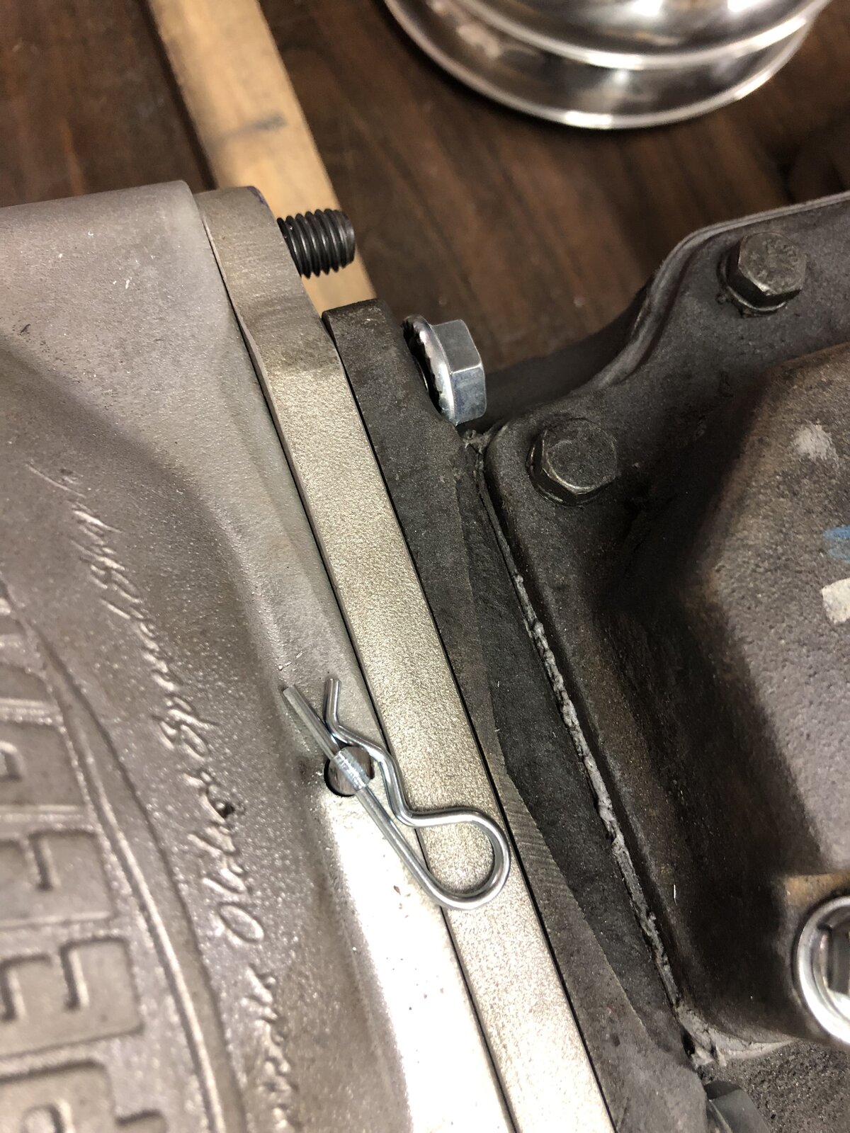

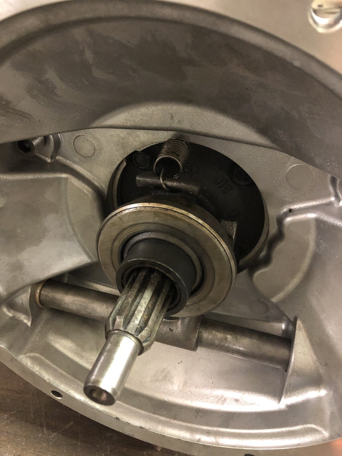

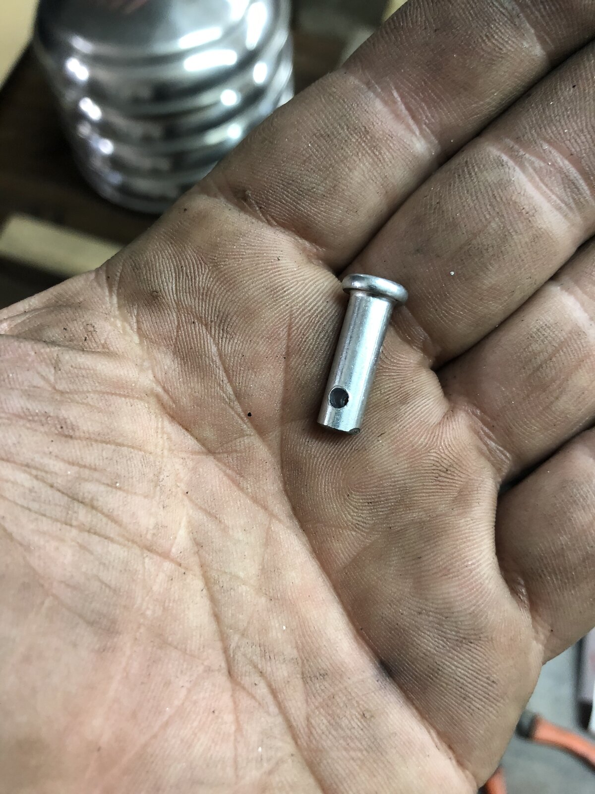

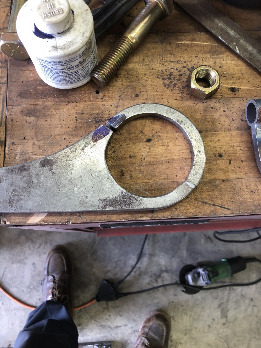

    Got the clutch shaft sorted out. I needed to have some way to hook the clutch spring to the adapter, since the original way was on the front bearing retainer of the original trans. Luckily I was able to drill a 1/4 inch ole in the top of the speedway adapter, and use a 1/4 inch retainer pin from tractor supply. This lets me use the holes drilled in the pin for different spring clip locations and cut it to length. Unfortunately I cut it in the wrong spot so I’ll have to get a new one in the morning. But this worked perfect. 7B54F2A2-FC4B-4B72-AD52-70353CF98CF3.jpeg B5B47E34-7AF2-46AE-961D-EC51EA5F4798.jpeg 6D869BF1-6D80-490B-8E28-607BBC2ED27F.jpeg

    Clever idea. That ought to hold up real well.

    When I used one of those transmission adapters, I used a hole saw and cut an "inspection hole" in the top of it and used a stock cover for it. Came in handy for lining up the transmission to the clutch disc when putting it all together.
