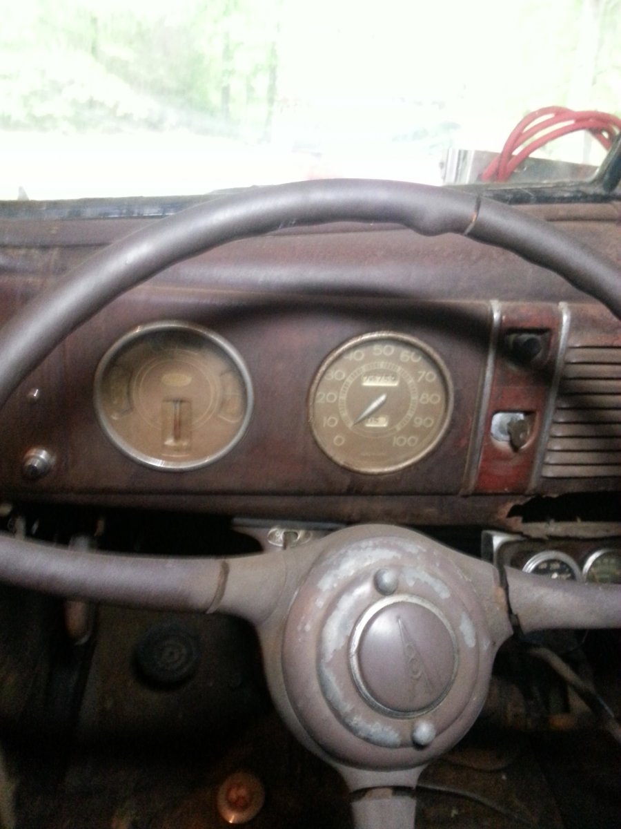

    I'll be lookin forward to yours as well. Better get your head around it's "stepchild" status. It caught me unaware on many fronts. Anything I can help you out with just sing out, I'll do the best I can. How's the dash panel and gauges? I can maybe do a paper trace of the door panels and send em to ya (mine are done). I'll PM you a list of sources later this week like for the headliner and some of the weather strip supply. Got a lot from Drake in that regard. Good luck with it, should be a lot of fun.

    Thanks man id aprieciate it! The das is pretty good other than some nimrod cutting a hole for a radio in it. the guages are all good except for the temp guage that some one cut off the capilary tubing to it. 20160509_190140.jpg 20160509_190146.jpg 20160509_190150.jpg 20160509_190205.jpg
