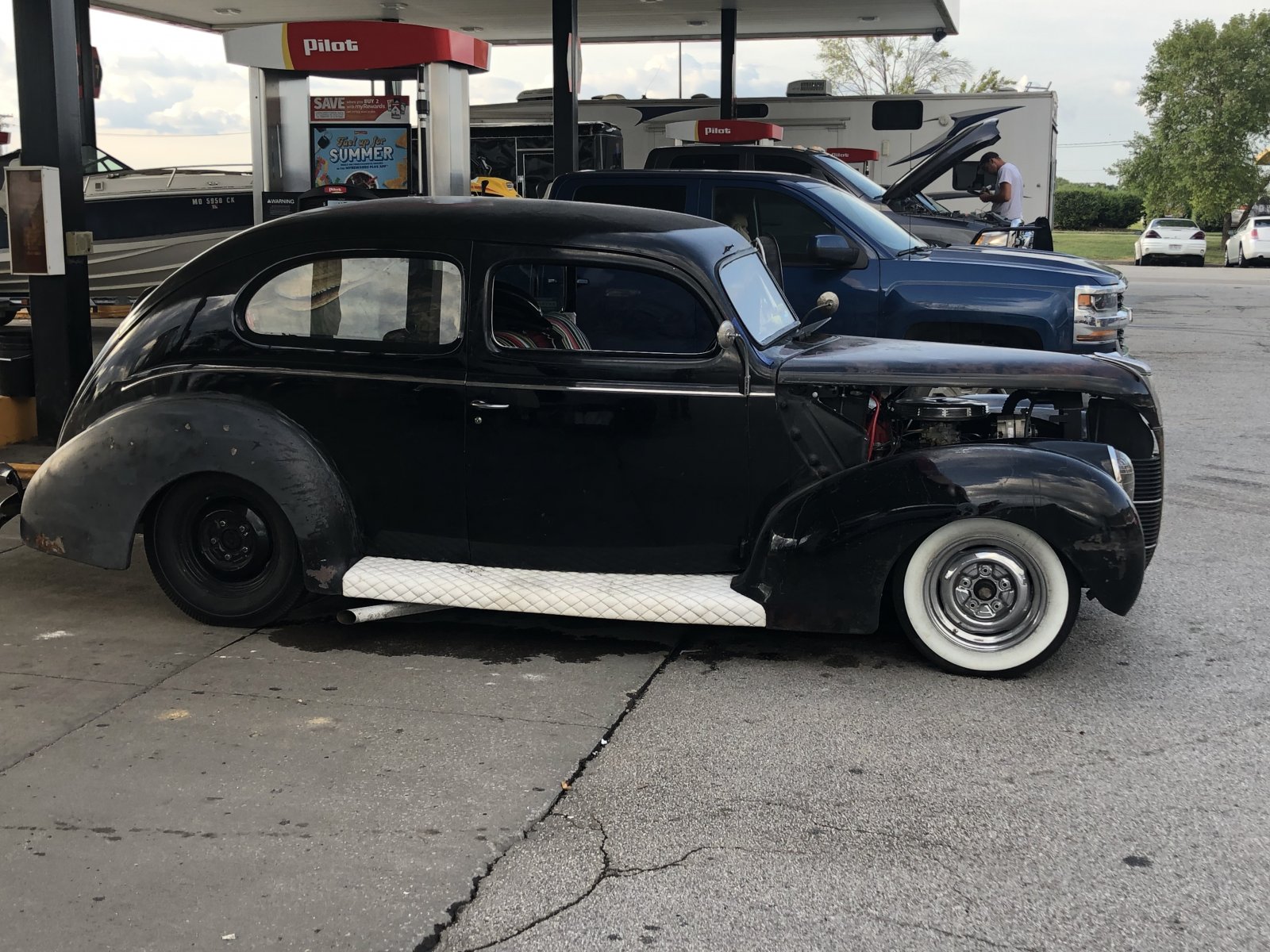

    On the way home the rear spring, a posies spring, had had enough. I had just way overloaded the car with ****. Look like the dam Clampets coming down the road. And the spring started going flat. Also before we left I still had the problem of the rear tires that were shot when we left now had cord hanging out of them. Luckily for me, when my bro Dels car got a flat at the sign when we arrived it was on tires that were 5 days old from Coker. The tire was delaminating on the inside and punching the tube making it go flat. So after he calmed down, and talked to Coker, they overnighted him two 6.0 16 firestones to replace the 5.60 16s he had on the way out. They were out of 5.60s. But we took the tubes out of the tires and since the wheels were powder coated just put valve stems in them and ran it. And no more problems. That left the 6.0s from Coker for me to through on the back of my car for the ride home. This made rpm’s go up a bit but hell we did 3200 all the way here, might as well do 4000 all the way home. The Goodyear guys took care of mounting the tires for me on the salt. 8247A904-E1A4-48D0-B1AD-9719B62756F6.jpeg D6B9B6F4-C0C5-4315-9AAD-BF42932EFECE.jpeg 03C81886-1C31-43D1-BF9B-45316E9107FE.jpeg
  6. Nailhead Jason
    Joined: Sep 18, 2012
    Posts: 4,515
    Nailhead Jason
    Here you can see the combo of spring flattening and going from a 7.50 to 6.0 on the rear in how low rider it became. Also keeping painters tape in a early ford with a tilt out windshield will really help seal it up good when you in a down pour. We hit a giant pot hole in St. Louis that was violent enough to break the aluminum gear in the windshield regulator, and rip all the hangars off the drivers side of the exhaust.

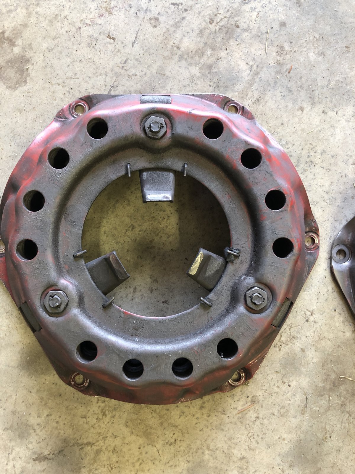

    On Day three of the return home we got back to Bens shop. Said or goodbyes and gave our hugs and put the car back on the trailer to get home. I towed it to Bens specifically so if there was an issue, I could at least get it home on a trailer from there. Glad I did, this thing was s****ing ever where and the shifting issues were coming back. But we got it home and back into the shop to get fixed before Trog.

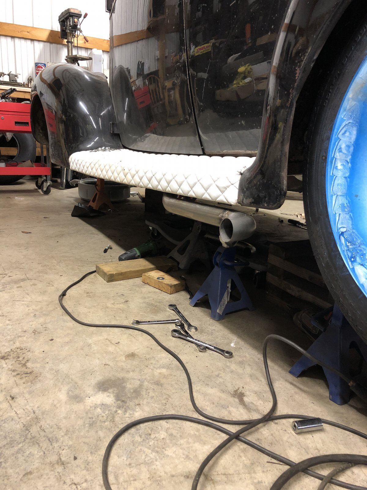

    After 2 weeks gone for Bonneville, had to go back to work, then took the family to the beach for the yearly beach trip. Now Old North State and TROG are coming up quick and I gotta get this thing fixed quick. So. Get it up in stands and the trans comes back out. Put in a new clutch disc with ceramic pucks, Throwout bearing, throwout hub and pressure plate from Wilcap. Fixed the hosed up threads for the trans mount all back together and shifts and drives like new again. For the spring. I took it out of the car and completely apart and added a few more inches of arch the the leaves then put it back together. Just to be extra safe, I put Air shocks for a 63 to 80 corvette on the *** end to hold it up just in case. In the pics below of the pressure plate that is not clutch material. That is metal from the hub sawing in half. The red pressure plate is the old one and the bare steel is the new one. This three speed is almost a direct swap for the mustang T5 so yeah that’s happening in the future. While it was up on the stands I put a Pete and Jakes front sway bar and the front bumper on it. B70CF6E6-4C6A-4BA8-BBD3-F7C2730AB94E.jpeg 506B7816-84FE-4D2F-83C8-883027A5A7CF.jpeg B640BA28-381A-4ACD-B885-E3C6DB3C2273.jpeg B7FE9625-C553-4CA5-B257-3696A6BEA1FB.jpeg 65CA85D6-2AE2-42EB-8817-B465B689865B.jpeg 43A3AD3A-E980-4014-830A-F4838F78C90C.jpeg

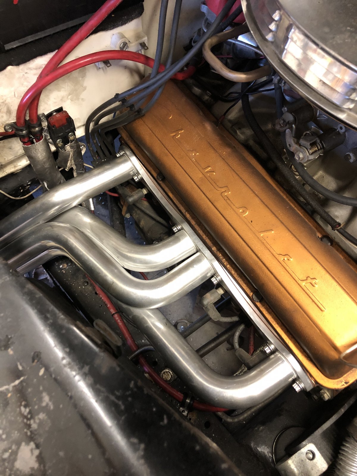

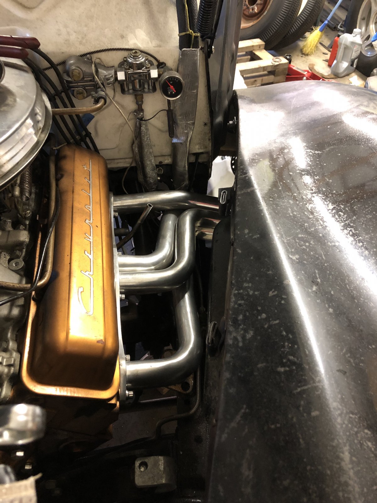

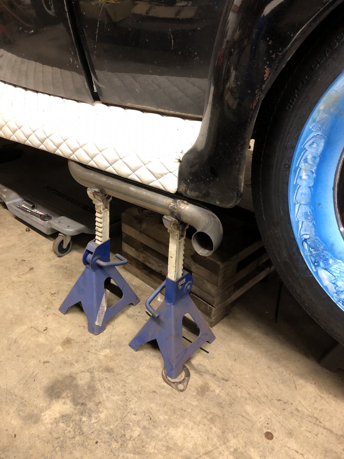

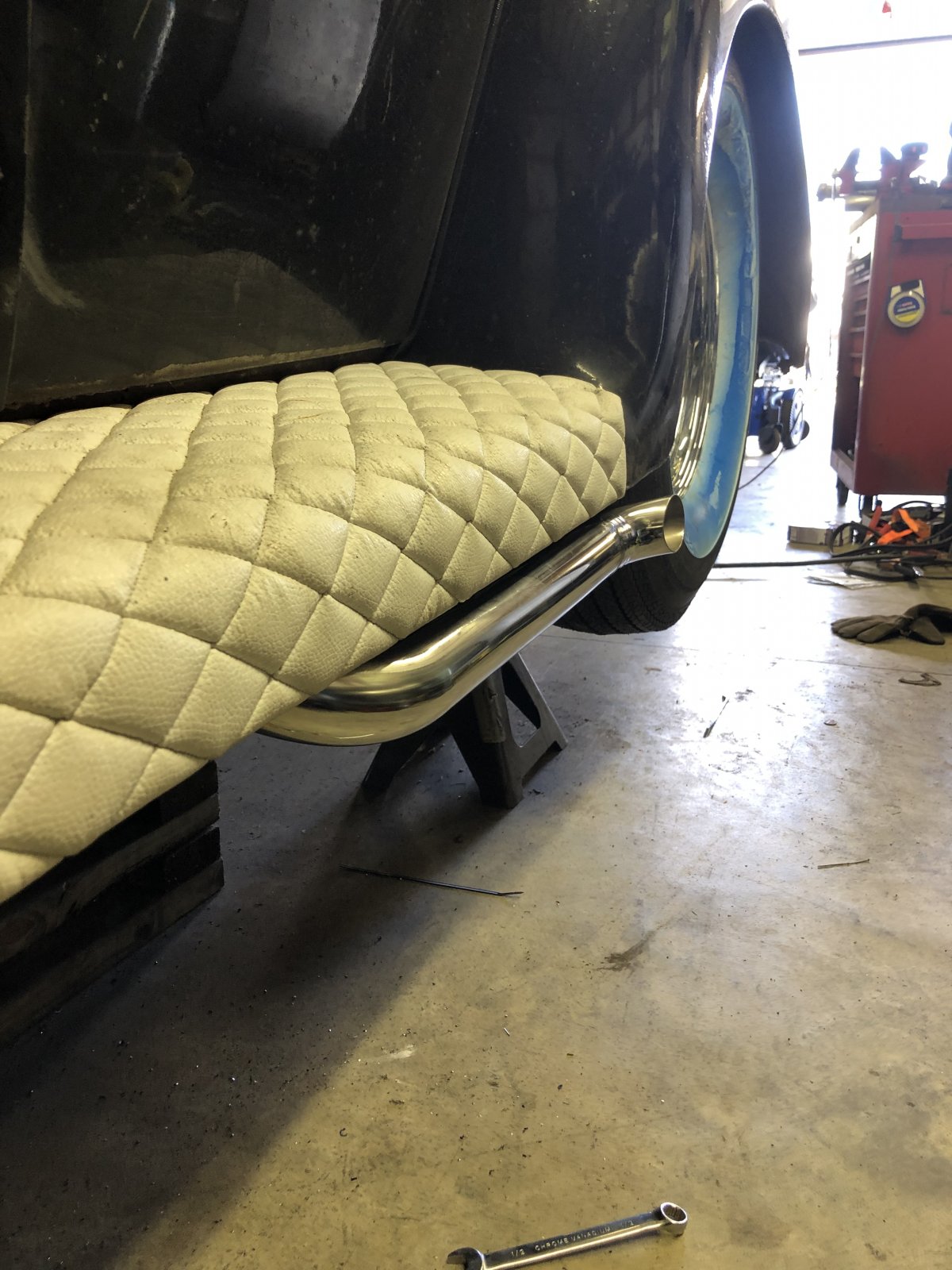

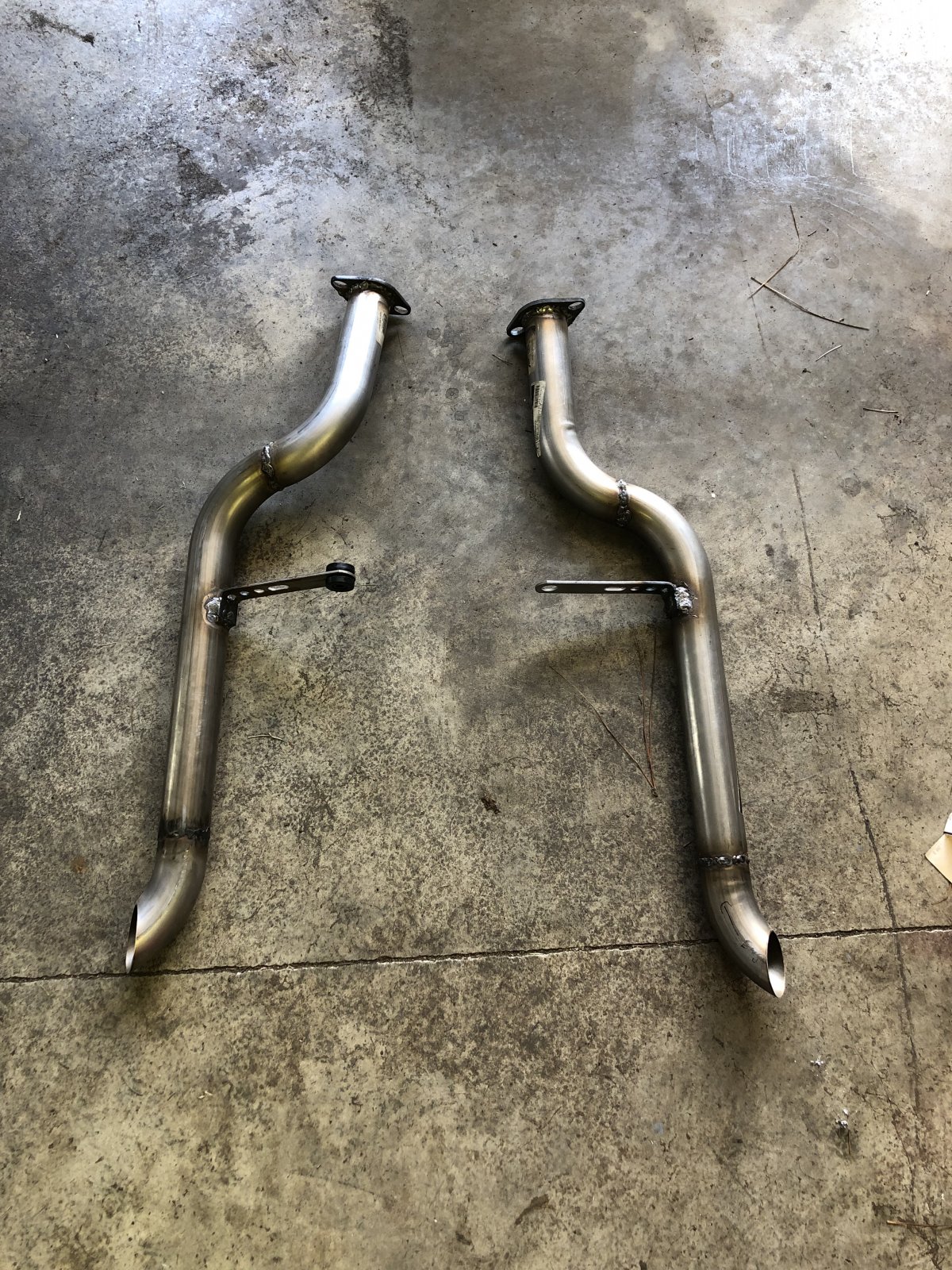

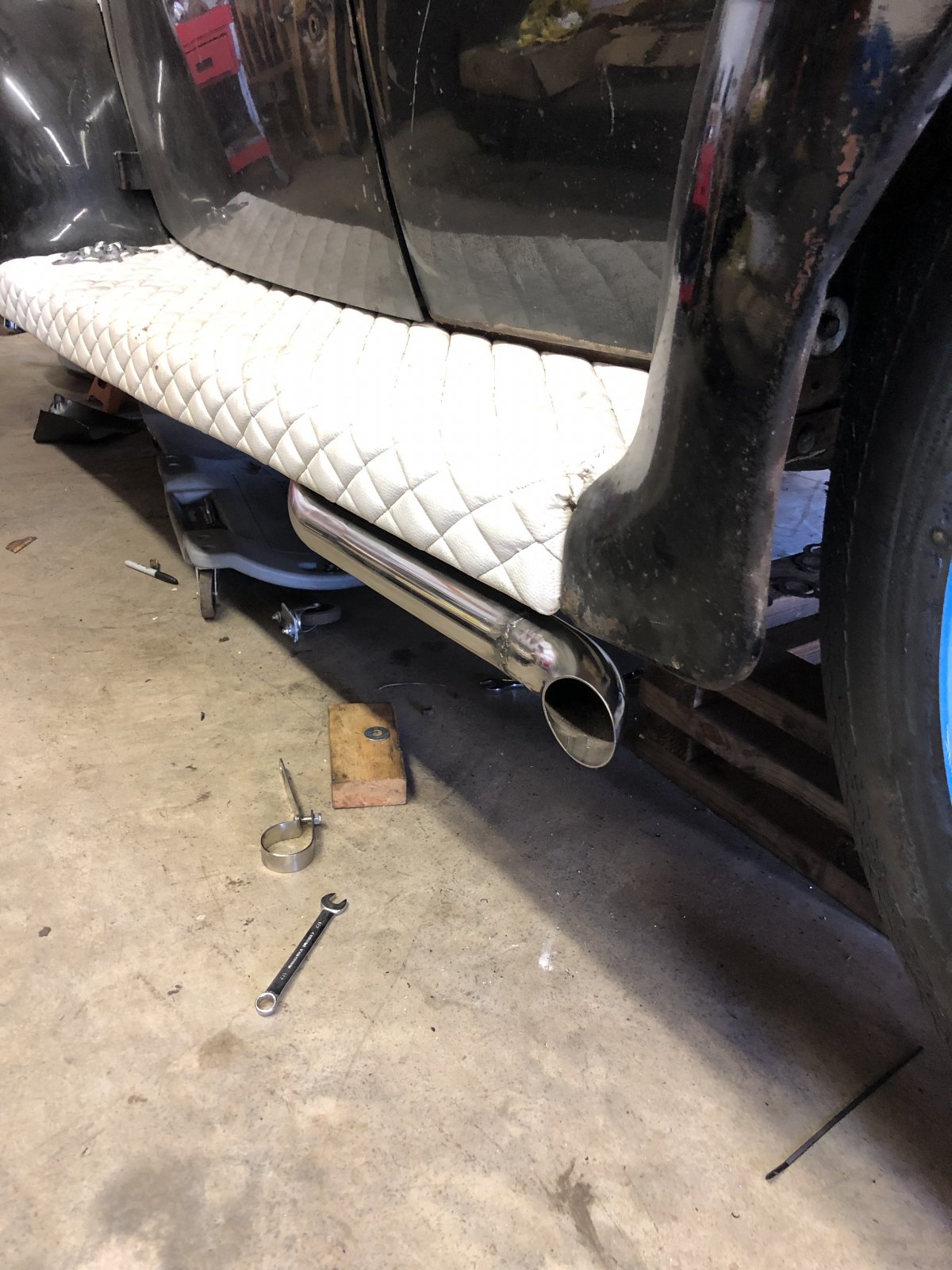

    The last major thing to tackle was the exhaust. When I started on this car I bought fender dump headers, then I decided I wanted 55 manifolds, so I used those and help onto the headers. But what I always want was a set of the killer ribbed kickstand lake pipes. 4D9AF3D8-E39E-4A4E-B94B-E441D48047DC.jpeg
  10. Nailhead Jason
    Posts: 4,515
    Nailhead Jason
    Those being hens teeth, and with half the exhaust needing major repair, screw it, let’s start all over from the heads back. So off the manifolds came and on the headers went. Once in I was able to use some 2 inch stainless J bends from speedway to make my own version of the kickstands. Never welded stainless before so I bought a spool of stainless wire and had at it. I think they turned out great. I used the lake pipe hangar to cover the weld seam at the turn out. No mufflers this time. Headers and 2 inch straight pipes. I love how it sounds now. Once the kickstands were made I polished the stainless up on the buffer to above shine. B14B01DF-1B4D-41D2-B8E3-C38D4B55BE2E.jpeg FA2C76E8-1B86-423B-8052-F6C38A3A524B.jpeg BA615DE9-2629-4B13-911C-3BC430FE934B.jpeg 997C9D31-AA21-421F-96AE-63A3058FC9A1.jpeg 64E91E33-84DF-46D9-AE34-97FD5EBF8B45.jpeg 4CFBAB2E-79EF-40F7-8D00-A6DE8C81155D.jpeg 74EE2BE0-AE63-44B7-BA81-A37EA4E690C6.jpeg 0168DBF9-BFFB-4325-A0F0-2B16BE354215.jpeg 37D9F269-4851-438E-B73F-8FF9349261F6.jpeg

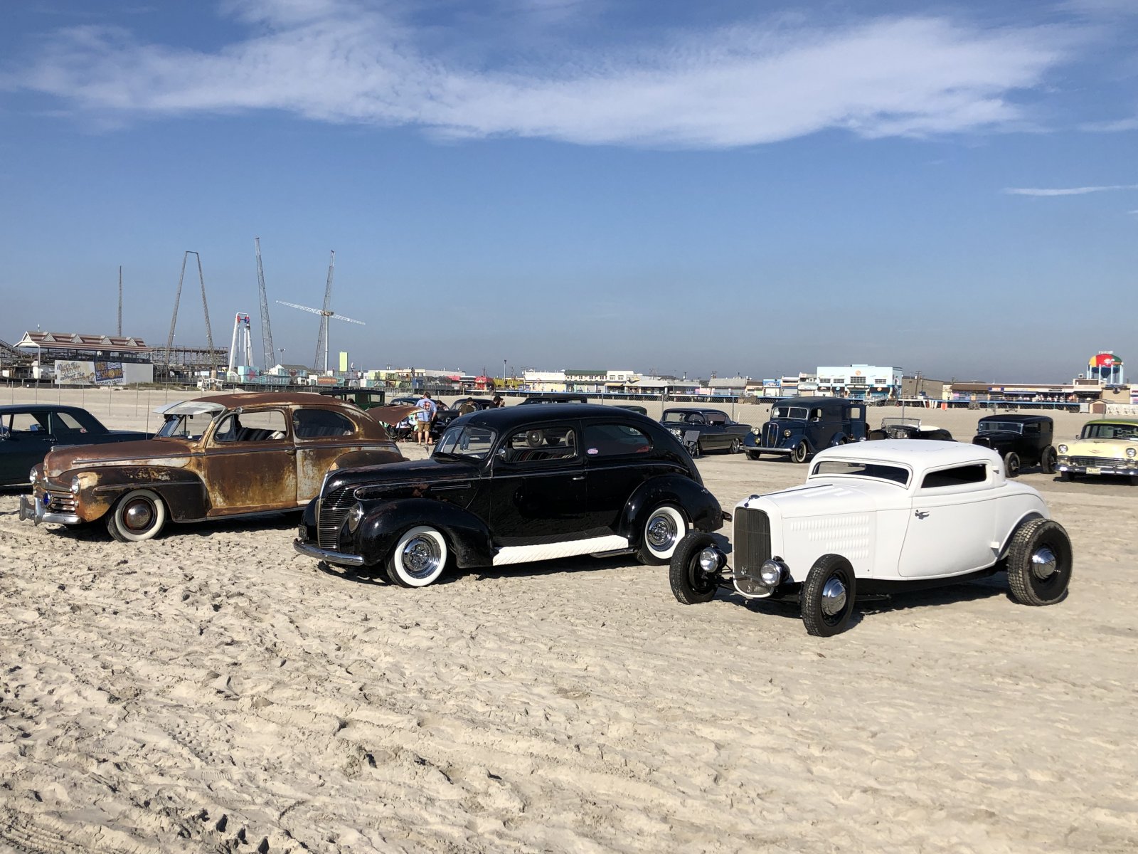

    We were not able to make it to Old North State due to some family things that kept us home. But we did make it to TROG the next week and got to be one of the 100 cars selected to be on the beach. TROG is always one of my favorite events. This one was now exception. That’s my buddy Doug’s knuckle the 804 bike. EC16F3F2-B410-4DBB-B37D-785B6D41F6FD.jpeg 581E11A6-4F47-48A4-B87F-A86EE6FA09B6.jpeg 19A8558E-A05B-4456-8FA2-B2400C39AB66.jpeg 5924917B-9F58-467D-BB0A-D61485BED69F.jpeg A3B449EB-9142-4E78-A0EE-608F07A43E5D.jpeg D4367E4E-DDC8-463C-8047-2F67DF10EC7F.jpeg 3E2FBB96-AE0B-45AA-A8D4-C57134D71654.jpeg A8EDE12B-8073-44CB-BAB9-880593BAC440.jpeg

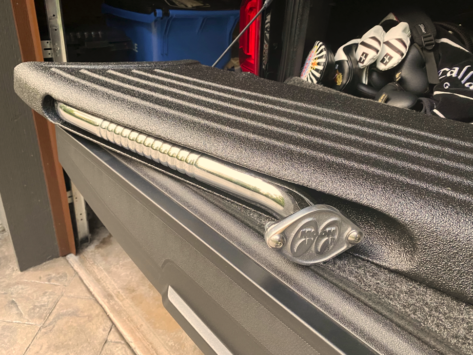

    Kickstands for the win. I do happen to have a set of kickstands but I don’t think I want to let them go….. the ones you made look awesome!

  18. Nailhead Jason
    Posts: 4,515
    Nailhead Jason
    In my best OB Wan Kanobe…. Those are not the kick stands you want, you will let me have them….

    Those kick stand pipes turned out slick! I got lucky on a pair and frenched them into my PU running boards so I wouldn't drag over speed bumps. Your car looks great with those running board covers.

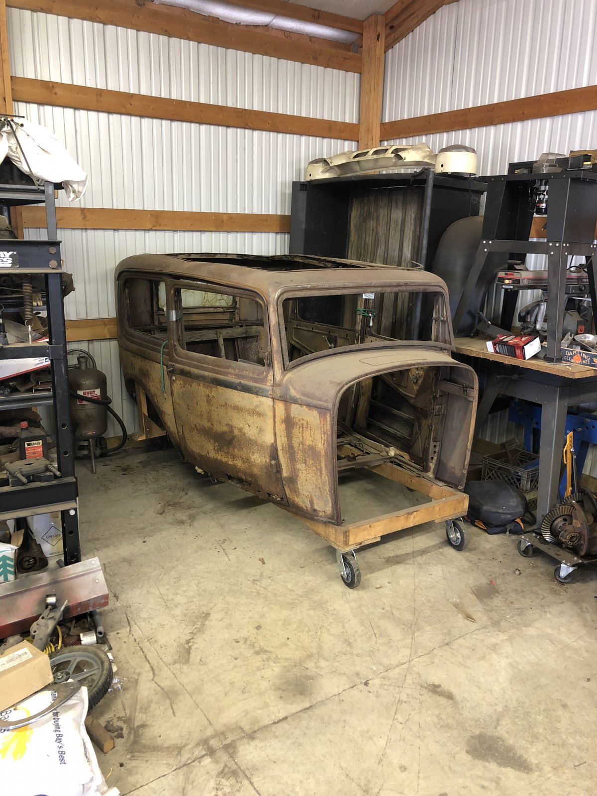

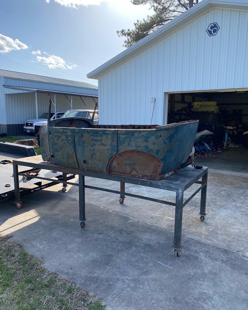

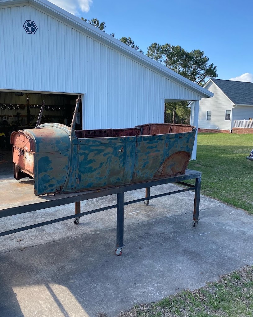

    Before Dad left us, we had talked out the next build to just about the finest detail. pretty thankful for that. so my direction is already set for how to build this one. Like everything else we like, like its 1962.
    I mad a deal with my club brother Dustin on his 29 Phaeton that he had in storage. So i sold my 31 sedan body that i had been saving since i was 20 years old to build and bought the Phaeton back in Dec. We were finally able to get down to NC to pick u the body this last weekend and get it figured out what we need to do to get the body back in shape and on to my 32 ch***is with 259 Stude power. And picked up a sweet new steel fab Table from my bro @hotrodderhaag Anyway here it is. I will be starting a new thread to cover the phaeton build when i get a little further along, so in a month or so.
