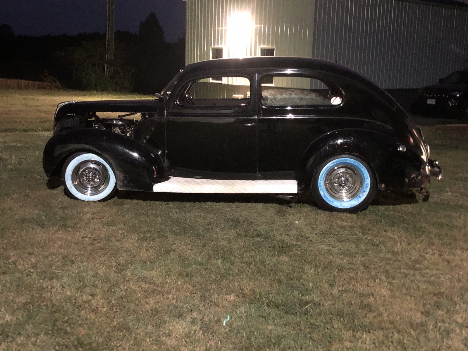

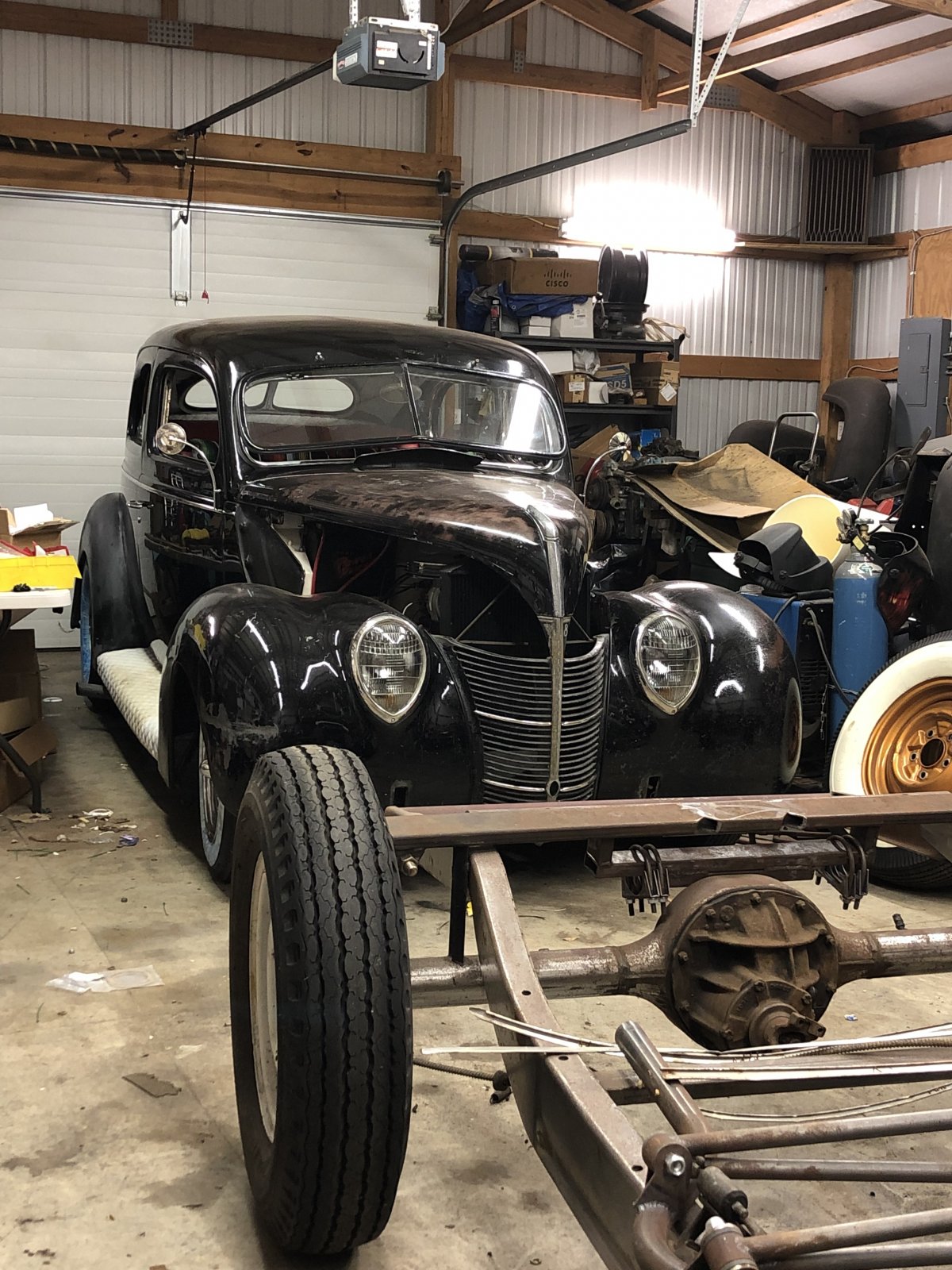

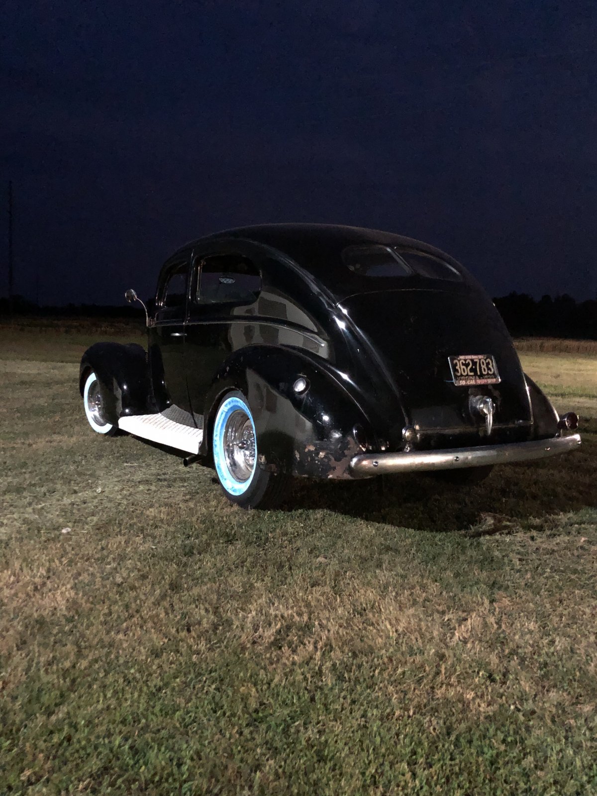

  1. Good looking car Jason!! Stance and rake right on time! What size rims and tires on the front? Any problems with tire rub on the fenders? I'm getting ready to drop my 39, so I want to make sure I do all the right things!
  2. Nailhead Jason
    Joined: Sep 18, 2012
    Posts: 4,515
    Nailhead Jason
    Thanks Man!
    NO tire rub whatsoever. the set up on mine is a dropped and narrowed 33 to 36 front axle using a 36 front wishbone with a Posie's reversed eye front spring. The front axle was dropped by Jack Fuller in Norfolk, it has a total of about 4 3/4 inches of dropped and narrowed in the drop process about an inch on each side, thats how you get the extra fender clearance. I used the earlier 33 to 36 axle and 36 wishbone to be able to get more drop out of the axle than i would have with a 37 to 39 axle. and still be able to bolt it all in without splitting the wishbone. The front wheels are new from Wheel Smith 15X5's with 5.60 X 15 bias Plys and the rear are the same wheels with L78 Coker white walls. The rear spring is a Posie's Reversed eye spring mounted to a 9 Inch on spring brackets that drop it 2 inches. You can get the same stance buy using a Posies #R40L rear spring and 41 shackles to get the same drop, that what was on here before i swapped the banjo out.
    If you in Fred, im only about 30 min from you, my shop is in Caroline and i live in Ashland. Send me a PM and ill get you my Cell number if you want to come see it in person or just want to head to the Shop!
  3. My car is a 39 Deluxe Coupe. I have a 33-36 front axle and wishbone down at Jack Fuller's now that he's dropping for me. On the front I hope to use a Posie's reversed eye front spring and stock 40 Ford rims - 4"x16" with 550R16 tires. I hope I can pull it off without any tire rub? I also plan to use the Posies #R40L rear spring on the stock banjo in the rear, with 40 Ford rims - 4"x16" with 700R16 tires. Would definitely like to get with you sometime soon. Thanks Jason, Greatly Appreciated!!

    with an axle from Jack and those front tires you will be in the clear! I also have the reverse eye Posies front spring and it rides great. While you are doing the front end, I would highly recommend a front sway bar kit from Pete and Jakes. it really is the single best improvement on my sedan's suspension, a night and day difference in handling. Just make sure and get one for a 35 36 since that is the wishbone you are using.
