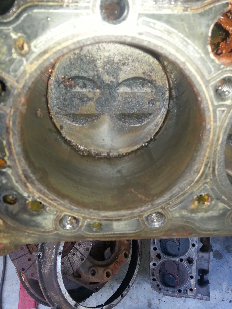

    Got the head off that had the stuck valve and it don't look good. Looks like an overbore is gonna happen. 20160917_170449.jpg 20160917_170507.jpg 20160917_170529.jpg

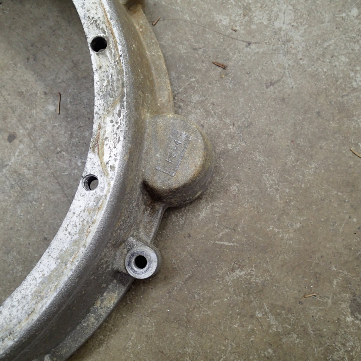

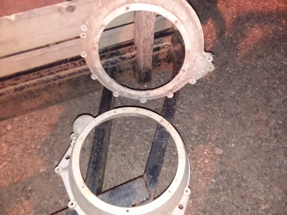

    Jason I think I have the same adapter "in inventory". I bought a box of misc. parts years ago at a swap meet and these were in the bottom of the box. I looked in an old Honest Charley catalog I have (circa 1961) and found the adapter. The other piece is a GM Powerglide adapter.
  3. Nailhead Jason
    Joined: Sep 18, 2012
    Posts: 4,515
    Nailhead Jason
    That looks like the one I have. I ran the part numbers on the castiron piece and it says 56 to 61 vette powerglide adapter. But im missing the sheetmetal portion.

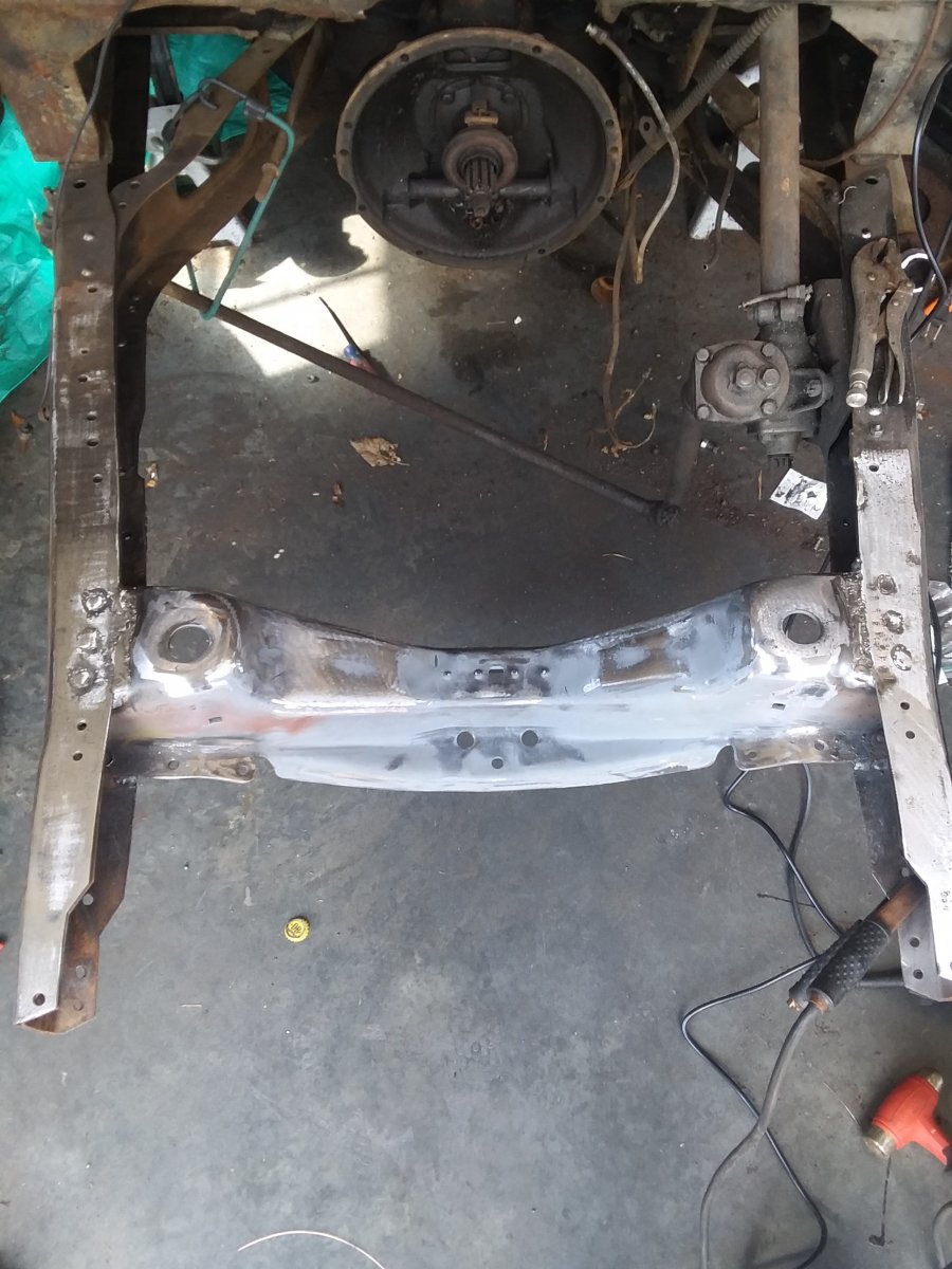

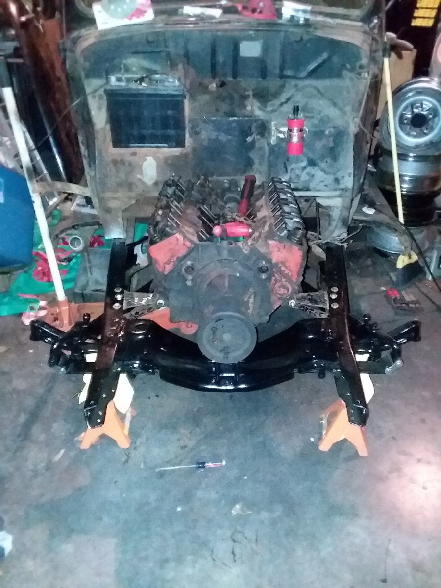

    Been a while since i updated tbis but finally have some good progess on it. Got the old butchered cross member out and the new one welded in and painted. Hopefully I'll have the front end back together tomorrow and bolted in. 20170219_124158.jpg 20170225_210427.jpg

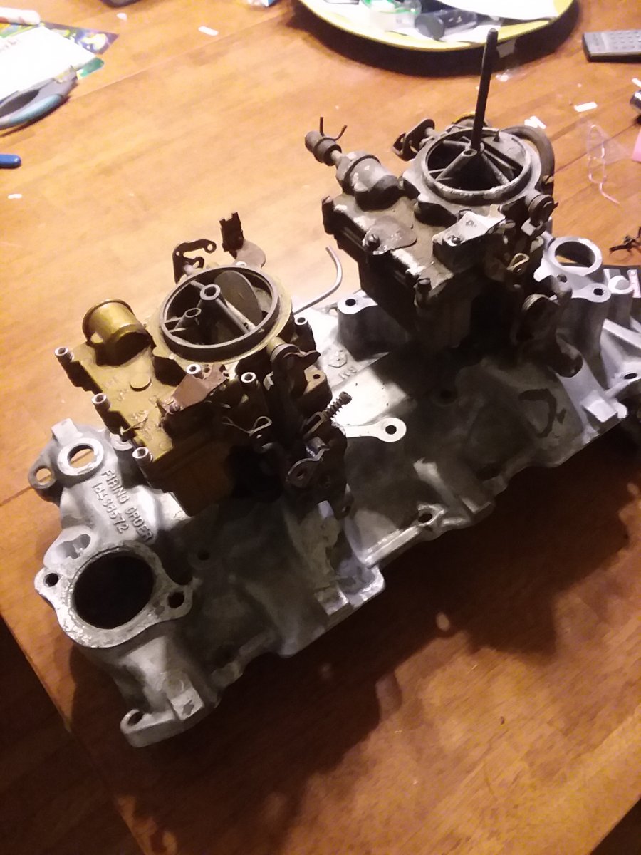

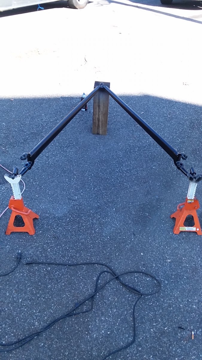

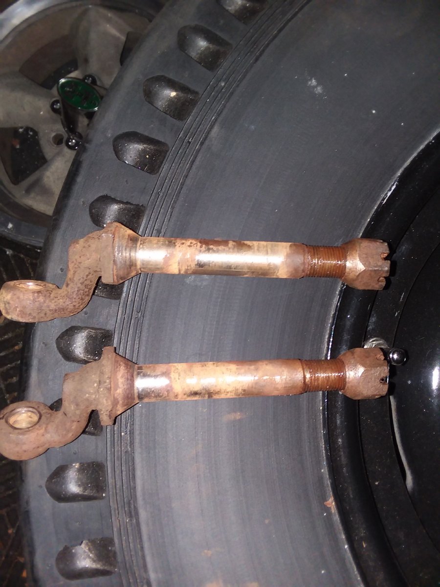

    I ripped the front end part last week for new king pins in the spindles and clean and repainting. I couldn't believe that I could pull the perch bolts out by hand. They just twisted right out!! Spindles were a bit tougher but not to hateful. The wish bone is the nicest I have ever had. Almost no surface rust, just road grime. My pal D-Russ here on the HAMB was nice enough to reverse the main leaf for the front spring for me to help get it down a little more. 20170225_211445.jpg 20170226_150923.jpg

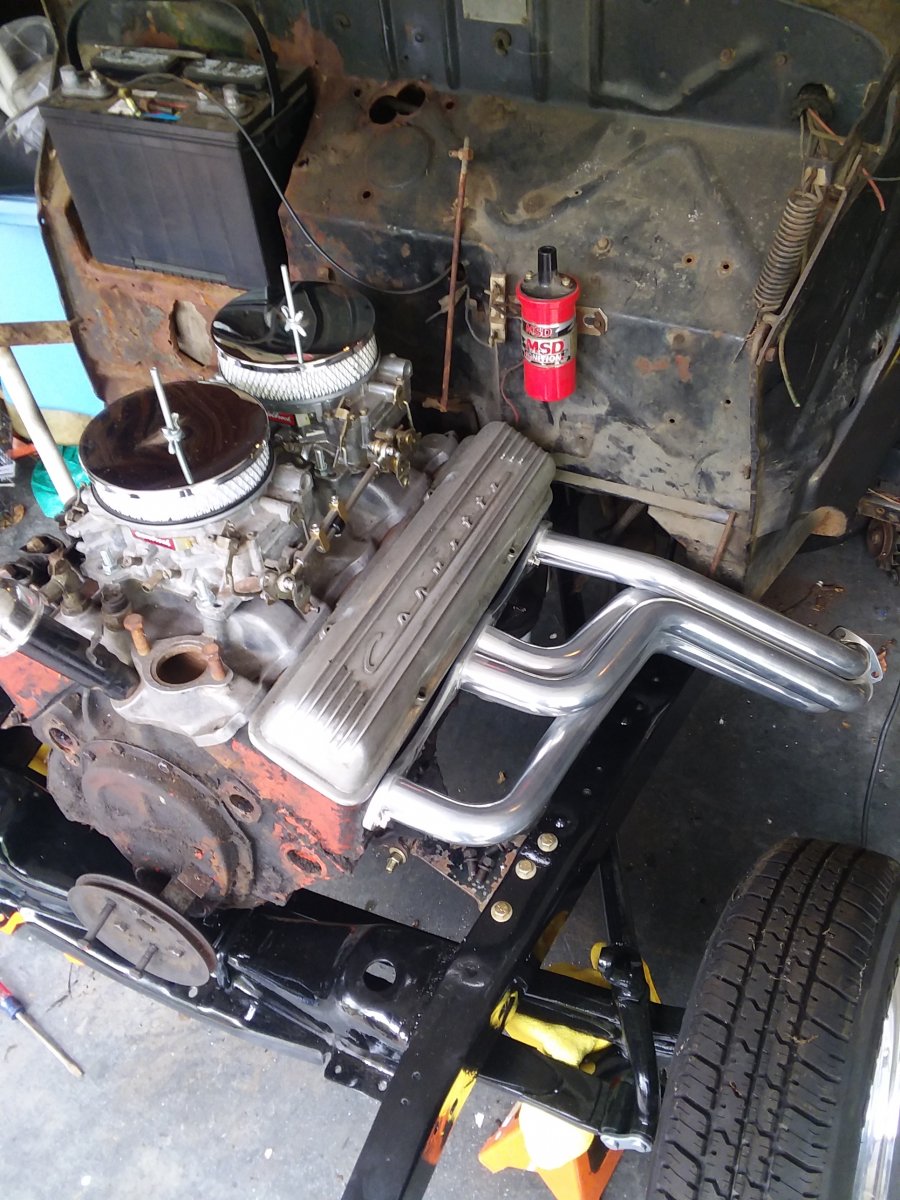

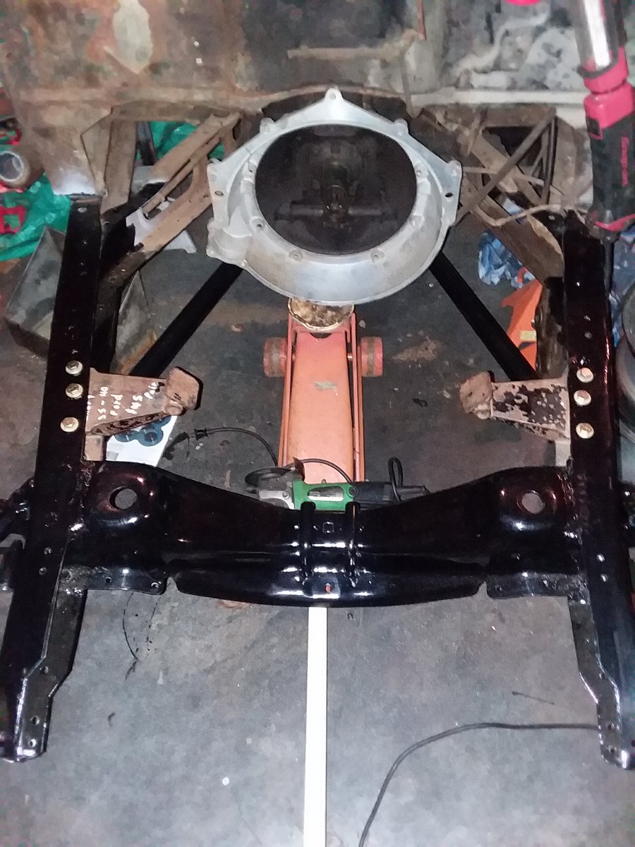

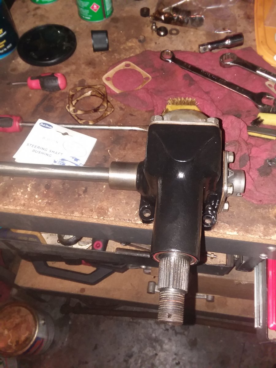

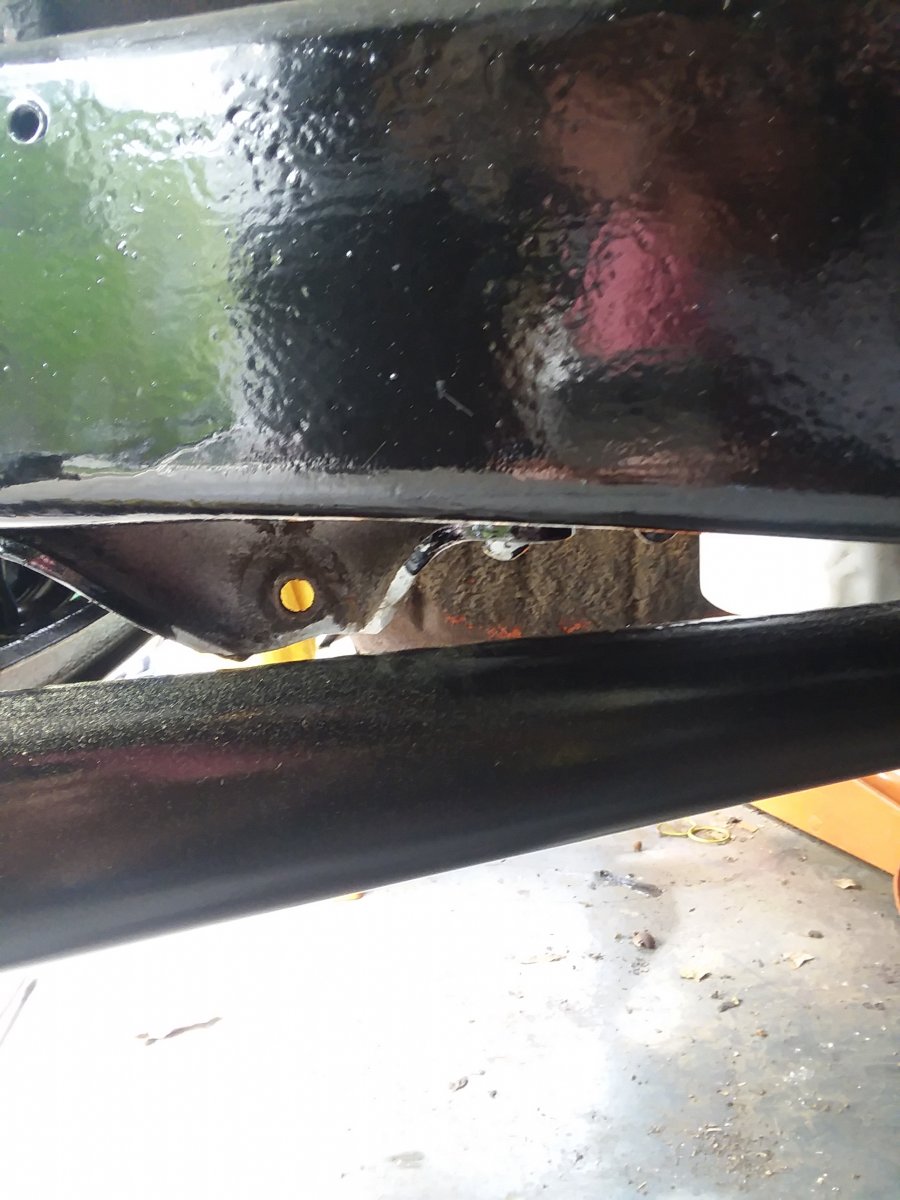

    Here are some updates on the 39. Making some decent progress. Front end is all rebuilt and installed, though I need tho add a leaf back to the front spring I think. It's mighty close to the steering box mount. Got the steering box all rebuilt and ready to go in. I had a set of TCI bolt in motor mounts but they don't jive well with the stock trans in it so I will be using an old Hurst front mount I forgot I had. Also swapped out the two piece trans adapter for a NOS old wilcap adapter. The motor in it is just for mock up. Once all the mock up is done I have a 283 to rebuild with an 097 cam so it out to sound pretty good. Looking at having it move under it's own power by the end of June. 20170423_130213.jpg

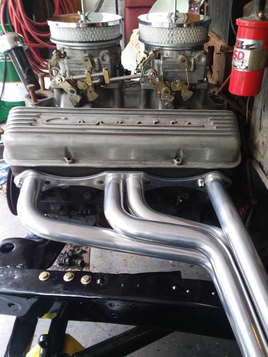

    Nice. So on mine i found that they had to cut the front p***enger motor mount biscuit ALOT (nearly in half) to get the fuel pump to clear. Maybe check yours. I have a pic of how mine is cut to clear. I have the same hurst mount. I think i may go to a different pump. I dont like how much has to be cut.
    What kind of headers are those you have mocked up? They look good.

    @Black Clover Custom yeah its the same deal with mine. The way the Hurst mount (or any front plate mount on a small Chevy) it puts the pump so close there is no clearance. Plus on a 35 - 40 frame, and I believe 41 to 48, the front cross member is in the way and needs to be notched for the pump. I may go to an electric pump. even though I really don't want to.

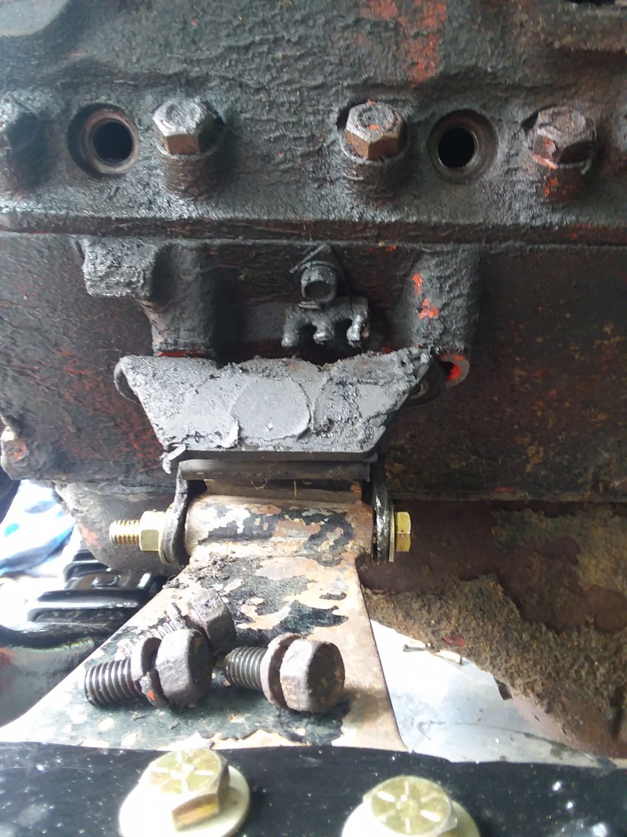

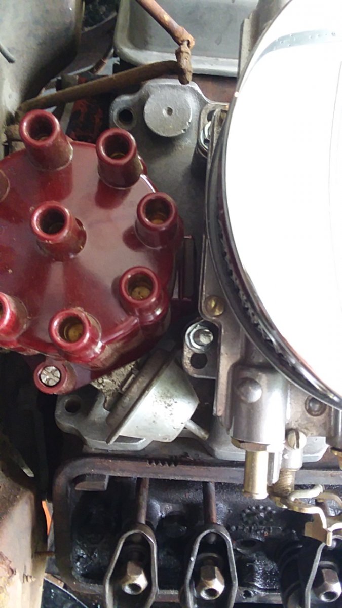

    So now I need to swap out the mock up motor to be able to mount the Hurst plate on the front of the block. Reason being, is that on the p*** side of the block the holes for the mount are not drilled or tapped. the bosses are there just not drilled. I have never seen a small block that wasn't drilled there before so I never bothered to look. the casting numbers on the block say it is a 64 to 67 283. Was this common on these? anybody else encountered this. I have a stok pile of small block stuff so another block isn't an issue for mock up. Just never see the holes not drilled before, and this is the on that was closest to the car...

    Never paid too much attention to those holes not being there. They were there on a '62 327 I had, but it was bought from GM as a replacement short block. Using side mounts on the '73 350 block in my roadster now, and I'll try to remember when I'm at shop later today to check for the holes on it.
    Years ago I used a Hurst mount on a '53 Studebaker with that 327 I mentioned above, and a '65 Chev 283 in a '34 Ford with another Hurst mount, and neither required an elecric fuel pump.
    The Brookville provided, P&J built repro '32 frame under my '31 "A" roadster is pinched in the front and the frame rail was too close to engine to use a hi-po Holley mech. pump and I had little choice but to use a Carter electric.
