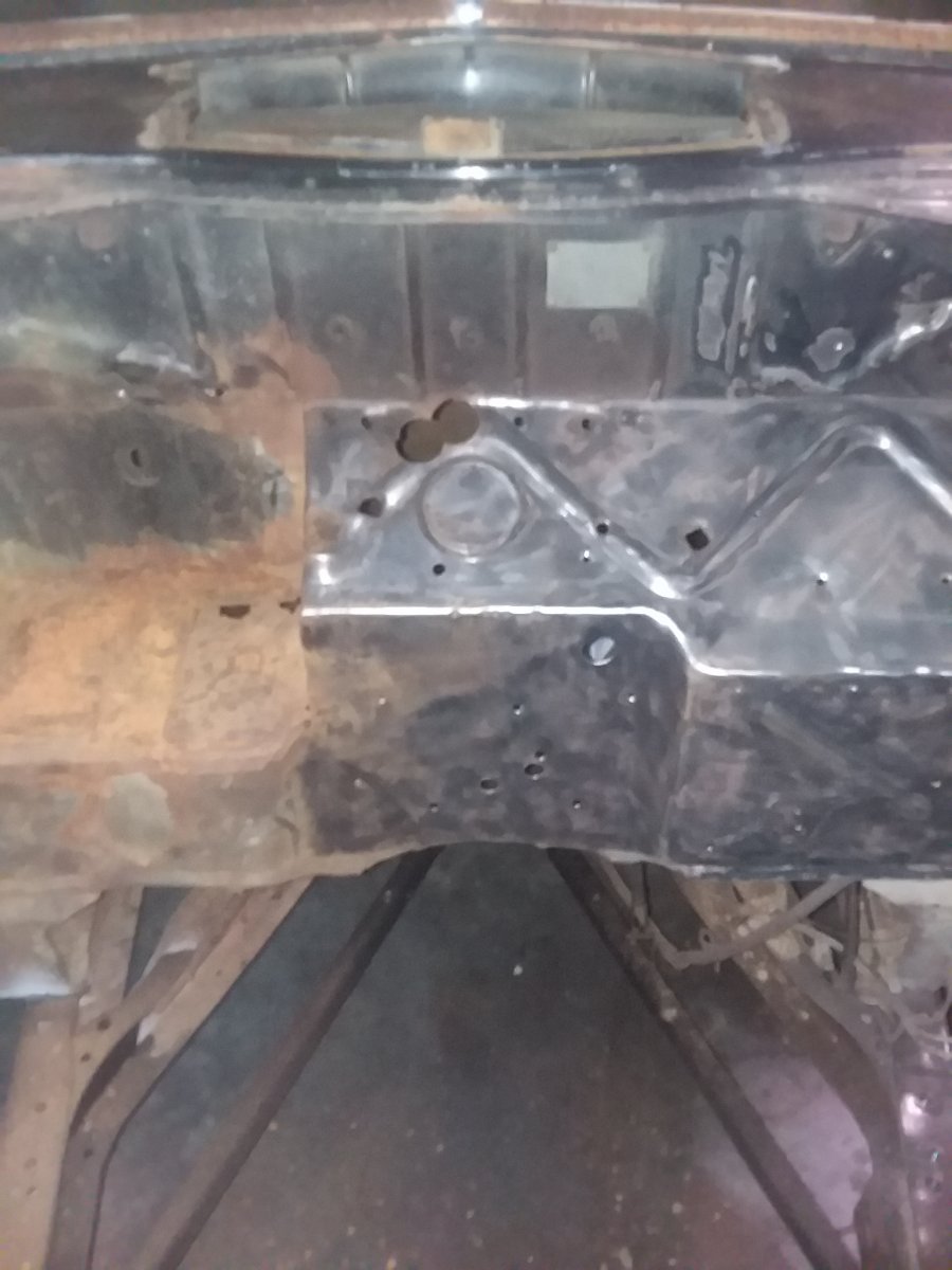

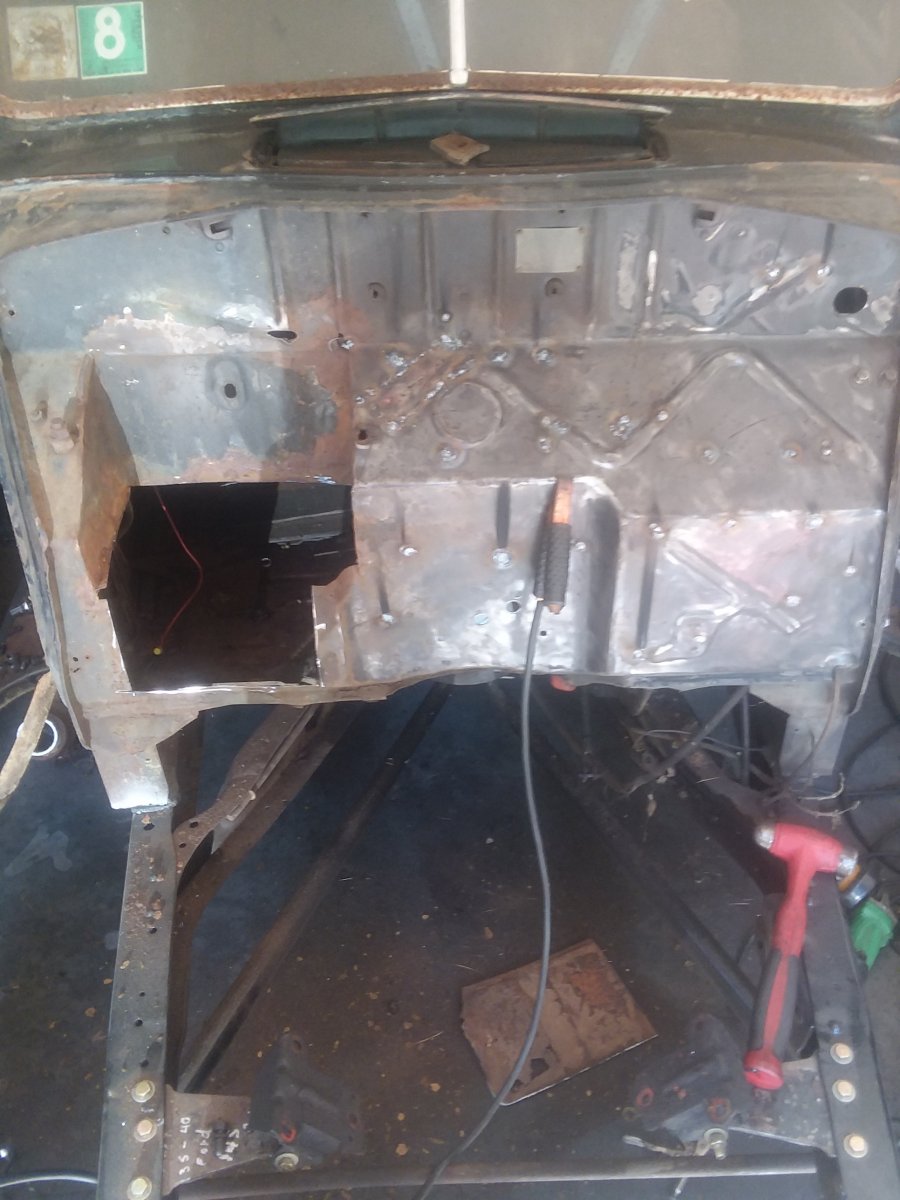

    Nailhead Jason

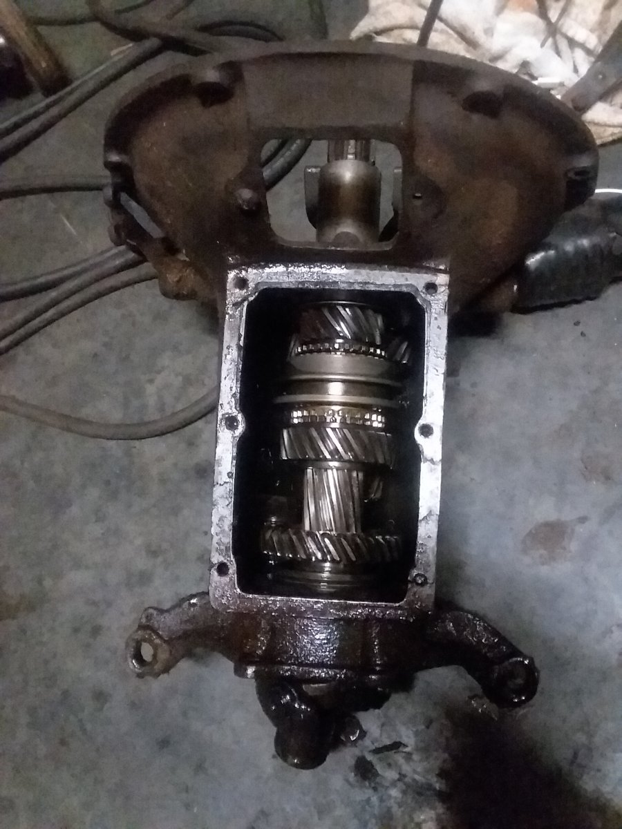

    Major progress made. Front end is all finished and rebuilt. Just finished up the fire wall repair, and got it in primer last night. The new 283 is coming together and I should have it all bolted together this week. Trans rebuild is planned for this weekend. I will have some pictures up this evening when I get home. Cant seem to get them to upload at work.
    lothiandon1940 likes this.

    Looks great Jason. Are you using the '39 transmission?

    @sidevalve8ba Yes i'm using the 39 trans on an NOS Wilcap adapter and the banjo rear. The car is in remarkable shape save for the scratched and chipped up paint. Everything I take off of it for the mostpart just needs cleaned lubed and reinstalled. The inside of the trans looks as good as you could hope for, NO moisture in it, everything all oily, no rust, and all the gears are tight in the case. The only thing I have found wrong with it so far is the sliding low reverse gear has on slightly chipped tooth. My pal Scott in NC has a new gear in the mail to me now. I have all the stuff to rebuild it and the banjo, so those will be done shortly and the drive train will be sorted.

    Sounds great. I went through a '40 transmission a few years ago and found a great supplier then. Just thought I'd keep in touch in case you needed anything for that build.

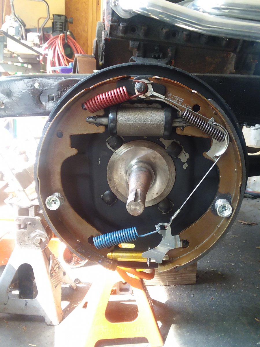

    So I am making some good headway and am shooting to have this driving by then end of Sept. Right now I have the gas tank out doing the toilet cleaner method. Front end is all rebuilt with F100 brakes. @***us hooked me up with some front tube shock mounts to finish it off. The 3 speed is out to be gone through and the 283 is nearly ready to be bolted together. Got a slick set of wide whites and some copper paint to coat the steelies and the motor. Fire wall is all patched up and almost ready for its coat of white paint. Finishing up firewall this week then the trans and motor and running the plumbing. Anyway here are some pics! 20170617_184740.jpg 20170618_103137.jpg 20170702_111803.jpg 20170708_163310.jpg 20170716_130104.jpg 20170716_103128.jpg

  13. Nailhead Jason
    Joined: Sep 18, 2012
    Posts: 4,515
    Nailhead Jason
    I'm going to try it with out. I replaced the front hub seals with a double lip grease seal that should keep all the grease in the hub. he only reason im not using the shields is that they will not clear with the adjuster hardware I used. I made these auto adjust by using 53 to 56 F100 backing plates and hubs, 65 F100 shoes, hardware and adjuster kits. Also if you need new drums for your F100 brakes, you can get a set of early Bronco rear drums and they are a perfect fit. I rebuilt all the front brakes on the 39 with parts from Rock Auto, with wheel cylinders and drums it cost about 75 bucks.
    If the hubs start slinging grease, then I will put the baffles in and swap the brake hardware out.
    Bam.inc, neilswheels and Tim like this.

    Black Clover Custom
    Nice job with the brakes man. I converted mine to original lincoln backing plates and brakes. But that whole f100 brake swap thing is killer. Hope the grease stays out for ya. Wish i had some auto adjusters!

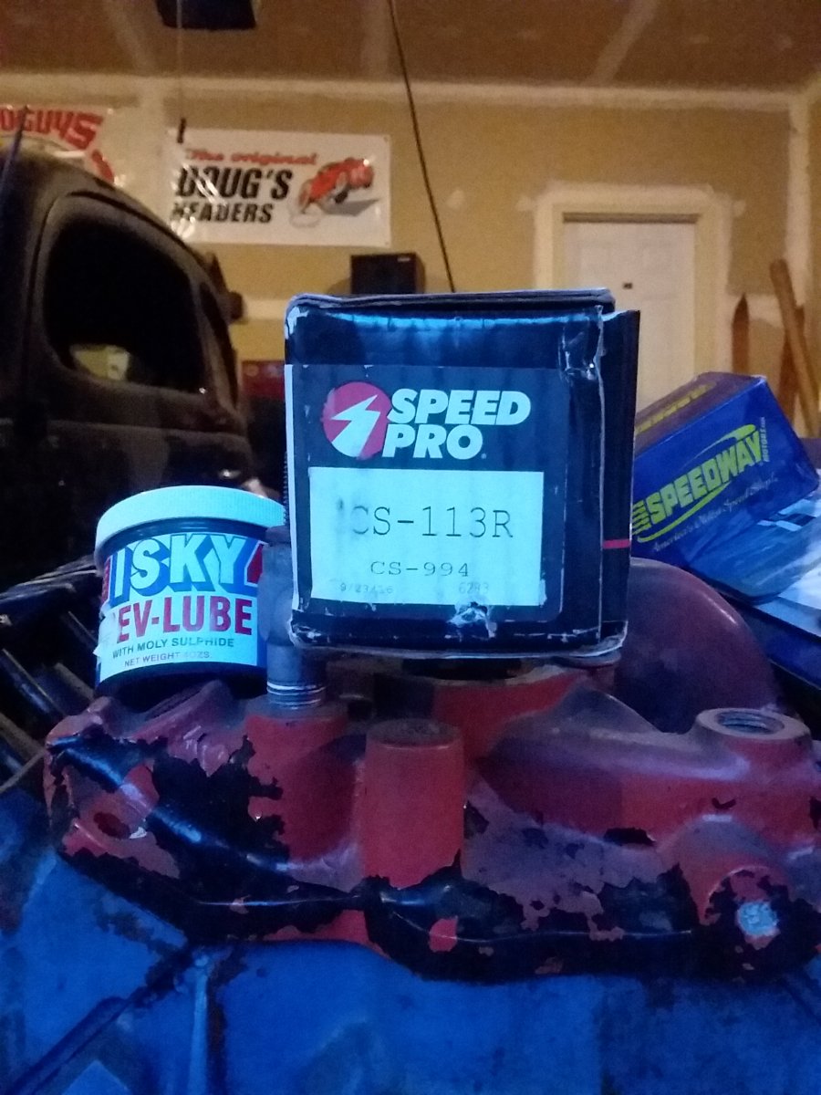

    I was hoping so, but a few of the cylinders were pretty rusty and need an overbore. I got another 283 that needed less done to it to freshen it up. Should sound pretty good. With the speed pro version of the 097 cam. 20170712_203853.jpg
  18. Can't win all of 'em I guess. I like the idea of a 283, its a nice change from what normally gets done these days. With the 097 it should d better then sound good. ;)

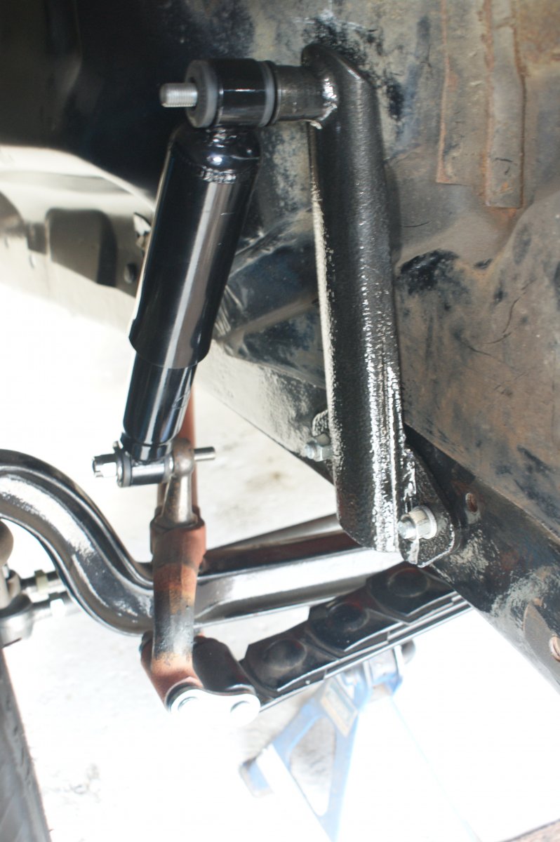

    I am using a set of old Western Auto Tube shock conversion brackets. They bolt on in the stock location for the lever shocks and use the attachment point from perch pin to connect the lever shock link for the lower tube shock mount. Really simple and worked for years. you can usually find a set on e-bay for around 40 to 60 bucks. I am running a Stock axle with a reversed eye stock spring. But this winter I will be swapping to a dropped 35 36 axle and 36 wishbone. The 36 wishbone will allow the use of the 36 axle or most aftermarket dropped axles, while still suing the stock width spring without splitting the wishbone, making the entire set up a bolt in deal. With the exception of heating and bending the steering arms to clear the axle. There really is no tire clearance issue whatsoever. the primary header tubes enter the wheel well area probably 10 inches behind the tire, they never even come close. I had though about building my own headers but these just work so well and the price an be beat. If your doing a small chevy swap and using the original trans I would recommend getting an early Mallory YC or YL distributor. They will give you about 1 1/2 inch clearance between distributor and firewall compared to about 1/2 to 3/4 inch with a stock 58 up chevy points distributor. I just picked up a YL dual point for 50 buck and put a pertroinx conversion in it since I cant find a decent points for less than 80 bucks a set.

    Like this? I've got issues getting the shock off, clearance on the drop isn't enough. Although this is a bit of a 'modified' affair. I think I need to go back to a bolt instead of a pin on the top mount, and am thinking of using 39 perch bolts to move the bottom mount over. I'm slowly getting a 348 and T5 in mine, but thanks for the info, its all good, and useful to anyone doing the same swap as you.

    My brackets are a little different but the application is exactly the same. yes the 37 to 39 perch bolts should give you the clearance you need, but id just swap it out for a bolt!

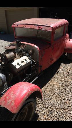

    Black Clover Custom
    Thought you may know someone who would want this car i just found on craigslist here in Eugene OR. ***le says 1930 Ford 5 window rat rod!!!! Hahaha. Check it out. Looks like the best ratrod i have seen in awhile. 00t0t_1ened68j2fr_600x450.jpg $8500.
