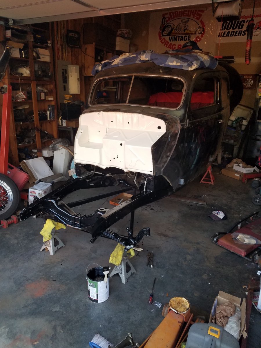

    Now that the weather has broke, and it seems like it might be here to stay for a while, I finally got a chance to move all the parts surrounding the 39 outside so I can get back to putting this thing back together. With some help from my oldest son we got the new shackle bushing pressed into the wish bone and front spring and the got the dropped axle, spring and wish bone all ***embled. With the front end ***embled, we went forward with getting the rebuilt banjo back in the car and bolted in. Once the rear was in, we moved forward and put the front axle / whish bone ***embly back in the car. With that secured, it was time to touch up a few spots on the axle and frame that needed touched up that had suffered some chips from ***embly. then we went ahead with putting the spindles and F100 brakes, with Ch***is Engineering steering arms to cleat the axle back on. Finished up with getting the brake hoses on for the front. and the crossover front brake line. all that's left is to bend up the line from the Master to the drivers side brake hose and the short line from the master to the rear brake hose and we are ready to bleed the brakes. Planning on getting the rest of the brakes lines bent up and in place after work this week as well as getting the rebuilt steering box put back in and replacing all the wheel studs on the rear hubs, The rear hubs were redrilled to chevy pattern and I'm moving it back to 5.5 inch pattern for the 46 for steel wheels. Here is a few pics of the progress.

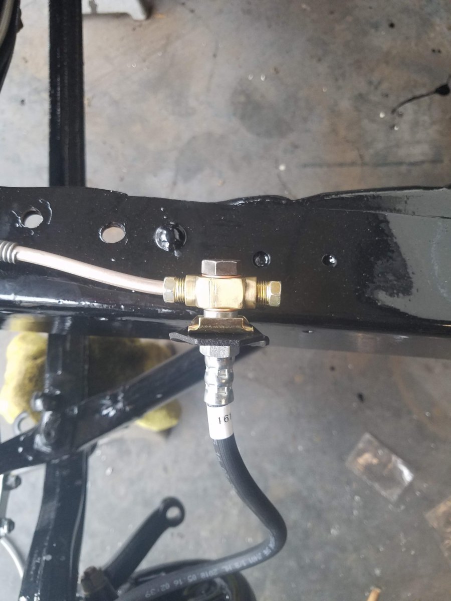

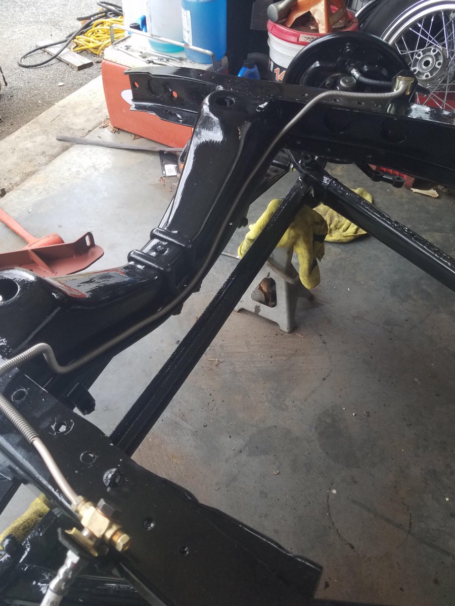

    If you are putting F1 / F100 brakes onto your early ford, and want to retain the use of the original banjo bolt for the hose fitting, you need to use Brake hoses for a 52 to 54 ford. They allow the use of the copper washer for the Banjo bolt, fit the F1/F100 wheel cylinder and still allow the use of the original 1/4 inch brake lines. Its Raybestos Part number BH16179. they are just the right length too when using a dropped axle. 20190407_171557.jpg 20190407_171612.jpg 20190328_200428.jpg

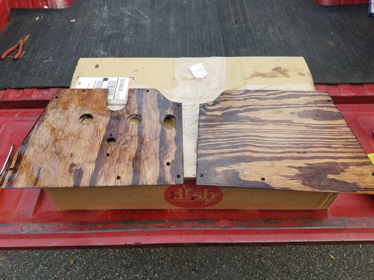

    Also got the wood toes boards stained and five coats of poly applied. the floor is now completely done, both steel and wood. Getting cloer to painting all the Copper parts and get more big stuff put together!!

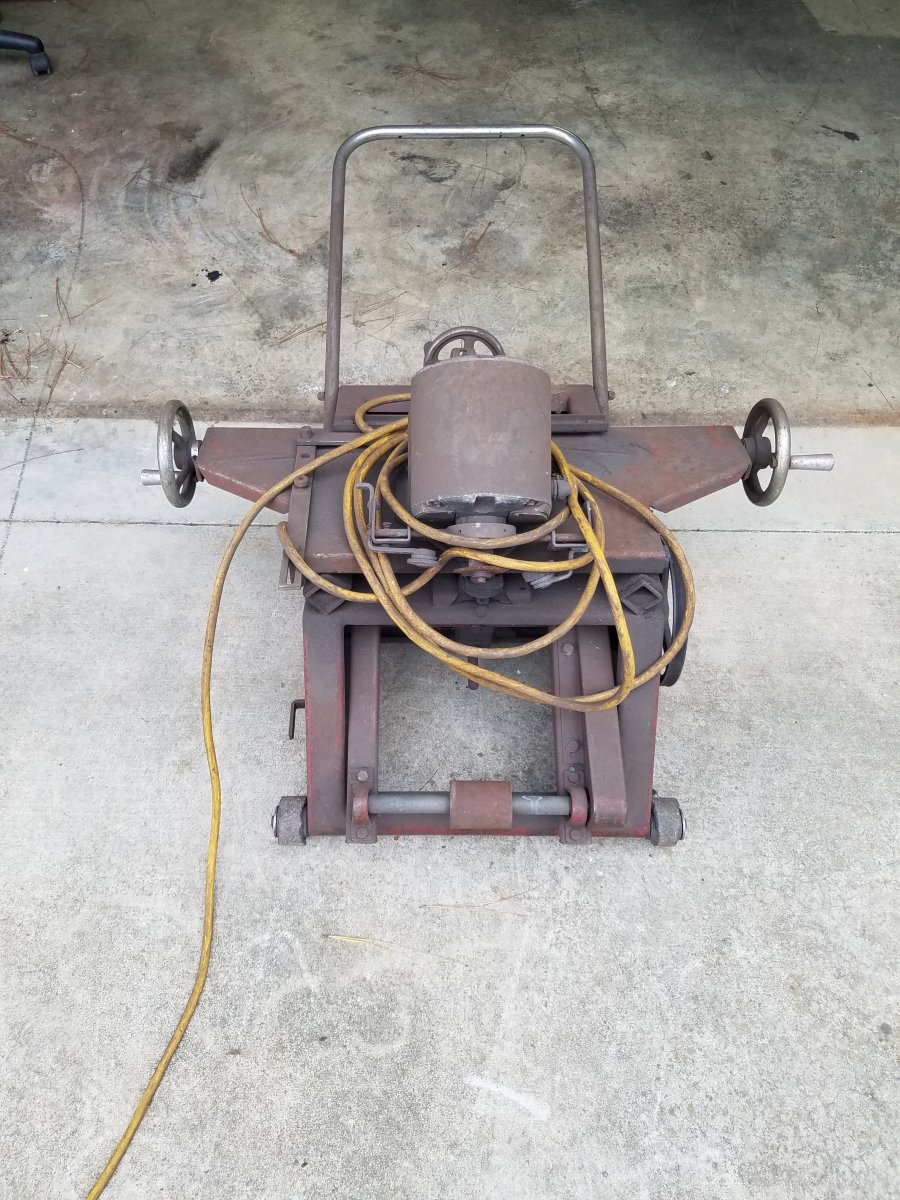

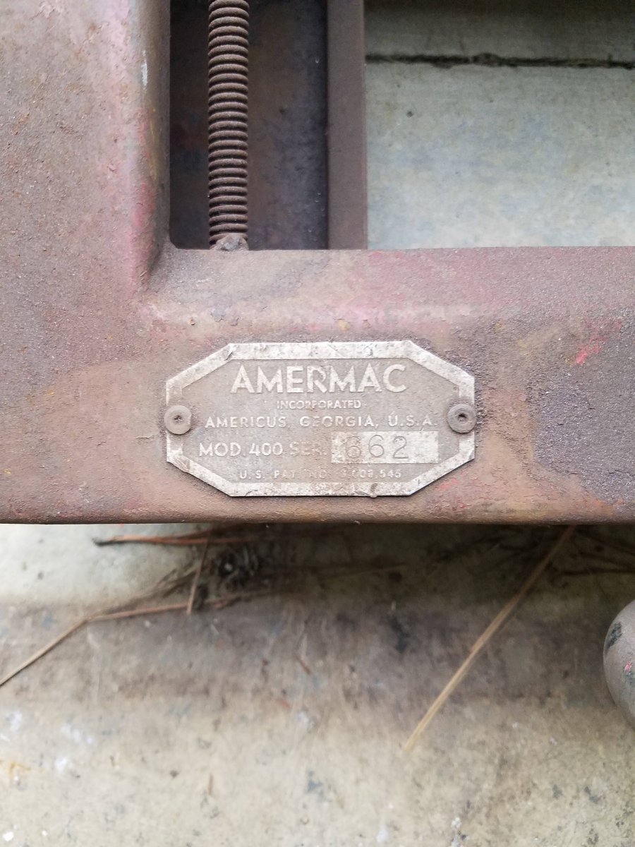

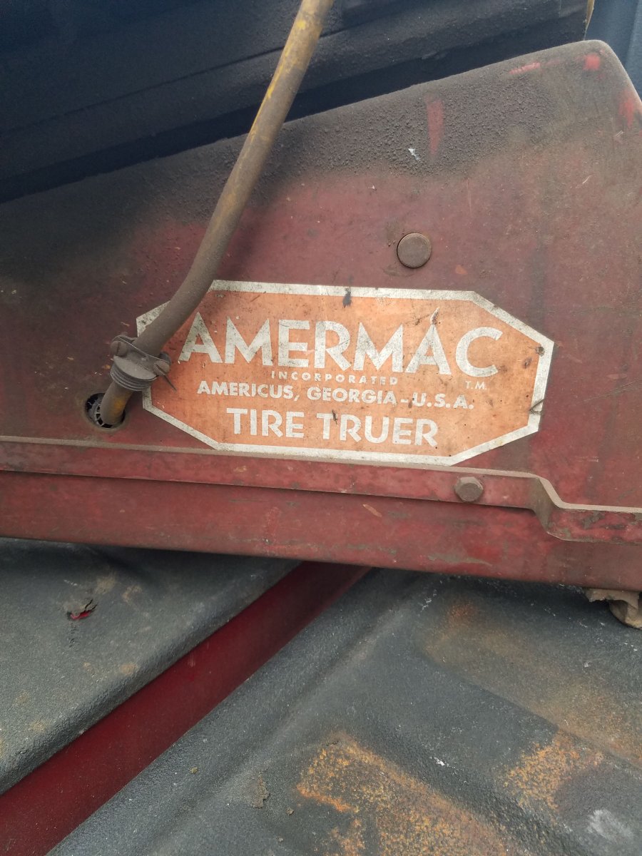

    Getting close to mounting the tires and having this back on four wheels. With that coming up, it worked out perfect when my friend Jack Fuller decided to get rid of his Amermac Tire Truer. So I went down to his shop last weekend and picked it up. once I get the tires on and mounted I be able to true the tires right here in the garage or at the big shop down the road. I have to rebuild the main drive motor, but that's about it other than a clean up. Any one that is in the Richmond area feel free to hit me about if you need to true your Bias Plys up, once I get this operating again.

    Good tip. Wish I'd had it a few months ago when I did my brakes. Your lines came out a lot cleaner than mine.

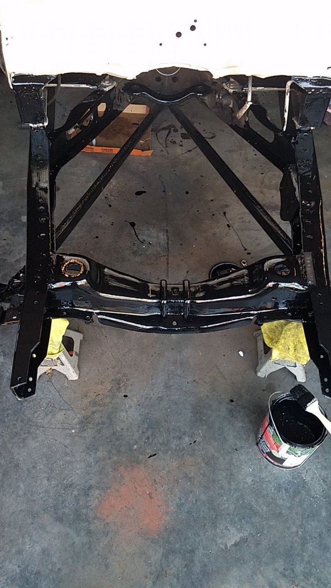

    Finally have to progress to put in this thread. All my major sub-***emblies are just about done, wireing, fuel system, front and rear suspension, brakes rebuilt installed, plumbed and bled. Just needed to get the dash and wheels painted to get it to a roller and start wiring. I took my kids to camp where they will be for a month so I have a months worth of free weekends and after work to really plow though this thing. Got the dash all metal finished, spot putty put on, etch primed and epoxy primed today. Tomorrow morning I'll finally get to spray the color.

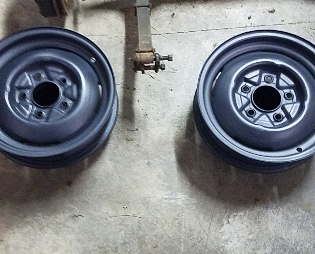

    Got the wheels all etch and epoxy primed fronts are 15x5 and rears are 16x5. Got a set of 5.60 15s bias wide whites for the front and 7.50 16 firestone wide whites for the rear.

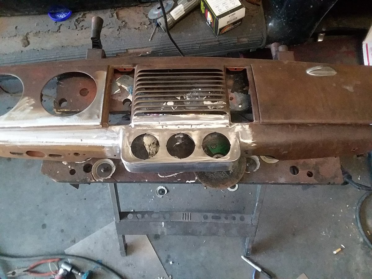

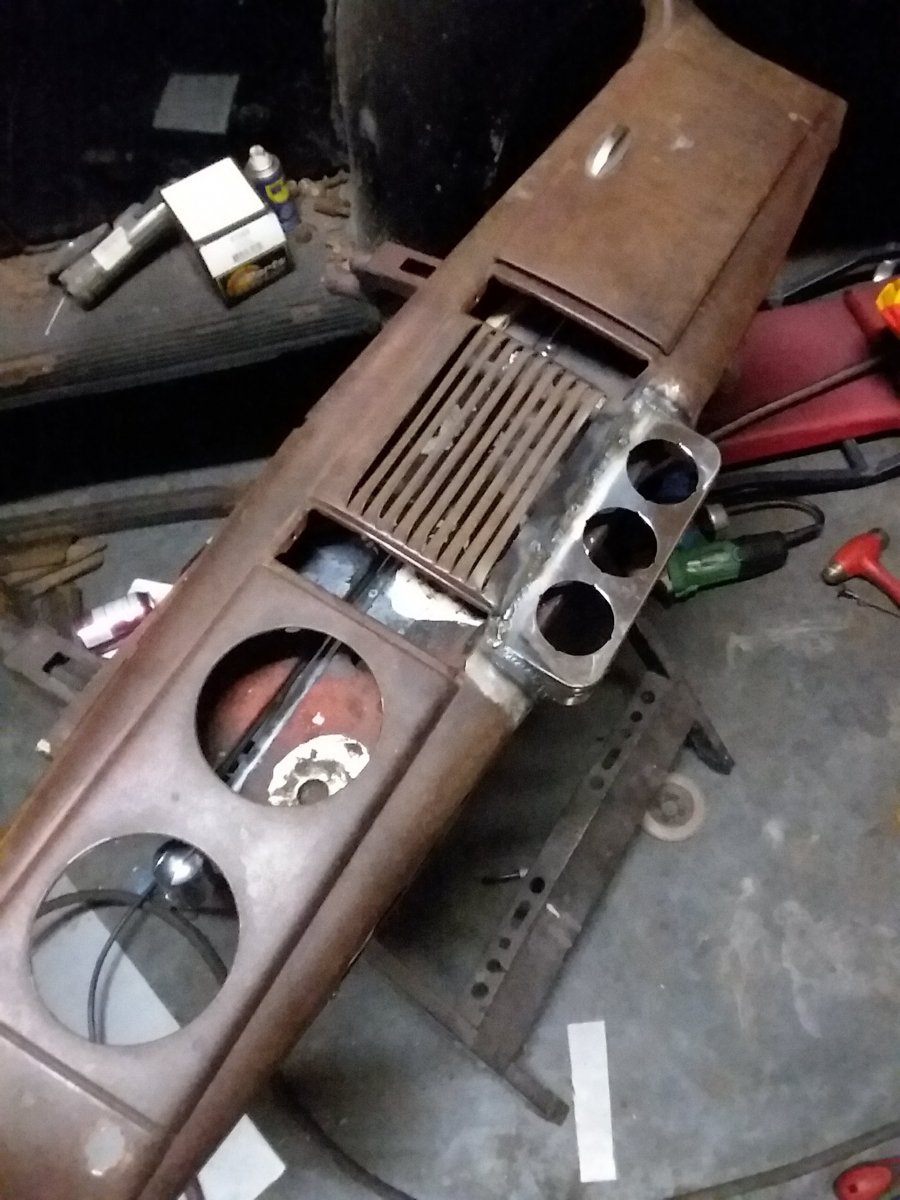

    And got the dash stripped to bear metal, finish body worked, etch primed, and epoxy primed. Really happy with how the guage modification to fix the gaping hole hacked in it for a radio went. And really pleased with how the whole thing turned out once it was in epoxy.

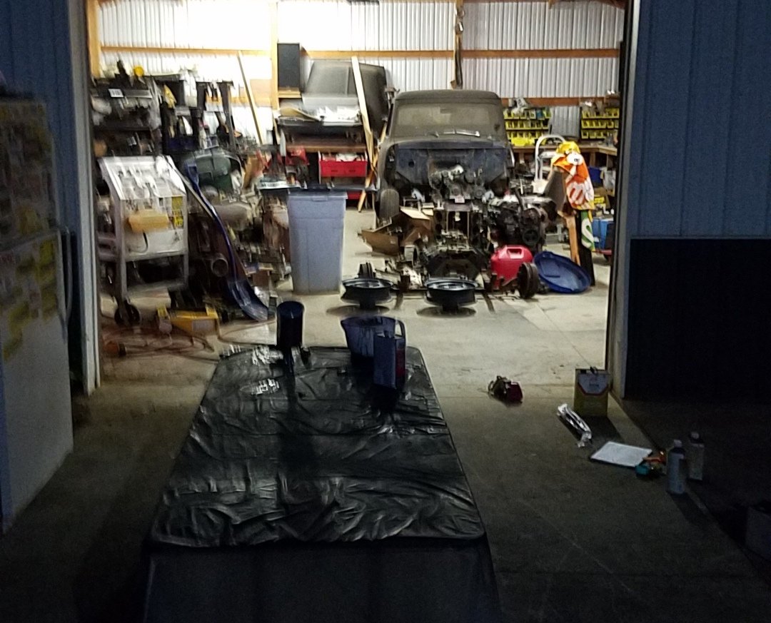

    Big problems with spraying the color today.... I followed ratios of paint, reducer and hardener. But it was just too hot and after about 3 min of spray time it would start to set up in the gun! After two mixed with progressively less hardener I got it to flow properly and set up properly. I ended up using about 1/8th the recommended amount.
    Once that was worked out, I was pretty dissatisfied with the color. It was supposed to look more like a new penny than an old penny. It's not bad, just not what i was wanting.....right now I'm strongly considering s****ping the copper paint and just going with chromed steel wheels, I already have a set. I only painted 2 wheels because of the mix issues and unsure of color once I got it to flow. Here is a pic of the painted wheel. Let me know what you think...I cant make my mind up.

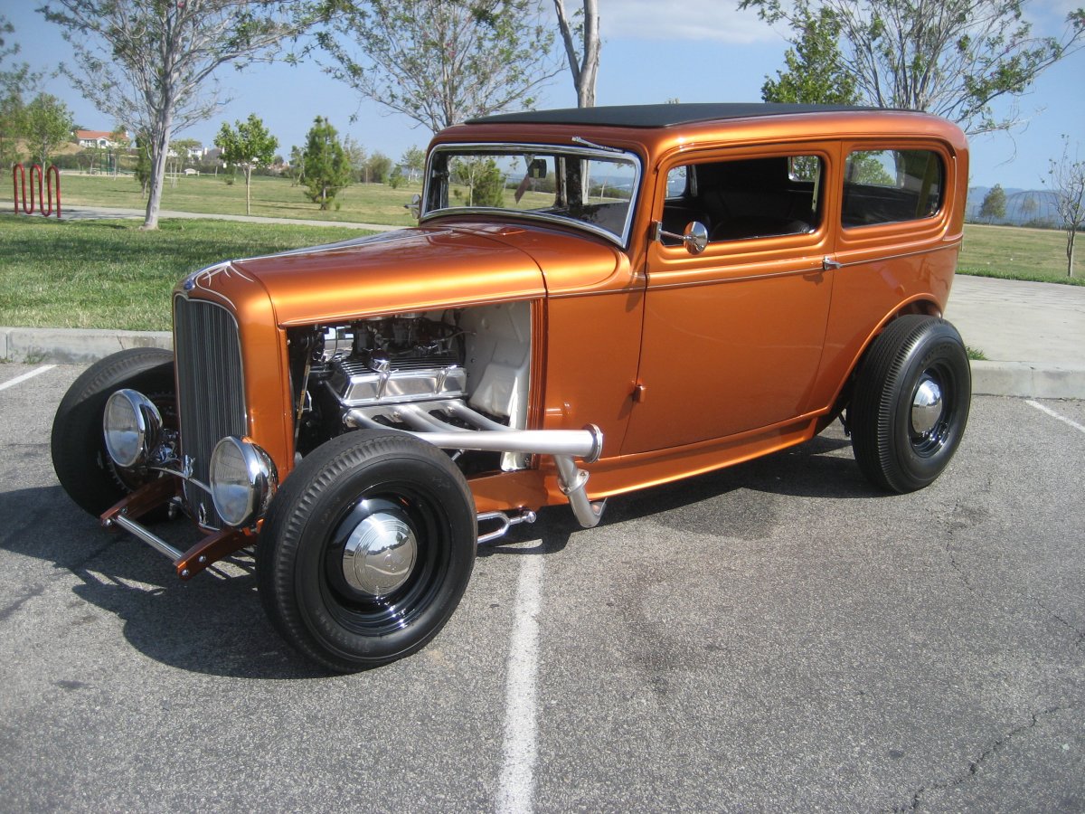

    The Copper on this '32 Sedan currently in the cl***ifieds looks beautiful....... 32 sedan and 56 truck 046.JPG

    That was what I was shooting for. And just to be clear, yes I know that the dark base color will make it darker. The pic posted above is after I sprayed light grey sealer over the dark grey epoxy.

    Nailhead Jason
    Yeah the color is pretty true in the picture. It has a little more sparkle in person but the color is spot on.

    Got the wheel color straightened out. Bought a bunch of VHT engine paint in burnt copper and spray bombed them with VHT sp402.
    This is what it was supposed to look like. They will get cleared tomorrow and that will make them pop.
