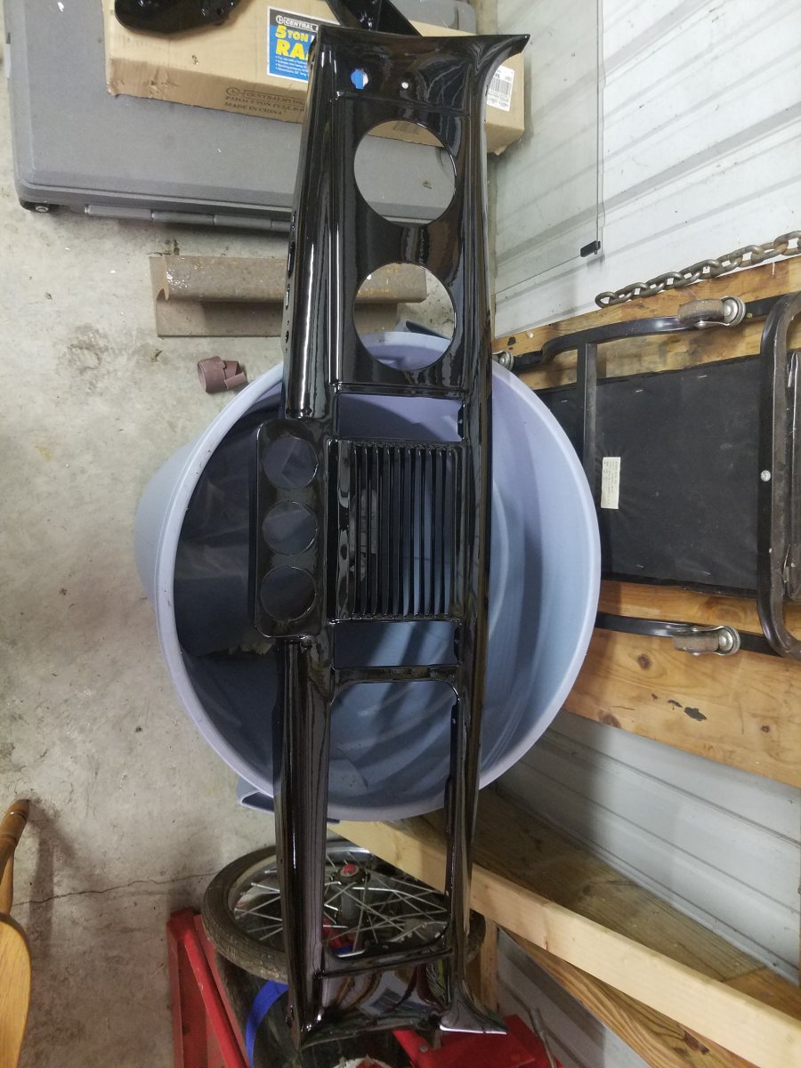

    My very good friend Del is gonna get the column tube, drop, and garnish mouldings chromed for me from his guy in NC. So I'm going with a black dash that should really pop with the black banjo wheel! Dash is all ready for paint now

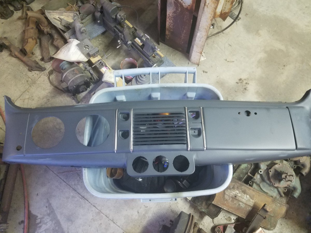

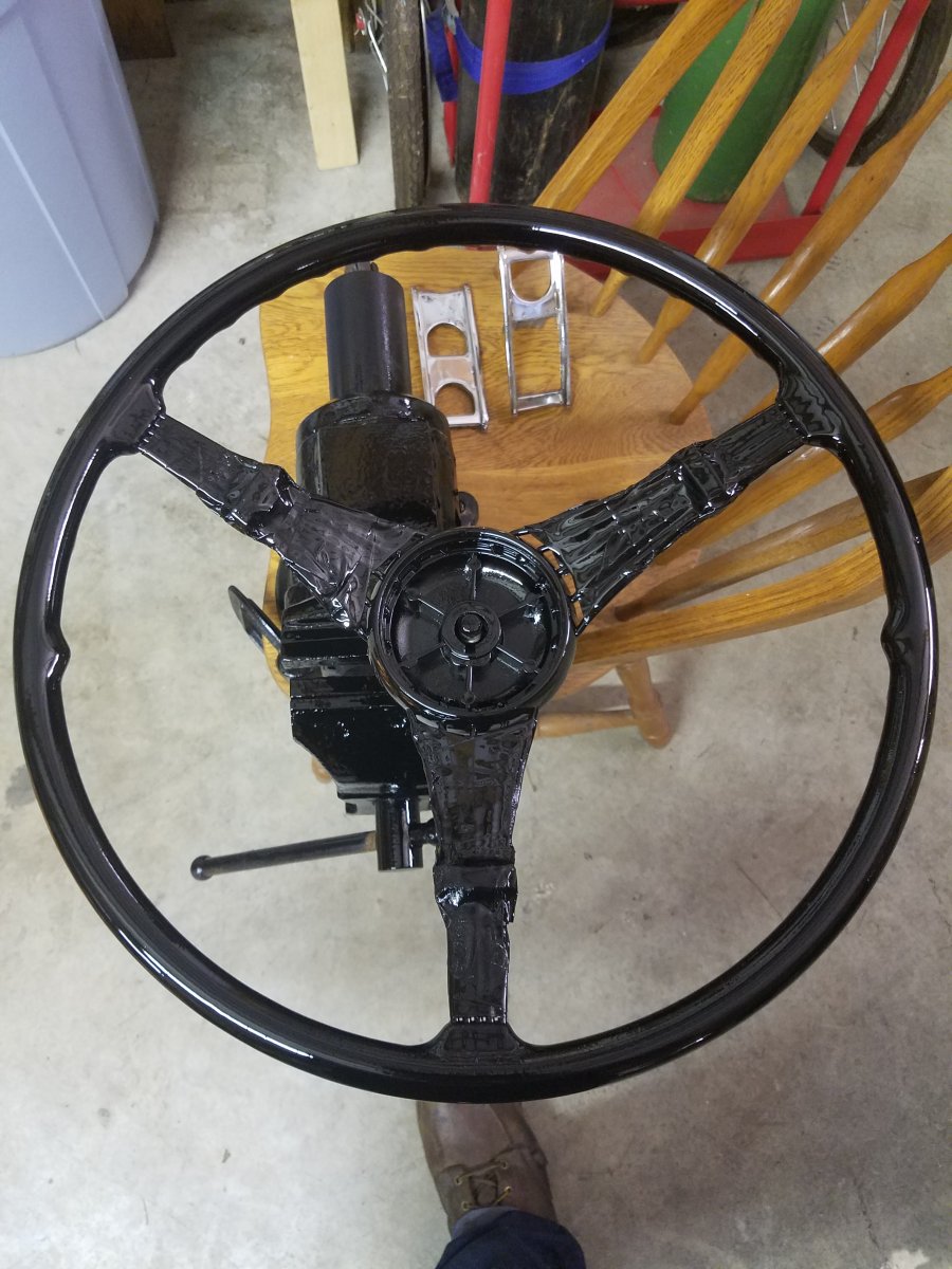

    Plowing forward with the progress!!! A huge thanks to @theHIGHLANDER for the info on painting the banjo wheel. It turned out great! Got the dash and all the small bits painted this evening as well as the banjo steering wheel, the hurst motor mount, and the headlight switch knob. Gonna have to redo the horn ****on it got fisheyes in it but I probably should have used the adhesion promoter on it as well. Looks pretty good for doing it on a table next to a 35 acre farm field!

    Really happy with the banjo! I'll pull the masking tomorrow after it sets in the sun for a few hours.

    Don't get greedy with the sun on the wheel, and don't freak out if it gets a little "soft" at 1st. Should cure well after a cool down and you'll be all good. Soft core, fresh paint, **** moves around.

    Banjo wheel looking real good! Gonna set it out in the sun for a few hours to help harden it up. 20190706_114306.jpg

    In that case it will stay in the shop. It wont go on the car for a few weeks so it should cure plenty by then don't want anything to mess it up. I dont want to strip this one to do it again.

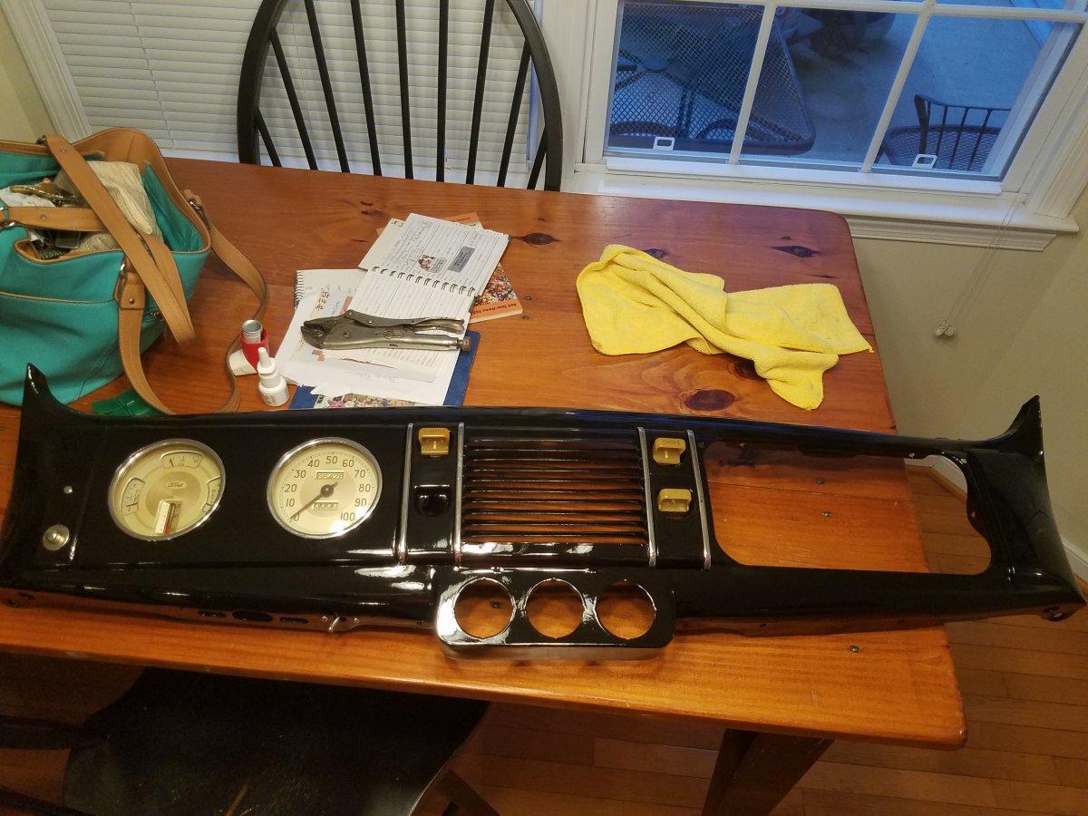

    Dash is looking good as well. Got the chrome polished up for the inserts. And all mocked together gonna let it set for a few days and then start with ***embly and the wiring.
    Tonight is parts orginazation, and staging. Making sure I have and can find everything that I have bought for the car and that it is in the right spot when I need it.

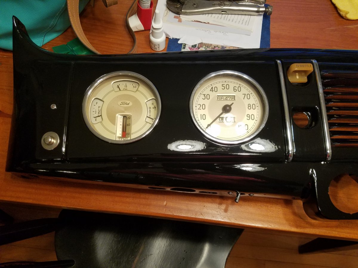

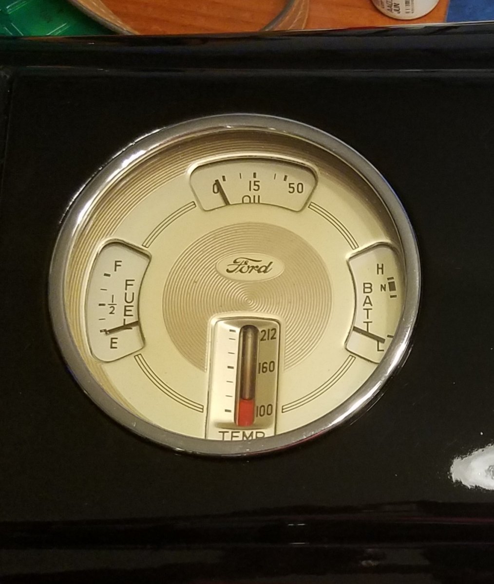

    Got a few other things done but not as much as I had hoped too. I was able to get the dash ***embled and ready to start wiring. Swapped out the original standard gauge to a real nice set of 39 deluxe gauges I scored a few years ago. Not a fan of the dodo brown standard gauges. And got all the trim panels and NOS knobs installed on in the dash. Just need to find a lighter socket for the last one. Gonna pick up a universal power port from the parts store and see if it will fit. I have a NOS 40 lighter element to use if I can get the knob off and swap the 39 knob on it. Once wired up, it's ready to install.

    One thing that I liked about these deluxe gauges, was that they had a volt meter in the quad guage. I have not seen that many before, but I have this deluxe one and a standard gauge that has a volt meter instead of the regular Amp meter. How rare is this? What will it do on 12 volts? I like it but may swap it for an amp meter since I'll be running 12 volts and I have a nice old Stewart Warner voltmeter to run in the 3 guage pod on the bottom.

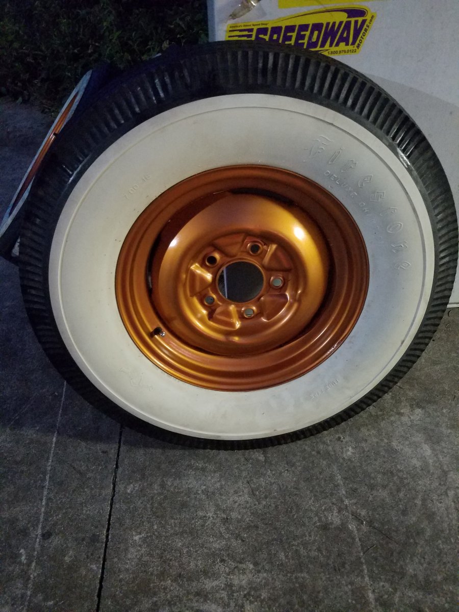

    Went ahead and started mounting the tires up by hand so I dont have to worry about some nimrod scratching the paint up. The wheel color came out perfect exactly what I wanted against the white walls. Got 3 of the four done before I called it. Finish up the last one tomorrow. 20190709_210517.jpg 20190709_210523.jpg

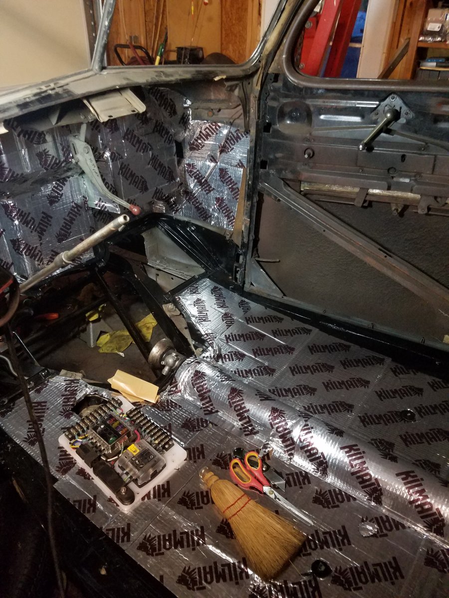

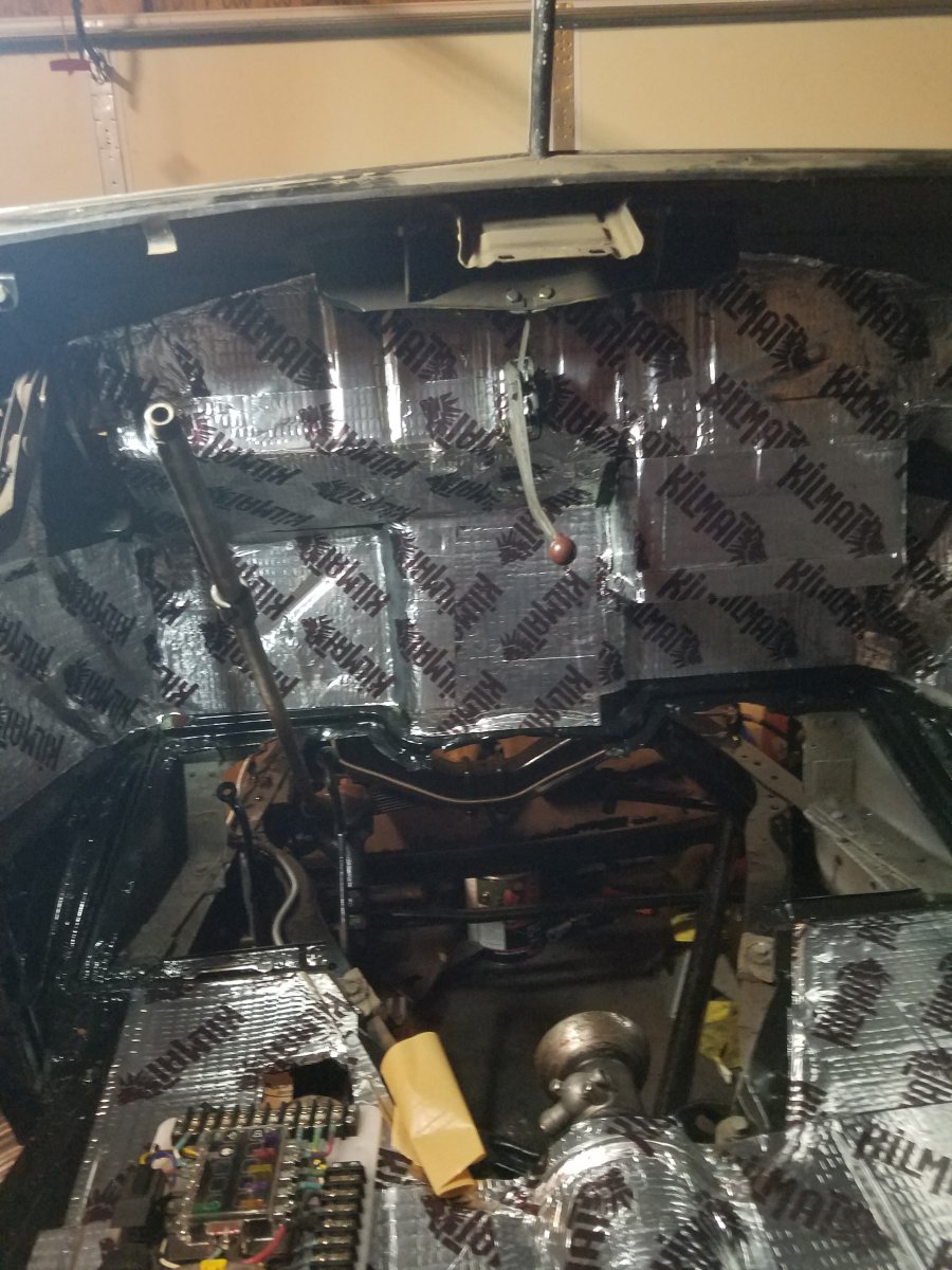

    Small progress every day will get this pig put together. Got the kill mat sound deadener put in on the firewall and the floor. Gotta order another carton to wrap up the edges of the floor and do the ceiling too. I dont want this to be a harmonics amplifier. 20190710_205320.jpg 20190710_205326.jpg 20190710_205332.jpg

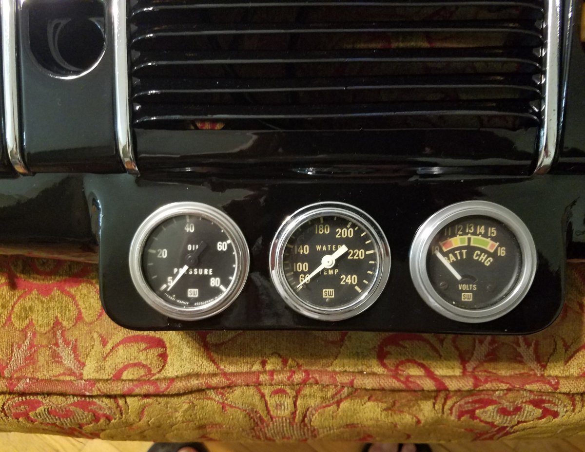

    Found the Stewart Warners to put in the lower pod tonight too. The temp and volt meter were in the car when I got it, the oil pressure was in my guage stash. Kinda cool to use the old Stewart warners that have been in tha car for decades.

    My good buddy Del from NC came up the other day and we got the rear hubs pulled and the bolt pattern changed back to 5 on 5 1/2. The hubs had been redrilled to chevy pattern by the guy I got the rear from. Got the fuse panel mounted on the firewall and all the dash wiring done. Now the dash just needs installed and wires connected to the fuse block and the end points. This wraps up all the wiring except for the lights of the factory light switch at the end of the steering box. Getting closer....

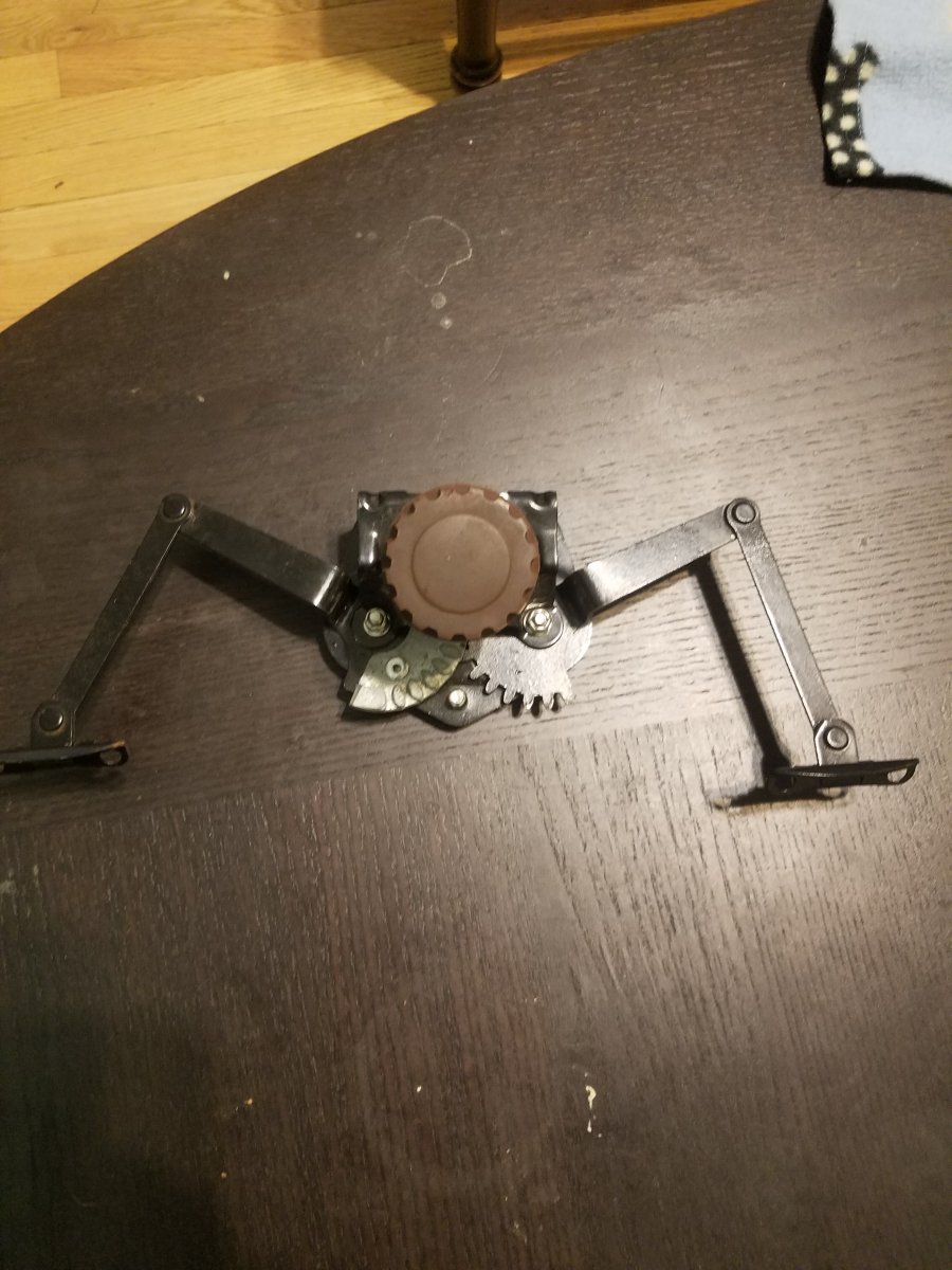

    Also got the windshield regulator rebuilt. The aluminum gear was missing 3 teeth. Luckily I found a guy on EBay that had a new gear and scooped it up. Had to drill the rivets that the arms pivot on and redneck machine (file to size by hand on my couch) aluminum spacers and put it back together with ****on head allen bolts and nylocks. It appears to work so far..... 20190720_233028.jpg

    Nice work especially in this heat wave. Curious about the electric panel. Where did you source that from or did you build it yourself?
    Atwater Mike, Stogy and loudbang like this.
  30. Nailhead Jason
    Joined: Sep 18, 2012
    Posts: 4,515
    Nailhead Jason
    I made the electrics panel from some boat fuse blocks and terminal blocks I sourced on amazon, and mounted them all to a cutting board I bought from the dollar store. Since I am using the original head light switch and the column drop switch I couldn't see buying a harness for a couple hundred bucks just to cut it all up. So I made this one. Between all the wire I bought,the fuse panel, terminals and original switch parts I have less than 100 bucks in rewiring the whole car.
