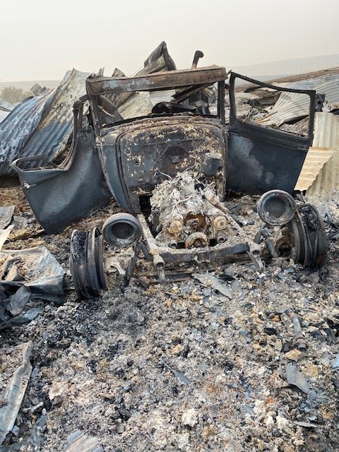

    788EE2E0-879F-4999-BB47-C85639DBE115.jpeg My father in law bought this pickup sometime in 1968, and drove it around his farm for fun, and occasionally drove down Burr Canyon to the Snake river.
    With a 59AB flathead and a 1939 transmission, he would say, "Man, that thing would GO."
    In 1969, during one of these jaunts, it started smoking and knocking. He ended up pushing it into a shed, where it stayed till the mid 2000s. He and I pulled it apart, cleaned it up and got a 8BA to replace the 59AB. The 8BA was out of the first pickup he had bought new, a 1950 F1.
    We boxed the frame and added front suspension from a 1940 frame that was in the boneyard behind the shop. It all came together really well.
    We lost my wife's parents 2 years ago, p***ing 5 weeks apart. For the past 2 years, my wife, her family and I have been caring for the farm, cleaning stuff up, and trying to protect the farmhouses and the shops.
    Last October there was a fire that started over 12 miles away. It came along the Snake river, and up Burr Canyon. It devastated the farm. We were told 6 homes were lost, 2 of which were homes at our farm. We also lost both shops and a bunch of outbuildings.
    The Model A was in the same shop that we had put it back together in. That shop burned to the ground, and some of the pictures will show nails on the body.
    The building burned and collapsed onto the pickup, leaving the nails behind after the wood burned away. As if it had rained nails.
    So I have decided to try to save the Model A, Hopefully the frame and suspension is salvageable. But I am in for this project even if Im starting with only some nuts and bolts. [

    Looking at the way the doors are distorted is shocking to say the least. Fire sure is a scary thing. About the only good thing is that you were not hurt or there when the fire was raging. Good on you to save a family treasure.

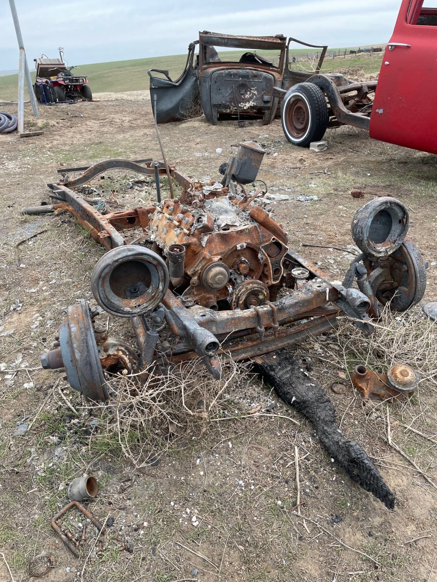

    This last week, I took the wheels off the front and found the rears ( I had taken the rear end apart after it broke an axle shaft), and took them in to make sure they were ok. The tires had burned right off of the wheels. I also found 3 other wheels in the rubble that I had looked for 10 years ago. I left 7 wheels with some great local wheel guys to check and powdercoat the 4 best fire-engine-red. I had rattlecan painted them 10 years ago instead of powdercoating and always regretted it.
    They called and told me that 2 of the 7 were usable. The others were warped and out of round from the heat. A third wheel might be usable as a spare, they said, but still had excessive runout. I loved those Ford wires, but I have some other wheels I might use.
    The engine seems wasted, as it is locked up, and all the aluminum parts are melted, as are the carbs, and the radiator. And the windshield. That ****er got HOT.
    So I have some decisions to make. We had decided to not restore the Model A those years ago. Rather than do the restoration thing, we thought it wanted to be a hot rod. So we left alone as much as we could and made everything work, leaving it somewhat a survivor. That plan doesn't really work anymore, so maybe a 60s vibe. Ive been thinking about a 390 FE and slotted mags.
    Ive already bought another cab, and Ive salvaged some sheetmetal from a 1936 International truck (that also partially burned) that I am going to try to include. And since the radiator and grille was destroyed, I am going to use the grille and radiator from the corn binder, too.
