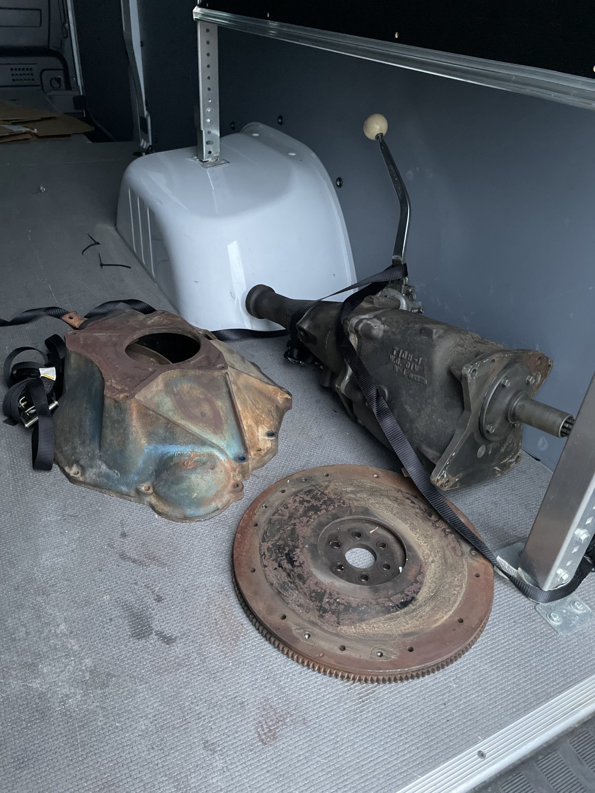

    I’ve also made some decisions on powertrain. I came this Borg Warner T-10 with a hurst shifter. It’s been nicely rebuilt, and it has a dual pattern.

    Looks like the truck cast iron bellhousing, which is, I think, 5/8" deeper than the car unit. So check that the transmission input shaft will be long enough. I think you used to be able to buy a long pilot bushing for this setup.
