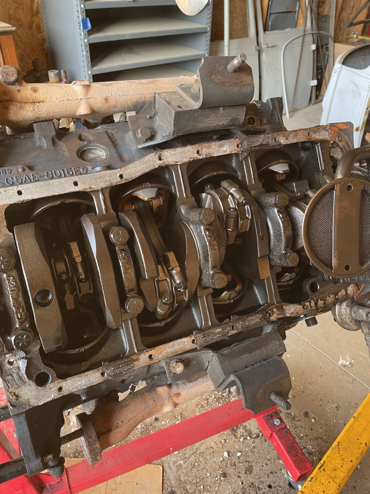

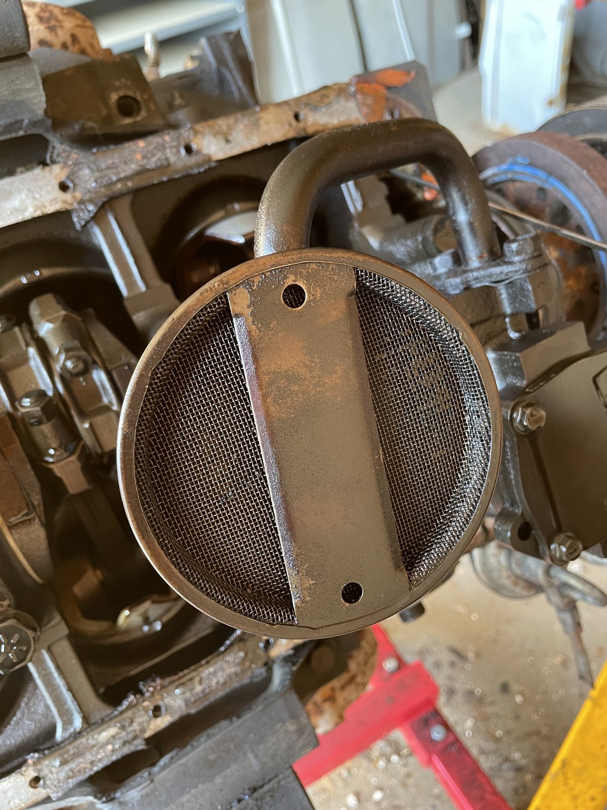

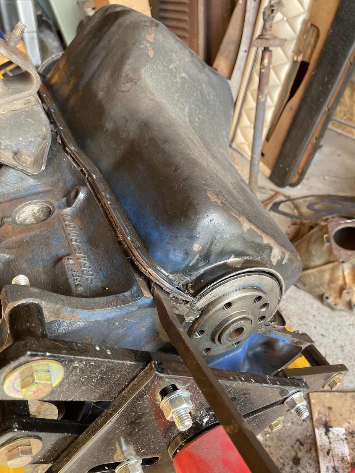

    So I checked out some ideas for the dash today, and cleaned up the engine I bought, and pulled the oil pan.

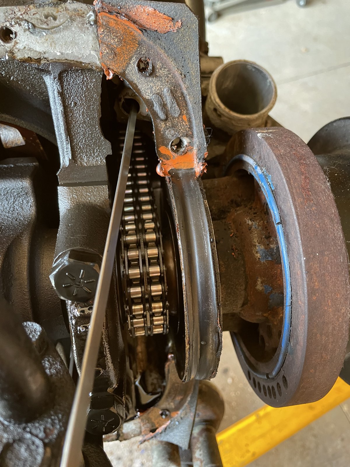

    Everything looks really good, and that is a double roller timing chain.

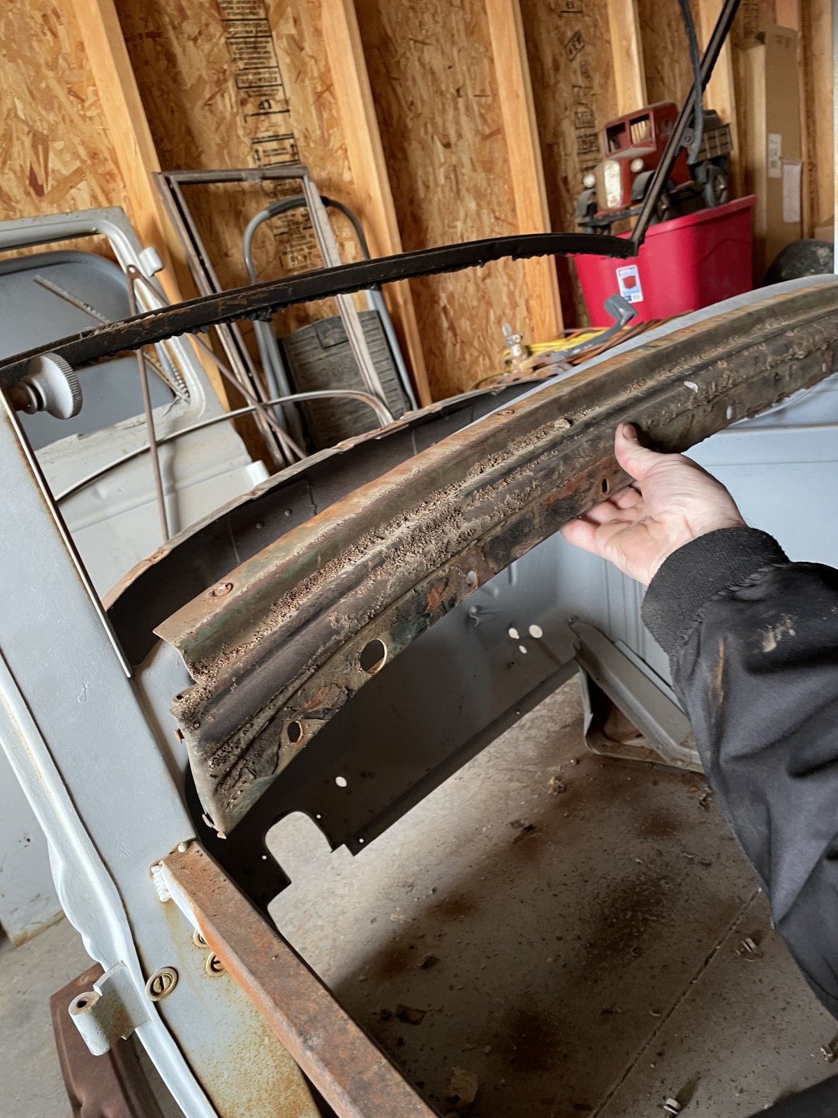

    I like the look of the dash. I may need to do a little bit of t******* for final fit. And I’m thinking I might put a hinge in there so the panel folds down to work on the gauges. Cuz I hate working on my back under the dash.

    I think it needs the cap panel
    , but they’re too thick.

    Gonna have to think a bit on this. I want to get the dash cap right. Maybe cut the cap down thin and put some black closed-cell foam rubber over it.
  16. loudbang
    Posts: 40,346
  17. briz
    Joined: Dec 30, 2007
    Posts: 220
    briz
    Wow- I hadn't even looked over that rubber insulator. But yeah, I guess Im gonna put a new balancer on my shopping list.
    Weather checked AND swelling out of the groove? I'm sure it'll be ok...:)

    The cracks in the harmonic damper are found on pretty much all Ford dampers. There were several Dealer Service Bulletins about it over the years, saying they look bad but are safe to use.
    Here's the comment in the small block Ford bible, Bob Mannel's book:
    There is a wavy groove cut into the mating iron surfaces to prevent slipping, as well.
    Okie Pete and deadbeat like this.

    I looked over my dash caps, and decided which I like the best. I really wanted to include the original cap from the Model A, but it just didn't work. 67351499-DA33-4F0C-9E37-98A51BCDF674.jpeg

    The one I like is actually a brace that was behind the international dash.
    I cut the bottom edge off and it seems to fit well. 8851CEDC-C833-44E0-B1B1-7C65E656FB95.jpeg
