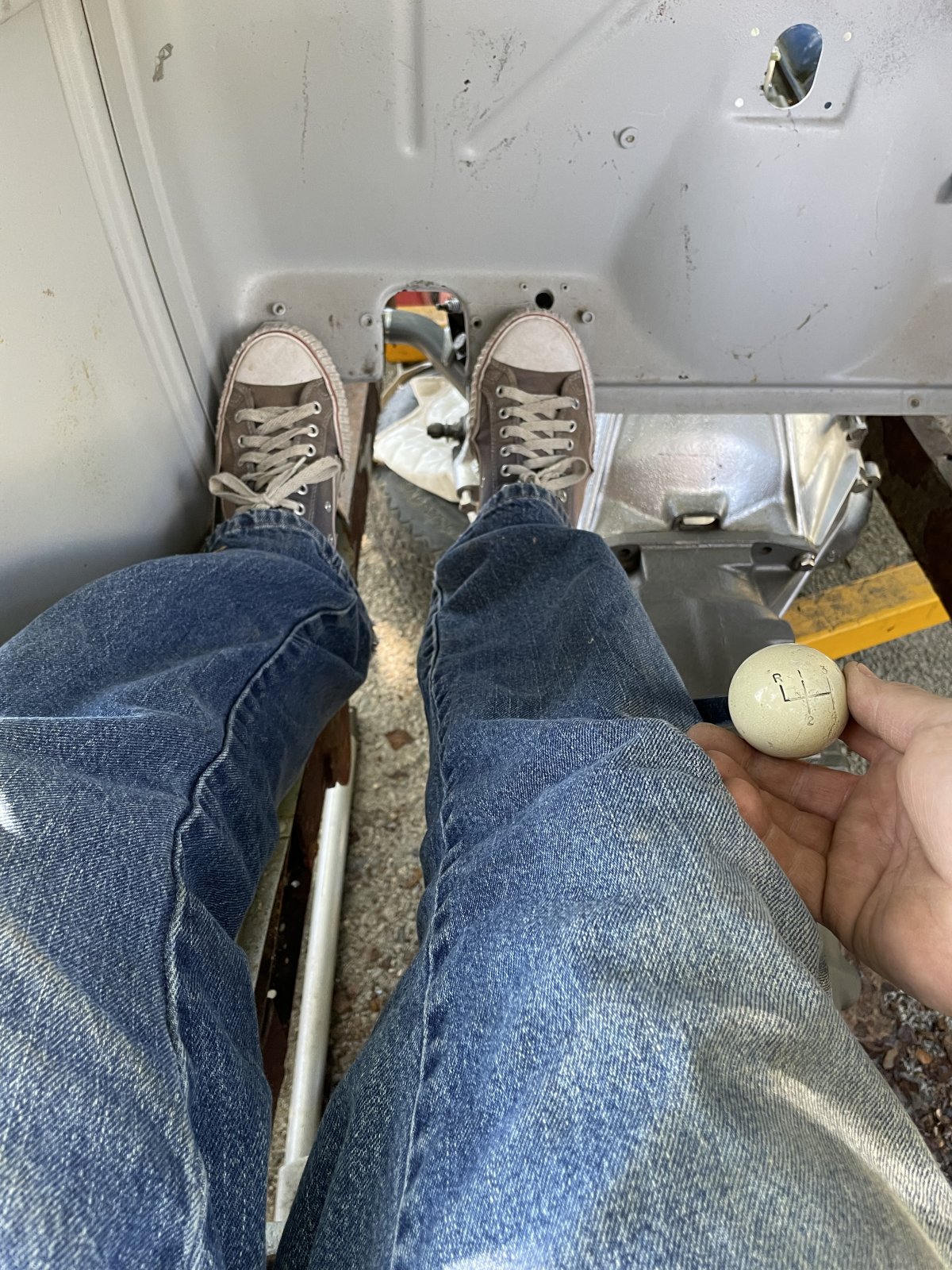

    I was concerned about the placement of the shifter, so I put the seat in and checked the fit.
    101D54D3-2385-4F6A-96BB-359684858C67.jpeg 15D43E55-3403-4F44-92C7-76FE6A50063E.jpeg 2C6D97D5-C6C4-4F65-9182-0E3561EEA34A.jpeg
