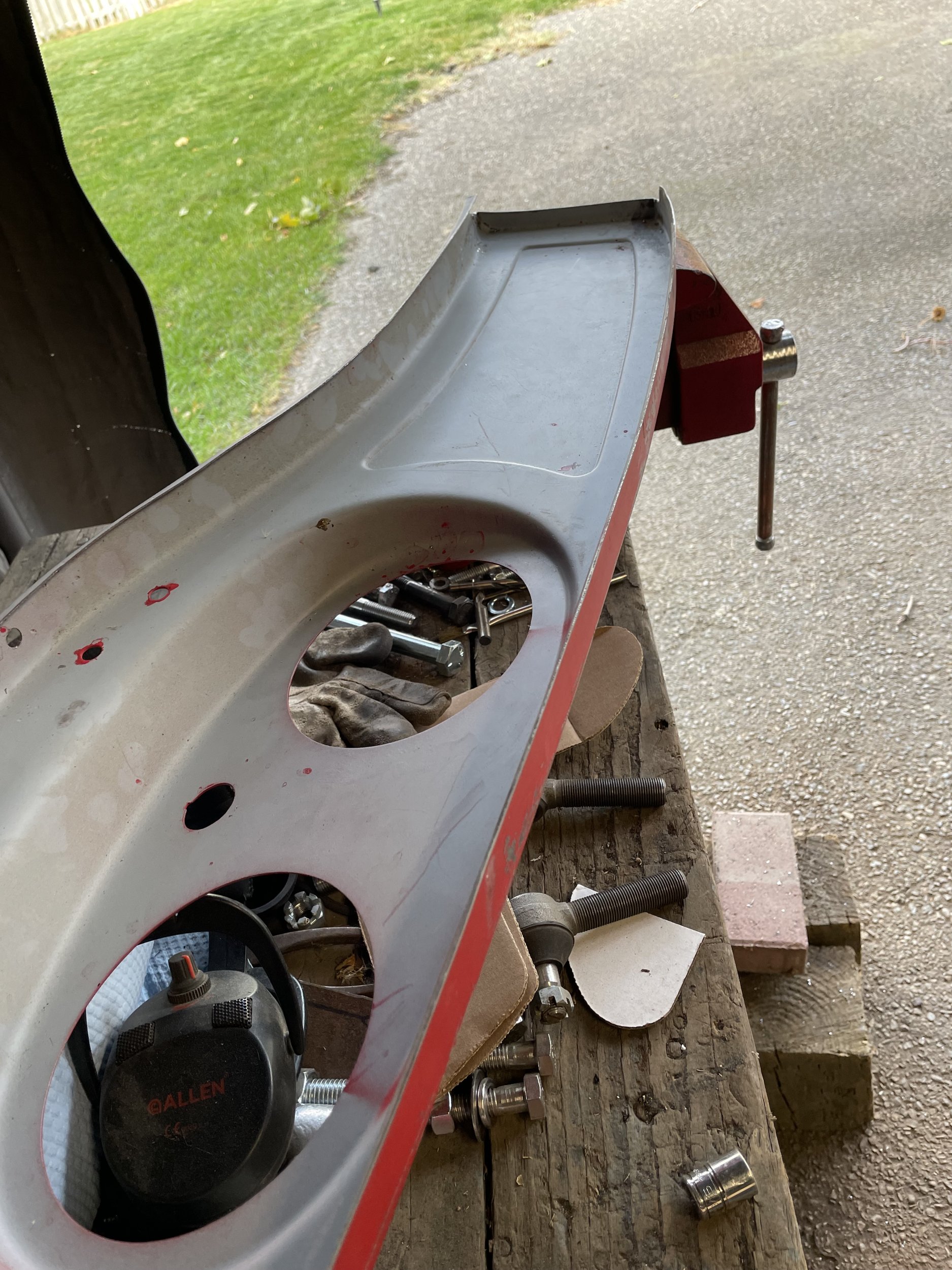

  28. briz
    Joined: Dec 30, 2007
    Posts: 220
    briz
    I want to countersink the fasteners, so I made a simple dimple die to help me do that.
    a simple dimple die?
    Yep, a simple dimple die.
    After I’ve drilled the holes for the fasteners that I want countersunk, I thread this hardware on and tighten it all up and it “dimples the hole at a 45 degree cone ( or a 90 degree cone depending on who is measuring it) and a (90 degree) countersunk screw will sit in nicely.
  29. briz
    Posts: 220
    briz
    I had to grind one side cuz it sat so close to that edge.
  30. briz
    Posts: 220
    briz
    The. I tightened the whole thing together till it mashed a countersink into the dash panel.
    jet996, alanp561, LWEL9226 and 4 others like this.
