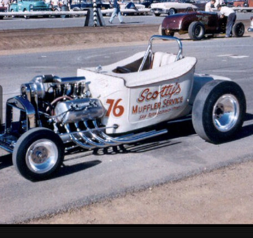

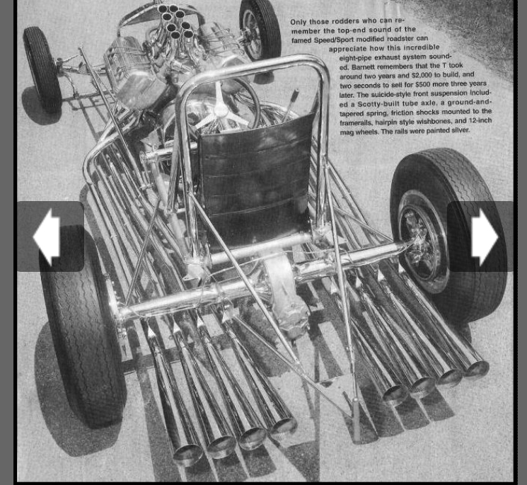

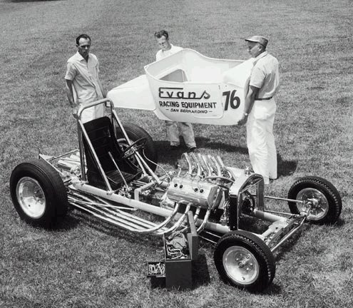

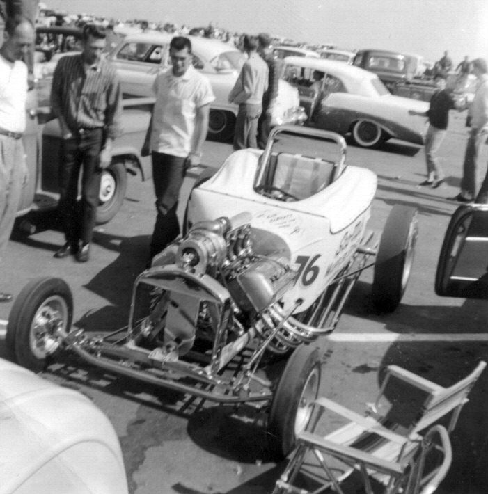

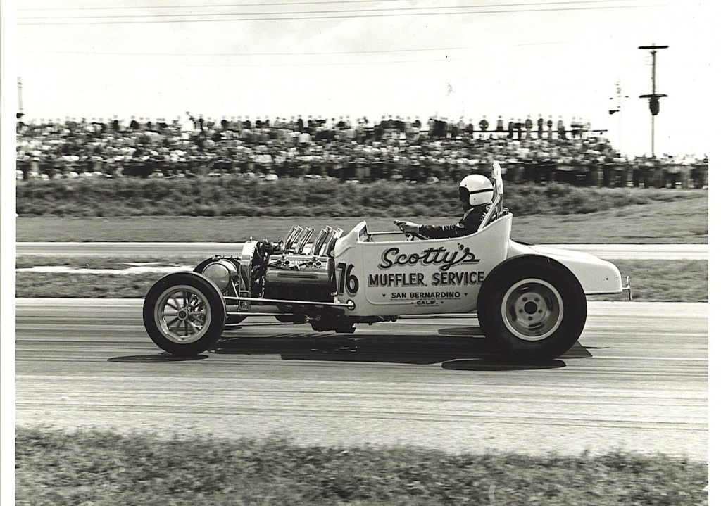

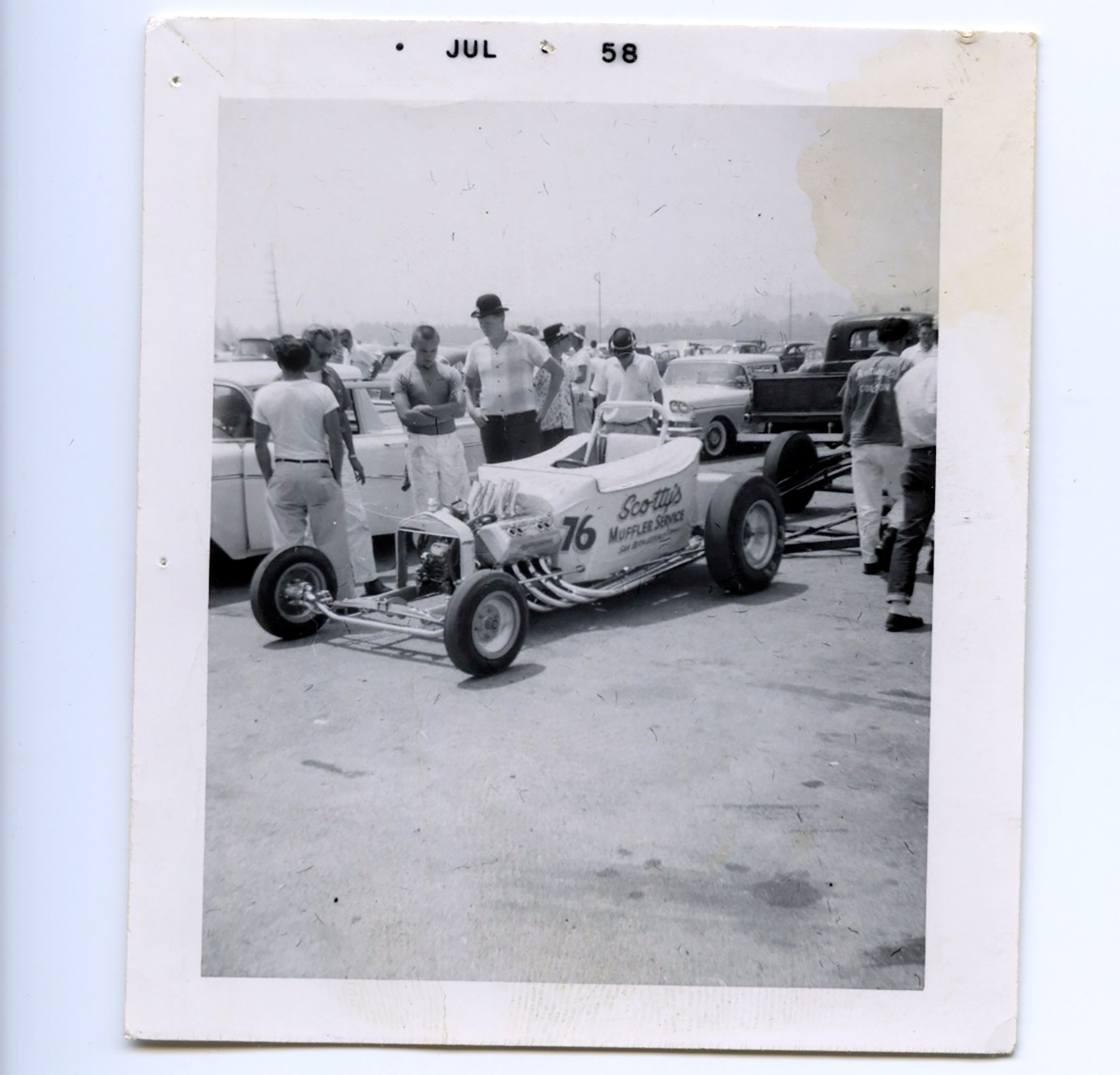

    Well, I’ve been pondering and researching this deal for several years, life got in the way as it often does. I’m finally ready to start the build to bring this iconic Hot Rod back from the past with a complete build from nearly scratch. It’s a great car that was originally built as a club project and with really fine craftsmanship and nearly everything was chromed. I’m going to build the injected only version for now because I just think it looks great, but I have the chain driven blower set up if I want to add it later..
    . I’m going to need A LOT of help Identifying the parts in the pictures if possible then, finding these vintage parts. I’m gonna need a lot of advice, building tips and support to pull this off. I’m hoping to maybe work out a partnership agreement maybe with someone that can help out with the build someway in return to put it on display in a museum or shows or something. I dont know if that is anything people normally do But I’d like to try that.
    My first issue is to lay out and build the ch***is. I need to source some elliptical tubing for the main rails so far I haven’t been able to find a good source for that yet. Doing the research I’ve heard they frame rails came from PBY-5/6 wing struts. Other research just says it was tubing designed for wing struts on planes.. I need to determine the approximate wheel base which I can’t find any mention of so far in my research but I’m guessing it’s approximately 110” give or take. So right now I’m on the hunt for this tubing to just get the ball rolling. I have many many vintage parts to still locate but I’ll get into that as I go.
    I’ll post several of the pictures I have of it and hopefully I can get some input as to wheelbase estimates and any other details that need to be. sorted out.
    oddly another thing I’ve learned doing research is that even though this car was only on the scene out in California for what I believe to be 2-3 years, I’ve discovered it had 2 different paint schemes and was ran mostly with the 12” Magnesium midget wheels on front, but it also had some other taller spindle mount spoke wheels briefly.
    here are the pictures, first priority it to source elliptical tubing that’s approximately 2x4 inch and .085 or so although the thickness isn’t as critical.
    Wish me Luck I’m gonna need it……

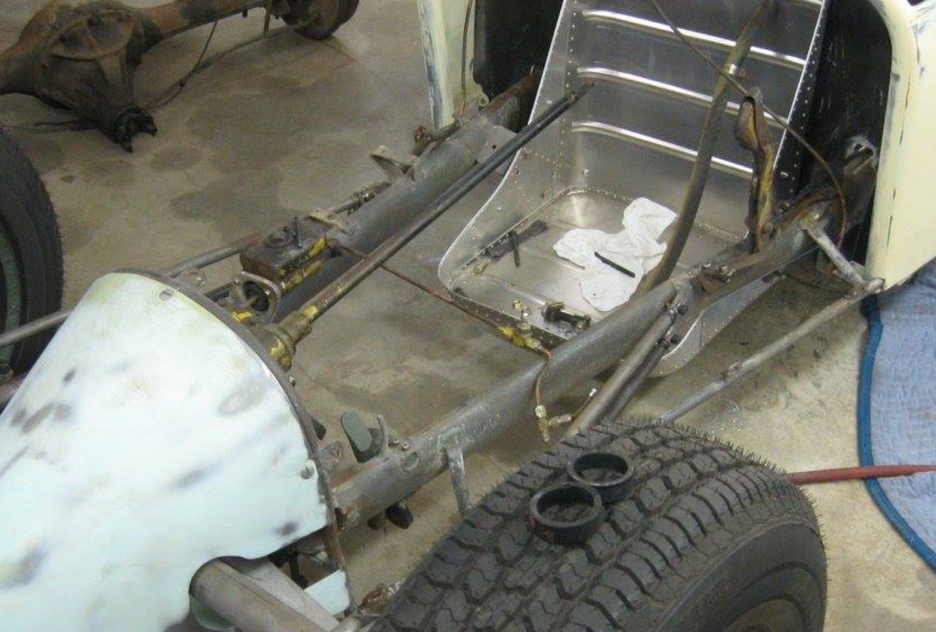

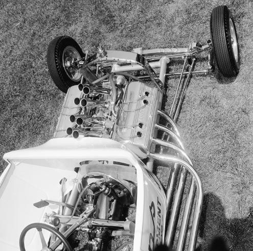

    I got to help with the Carrillo roadster restoration some years ago. It had elliptical frame rails which, according to Carrillo were wing struts from a WWII PBY. Only a reference, here is a shot of those frame rails during restoration.

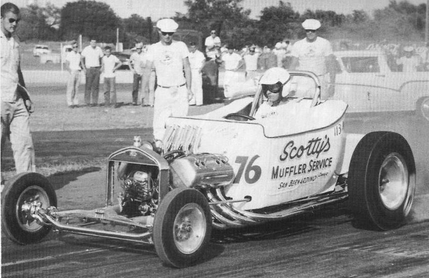

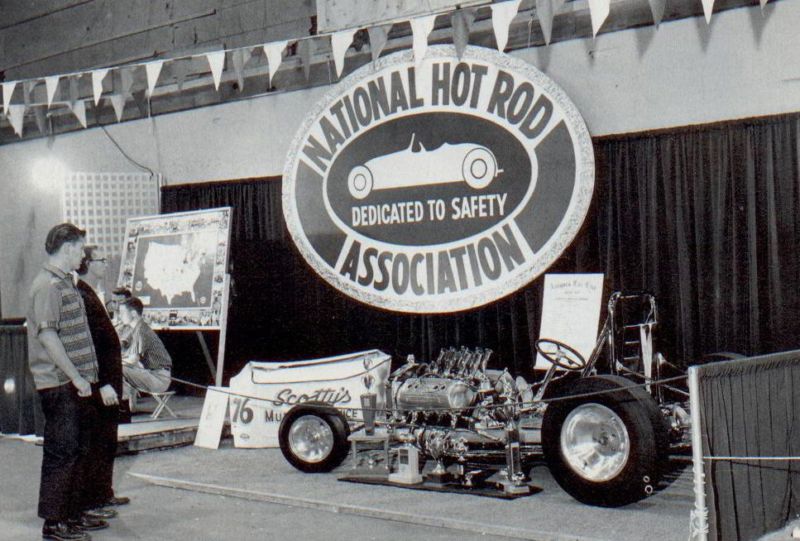

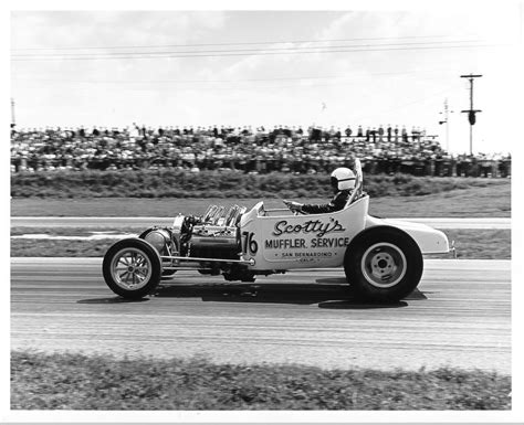

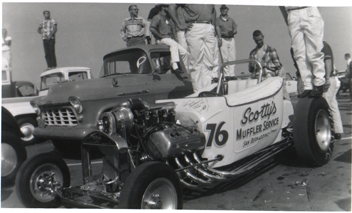

    Here are some photos that you might already have some of . . .
    National Queen.jpg Scotty's Muffler Naked-04.jpg Scotty's Roadster.jpg 23 Alton.jpg 23 Bare.jpg 23 in Alton.jpeg 23 Roadster Colton.jpg 23 Roadster Riv..jpg 23 Roadster Colton.jpg 23 Roadster Riv..jpg National Queen.jpg 23 Roadster Riv..jpg 23 Roadster Riv..jpg 23 Roadster Riv..jpg Scotty's Muffler Naked-04.jpg National Queen.jpg 23 Alton.jpg 23 Bare.jpg 23 in Alton.jpeg 23 Roadster Colton.jpg 23 Roadster Riv..jpg
  6. Stan Back
    Joined: Mar 9, 2007
    Posts: 2,719
    Stan Back
    . . . sorry, I can't eliminate the duplicates in my electric machine. Well, she's okay to look at a few times.
    The best of the features, in my opinion, are the 12" wheels and the out-the-back exhausts which I was told were modified Ford torque tubes -- which I doubt is true.

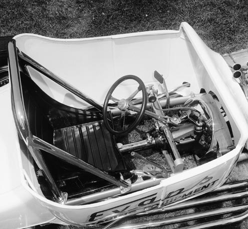

    Thanks! That’s the same tubing alright, as well as the aircraft seat I will need to one up with as well

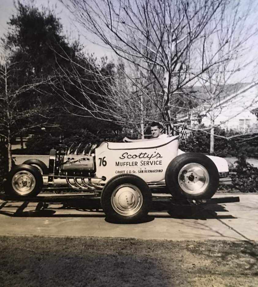

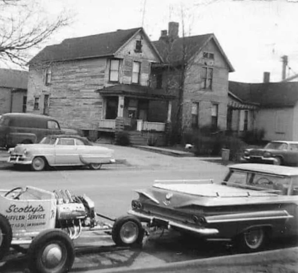

    Thanks for posting those! Yeah , I have all those and just a few more and I believe that’s about all that are known to exist . The one on the trailer is taken here in Springfield Illinois when the car was sold to Bob Baugh who was a buddy of my Dad. The car worked its way around here for a few years, then was sold off in pieces and now most of its whereabouts are unknown.

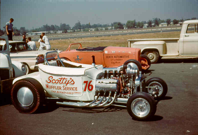

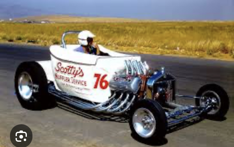

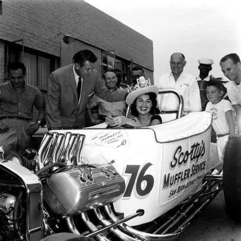

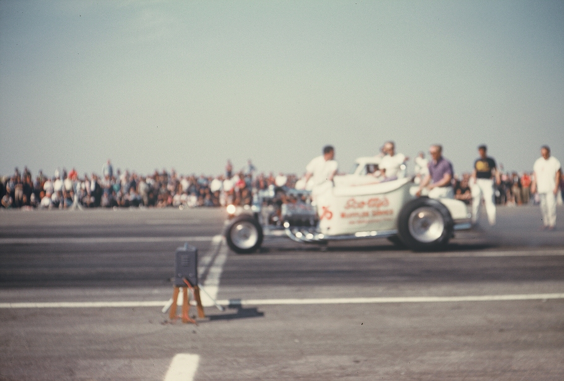

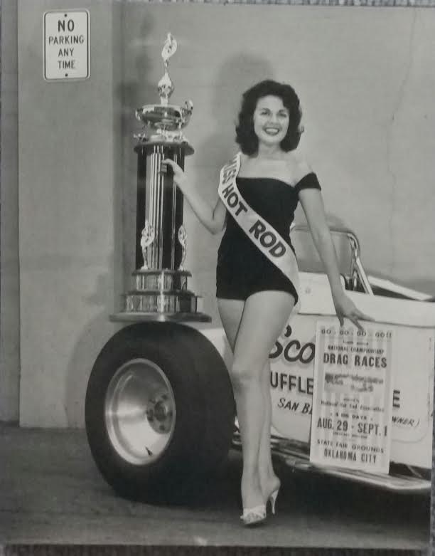

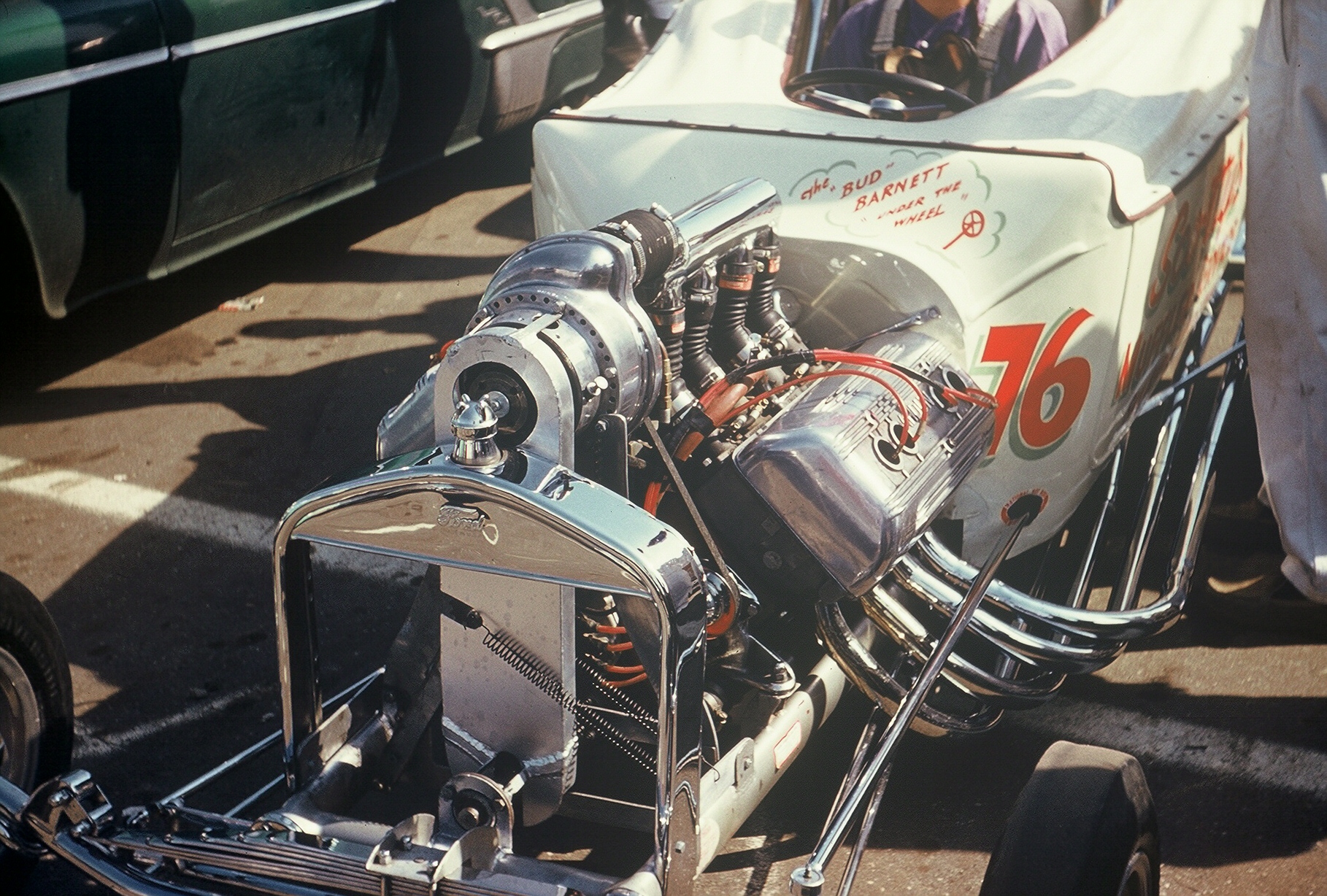

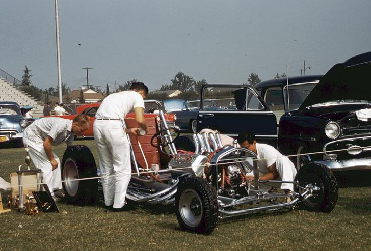

    Its always been one of my favorite cars, so I have saved a bunch of pictures of it. Here's what I found so far.
    You may have already seen these but they are cool anyhoo.
    Mick scottymuffler@show1.jpg ScottysMuffler&TrophyGirls.jpg scottysmuffler1.jpg scottysmuffler2.jpg
  12. lurker mick
    Joined: Jun 1, 2001
    Posts: 2,968
    lurker mick

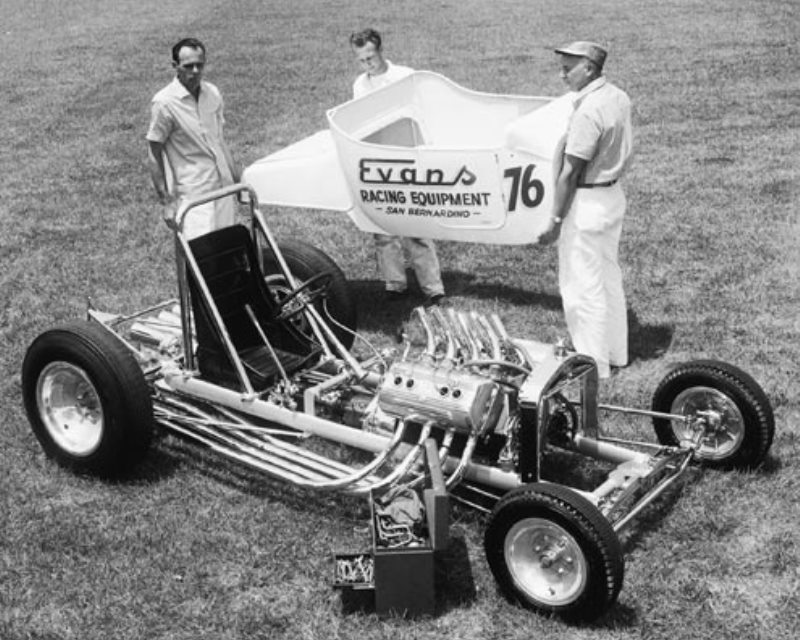

    Some more
    Mick
    ScottysMufflerOnRun.jpg scottysmufflerrdstr.jpg scottysmufflerrdstrardun.jpg

    Even more.
    Mick
    ScottysMufflerT&Model.jpg ScottysMufflerT-1958.jpg ScottysT-RoadsterOnTrailer.jpg

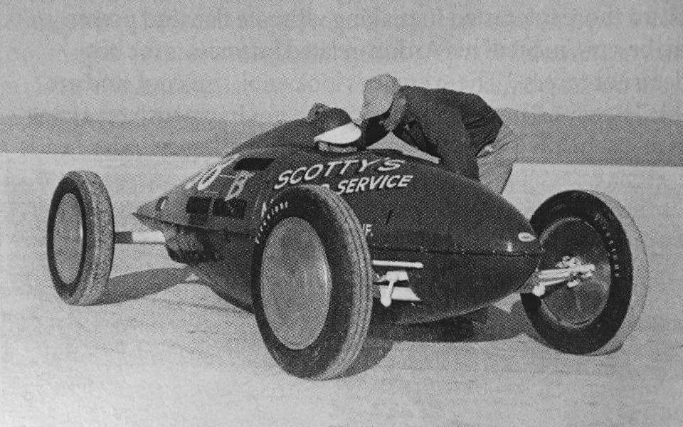

  14. Stan Back
    Joined: Mar 9, 2007
    Posts: 2,719
    Stan Back

    The oval tubing may be a problem. I would contact aircraft supply companies that handle restoration structural supplies.

    I talked to a steel manufacturer in Louisiana yesterday that said they can make it but it’s 3000. Minimum to tool up for a run and then they are 8 weeks out.I have a guys number in Oregon that says he has a couple old damaged PBY struts that may be viable still. I’m still tracking down suppliers for the tubing.

  23. Awesome will be following along.
    Ken Crawford photos
    @hudsonjoe49 Got any PBY Struts?

    For the tubing, there are airplane junkyards in SE AZ that might be a source.
    I don't know your skill level, but it might make more sense if you haven't scaled the pictures for measurements to build a wood frame and hang the components first, then once stuff is positioned in place, fab up the real frame.
    You might want to try to set up the pics in one folder showing it by time, too since it went through variations.

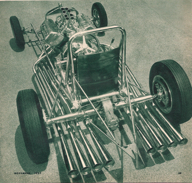

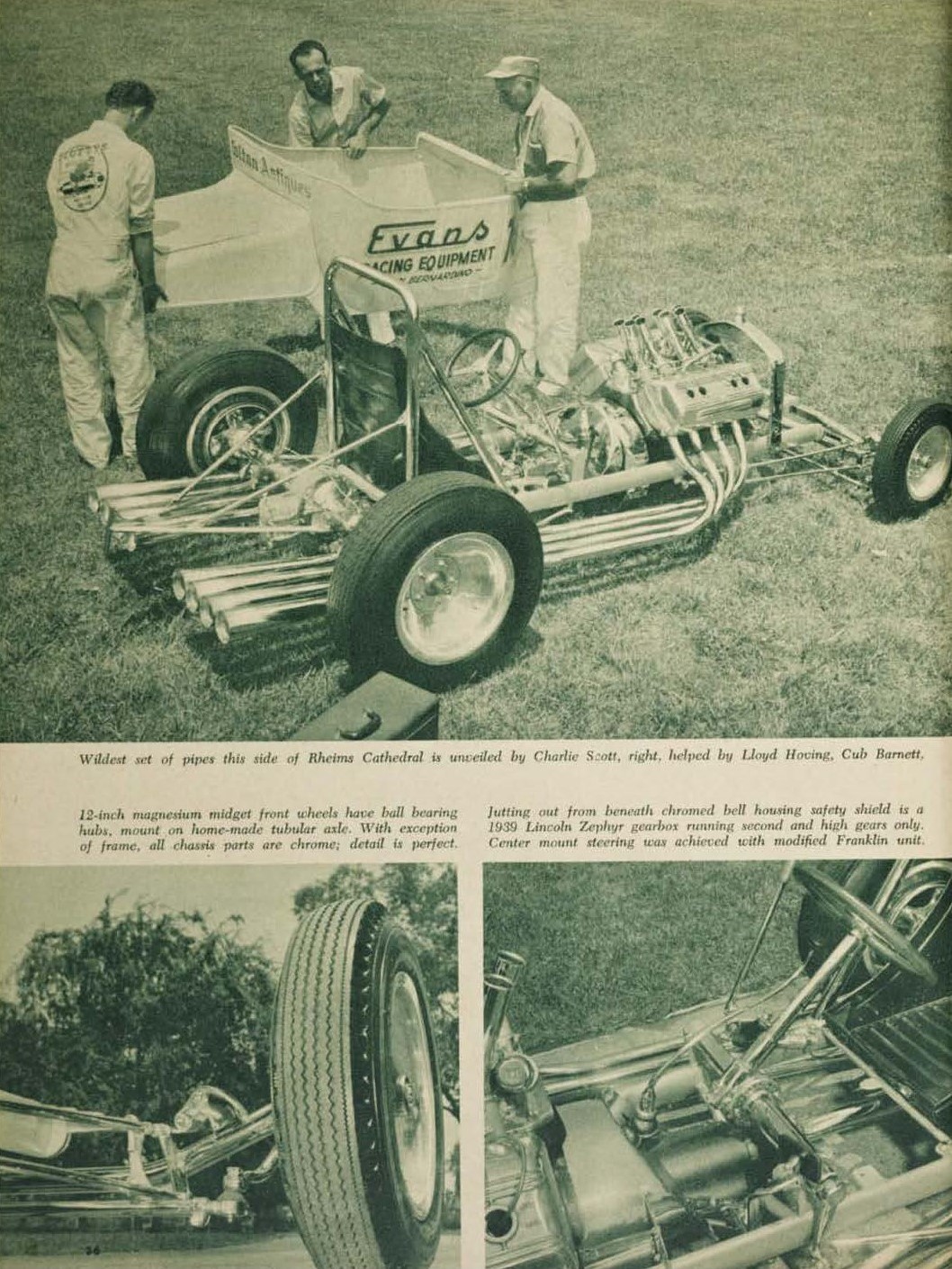

    November 1957 Hot Rod Magazine:
