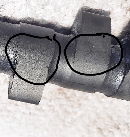

    Well I’m not an expert but have been involved in the manufacture of camshafts. This cam was manufactured from either a casting or forging and not billet. A crack could have started and/or propagated as the result of a straightening process during manufacture. The crack maybe the result of poor heat treatment/quenching and went undetected. The other possibility looking at the lobes closely is “grinding burn” resulting in surface cracks due to insufficient coolant during final grinding of cam profile. At least a couple lobes look su****ious. Cams I was involved in were all Magna-fluxed as a part of final inspection.
    Of course a lot of factors are unknown such as manufacturing process, heat treatment, cam material, post manufacturing quality procedures, etc. Not pointing the finger at anyone but in my opinion a camshaft never turning a rpm in a running engine shouldn’t fail unless mishandled or damaged after manufacture. My opinion your mileage may vary!

  3. That is bizarre ... I can't imagine a cam breaking right through a lobe like that unless it was due to a manufacturing defect. Only other possibility (in my mind) is the cam was dropped at some point. No way (again ... in my mind) that it broke like that just from turning it in the block, even if something obstructed its ability to turn. Basically this, if the cam was well made and not dropped, I honestly can't see it breaking where it broke, just from turning it in the block, obstruction or not.

    wow that looks like a cam blank problem...after close inspection I don't know if I would have even installed it in the first place but I do lots of things I shouldn't too trusting in the manufacturer/supplier
    the porosity is what concerns me

    My guess would be that it was dropped or mishandled in shipping that caused it to crack most of the way in that spot.

    But I agree with the first paragraph above. That looks to me like an unfinished, raw, "blank" cam. Shouldn't the lobes be ground to a profile with a higher polish than that?
    If there was no clearance because of oversize lobes, that could snap it like a chicken bone in a single rotation.

    That finish treatment is know as Parkerizing, it’s done in an acid bath to put small craters on the lobes to hold oil to aid the cam to lifter break in.

    That cam has all of the appearances of being welded. The left lobe on the heel and the right one on the toe. Notice the differences in color at the weld parting line. Notice the small pits at various locations. Welded lobes if done properly will be as good or better than original. Isky had ones in the early days he called "Hardface Overlays". They stood up very well.
    There are several methods for welding cams both for racing and plain damage repair. Most work well.

    Welded lobes, well if they were, then they were done by ISKENDERIAN. I open the cam out of the box and plastic bag,before I installed it into the flathead
