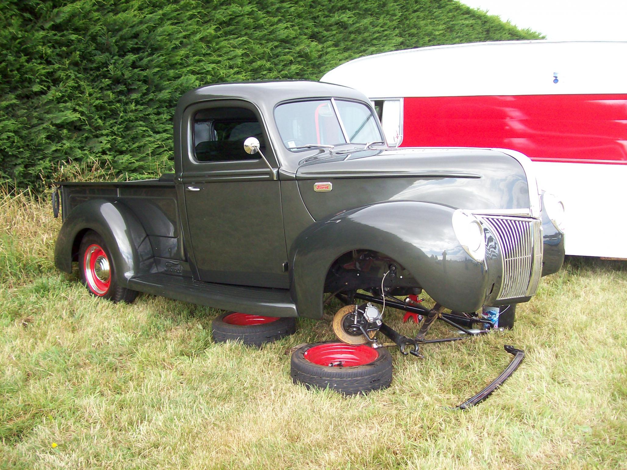

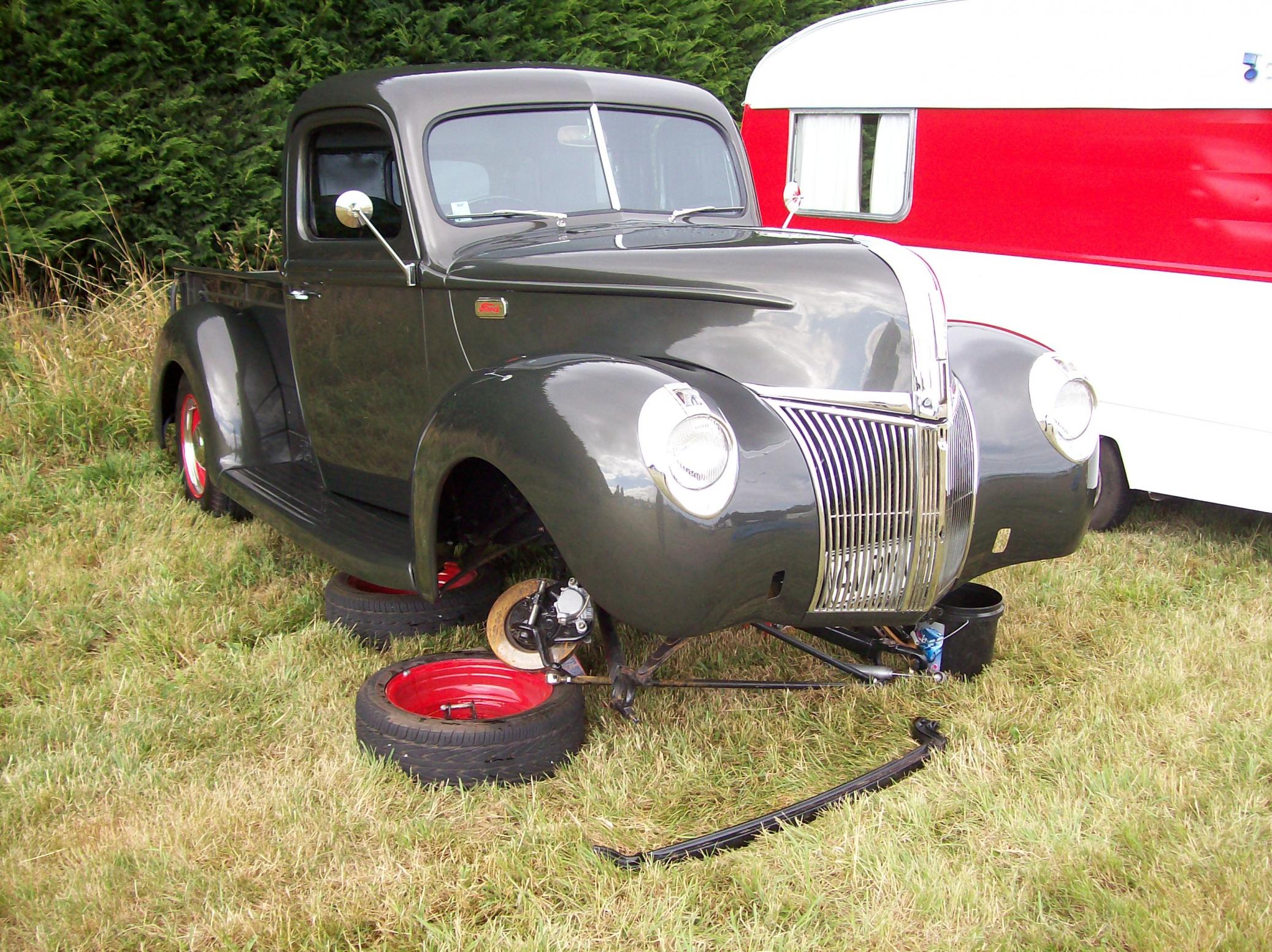

    In both cases they were new or near new axles. The one in the Australian car (36 ) was NEW and the one in NZ ( 40 pickup) which the thread was started with had only done 300kms, that's less than 200 miles. AND it uses a stock wishbone , unsplit!

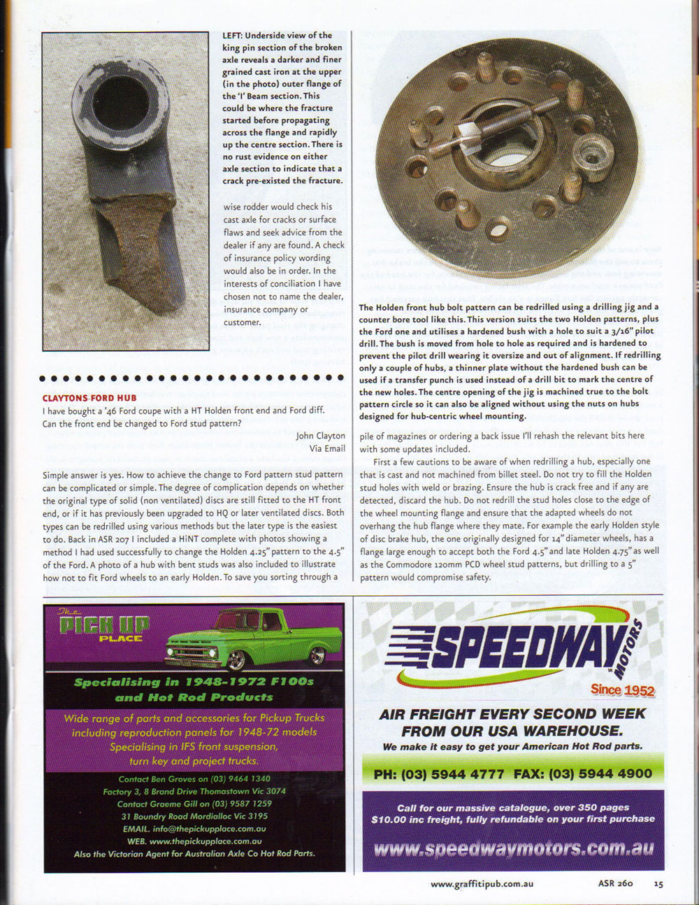

    From the above image:
    "The axle is not branded with any manufacturer's name but the name on
    the invoice is a recognized USA brand that will also get you an ice cream
    at any milk bar..."
    There is a Magnum ice cream, now available in the states.
    http://www.delish.com/food/recalls-r...ice-cream-bars
    Never heard of Super Bell or Socal ice cream.

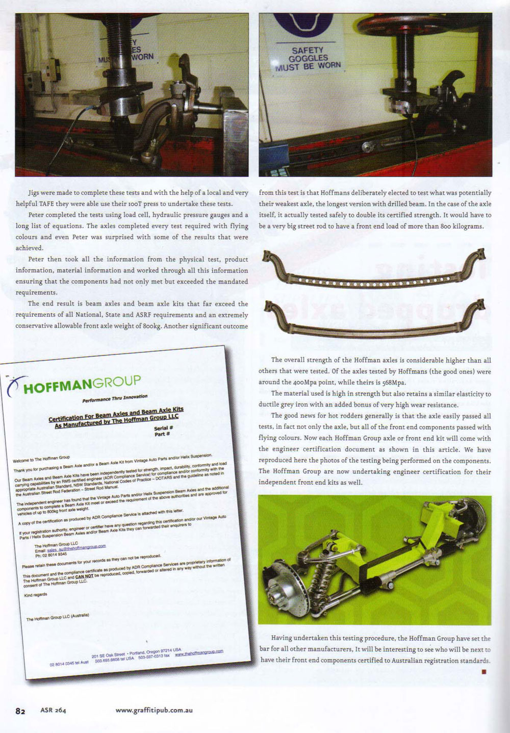

    Here is the second page of the ASR magazine article.

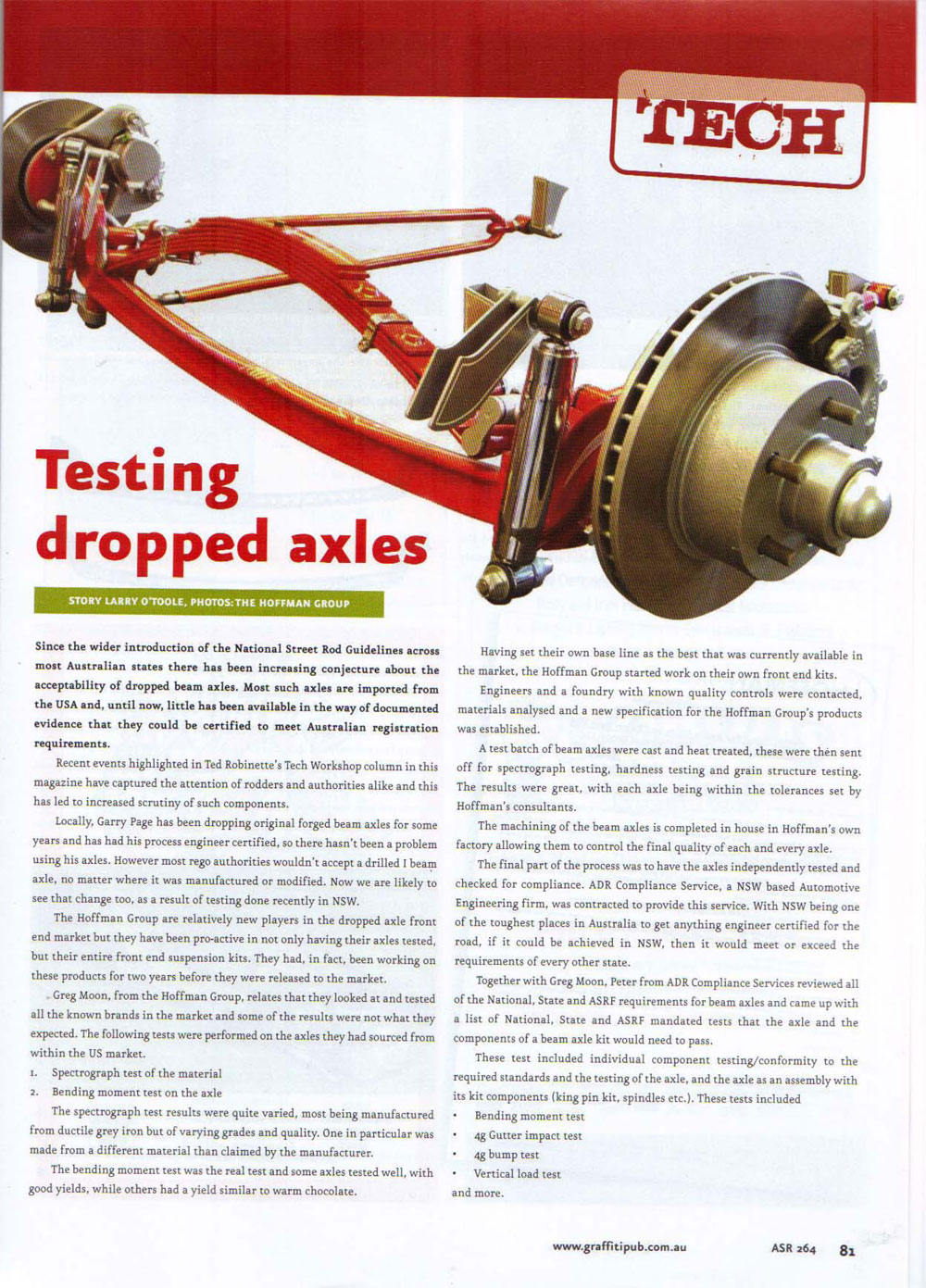

    There has also been some work done by the Australians on testing axles. Here is the article.

    Pretty sure Helix is part of Hoffman and the article you posted on testing the axles said they are cast and heat treated.
