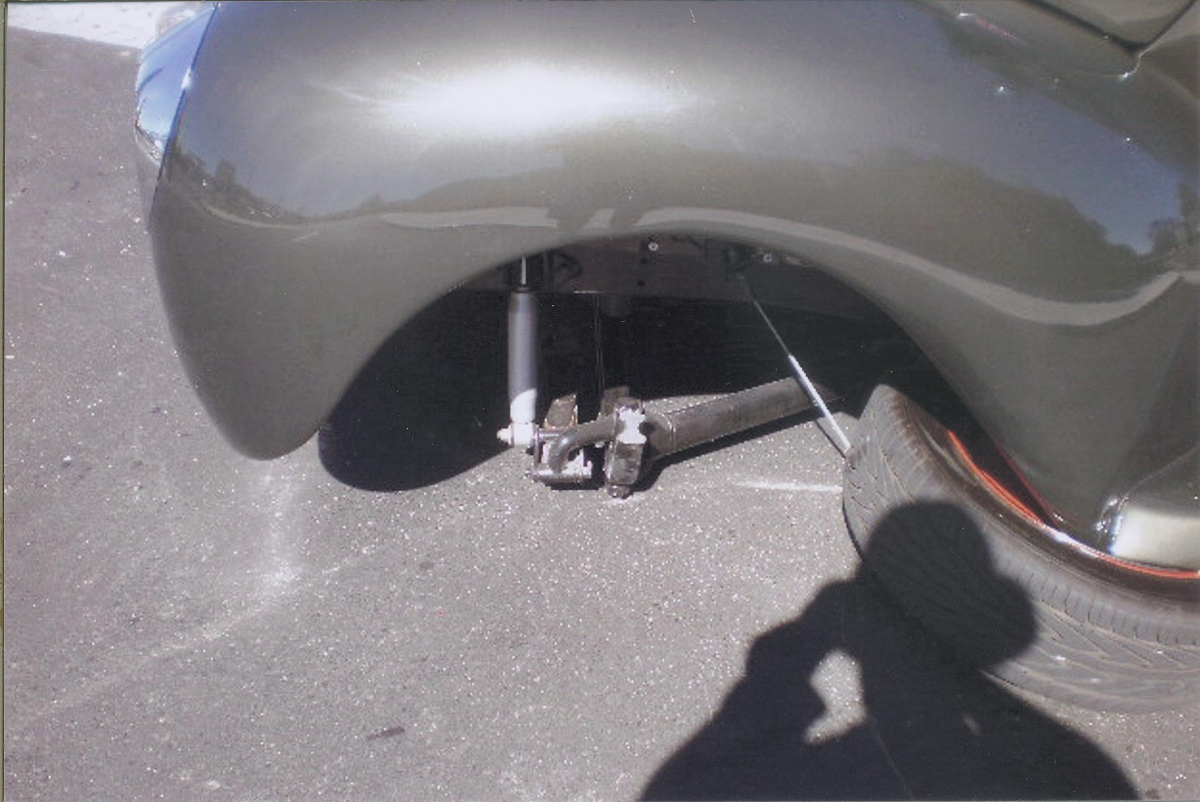

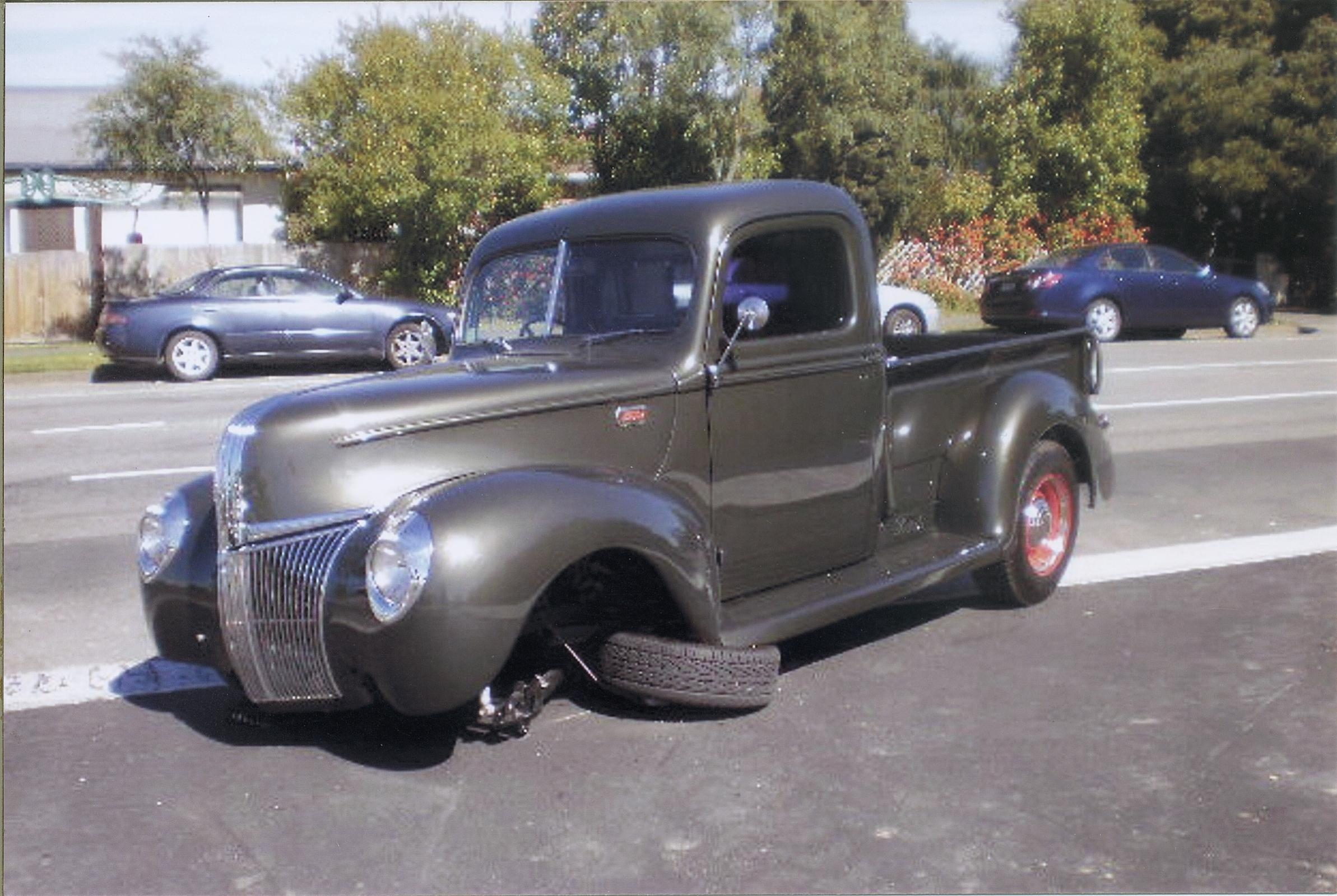

  19. hotrodkiwi
    Joined: Jul 3, 2006
    Posts: 69
    hotrodkiwi
    Here are a couple of pics of the pickup from when the axle broke.
    kiwijeff likes this.
