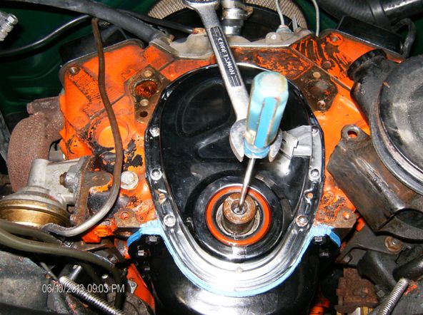

    I hope your right about not being stuck, I ***umoed it was stuck since I seated it being as I run it in until it stopped. I didn't put a lot of force on it but it is inside about a half inch or so. It seems like if I try to drill that far in I stand a chance of messing up the treads. I'm going to pull the balancer off then I'll try to get it to back out being very carefull I sure do not want to pull the motor. NAPA said they would give me a new tool as I would need a way to get it pressed on.
    Thanks

    If you bottomed the end of the adaptor out in the crank snout and twisted it off, they it's probably stuck (pressure still on the threads). If the adaptor shoulder bottomed out, the tension released when the adaptor broke and it should be handy.
    Have you tried to unscrew the adaptor out of the crank by hand? Both of the adaptors that I've broken off in cranks screwed right out. Didn't have to drill either one of them.

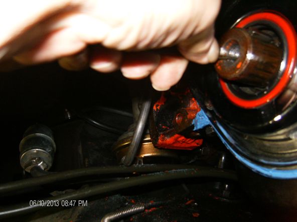

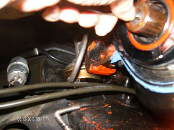

    The adapter is inside pretty far at least a half inch. I'm going down to the garage in a few minutes to take the balancer back off. I thought about an engraver I have if I could take my time and put a little indent in the end of the adapter, with a small screw driver I might get lucky and get it to turn, at least I hope so.

    Try using the eraser end of a pencil to turn it out before you do anything else (even pulling the balancer). If it doesn't work, go from there.

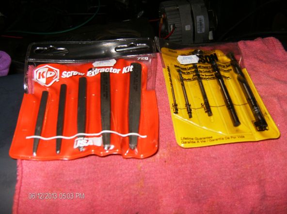

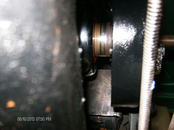

    From the pics that needs left handed drill bits. Use a piece of pipe or sleeve as a guide for the bit as suggested earlier.

  7. I wouldn't try it .
    I have seen the pics, and fully understand what you are thinking- no don't try it. Things are bound to get worse and if you screw up what left of those threads you'll never get the busted part out.

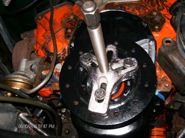

    I pulled the balancer off this evening, didn't have to hold the flex plate but the adapter was really tight like 31Vicky with a hemi said it would be.
    I took the advice and went slowly, used three left handed bits with the smallest then worked up two more sizes going back and forth. I was able to drive a flat blade screw driver in the hole really snug, tried hitting and turning but so far it hasn't budged. I thought I better let it sit over night so I wouldn't break anything else.
    I think it would have been a bad idea to leave the broken adapter in the crake and use a shorter bolt. I come in the house an the computer was messed up again it's always something. If I get it out NAPA said they would give me a new tool, I hope the same thing doesn't happen again.

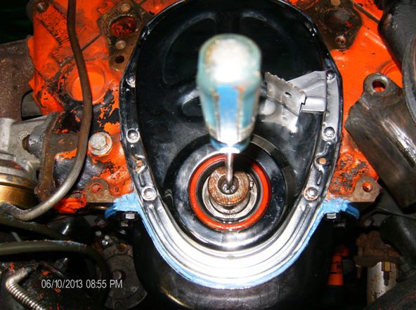

    I put WD 40 to soak while we were gone now this morning I’ll try again to work it out. I started with a left handed 5/64 then 7/64 then 5/32 the 1/4 I thought was too big, I didn’t want to take a chance on messing up the threads.
    I magnetized a flat bladed screw driver but it was too big to drive it in the hole I drilled, (that was not easy with the bad arms), so I used a skinny flat blade. I know I will break the skinny screw driver if I put too much torque on it. I might try to get the hole all the way through by taking my time and using the WD 40 to keep the bit cool. I have got this far and sure don’t want to mess up now. The machinist did say also like mentioned above that the early small block Chevy’s did not have threads inside the crank.

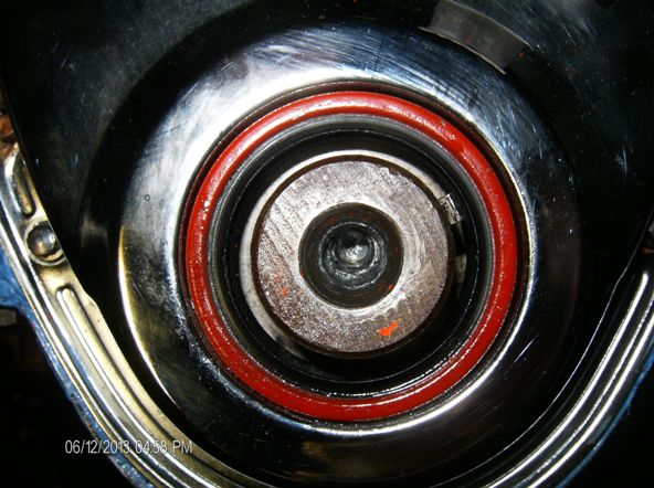

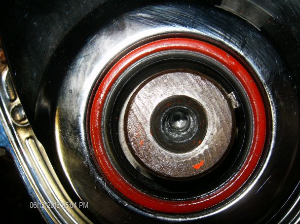

    I took your advice and I haven't broken anything or got into the crank treads the best I can tell. I had these tools since the broken bolt in the 41 Plymouth head.
    Do you or anyone know about how far the threads stop at the crank? From the front of the crank it looks like I have drilled 1 1/8 inch. Judging by the next size of adapter that total length looks pretty close.
    I had to stop before I got carless and tore up something. I'm real close to the threads with the 1/4 inch bit.
    If anyone has anything that would help let me know. The next thing is I'm not sure the oil leak is fixed, we put a new one piece gasket on plus a new timing cover with the new seal.
    Thanks for the help to all

  26. maniac
    Joined: Jul 11, 2005
    Posts: 539
    maniac
    I say drill it in more, don't worry about the crank, you won't hurt it if you drill into it a fraction, going in all the way WILL release the tension on it, go in with the smallest bit and work up from there, the more of the adaptor you dril away the easier it will come out.
    Remember to keep the bit lubed up.
    If you changed the pan gasket,cover gasket and front seal, you should have the leak taken care of.
    I have put on balancers with a big hammer and a piece of wood, not the best way, but it worked

    Well I hate to give up but I don't want to damage the threads inside the crank. I worked up to the 5/16 left hand bit without breaking the adapter loose, and the bit went through to the crank without any damage. I was getting real close to the threads at the top it was a little off center, so I would not be able to use the next size bigger bit.
    I talked to a mechanic friend of mine and he will finish the balancer, and I will put the rest together. I never want to say uncle but what it will cost to pay to have it done right will be worth it to me, I've spent way too much time an effort on it now. The threads more than likely will have to at least have a tap run through them. I will see if Napa will refund the cost of the tool instead of replacing it.
