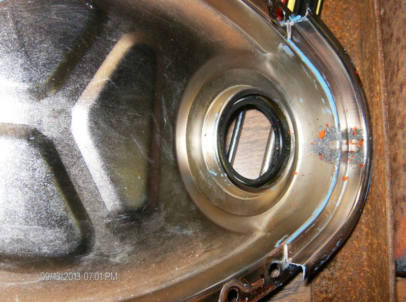

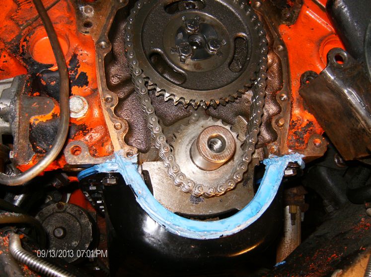

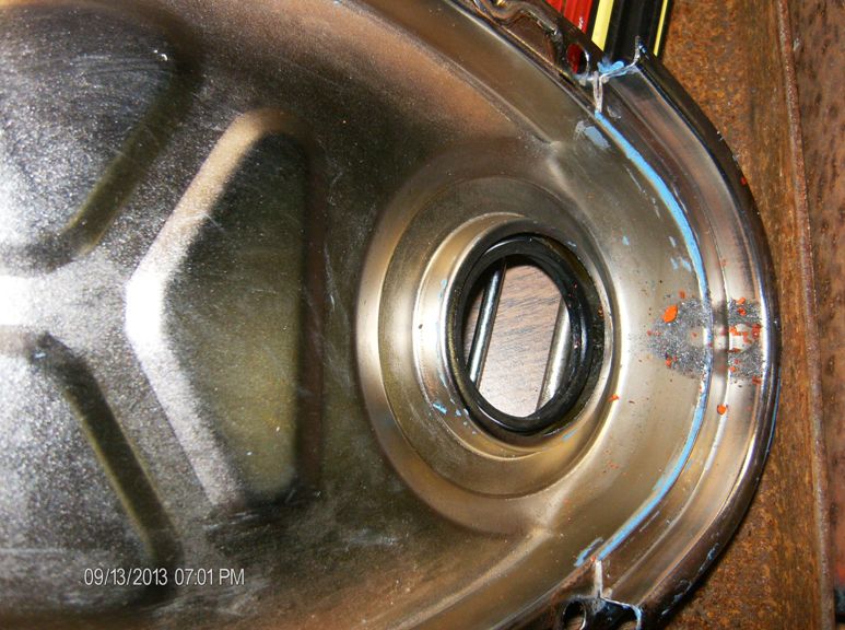

    I need some advice, I have a new timing cover I was going to put on the 350 engine. I drilled out the broken adaptor tool trying to put the harmonic balancer on but bits of metal got behind the seal when I would flush the bits of steel from drilling. I took a magnet to get behind the rubber part of the seal. If I can get the seal out, vacuum inside, do you think it would be safe to put a new seal in without going to all of the work to get the new timing cover on.
    Putting the new aluminum cover on was my plan but after having more medical problems I would like to be finished with this job, the sooner the better.
    I would hate to leave bits of metal behind the timing cover, and if I could get it all out it would save me more work.
    Thanks
    Custom50

    When you were working on it did you have it jacked up just in the front ?
    Did you spray a bunch of cutting oil on it when you drilled ?
    I would say if yes for both than it would be better to remove the cover.

    Salflats,
    Yes I had the front end raised up, I didn't think to block off around the seal.
    31Vicky with a hemi,
    I just put pictures in the computer, my instincts said not to do it. Along with you guys we were all right. I could never have gotten the metal out from the bottom of the timing cover.
    Now when I can get back to it, I have a new aluminum cover with a seal already installed. I know I ihave to try to get all of the dried silicone out, I have the bolts loosened so the pan would drop down.
    Wish me luck because I sure need it.
