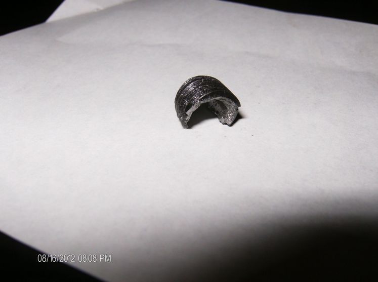

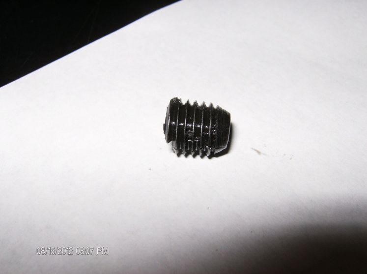

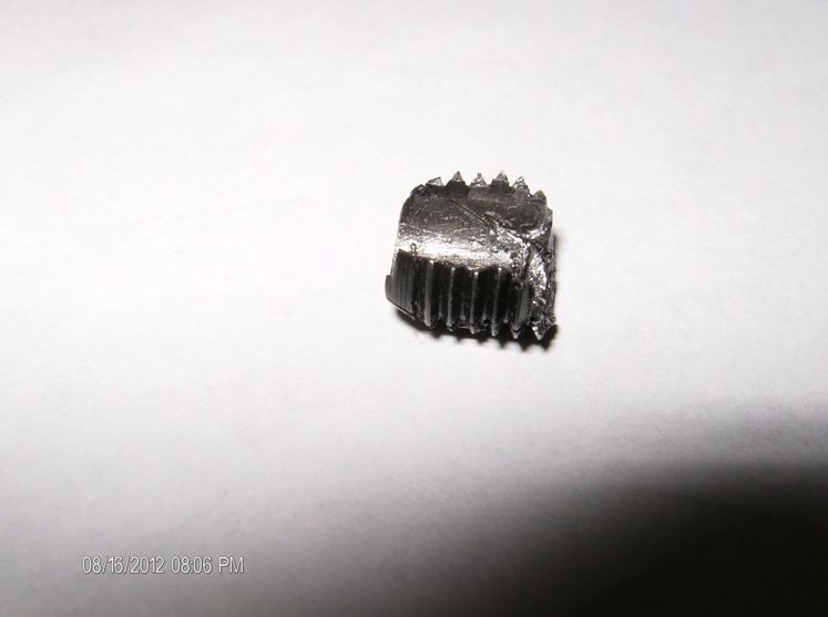

    I was not able to work on the car today, hope to get back on it Monday or Tuesday. I did what I do best today sit on a riding mower and cut for 3 1/2 hours.
    cb1,
    I couldn't believe how easy the adaptor was broken, looking back I think most of it was my fault.
    txturbo,
    I started with the left hand bits going up to the largest size I had. Then I used regular bits, it took a long time but it came out without damaging the threads.
    40FordGuy,
    When I finished I was able to run a tap all the way though, and the bolt went in fine.
    This is what's left of the adaptor.
    Thanks
