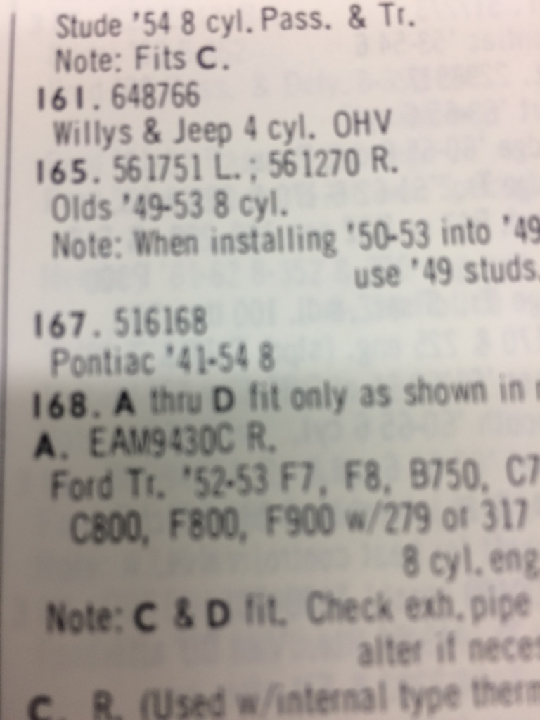

    Hollander interchange manual says 1941-1954 are the same
