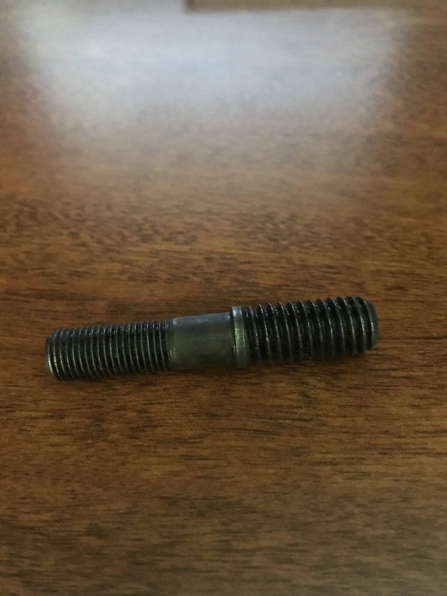

    735DE3CD-23B7-4600-8AC5-6D391F763728.png A8F15E39-7130-4A99-8D59-C897101E32D5.jpeg I can’t speak to the durability of studs produced today but when I was still employed I Rockwell tested a Dorman stud on the C scale and it was 37-38, equivalent to a G-8 bolt.
    The Pioneer (and other) studs seen on eBay have a shoulder above the 7/16-14 threads, you screw the stud in until the shoulder butts against the head and give it a bit of torque to keep it in place. I never had trouble with any I have run and never had a comeback on those I did for others. Would I use them with a big, radical cam? No, but for the street and an occasional blast they are fine.
    The Dorman stud in the screenshot has the right threads and the threads are the correct length but it looks like there is no unthreaded area for the rocker ball. I may have overlooked it, but this was the only Dorman stud that I saw with the correct threads. The Dorman’s I bought BITD and Pioneer’s sold on eBay have a 5/8” area for the rocker ball giving an overall length of 2 1/4”.
