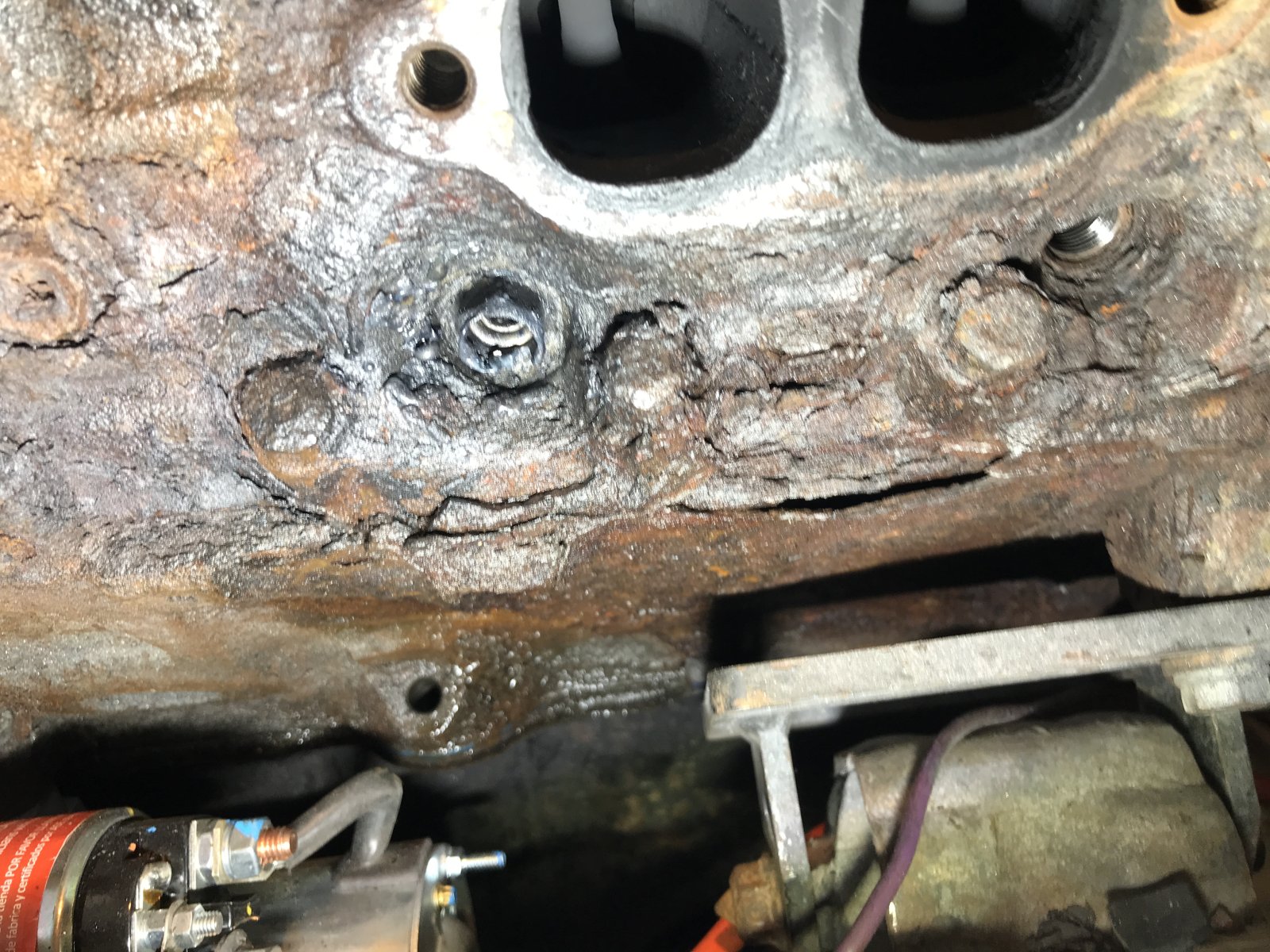

    This is the situation, the broken plug is under the left hand exhaust port bolt hole....It is a mess..Plan is to plug the plug shell hole with wax,then grind the shell remains back as far as possible....Then have a look to see the best next step...
    This will come out.....I have fixed worse ****..... 78AAA479-004D-42B1-9F91-466EFC62EF3E.jpeg
  25. Holy carp!! I've never seen one that rusty! Good luck!!

    427 sleeper
    I just puked in my mouth, a little... :oops: I'm all for trying to save good parts, but that might be just a little too far gone. Were it me, I'd burn or grind the bottom row of bolt head's off and replace the head.

    How long was that submerged ?

    That is epic! That whole engine looks like it sat in the ocean for a few years.

    That is U G L Y!
    I'd grind the rust away with a die grinder and an acorn bit so I have bare metal to weld to, stick a big bolt in the hole, use my MIG to weld it to what's left of that plug and use my impact wrench to blast it out of there why it is hot.
