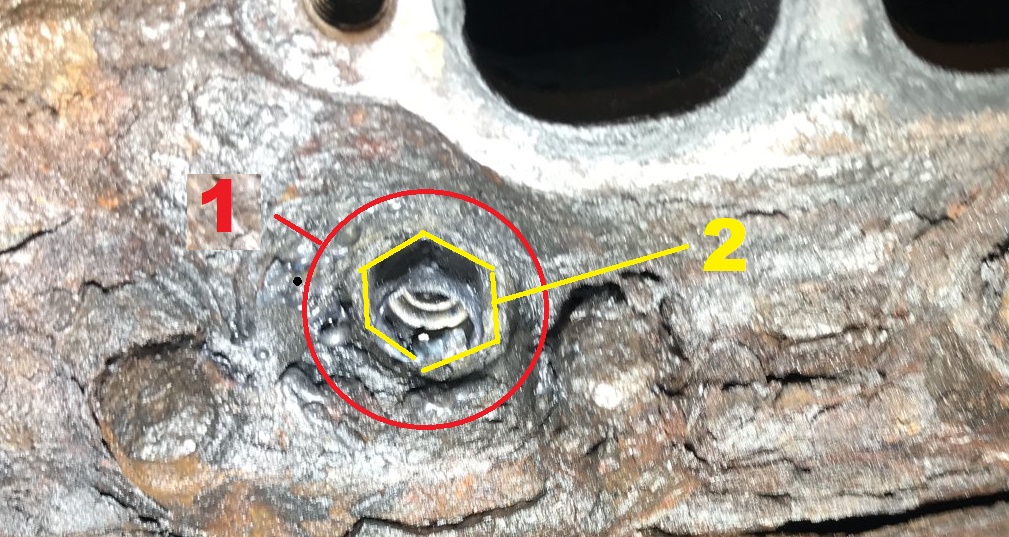

    Use a pneumatic needle scaler to clean the area around the plug, then get your chisel out to collapse the thin sheet metal shell, as I said before.
    Once you clean the scale off with the needle scaler, it won’t be so intimidating.
    Sounds like some of you guys don’t know what a plow truck is, much less have ever worked on one.

    I had the same problem on a ford 460 engine. A shop broke a plug of a left just the metal threaded part broke off. They wanted to charge $1200.00 to fix it. I turned the engine over to top dead center and kept P.B.Blaster on it for a few days. I used an Easy out from Harbor freight that fit perfect. I tapped it in snug and heated it several times with a propane torch and attempted to remove it several times while it was hot. It finally came out. I saved my dad (his truck) a lot of money and a big headache. Good luck and be patient.

    I have drilled out a plug that broke below the hex then just unwound the plug threads. As mentioned above, I am not even sure head removal is an option here. That is one UGLY mess and I wouldn't even think of proceeding without first spending a week or more with a needle scaler.
    I will say this, I have seen a Pontiac 301 where the head rotted through above an exhaust port. There might not be much left after you go at it with a needle scaler. Have you ever watched a rac**** wash a sugar cube :D

    I'd air chisel the **** out of the #1 circle, then the #2 would get a grinding to sound metal enough to weld a plate to all around. Then I'd die grind it down on the side, slide a 13/16 six point and impact it off.

    Ha, With beewax in the plug center hole. ....First a chisel to remove the mess then a large burr to clean the area and actually see the plug shell near the seat in the head. Ok , now we are getting somewhere....Then I was chipping off rust by hand with a long screwdriver when a stream of coolant came from the head above a lower head bolt .The ****ing head has a rust hole! The core plugs look rusty.......Gotta pull the engine...Oh well.........

    Then again some of us do and have. What happens when you blow through the casting with the scaler???

    Is there a cylinder head in this picture?

    You buy a new head.
    Actually, you probably buy a different engine at that point, as your “good running engine”. Isn’t a good running engine at this point.

    Man! That is one rusty engine! I think your only hope is to clean the area and the old plug and weld a nut on it. One other thing, folks have mentioned blowing air out through the plug hole to keep debris out of the cylinder, by putting an air compressor hose in the carb. Most air compressors have high pressure, but low volume of air and this cylinder will probably share an open intake valve with other cylinders. Might want to try a vacuum cleaner that has the blower option and duct tape it to the carb and turn the engine untill it intake valve is open. The vacuum ckeaner has low pressure but high volume! Might work! Good luck!

    you are gonna have broken pieces of the plug in the cylinder ..when and if you get it out ...

    He already stuck a fork in it, it's done. He hit water while chipping away rust!:eek:

    Well, heads toast right? So burn the outer head bolts off, hope that the ones under the valve covers cooperates with you, and take a gander inside.
    I’d guess but what was said, packed mud and snow sitting and leaching for months at a time, took its toll.
