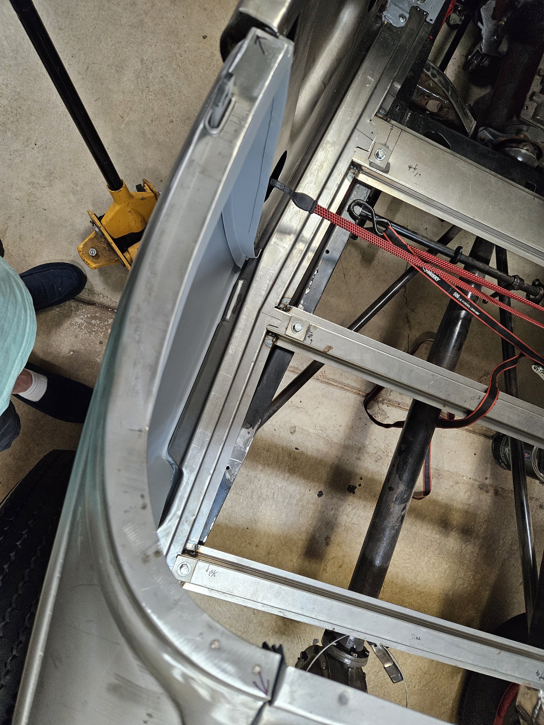

    I am installing my Brookville rear quarters and i have a question. In the photo I have marked arrows at two outside points. One quarter measures 28 1/2" point to point and the other measures 29 1/8". Anybody know what they should measure?

    That’s one of those places where measurements don’t really matter. Make it look right.
    Too many curves happening in a small area to be concerned with making them match. If one side has a big bow in the outer surface just because you pulled it in so it measured the same as the other side, it would look horrible.

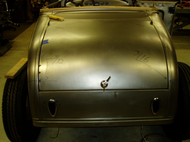

    P1010004.jpeg P1010005.jpeg I had several alignment problems. I had to drill out right 1/4 panel lower bracket and pull panel in about 3/4”. I measured on diagonal to fit.
    Had to pie cut one side of trunk lid.
    On left door I drilled rivets for inner and outer panel. This let rhe door flex and I fitted gap at rear and drilled holes for sheet metal screws. I am sheet metal challenged,so I got help from Brookville and others.
