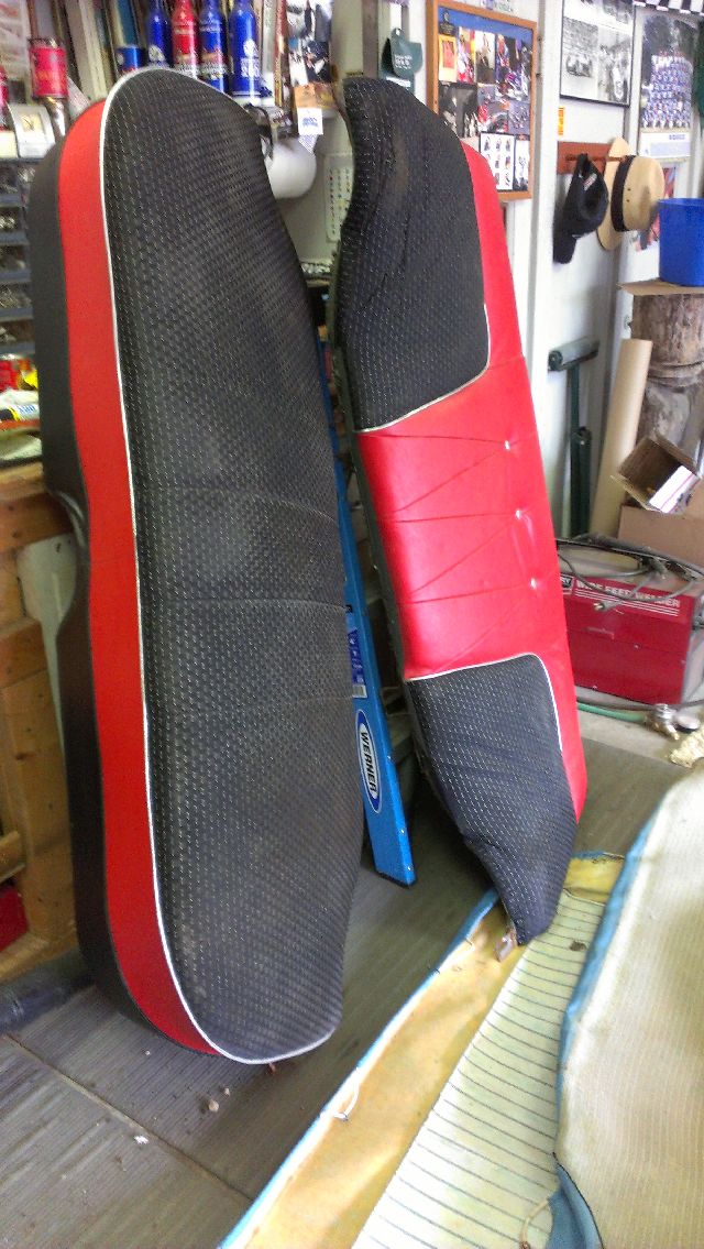

    I removed the seat covers that protected the seats over all these years. Seats still need to be cleaned but all I could do was stand back and say WOW!

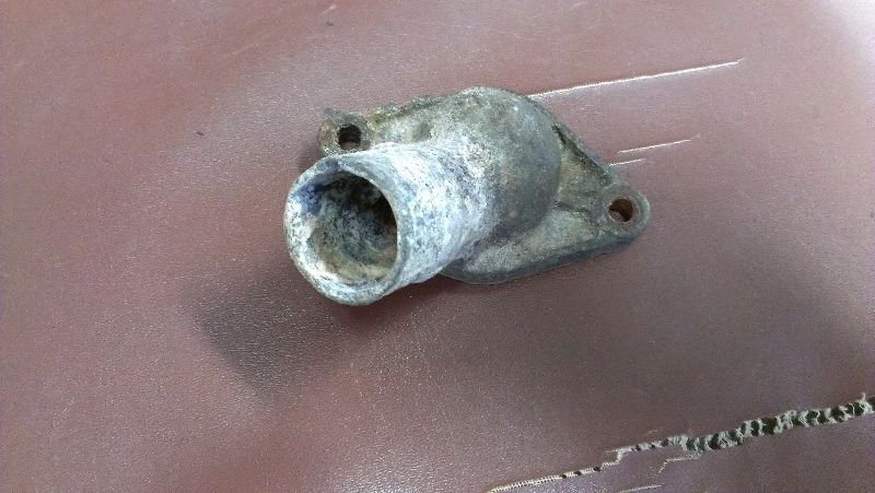

    The belts and radiator hoses have been removed to find the coolant outlet on the top of the engine completely blocked with what appears to be white aluminum oxidation debris. The coolant neck is aluminum and was covered with that white powdery oxidation. When I went to remove it the heads of the bolts just snapped off. Not the first bolt that has snapped off on this so far and I'm sure not the last. Easy outs & a good tap & die set are a must for this kind of project.

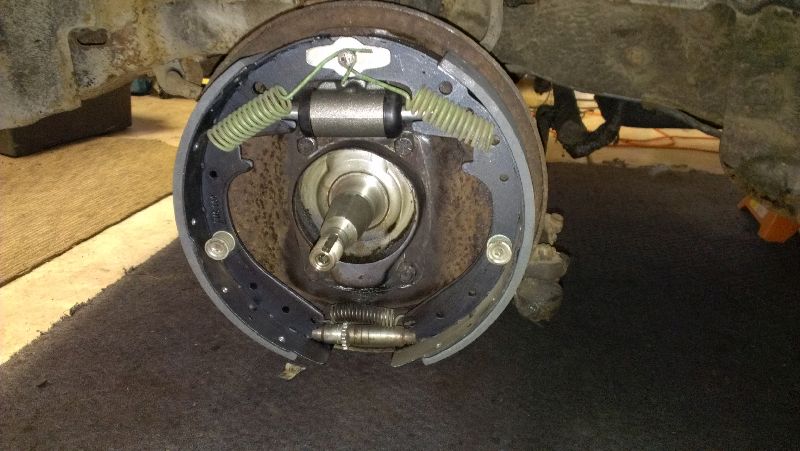

    Started working on the brakes this weekend. I already got the drums turned for the ridiculously low price of $7.50 per drum. Who does anything for $7.50 these days?

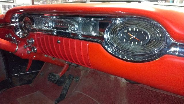

    More interior photos for you.

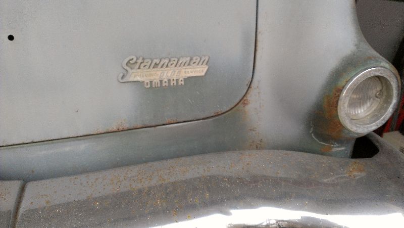

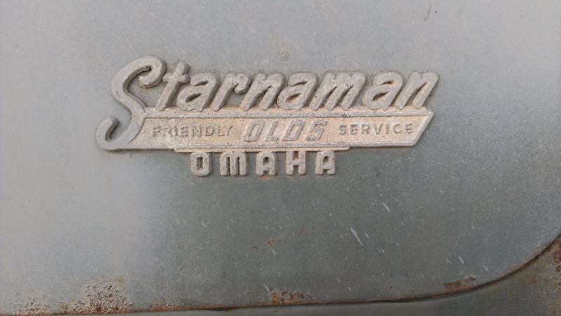

    C10, where did you get the info about Starnaman Olds in Omaha?? I have been in Omaha since 1960 & never heard of them. maybe they went out of biz before I got here.
  29. C-10 CST
    Joined: Jul 4, 2011
    Posts: 267
    C-10 CST
    from Indy
    I got the information right off the trunk lid.

    I replaced the thermostat housing. I originally painted the new one that Rustoleum Hunter green and it looked like I painted it John Deere green, it looked ridiculous. So I repainted it satin black. I don't think anything is going to match or blend in with that rusty old engine but the fact that it won't leak and has a new thermostat under it is good for me.
    Brakes shoes and wheel cylinders are installed, now I need to get all the new brake lines installed this weekend.
