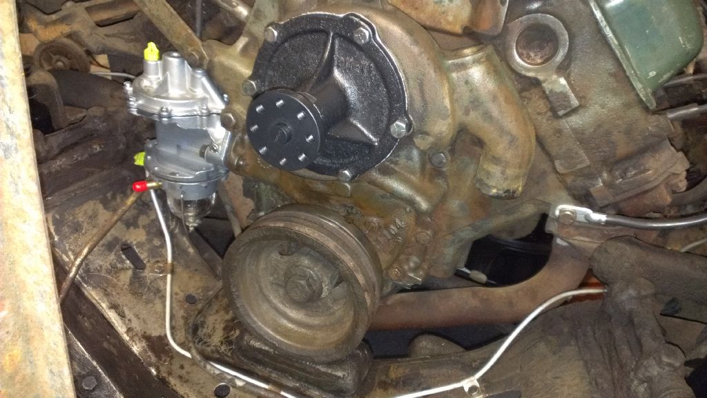

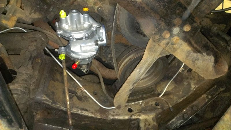

    I went ahead and ordered a rebuilt original fuel pump from Fusick. I have mine off & ready to ship back to them to get my core charge refund.
    Looks like I have some time to get those new brake lines & fuel line installed while gas tank & radiator are being repaired.

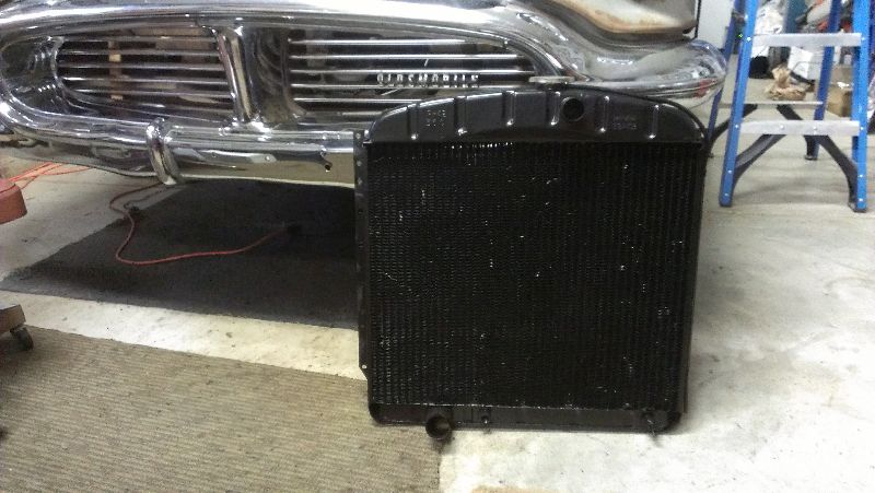

    I got the rebuilt fuel pump installed & picked up the radiator from the shop. They were able to save the radiator and it looks great. It was leaking from three different places. They ended up removing the top tank to clean and re-solder it back on then had to solder a piece to the bottom. Flushed, cleaned, Pressure tested it and painted for only $150.00.
    Stupid me found out the hard way that you can not use the rear wheel cylinders on the front. For some unknown reason no one I found has a listing for the front wheel cylinders except Fusick & they want $49.50 EACH. Everybody lists a rebuild kit for the fronts but no new cylinders. After paying $9.49 at NAPA for the rears I couldn't bring myself to pay over $100.00 for the fronts. I spent some time doing some research online and finally found what I needed. The fronts are 1 & 1/8 inch bore, the rears are 15/16th inch bore. For anyone rebuilding brakes on a 1954-56 Oldsmobile here are the part numbers. These parts might very well work on other years and on the Buick's of similar years as well.

    Radiator turned out great too!
    I also had mine looked at by a local shop, they just had to fix a small leak and redo the overflow tube. Beats buying a new one for sure...

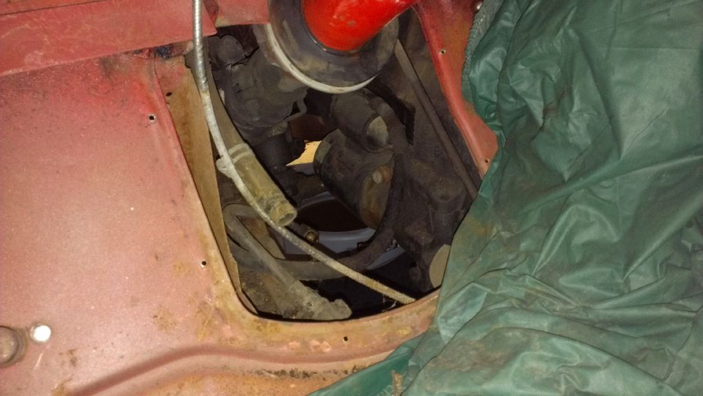

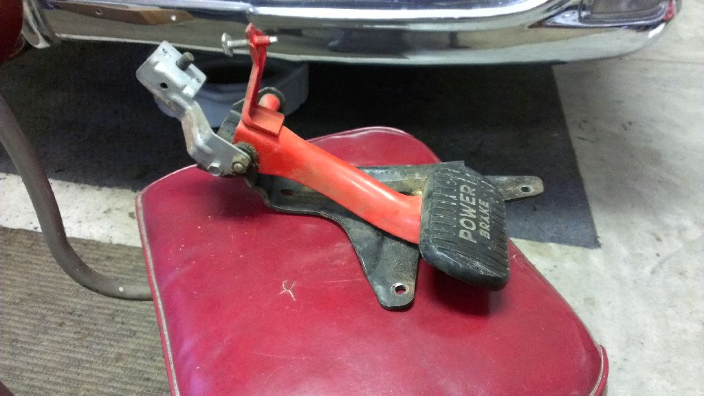

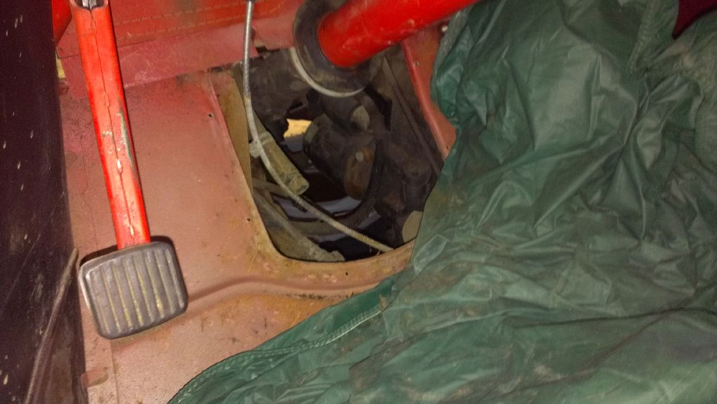

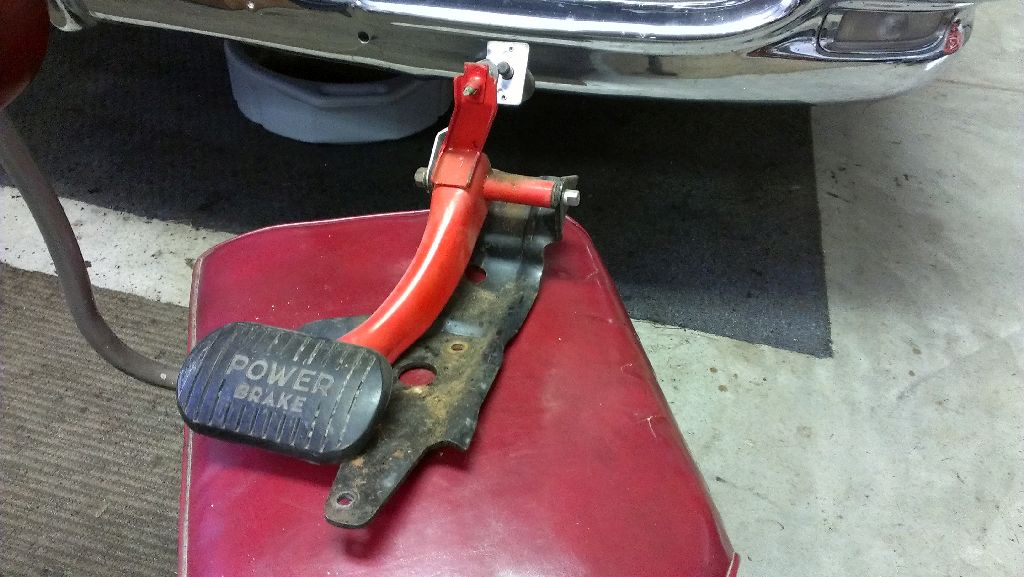

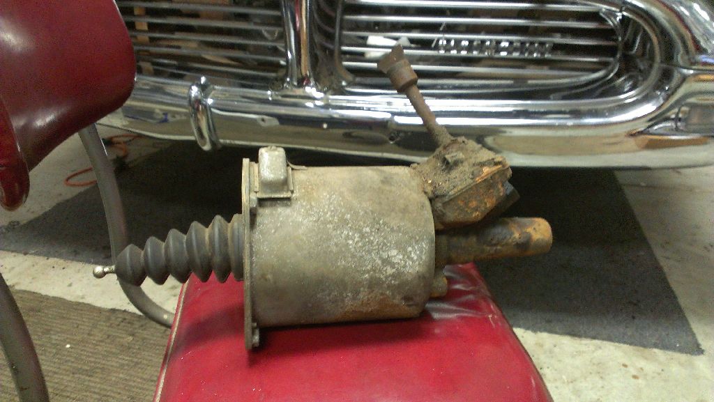

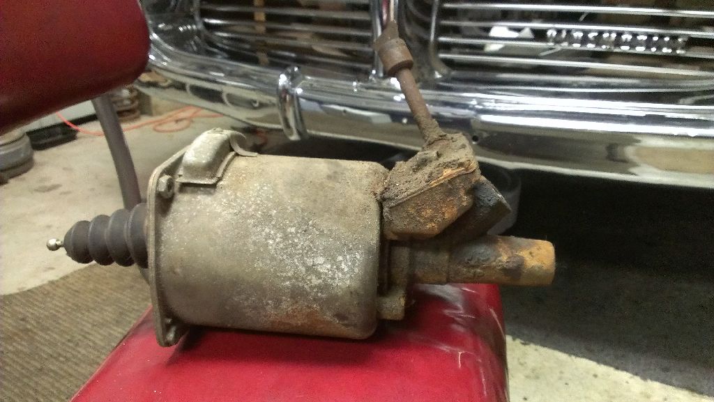

    Watched F-1 qualifying and worked on the car until 3am this morning. Burning the midnight oil on this car is going to kill me one of these days. Decided to change the water pump while everything was off and I had such good access. After getting it off I think it was a real good idea. There was evidence of coolant leaking out the weep hole.
    I also got the master cylinder/booster out from under the car. That's system I've never seen before. The brake pedal assembly pushes directly down through the floor board to actuate the master. First you remove the brake pedal assembly, then thank god there's an access plate under it that you remove to get to the master/booster assembly. It would be a real bitch to have to remove that from underneath. Once again I can't find a rebuild kit for a power master cylinder. You can buy the manual rebuild kit & the booster rebuild kit but no one I've found has a kit for that power master cylinder. The power master & manual master don't look anything alike. So I have it boxed and ready to ship off to be rebuilt by Fusick. With any luck they have one already rebuilt & on the shelf ready to ship out.

    Good call on the water pump and the Master Cylinder you sure don't want to go back in after the cleaning and painting. Brakes are always a good thing to have! I bought a rebuild kit for my brothers 56 power Master Cylinder from NAPA. Now that I think about it that was 14 years ago! Time does get away from me.
