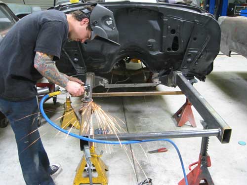

    O.K. here it is the secret is out (Thanks to Nick) So now with his help, some more pics. I have an art post on here somewhere with a idea of the finished project.

    By the way my friend Grant and I are doing this at his shop. I wish my garage was that big and bad ass. His shop is GMP in Santa Cruz . That is him in the pictures cuz I am opperating the camera.

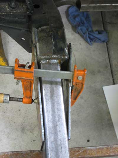

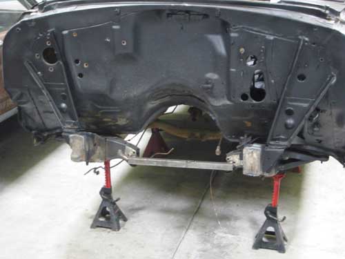

  14. flatheadpete
    Joined: Oct 29, 2003
    Posts: 10,631
    flatheadpete
    from Burton, MI
    You're retarded. This car, on the other hand, is pretty bitchin'. I dig it. What's my post count now?

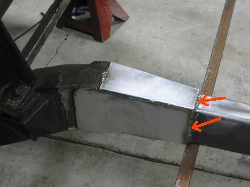

  15. Looks bad-ass.
    One problem I see, though...
    These welds are in a BAD spot... especially with the engine mounts sitting right on that joint.
    Crossways welds on a stressmember... a BIG no-no.
    Just watch for cracks to develop. Even if the paint cracks... that's an indication of failure.
    Sorry....
    JOE:cool:

  19. DeadFast 33
    Joined: Feb 3, 2003
    Posts: 649
    DeadFast 33
    from Santa Cruz
    Joe, Those plates are more for asthetics than anything. Under the 2x4 is welded and gusseted to the old frame. We also tied everything in there kina for that reason. Also there is going to be a piece of 1 3/4 tubing bent under the oil pan from rail to rail to make that are extra srtong.
    But I will keep my eyes peeld.
    FLIP
