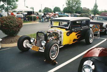

  2. I painted this with Petit marine topside enamel with some stuff in it called brushing compound, there was a website that showed you tricks for getting a smooth surface on the upper part of your boat. I had better luck with a soft brush, the roller didn't leave enough paint on the surface to level.
    One of the tricks I used was thinning the paint with the brushing compound and testing it on a sheet of glass, keep adding the compond until the brush marks disappear in 5 seconds and you are good to go. I only mixed it up about a quart at a time, because it got sticky in about 10 minutes.
    When it's in the sun, it shines like it was sprayed, and you can only see a few brush strokes.
    I'm sure it would work fine for a steel or fiberglass body, and it's as tough as nails, I've powersprayed this thing to get mildew and deteriorating black rubber streaks off of it, and used green scotchbrite to get the tough stuff and it's still shiny.

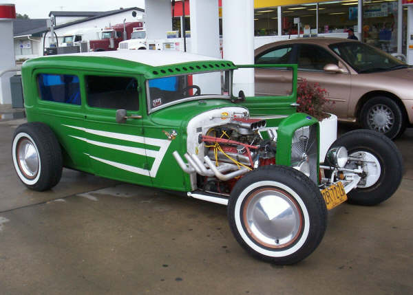

  25. Thirdyfivepickup
    Joined: Nov 5, 2002
    Posts: 6,095
    Thirdyfivepickup
    the thing that bugs me is all of the talk about it taking a month or more to harden... that isn't practical... but the outcome is pretty nice:
