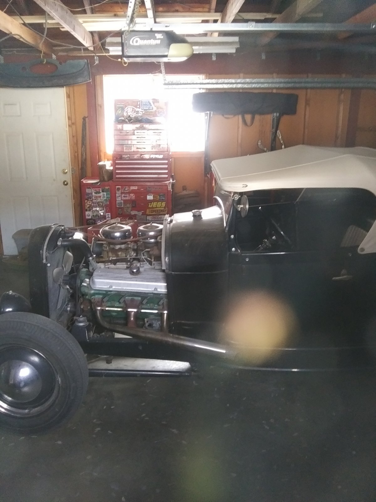

    Mine is brush painted about 13 years ago I believe. It was first sprayed with Rustoleum flat black and then brush painted with reduced won shot pinstriping paint and a real good brush. It turned out really nice and as tough as nails. If you look very very closely when it's clean you can see a small brush Strokes which is kind of cool. I can get some close-ups tomorrow 20220702_163444.jpg 20220604_165020.jpg 20220716_084225.jpg

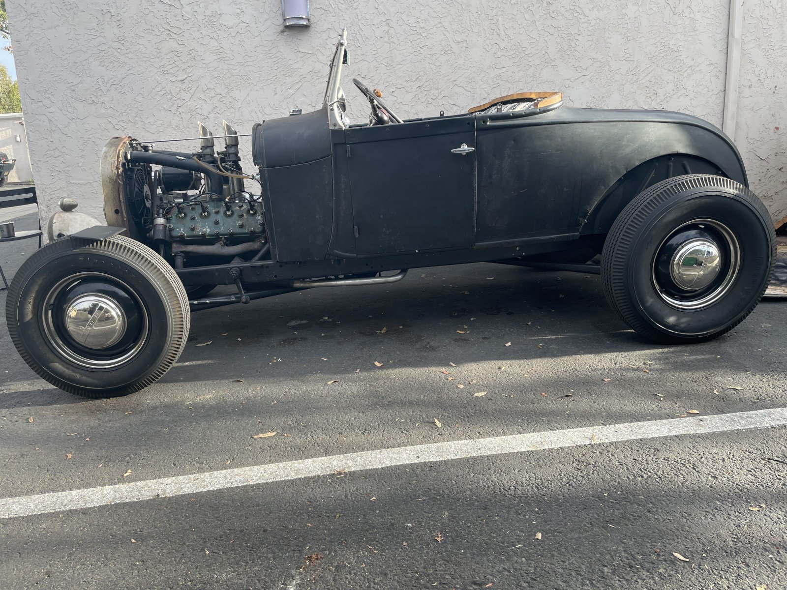

    Thinking about it on my '27 T Touring. (kinda appropriate, inasmuch as I'll be 80 in October!)
    True Grandpa paint job... (only 'maybe')

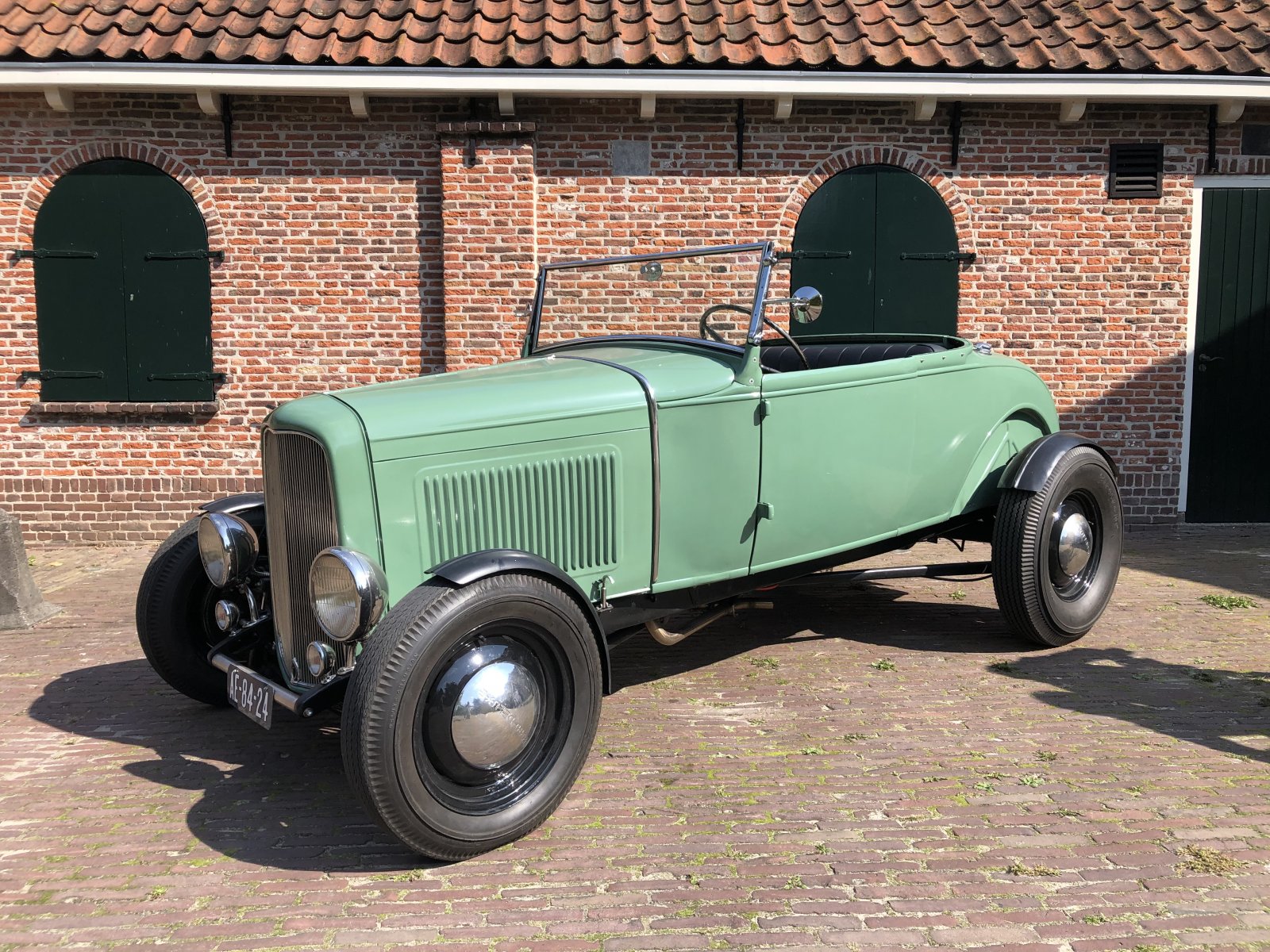

    I painted my coupster with paint from : https://www.craftmasterpaints.co.uk
    I only used a good brush and no polishing afterwards just light sanding between layers of paint, I used two layers on most panels.
    The trick with this paint is that you have paint a pretty thick layer and it wil flow real nice and no brush marks.
    Very happy with the result.
